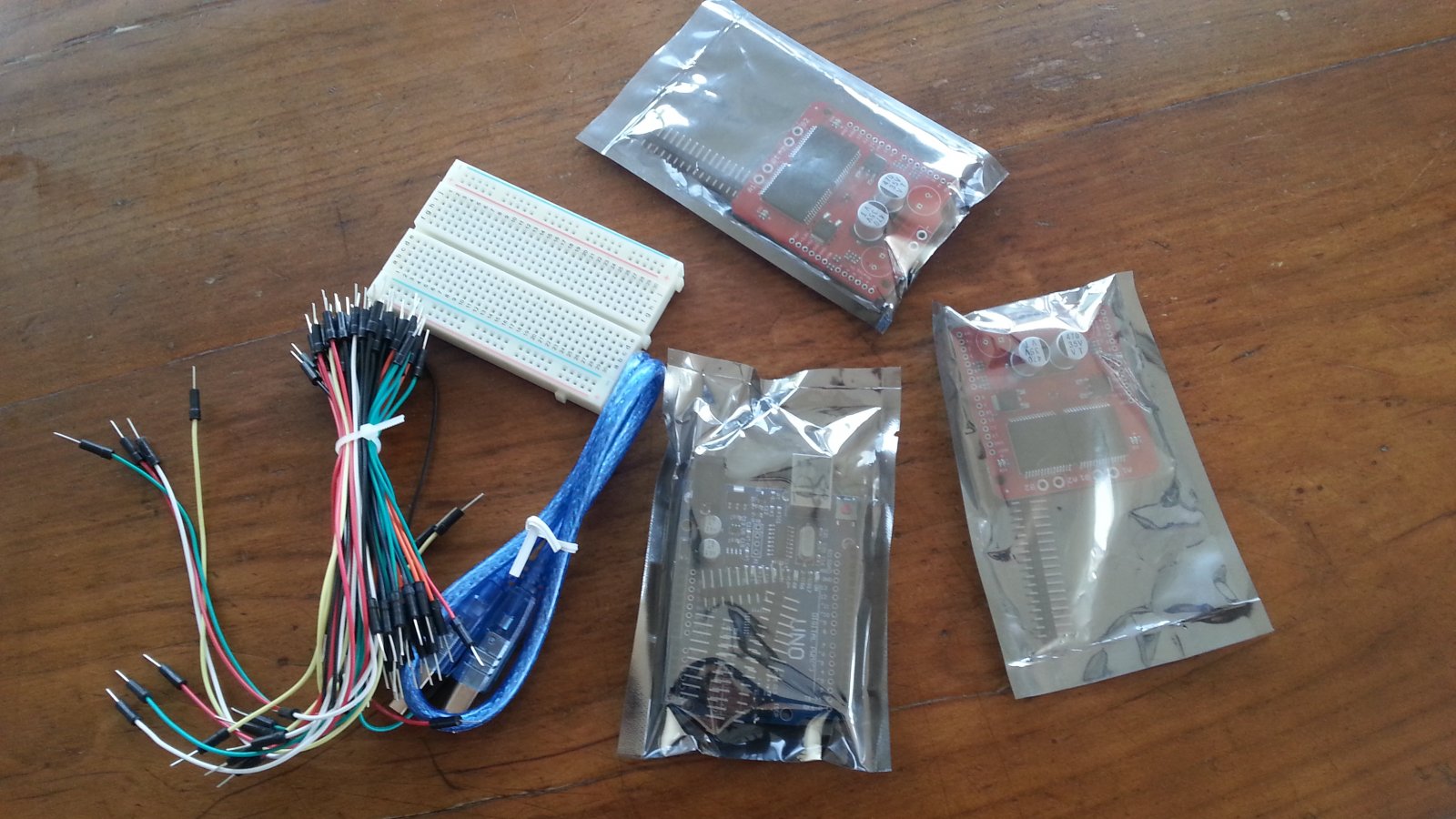

    The Moto Monster is well known as a Dual Motor Driver (called as a h-bridge, too). This cheap motor driver ($ 13 at Aliexpress) works as a half bridge as well. More information how to connect two Monster Moto output drivers together to drive a single motor using SMC3 you will find here:
    http://www.xsimulator.net/community...cts-as-a-single-motor-driver-more-power.5482/
    Now the time is ready to go ahead, the next step on the to-do-list is the MM Dual Half Bridge Motor Driver(s).

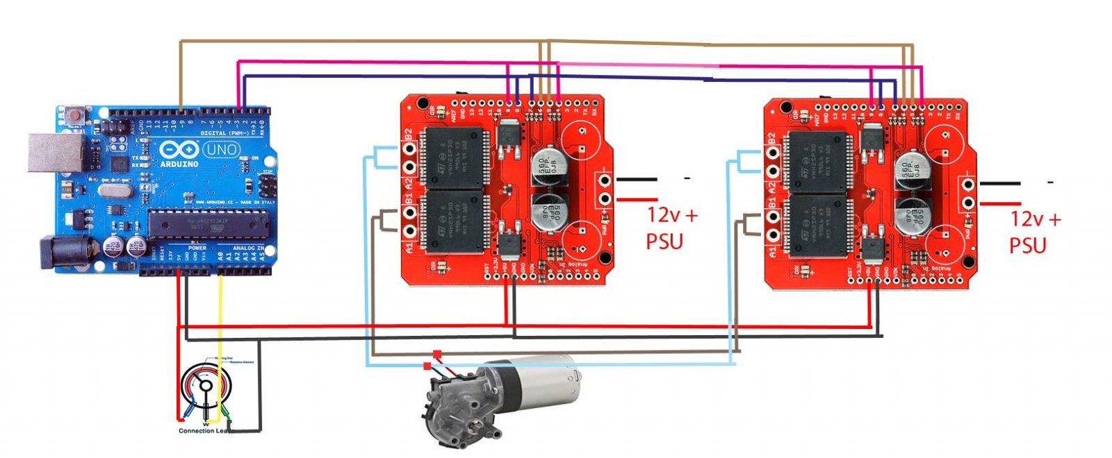

    If one MM works as a "Single Driver", two of them should do in the same way:
    For that purpose I ordered two MMs (each ~13$) and one Arduino Beginner Set (only ~8$ including wire, breadboard and USB connector!).
    Breadboards are very helpful to avoid any spaghetti syndrome. You can be sure if we will use four MMs at least to power up two big motors there are many jumper wires...too many if you will not keep order.
    The experiment starts this week and will end on the weekend. If this experiment will success, we will get for less than [EDIT] 26 bucks (including delivery!) a super strong and super fast motor driver. If not, I lost some MM samples :rolleyes:
    Stay tuned :)

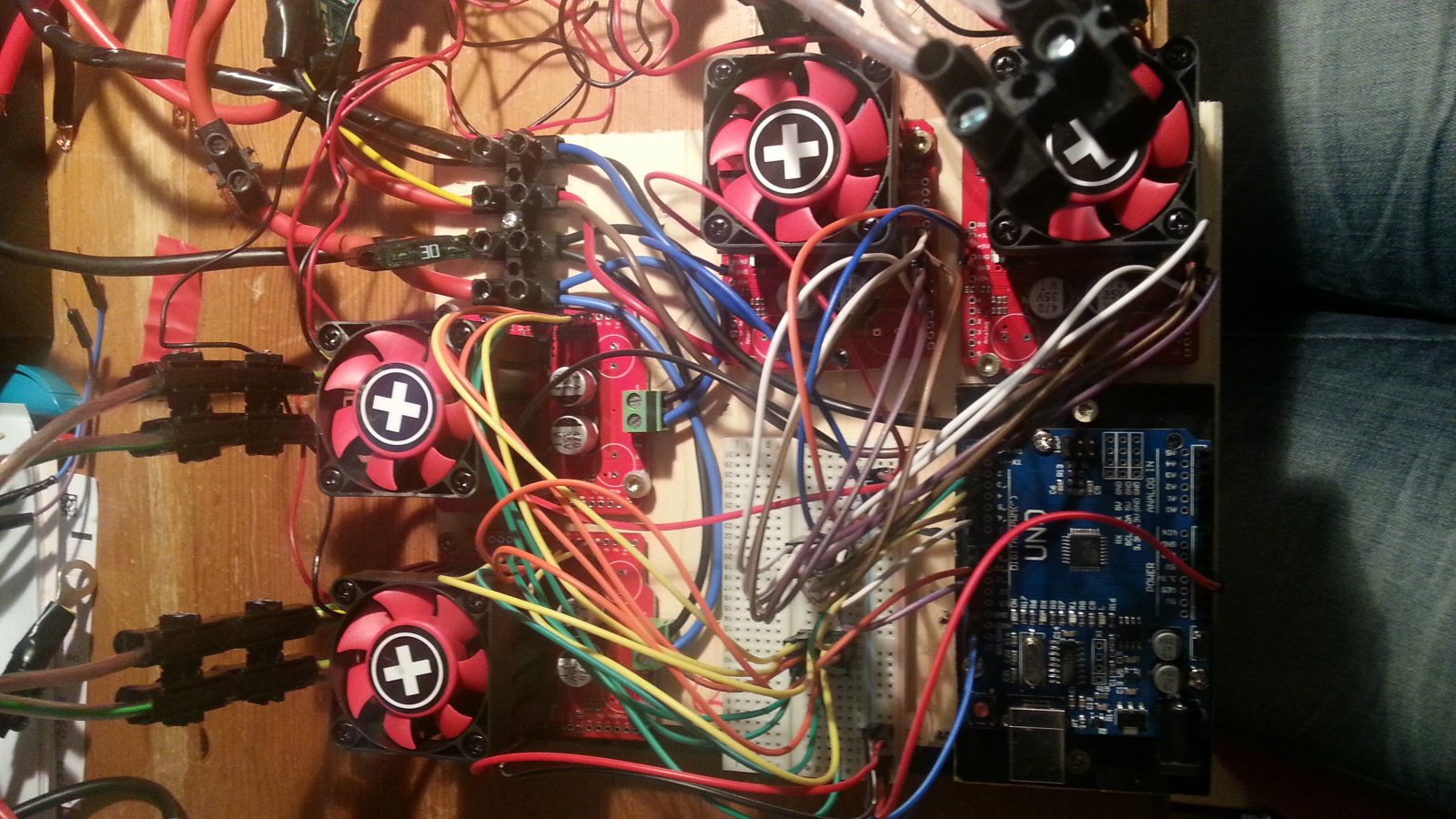

    CONCLUSION 03/22/2015
    These combo has been tested now for a while under very hard conditions and I can confirm it is running without any issues. Every MM will be less hot and this saves any lifetime. Finally between all the mixed outputs there a car fuses build in and not even one fuse has been blown yet. If you need powerful but cheep h-bridges, here you go.
    EDIT 05/17/2015 I have slung the fuses away, no issues since weeks.
    EDIT 10/20/2018 Still working without any issues.

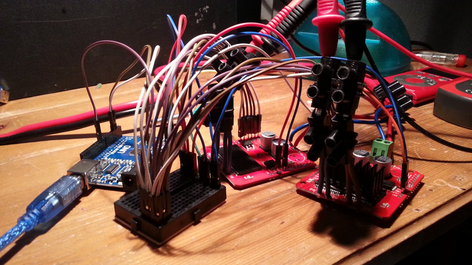

    First I was so stupid, I build in an already damaged MM and was wondering why the hell there was no power (multimeter testing)...now all is correctly installed and the test has been ready to be started.
    As a pioneer which I am - which I believe so ;p (not seriously) - I could not wait until the next week end and was hardly working today - and
    I got it working - really
    IT WORKS!!
    I uploaded a video for better viewing, but please ignore my comments and excuse my English :)

    Wiring please see the first posting!

    BTW I would use fuses between all outputs to avoid any faults.
