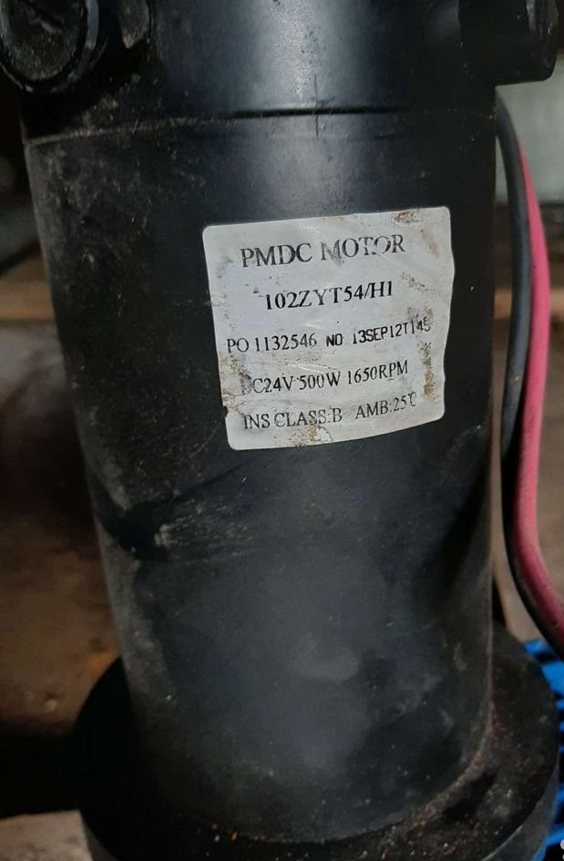

    Hi, everybody. I collect spare parts for the construction of the 2-3dof platform. I came across such motor reducers, there are doubts that they are very powerful for such a case.They are not very expensive, but there are only 2 pieces. So I think whether to buy for 2dof similar engine. 600w, 33A, 3600 1/min, 24v, NMRV040.
    Help with competent advice)))

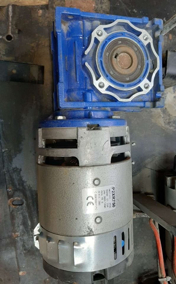

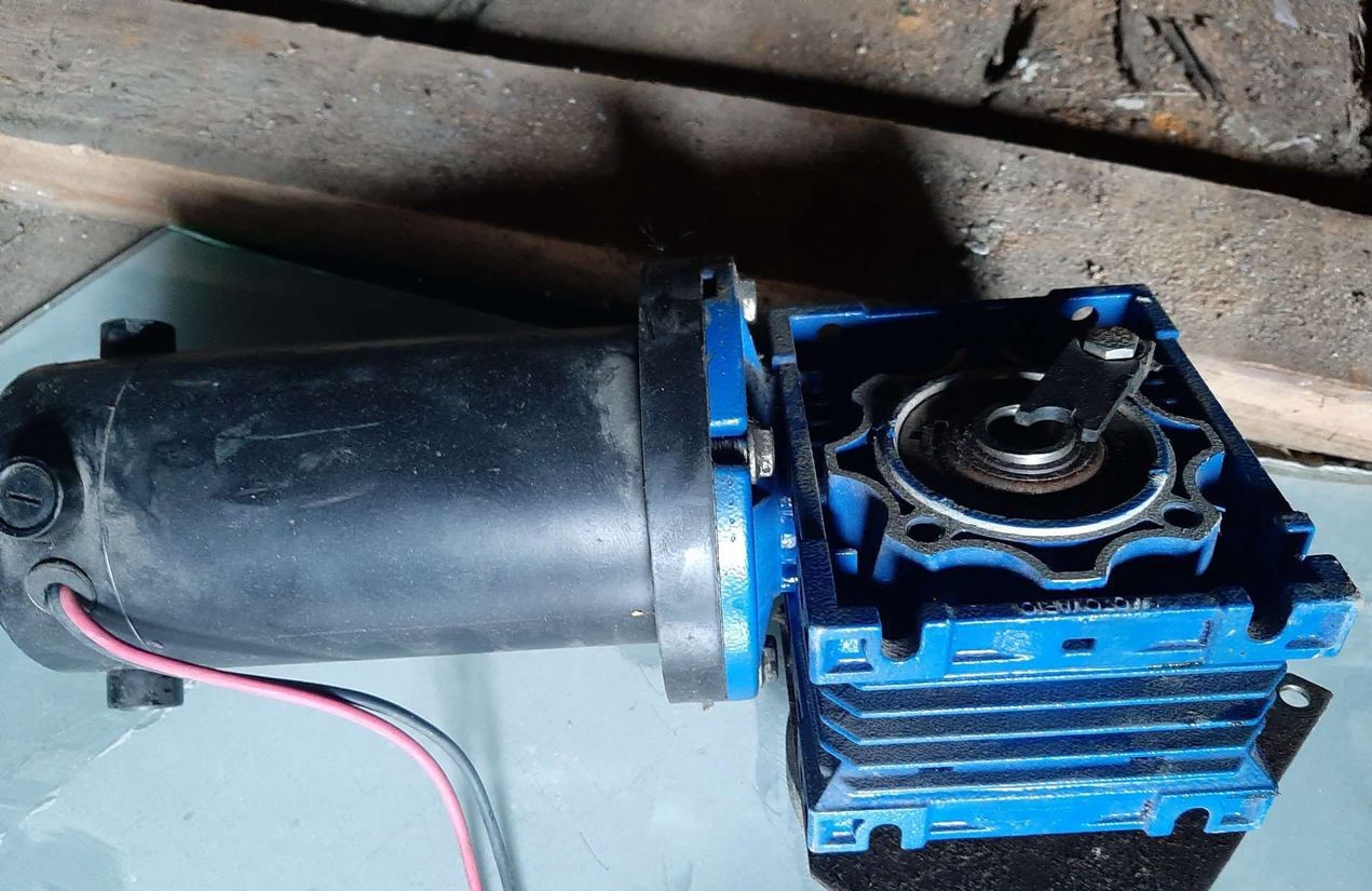

    There are a couple of other gear motors, but there are motors with different parameters. Can I use different motors in the 3dof platform? Or pick up all 4 motors and build a 4dof platform?

    21,602
    151,269Coins
    Do you know the final gear ratio?
    They seem like they are plenty powerful, particularly the first one.

    Should they be considered as a purchase? The price for all 4 motors is 140usd. What is the maximum allowable speed should be at the output from the gearboxes?

    On the first engines, the output speed is 90-100 rpm. The seller does not know, he sent me a video of the work and I counted about by eye)))
    21,602
    151,269Coins
    90-100 rpm is plenty fast enough for good motion.
