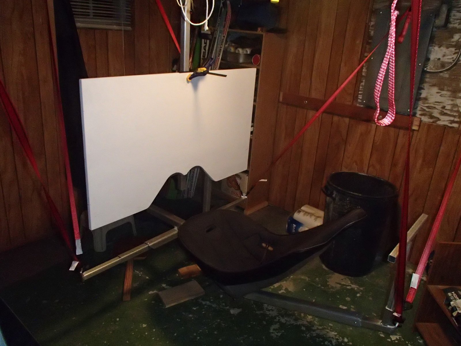

  5. PaulB
    PaulB Titanium2dof
    Apr 15, 2017
    121
    Canada
    723Coins
    +57 / 1 / -0
    1.3 is under way ! Hope to have it running by the holidays. Takes weight well. Nice and stable. Now just to get the motors connected! Let the cable revolution continue. : )

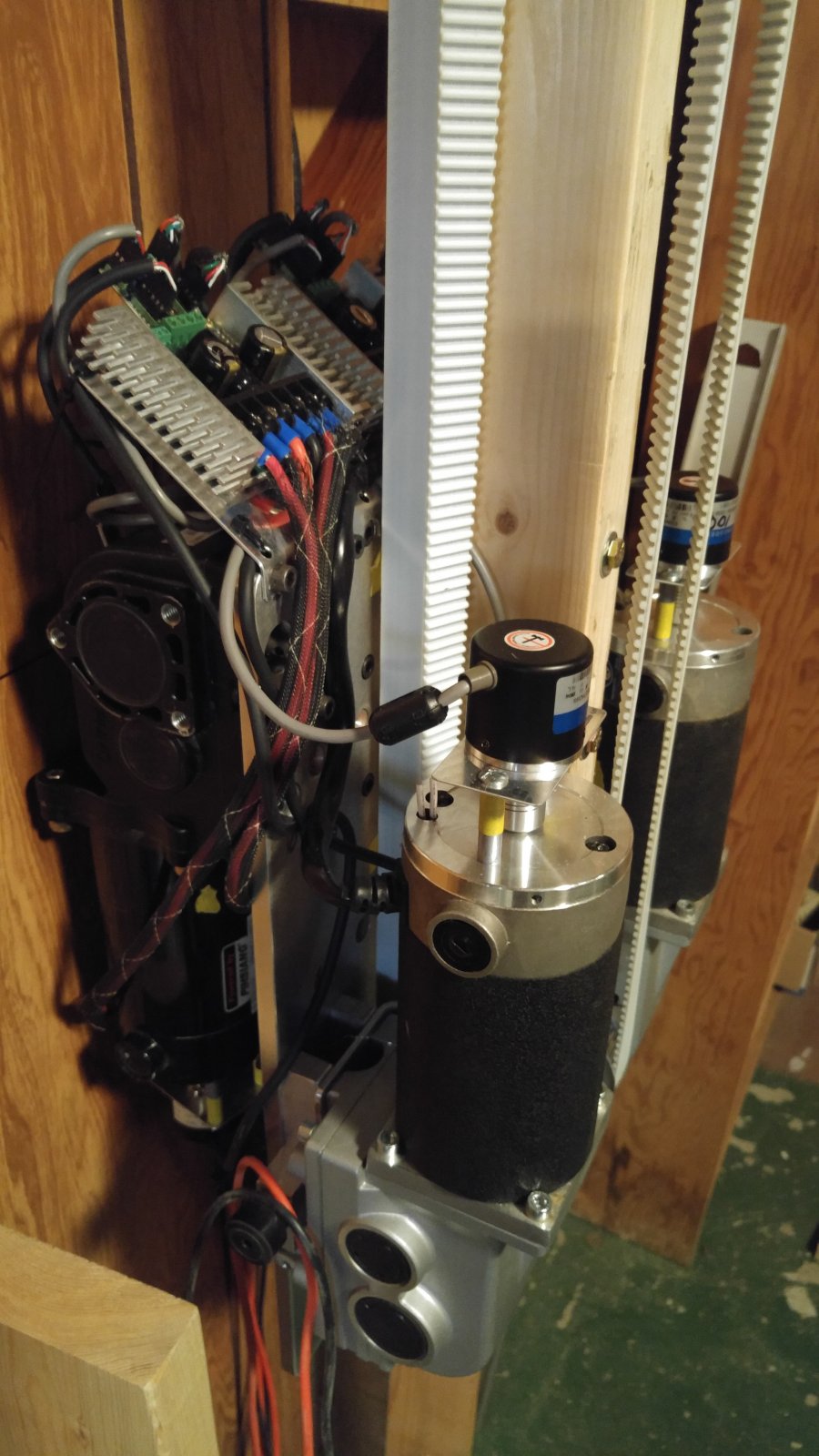

  8. PaulB
    PaulB Titanium2dof
    Apr 15, 2017
    121
    Canada
    723Coins
    +57 / 1 / -0
    The motors are driving timing belts 5m x 22mm belts. nearly silent. The noise you hear is the wheelchair gears not fully disengaging. Adding Heave next. First videos are half the movement.

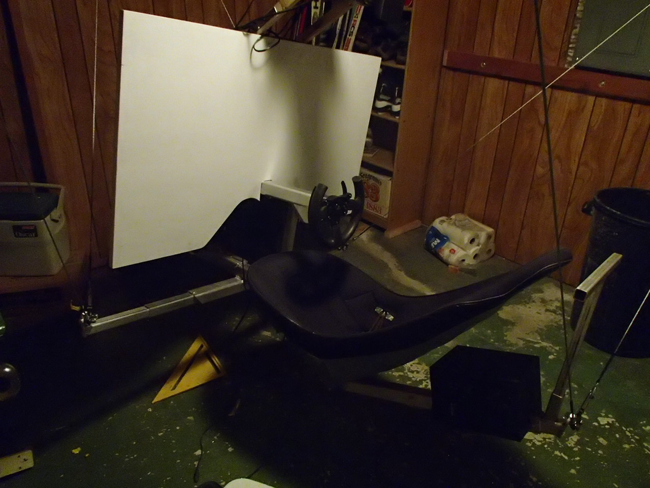

  11. PaulB
    PaulB Titanium2dof
    Apr 15, 2017
    121
    Canada
    723Coins
    +57 / 1 / -0
    Another update. Half way through tuning, but at least I can do some laps. A little bit off road F1 but laps.

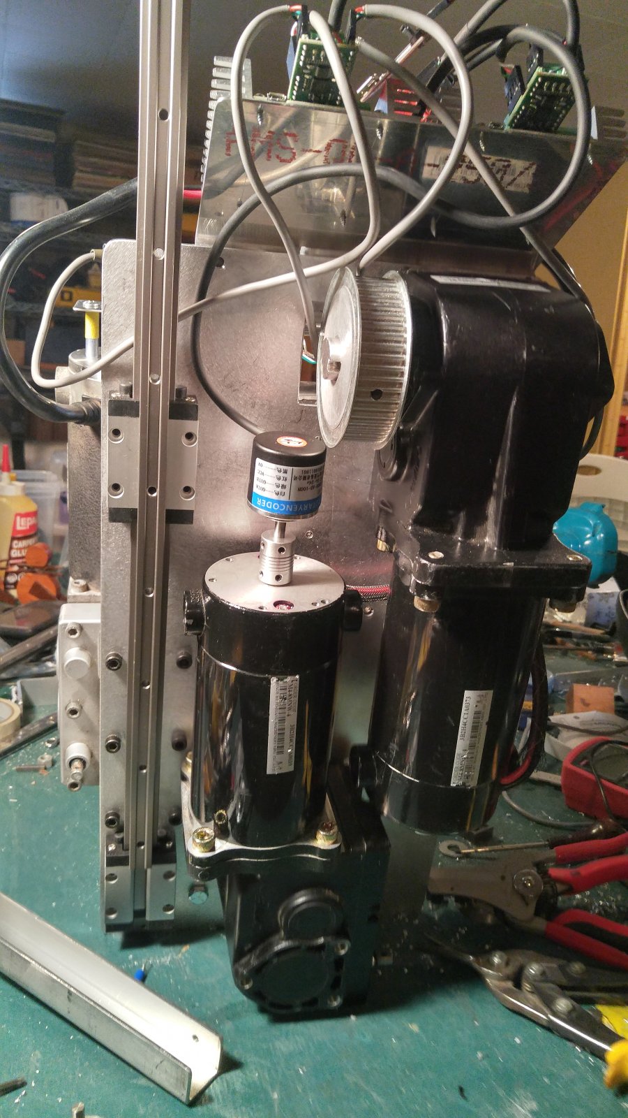

  14. PaulB
    PaulB Titanium2dof
    Apr 15, 2017
    121
    Canada
    723Coins
    +57 / 1 / -0
    Thanks. It was a lot of work trying to upgrade from 2 axis to 4. It's only 3 axis in the last video. This is a block of wheelchair motors that controls all 6 DOF. Heave isn't connected yet. The block will act as a partial counterweight if I get heave running, but I think I might go to a 6 Axis to simplify things. I'm surprised how much better the 2 axis chair worked from the first videos. I did all this work for TL and it wasn't worth it. You can see at the end of the video, as the car stops. It goes into a tank slapper that I can feel when driving that I can't tune out. I think it's because the one axis is so equally balanced. One more thing, this is running on two 12v transformers. The two axis on 1 12v! Nothing even gets warm.
  15. ferslash
    ferslash Active Member
    Feb 8, 2011
    495
    4,798Coins
    +181 / 2 / -0
    woow i see you put grate and expensive encoders on your motors. thanks for sharing it looks grate :D

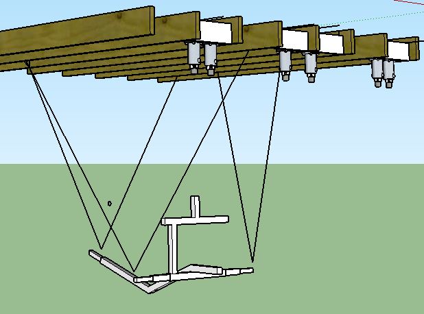

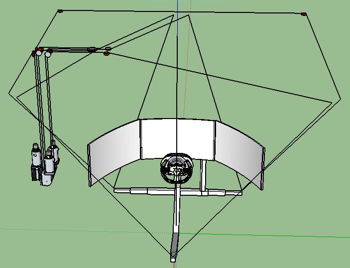

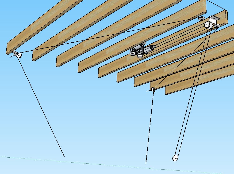

  17. Menix
    Menix Member Gold Contributor
    Mar 8, 2010
    79
    104Coins
    can you post pictures of the ceiling were the ropes are mounted . Are the Motor always on the ceiling? A small drwaing how the ropes are arranged would be good too. And were is your beamer mounted?
    many Questions but your sim looks good and its worth to build it.
  18. PaulB
    PaulB Titanium2dof
    Apr 15, 2017
    121
    Canada
    723Coins
    +57 / 1 / -0
    Sorry I don't have photos I can find, just rough models
    these are 2 and 6 motor setups
    2 motor had a frame around the driver attached to the wall to stabilize the rig!
    The "cable car sim" and "F1 Sim" videos (3 motors) is kind of a hybrid. I liked it because it didn't use the motors to lift any weight same with the 2 motor.
    Sorry no models

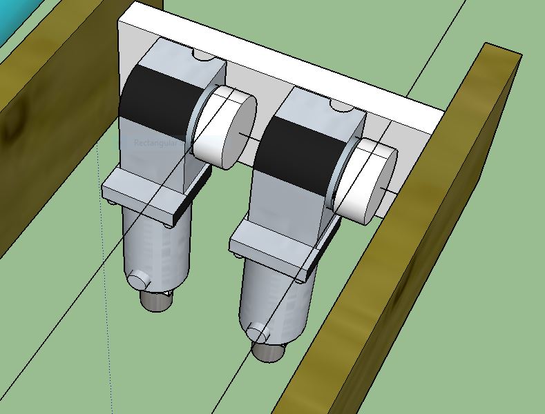

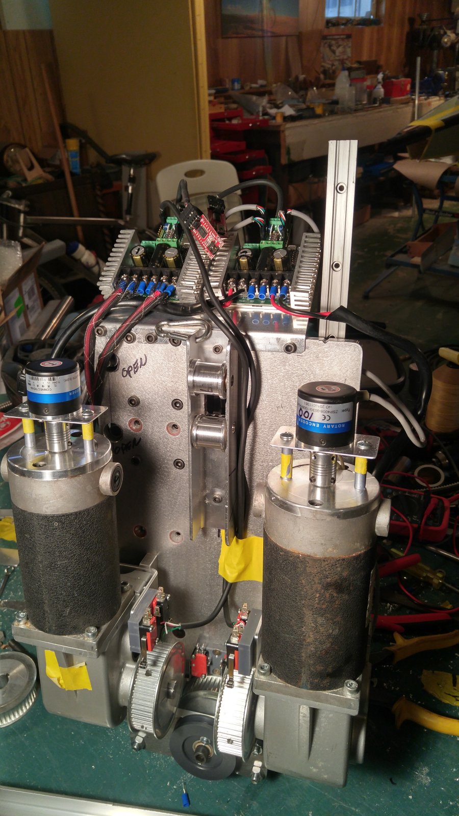

  20. PaulB
    PaulB Titanium2dof
    Apr 15, 2017
    121
    Canada
    723Coins
    +57 / 1 / -0
    Never the 4 motor rig working. The 3 motors rig "F1 simulator" movie has been dismantled to go to the cable Stewart Platform.
    This is how the motors are mounted.
