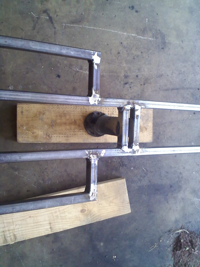

    So I started and am working on a motion simulator that will cost me about $550 USD!
    Specifications:
    2x 12 linear actuators capable of lifting 200lbs at 9mm /sec
    .125 1 square tubing
    17 DOF front and back 17+DOF left to right
    Logitech G25 steering wheel and pedal set
    AMC 1.5 Board by thanos
    Dual H-bridge By thanos
    2x 2x6 wood planks for the base
    Playseat Classic Gaming seat

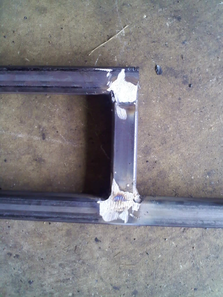

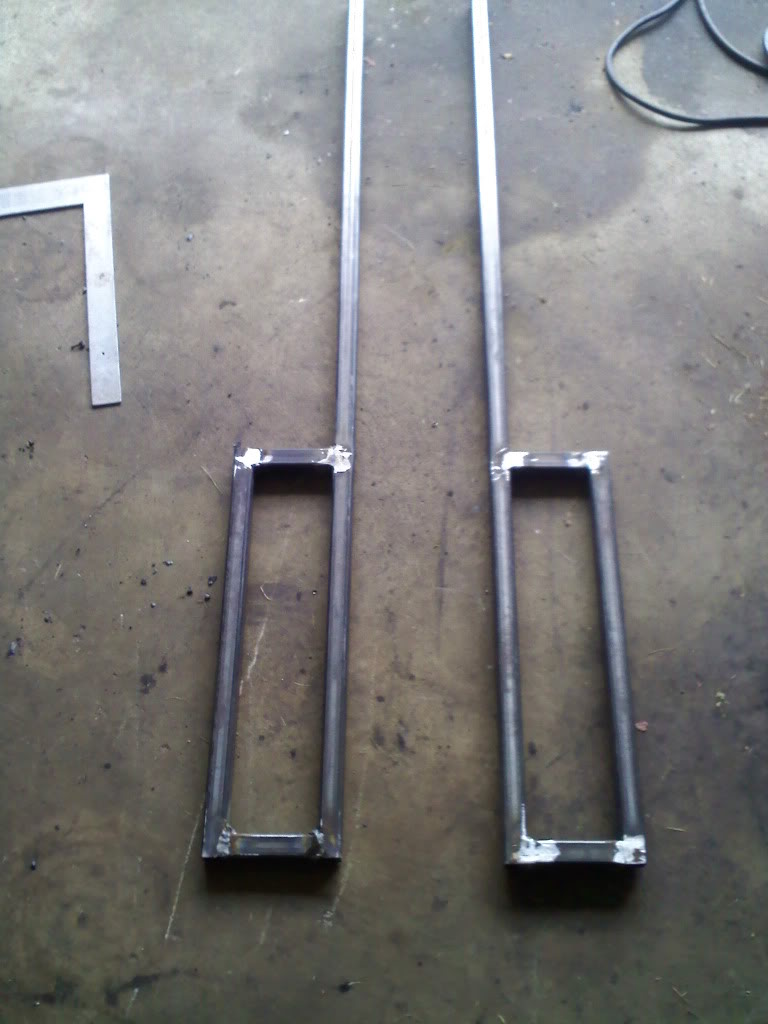

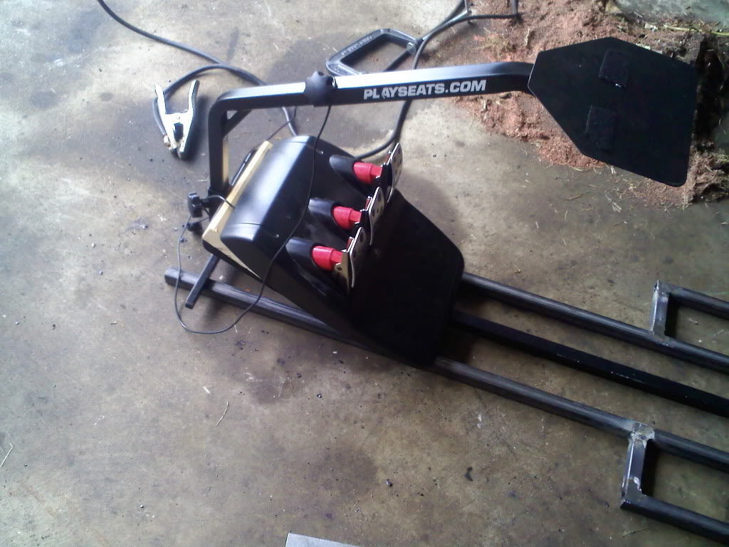

    So I started out on here... with NO idea how to do any of this.... and now I know exactly from step 1-done! It was a lot of time doing research for parts, since there are very few off the shelf parts for this. I thought about using wiper motors, but I wanted more umph. I've used window motors for robotics before and they seemed lacking for this project. I've actually had about 3-4 years experience with similar motors to what everyone here is using. I looked into other motors, but decided that linear actuators are the best bet. They are designed for moving things, nor will I have any issues since they are designed to handle massive weights! I also don't have to buy additional universals and weld onto the window motor, which I believe would be one of the first things to fail and also hard to do for an inexperienced welder.
    I started with no plans, just a tape measure and my mind. The result is this chassis....
    The square section is to support and bolt to the seat while the extended portion is to hold up the pedals and wheel.
    Weld Close-up!
    part of the Idea....
    Driveshaft plus terrible mock base
    I then asked myself what is a cheap and reliable source to move this unit. I thought drive shaft. Any driveshaft works since they all are heavy duty. Mine was from a 1980's volvo and the wall diameter was about .083 inches... which is more than enough for what I want. So I welded that on and here is what it looks like atm.... You can get one for about $20(mine was free), which is what I unnecessarily spent on the cutting of my tubing ($24 for materials and $24 for cuts that I coulda done myself!

    Note: The best way to but this metal is with reciprocating saw, bi-metal blade @ the highest TPI possible!
    Go to a local weld shop for the steel and ask for 1 tubing from .083 to .125. You'll need about 20' of it. They'll also weld it up for you, but welding it yourself is MUCH cheaper and more of a learning experience! Be sure to get the correct rods!

    Also seems like the G25 and Playseat Classic uses up most of you $550 budget. Are those included in your cost?

    the G25 is not included in the cost, but the seat is. I know that the linear actuators move really slow, I plan on decreasing the distance from the universal. The output of the motor in Newtons is the similar to that of an SCN5, but it's geared down. Decrease the radius, decrease the torque, but increase the speed.
    What do you mean swap the universal joint around? Like have the bolted portion on the frame? not a bad thought, but I think it'd be more than what is necessary. I get more than 17 degrees each way, but I think any more and I'd be too high off the ground, and that'd be a bit too intense.... considering the Blue tiger only goes 20 degrees, I think 17 is plenty, and if not I have some more play. I understnad what your saying though.
