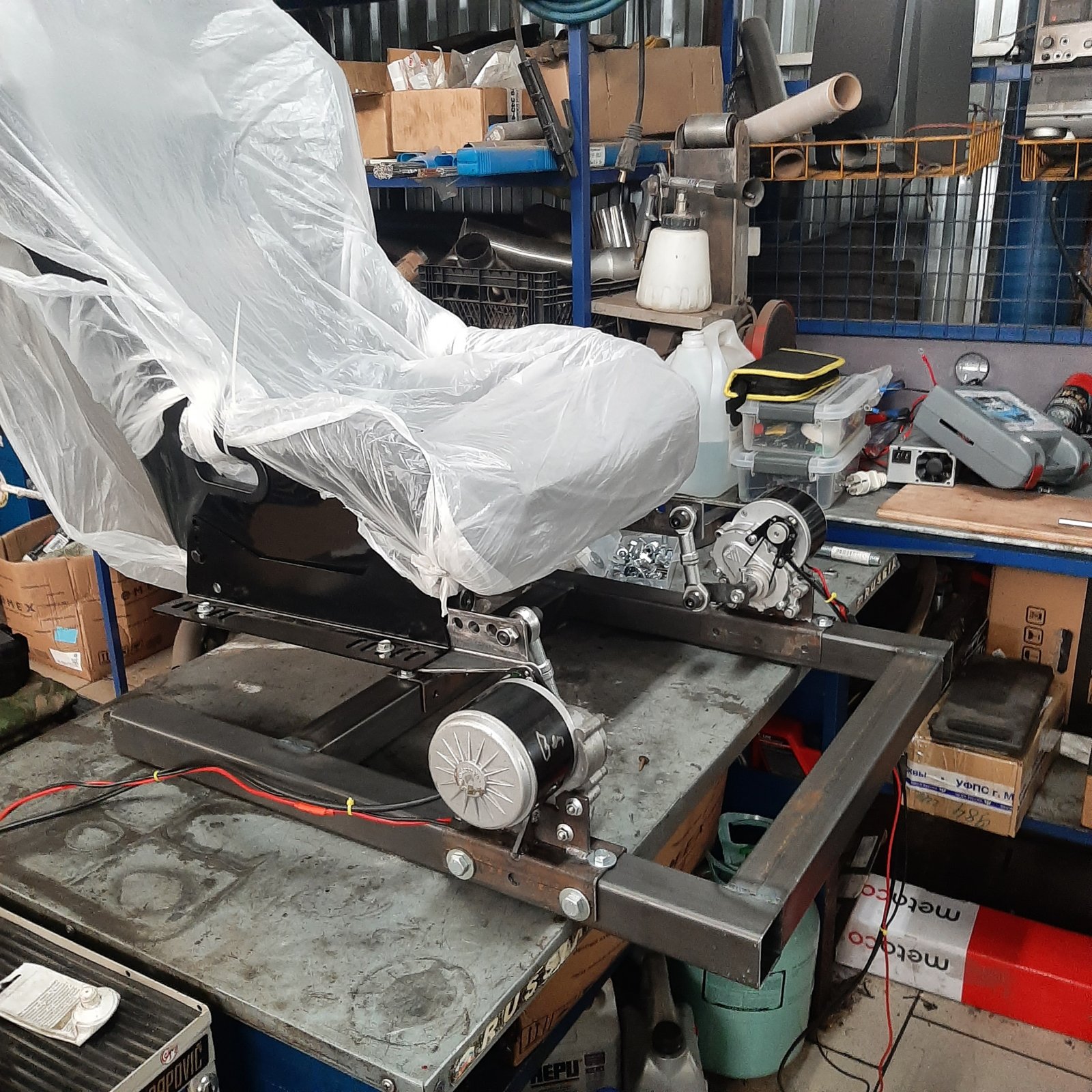

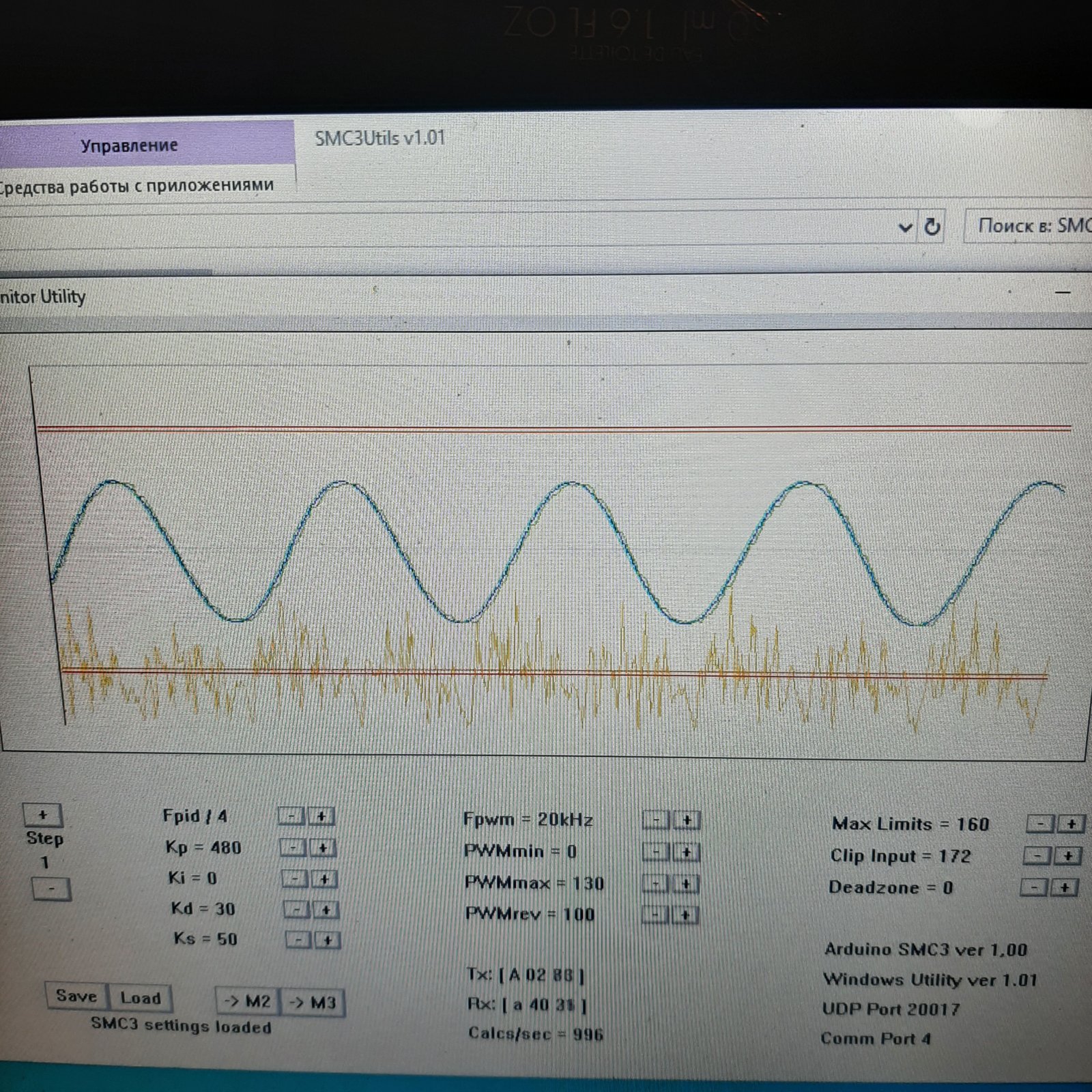

    20 volt test, what do you say? this is without load and so far only 1 motor
    21,669
    151,668Coins
    +11,045 / 56 / -2
    Was this done loaded with you on board, or unloaded?
    It looks to be tracking reasonably well, but stuttery and slight overshoots, so you may want to refine SMC3 settings further, particularly the overshoot at the top and bottom of the curve.

    so far, this is a test build without me on board! how do I correct these emissions? or do you need to make further adjustments with me on board?

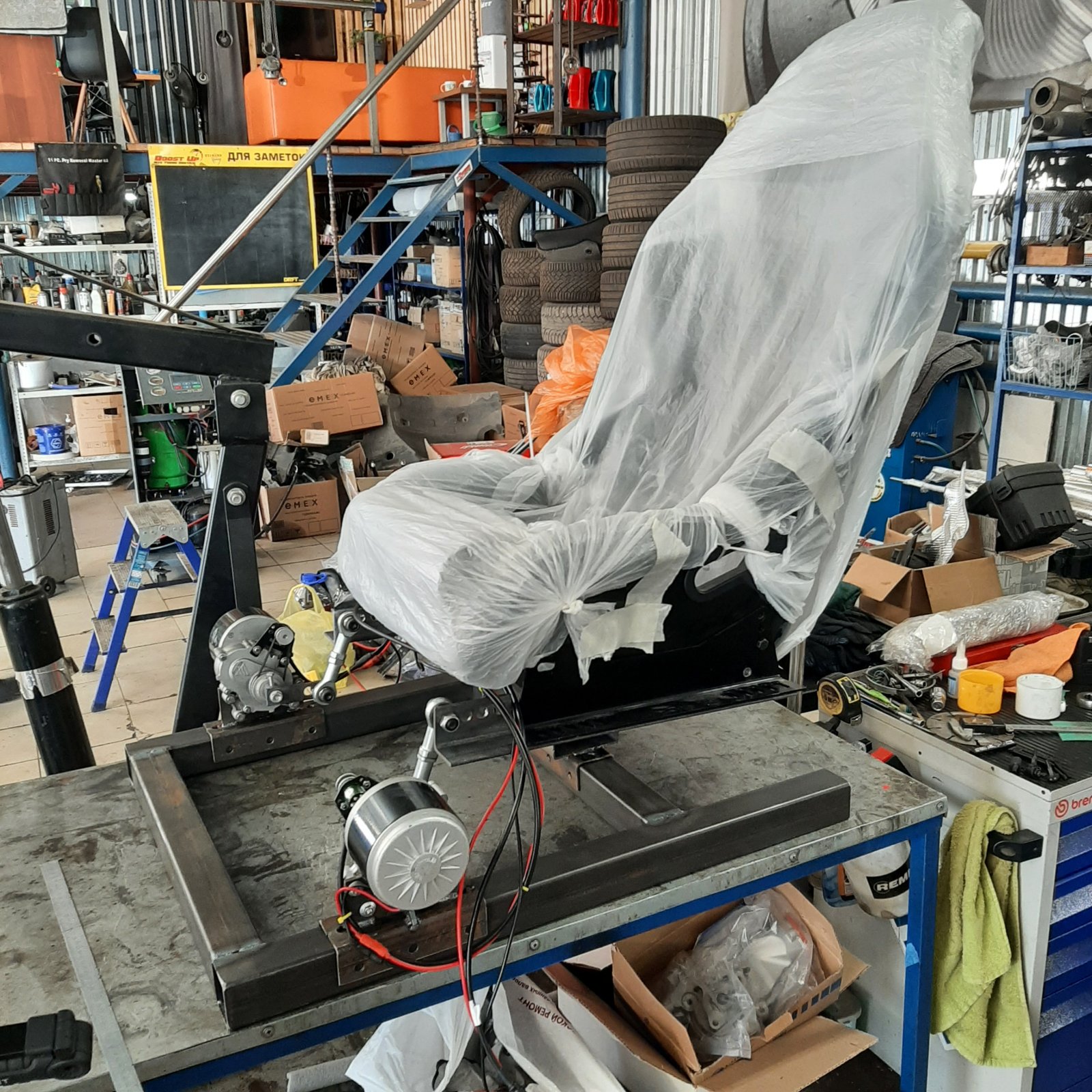

    It's time to start designing changes to my cockpit!

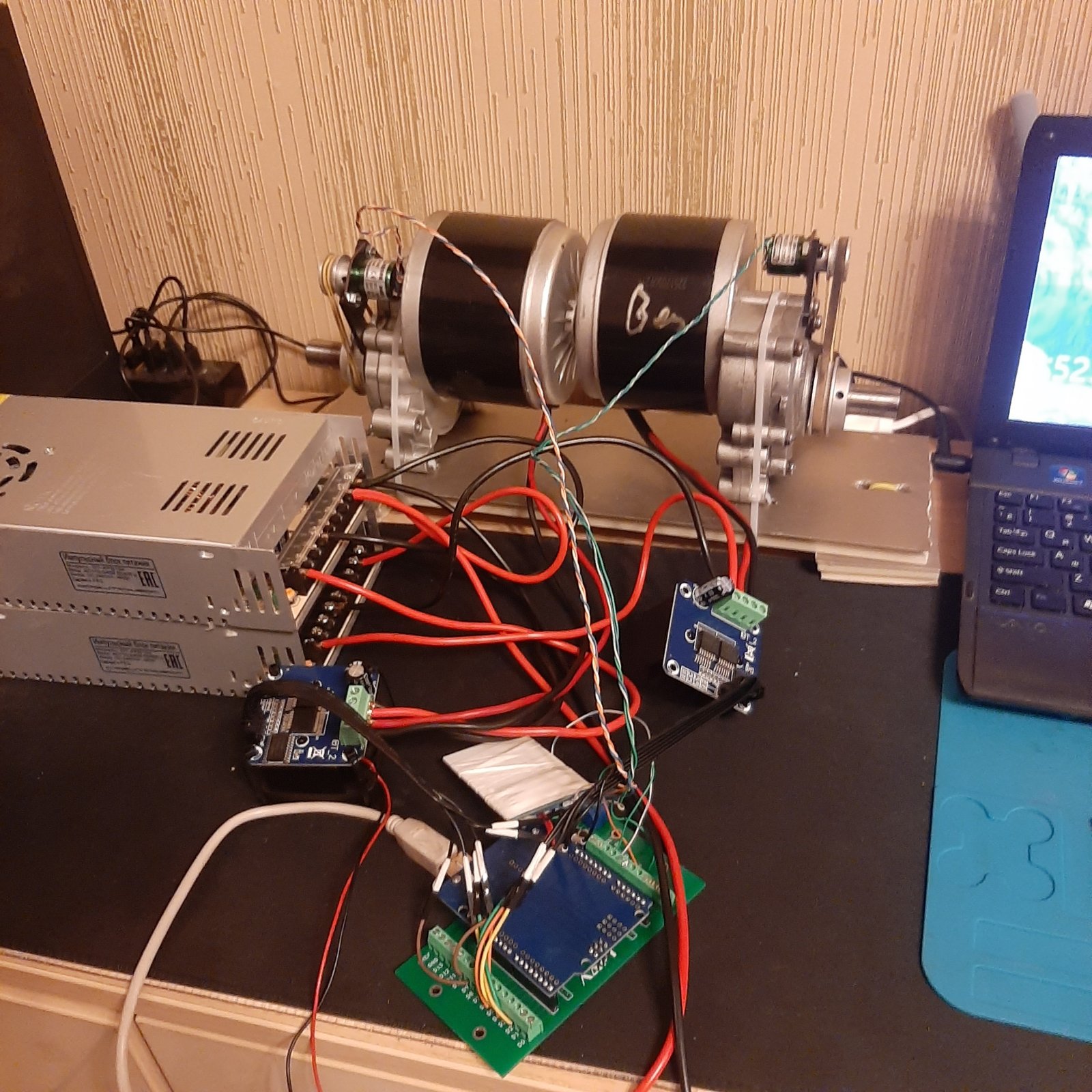

    hello! I ran into a problem (I set the center of 2 motors in SMCUtils everything is saved. I turn off the entire system, turn everything on again, then run SMCUtils all parameters are normal and the chair gets up if it needs a central position as everything is configured. next, I installed demo simtools, set everything up as in the instructions, chose the first trial surge effect, both motors move as they should in the same direction, but the central position in simtools changes 1 motor looks slightly up and 2 motor on the contrary, when I start testing both motors move in the same direction. how can I solve the problem with the center in simtools?

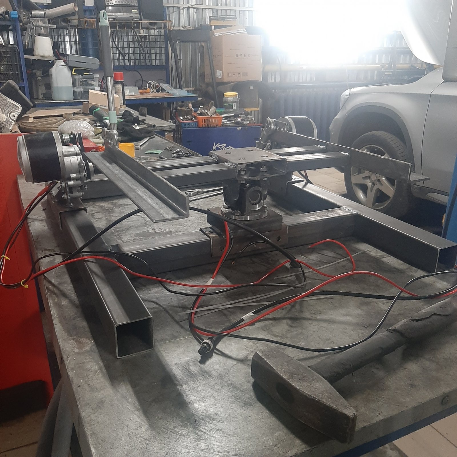

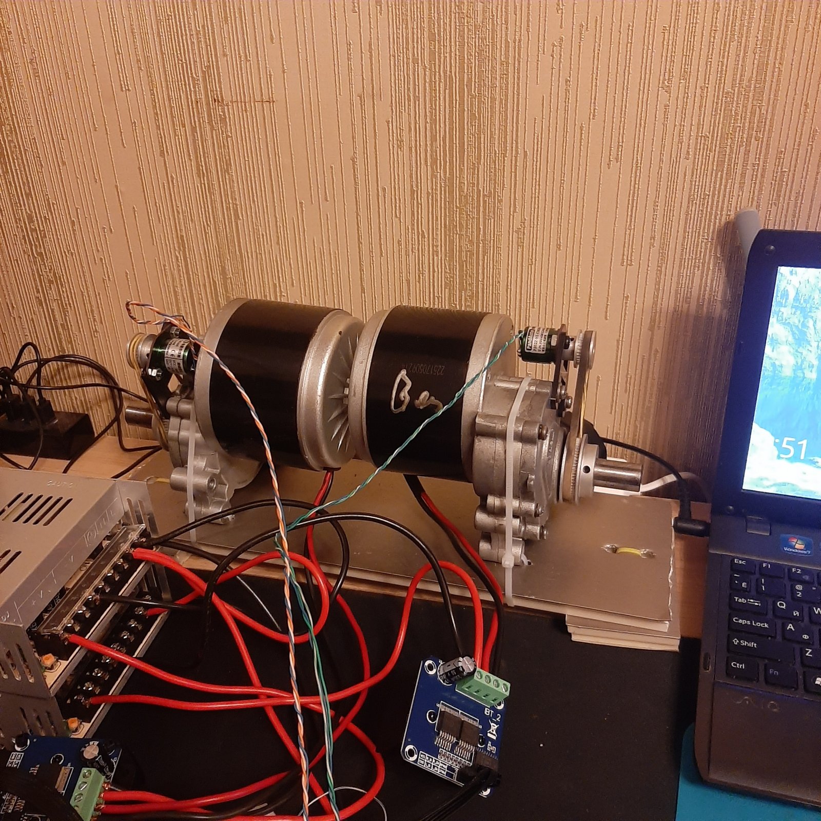

    The test framework is ready

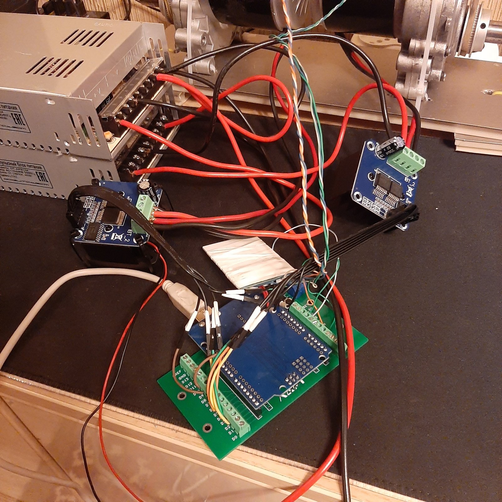

    hello friends! everything worked out for me and my test platform came to life as it should! I bought a lot of components and will try different options. now I use 2 motors from a 24v250w wheelchair,2 bts units,a 12v 1600w 130a mining farm power supply,an arduino uno r3 clone.I want to try a 100A motor driver on the same power supply, and then on a 24V power supply. I have all the components to experiment.but I can say that even now everything is working fine! so far I have decided to use simhub, but in the future I will definitely buy more simtools
