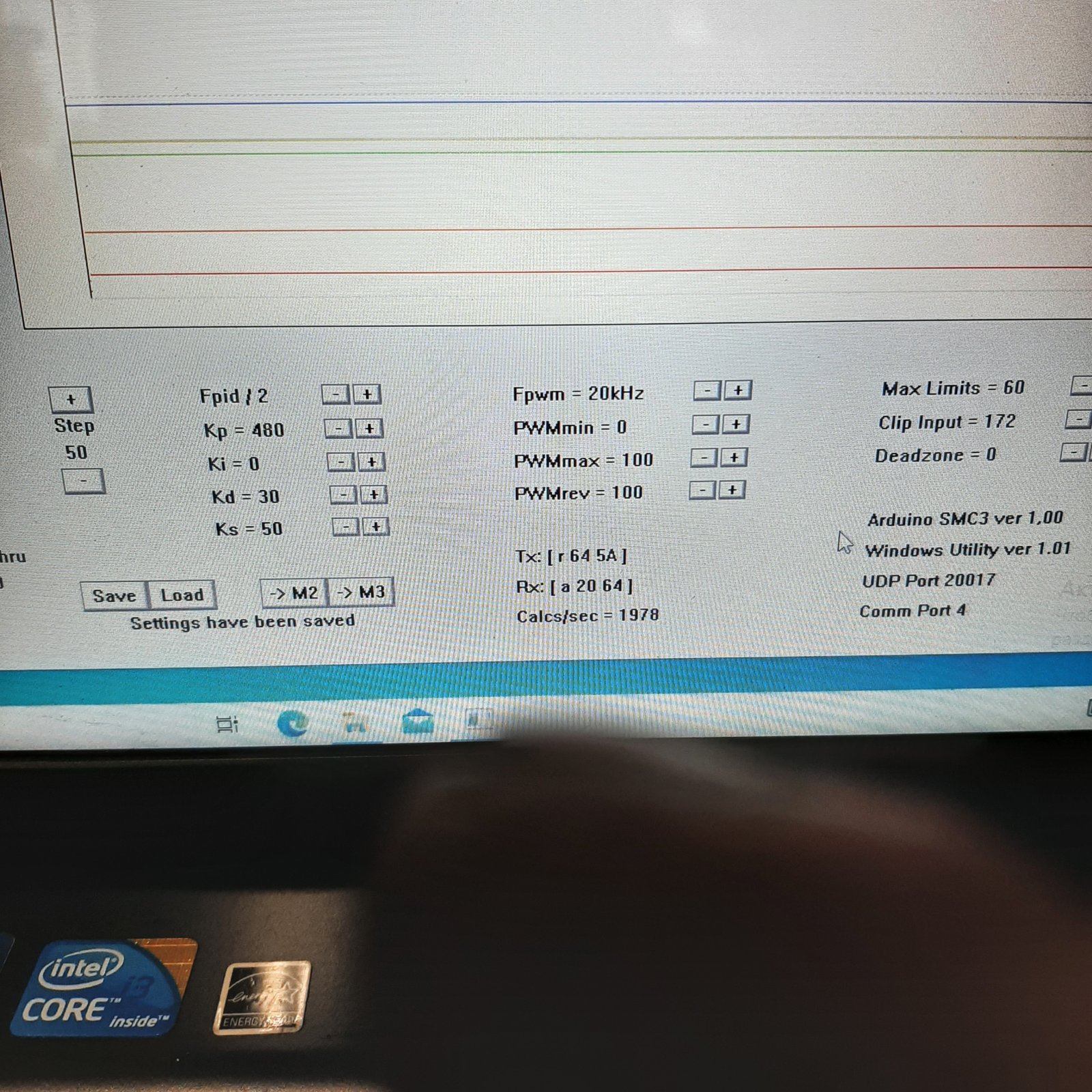

    here are the settings

    Are you hitting the SMC3 limits, which as a safety feature will shutdown, or is a PSU tripping?

    the power supply does not turn off, the arduino or BTS turns off. to resume operation, it is enough to overload the arduino.

    my configuration. BTS engine driver,wheelchair motor 24v 250vat,power supply 24v480vat20a,there is also a power supply 12v480vat40a,360 degree rotary hall sensor,I use a hall sensor with a belt drive of 60T to 30T.can you tell me where to start? I also noticed that the shutdown occurs with any SMC settings.

    Can you please post a picture running the Sine test.

    I'll post it later, the working day is just beginning
