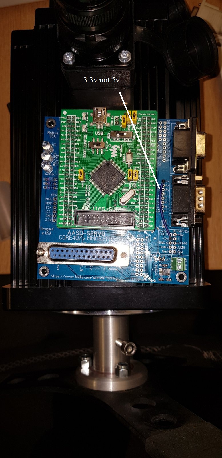

    @Thanos - I have been having some trouble getting the pedals on my sim to work correctly
    it appears the 5v for the g27 pedal connector is actually 3.3 V not 5V
    there is a wire soldered to the board that says 5v (pic to follow)
    is there somewhere else on the board I can take 5v from ?
    please advise

    image showing wire attached
    @Thanos

    The pedals and shifter do need to work on 3.3v, as the logic and analog signals from STM32F4 need to be 3.3v.
    The jumper wire you see on the photo is to also provide 3.3v power to the DAC as it doesn't needed 5v as I thought, but 3.3v rail to rail to have less gap on the offset center for the torque signal.

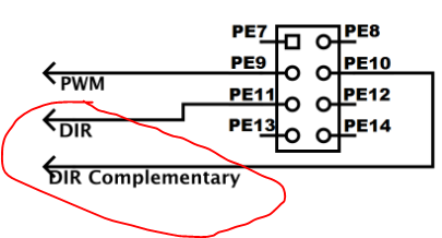

    I am not having much luck with the TDD board from thanos
    it appears the FFB is reversed when using Rfactor and other programs
    is it possible the direction pin is sending in the wrong direction ?
    is there a way to fix this ?
    the MMOS settings from Thanos recommend the encoder is reversed - but doing this makes the wheel spin when at the desktop
    i have tried changing everysetting iu can think of - e.g
    in RF2 the json file for the controller is set to
    "Steering effects strength":-10000
    I have tried very hard with this TDD wheel and I am starting to think the direction pin is wrong

    There's a inverted dir pin in mmos, try using that one if possible.
    Alternative would be to reverse encoder as you did, or put A encoder wire into B input on mmos and B into A.
    I think that you'll absolutely need to change dir pin because you can reverse the encoder but that will just fk up game input and you'll still have reversed ffb.
    Try using a little bit of desktop spring and see if your motor moves away from center - if it does dir pin is reversed (idk if you did that already, something like this was mentioned in your post).

    Finally a breakthrough - reversing FFB using MMOS and RF2
    Ok finally a breakthrough ! Windows 7 makes local user copies of ini files and when you edit them it may not be the file that windows ends up using !
    The solution for RF2 is edit the json controller file so the steering effects strength is -10000
    Now save the json file with a new name ie MMOSv2
    Now open rf2 and load the new controller file. Windows 7 has to use this file because there is no other one available
    Problem finally solved.
    I have posted the solution here so if anyone else gets caught out they will find the solution
