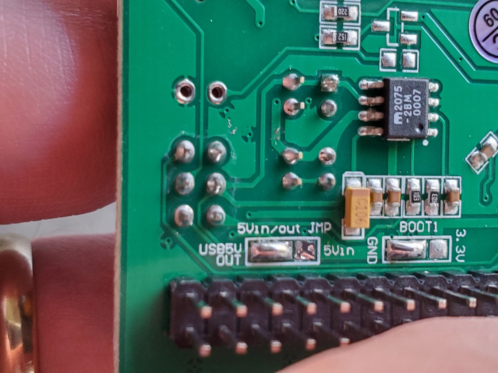

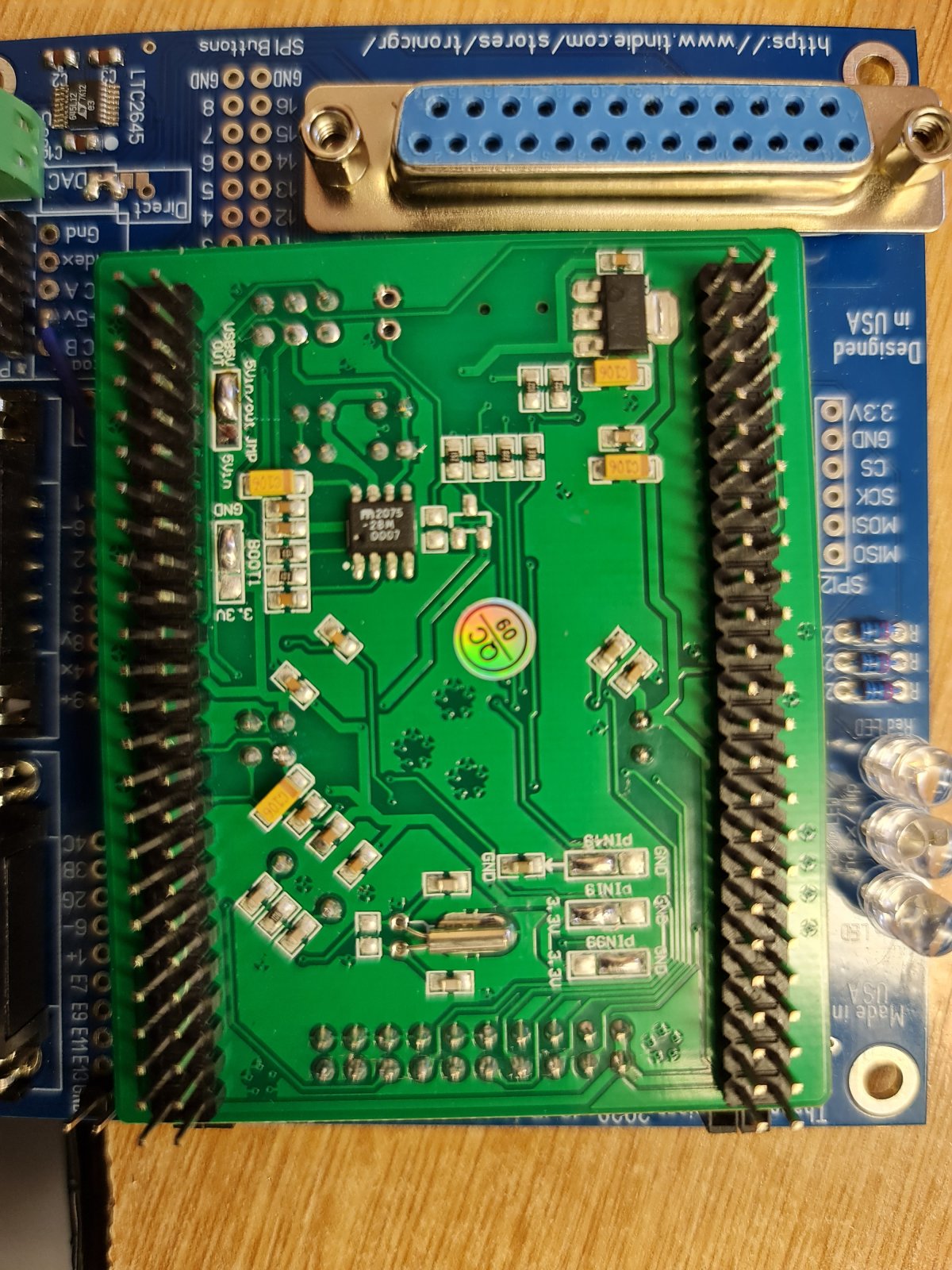

    Under the Core407v there is a solder jumper that has to be changed from Voltage In to Voltage output 5v... can you see if that is correct like in the photo?
  5. Gadget999
    1,992
    12,156Coins
    +492 / 11 / -0
    Pic attached
    If i put 3.3v to the index pin will that force the board to accept motion ?
    Do i need to measure any voltages ?

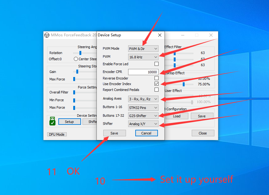

    I see in your video the analog axis is set differently. I have no idea if it effects anything or not
      File size:
      155.5 KB
      Views:
      535
  12. Gadget999
    1,992
    12,156Coins
    +492 / 11 / -0
    Good idea
    However why is my aasd driver powering up with a fault :(
