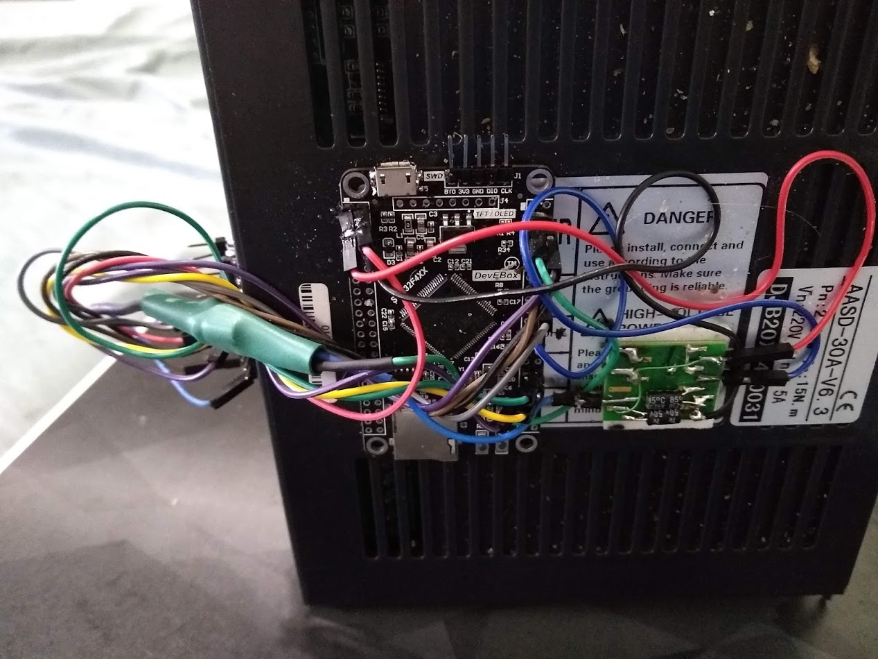

    Ok this is a build of a mige 130 st servo motor with aasd driver and Thanos circuit board.
    (Originally I built the wheel using the mige servo driver but it was not compatible with the Thanos TDD smoothing board)
    Today I powered everything up with the emergency stop button wired to the TDD

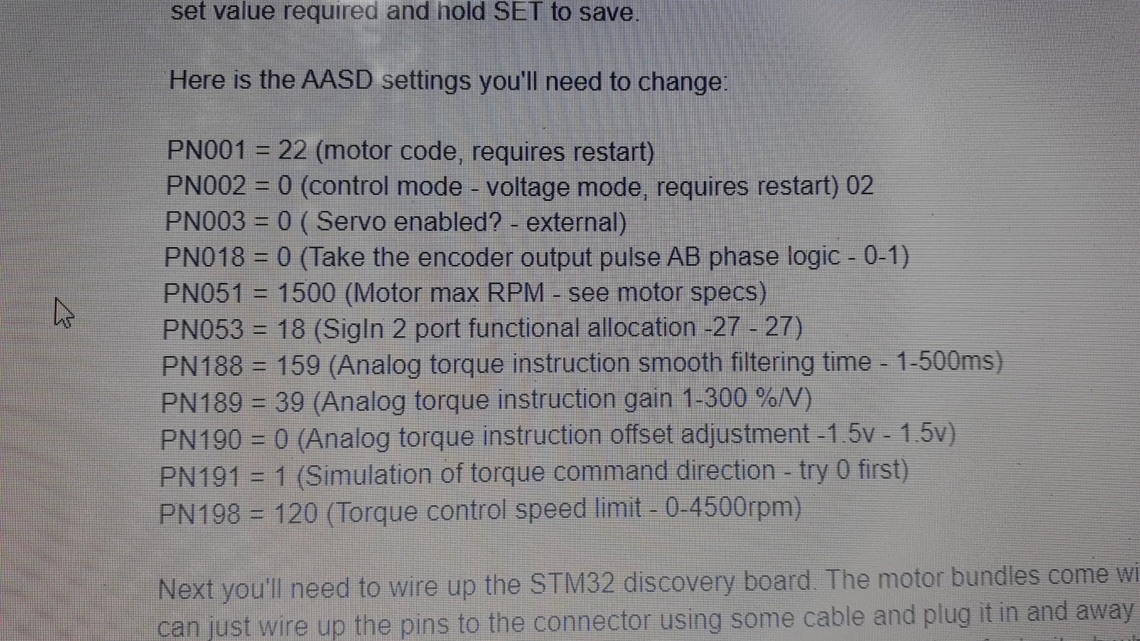

    I looked at peacemakers notes and changed some parameters on the aasd, see attached picture

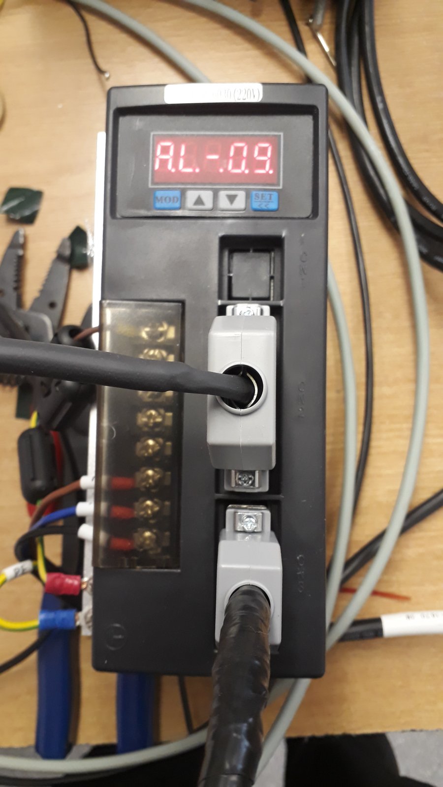

    After a restart the drive came up with error 9 (before the restart the board was responding to the encoder and index seemed to be working fine)
    Is there a way to reset the aasd and start again ? I am guessing I have set a parameter wrongly

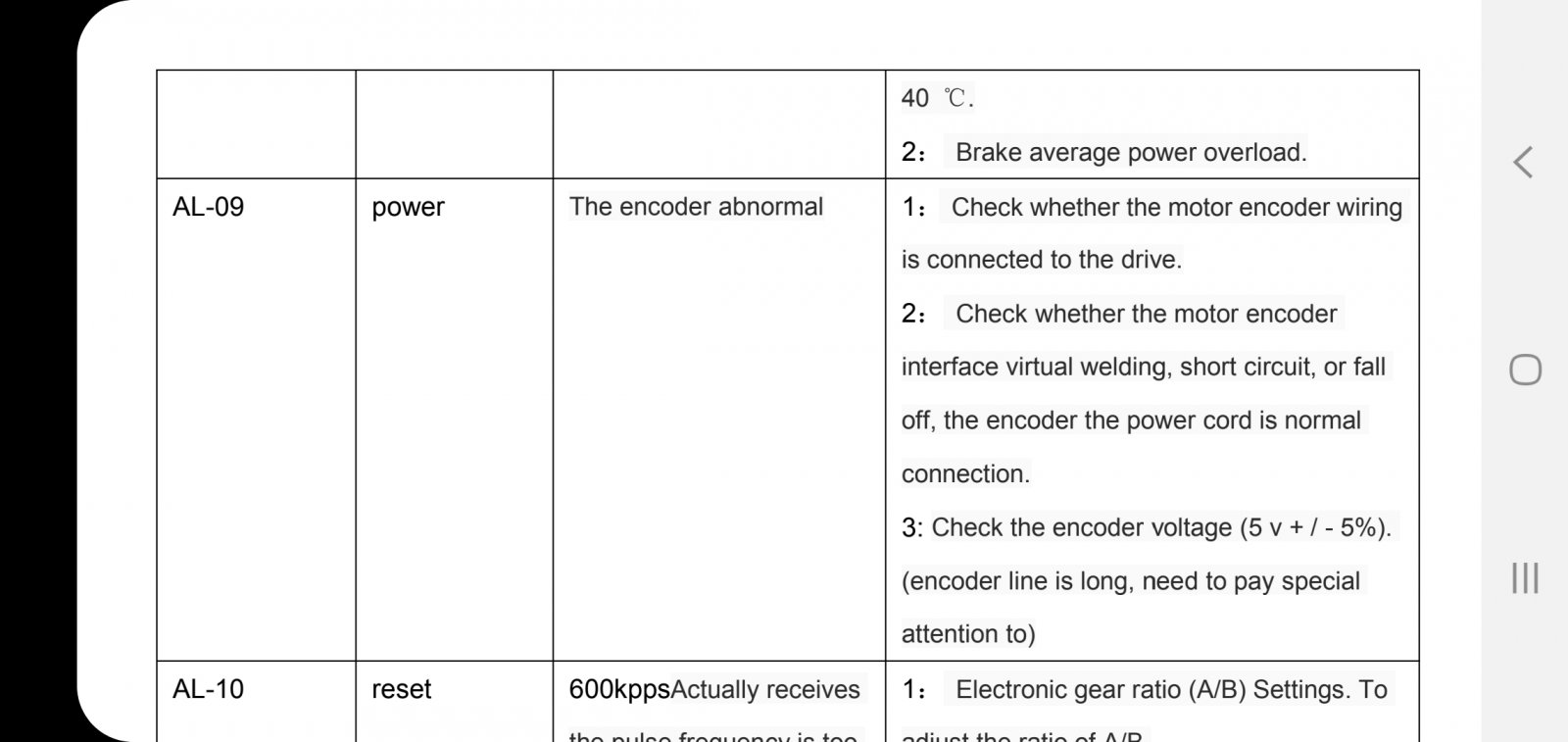

    Alarm 09 is a encoder error. Resetting power will clear it. If it continues to come up there is a failure in the encoder or controller eprom problem.
    FN04 will reset all the parameters to default.
    I have used it several times....:)

    Hold on... why you connected the encoder directly to the STM32???????????? Its wrong!!!
    The encoder from the motor only connects to the AASD drive!
    And the only cable that connects to the TDD board is the DB25!!!!
    You are trying to wire it as an Argon????

    Also the exposed wires is a big no. Proper shielding does not mean wrapping the cable with electrical tape...

    @Gadget999
    Are you still randomly getting the AL-09 error ??
    I see you have removed the hood from the encoder cable.
    Is this because you were inspecting the cabling ??

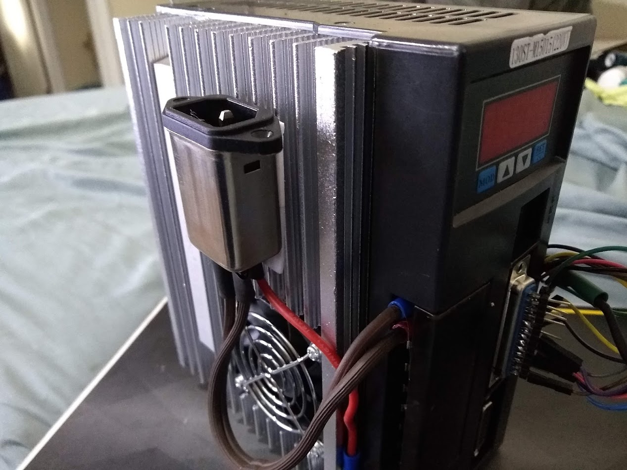

    Since you are using a DIY db25 cable consider mounting the TDD board on the side of the AASD with double sided tape or Velcro.
    The cable then only needs to be a few cm long..
    I mounted mine in that fashion. (I am not using the TDD board only because they were backordered at the time)
    Here is a link and picture of the EMF filter I use with great success.
    www.amazon.com/gp/product/B07L24HHXY/ref=ppx_yo_dt_b_asin_title_o00_s00?ie=UTF8&psc=1

    it looks like the encoder plug may not be a good fit - I will screw it down into place and check again

    Thanos is absolutely correct about the need for proper shielding of Motor cable and the Mains cable and the DB25 cable( unless it is only a few cm long) when using these servo motors.
    The encoder cable can be left alone as it is not a "Generator" of EMI but seems to be just a real good "receiver" of the others EMI
    I have been a electronic trouble shooter all my adult life and I have never seen such an electrical interference generator as these servos.
    The Motor cable is a massive source of EMI.
    The AC mains (220v) 0r (115) radiate like crazy also. Hence the EMI filter.
    If you would like to see this for yourself.. and you have an Android smart phone.. Install "EMF Detector" on your phone. It is free on Google Play Store.
    It is most enlightening:):)

    That would be the worst place to place the STM32 controller and exposed wire...
    Use a shielded db25 cable to move all emi sensitive electronics and wiring at least 4-5 feet away from the servo (or place them in metal enclosure)...

  17. Gadget999
    1,995
    12,174Coins
    +493 / 11 / -0
    Ok pushing the encoder connector down very firmly has fixed the error 09

    I doubt you need to touch the board...
    Have you tried changing Pn191?
    PN191 = 1 (Simulation of torque command direction - try 0 first)
