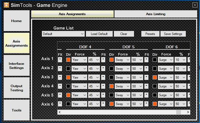

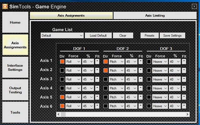

  8. value1
    Jan 9, 2011
    2,192
    Zug, Switzerland
    14,259Coins
    +3,361 / 12 / -1
    This I was told by yobuddy:
  9. Thanos
    Jul 6, 2017
    1,378
    Electronics Engineer
    United States
    2,911Coins
    +1,079 / 10 / -0
    Here are the complete settings for the interface and axis assignment:
    Best Regards,
    Thanos
