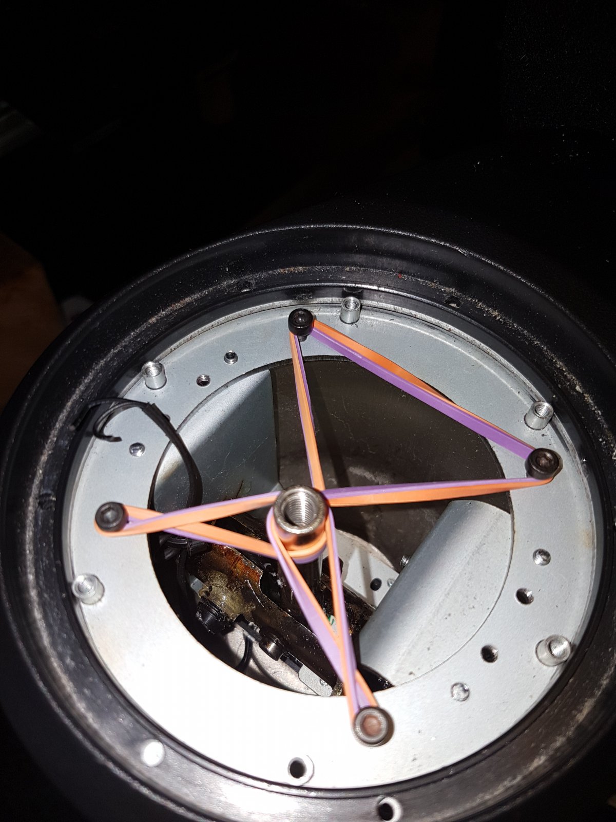

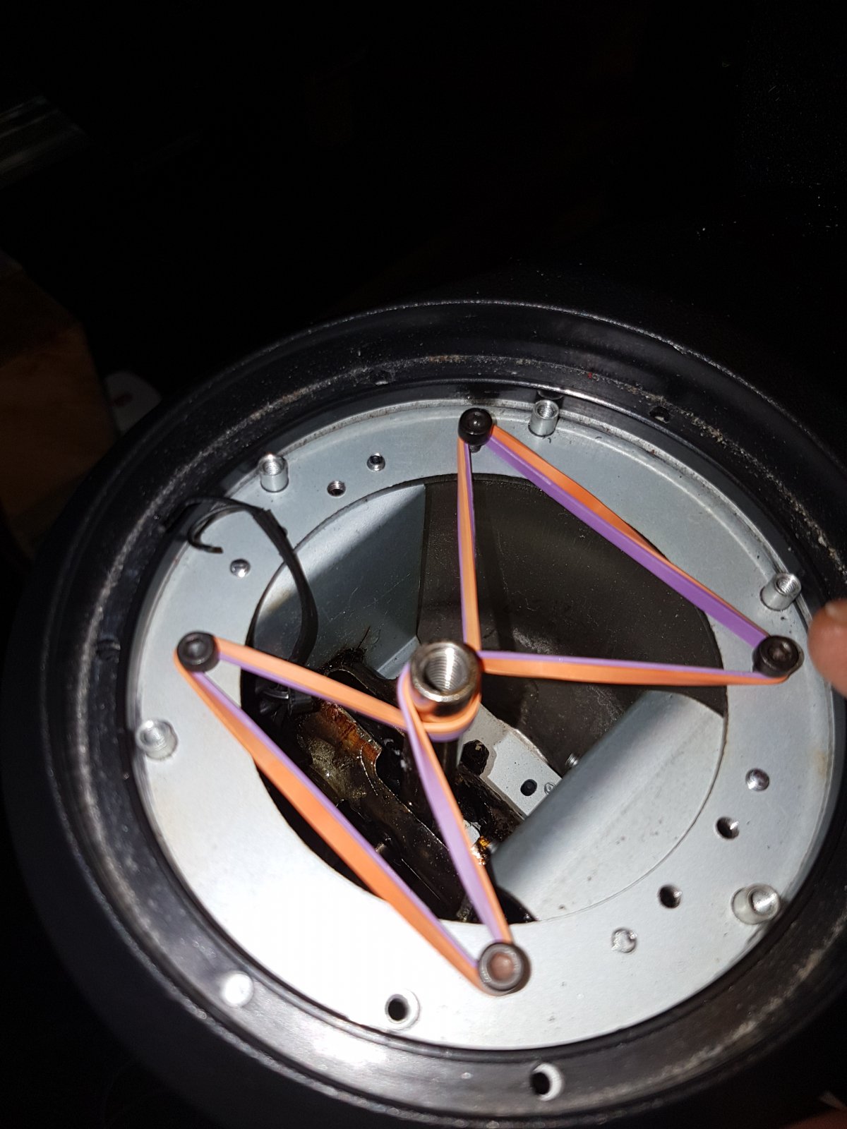

    Hi just a quick way to mod your th8rs

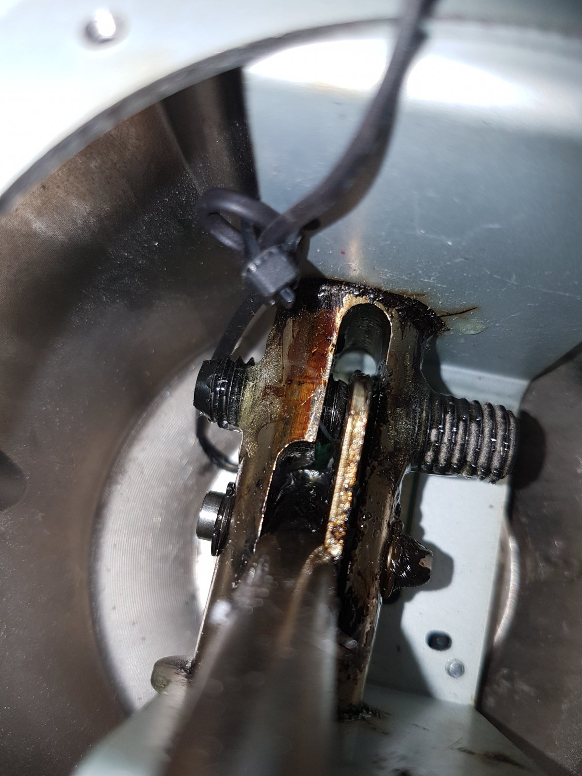

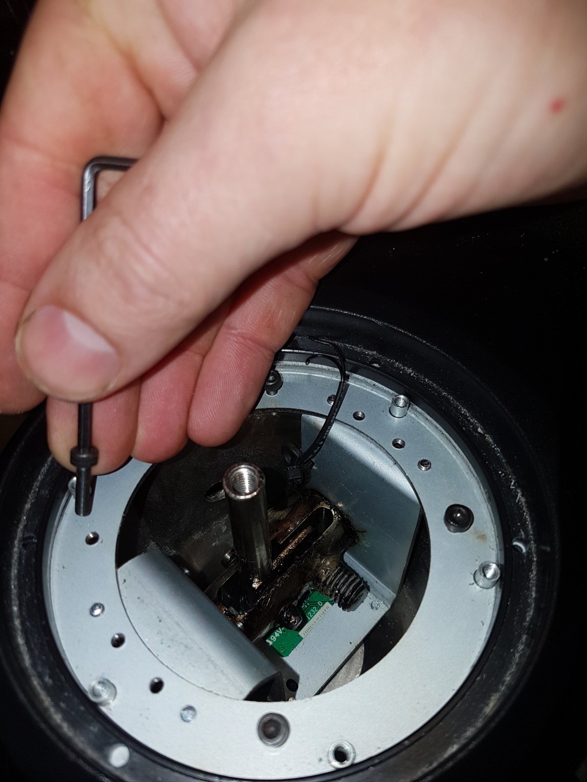

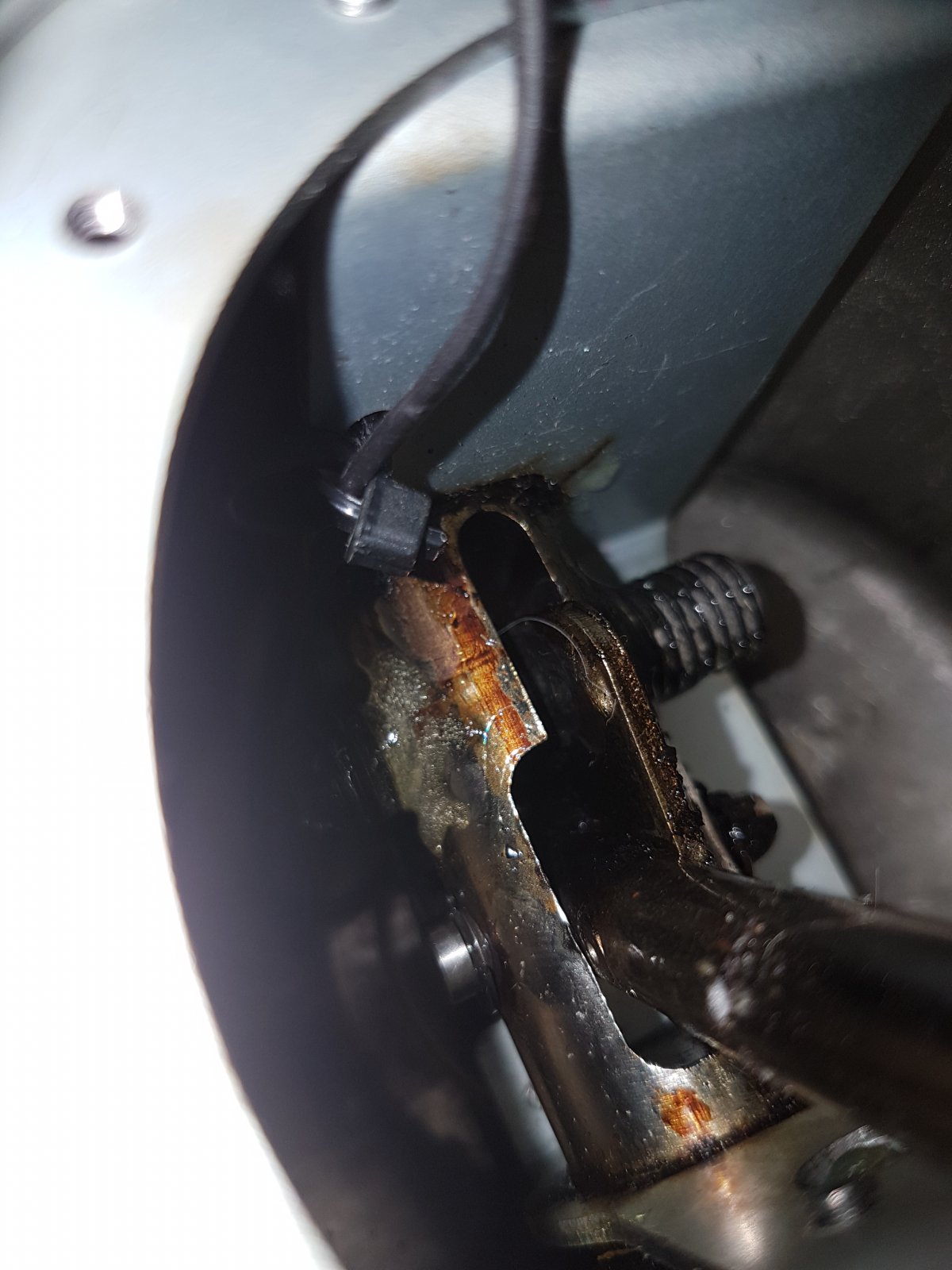

    This is the inside and theres a screw that comes with the th8rs you can turn to adjust feel.
    Now on the other side theres a threaded hole which will do the same thing.
    So add another balls spring adjuster and you can have double the control for feel.
    It notches the same in exactly the same hole.
    You can see the new one sticking out and you can also see it will stop the lever locator from bending as you can now balance to keep it centre.
    Now what else you can do here is buy diffrent grade ball springs to tune it even more see.

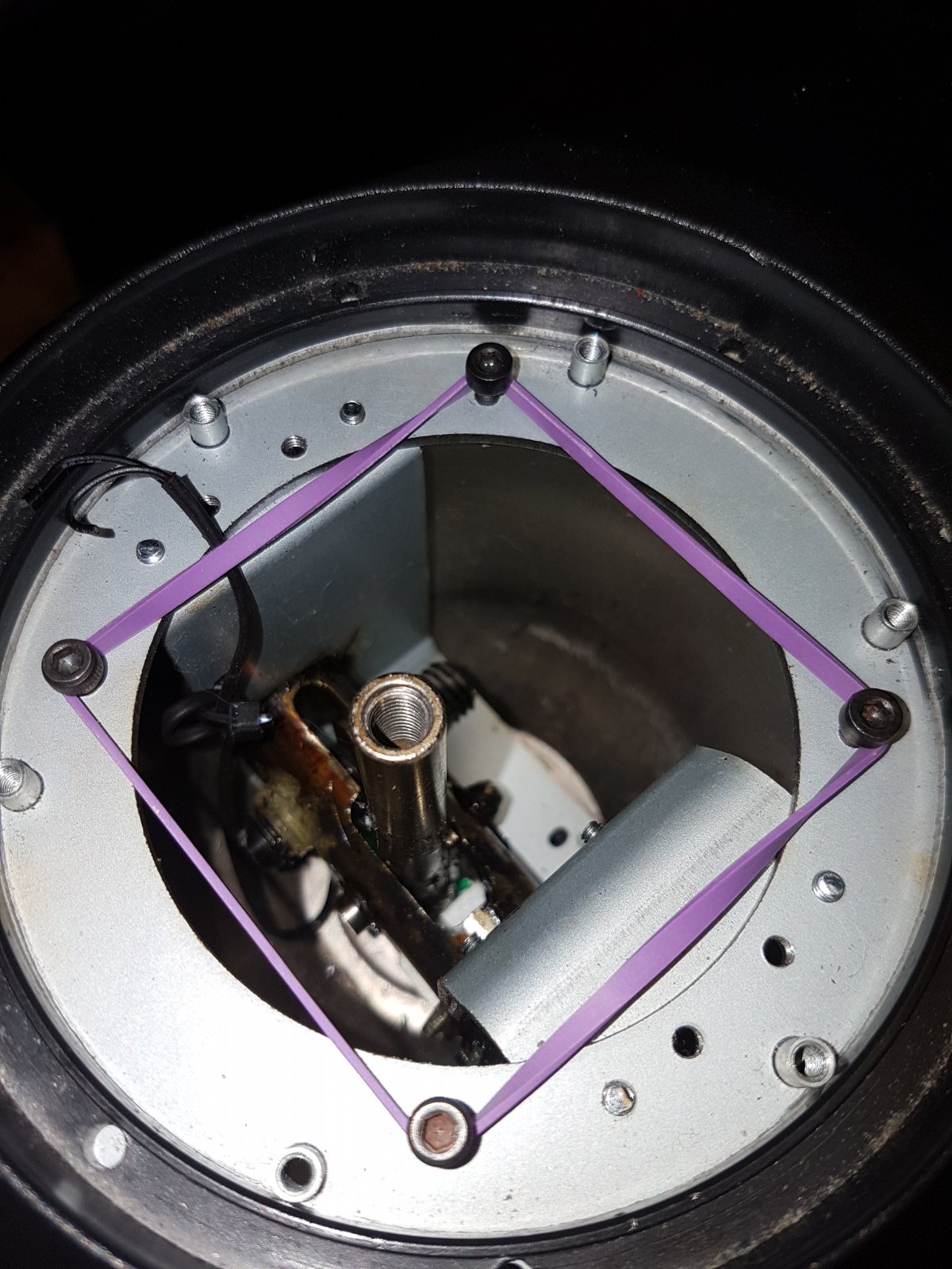

    Next you can add some tension to the lever.
    You can simply add some kind of elastic or large orings ect.
    Now the best easy way to do this is by adding screws to hole that are arady there.
    As you can se theres 4 you can fit.
    Now the cool bit to make this mod stand out from other mods.

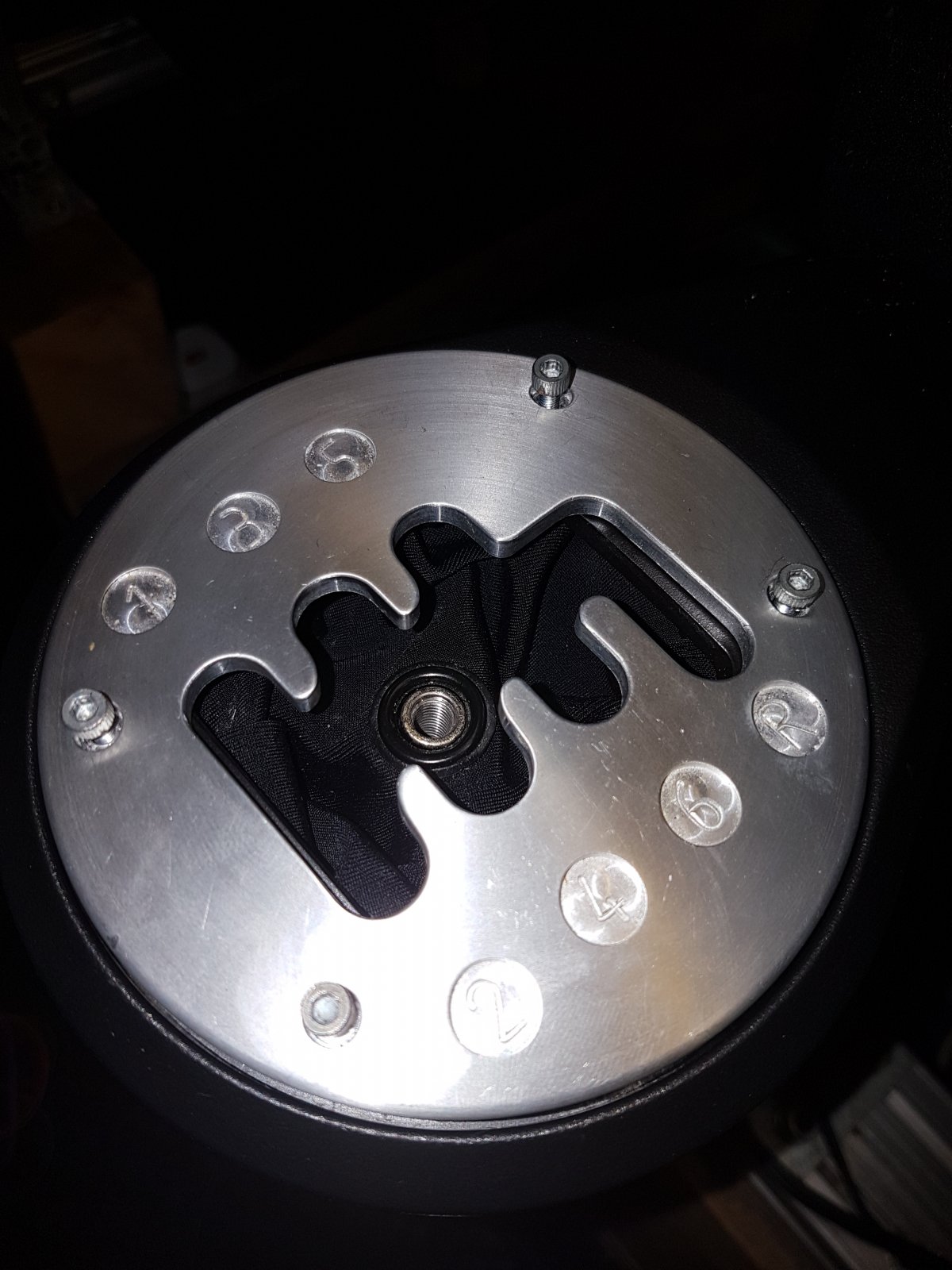

    A. Its done from just taking the top gates off.
    B. Its not so hard on the elastic so can be protected abit from rubbing and snapping.

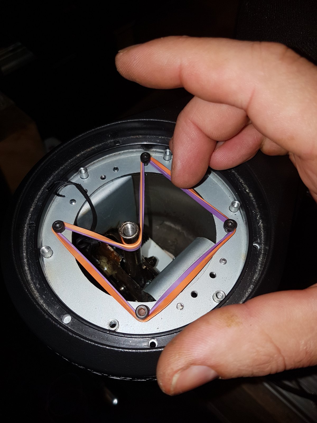

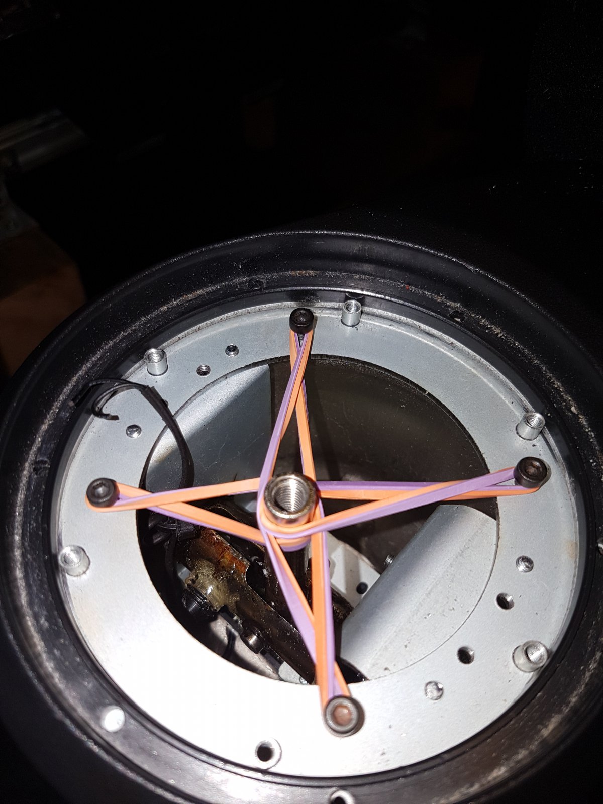

    Now add a band like this.
    This is where you can just keep adding bands depending on the feel you want.
    This will be trial and error and lots of different bands or what ever you use.
    The more you add then you might need small washers added to the screws to stop falling off you got a lil bit of room to play with but not loads.
    If you do need more space you could fit the screws from under and you have as much space you want but its a pain that way and fiddly.

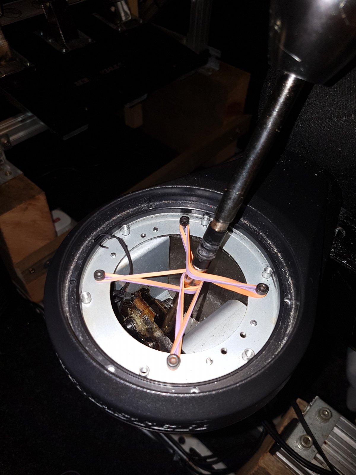

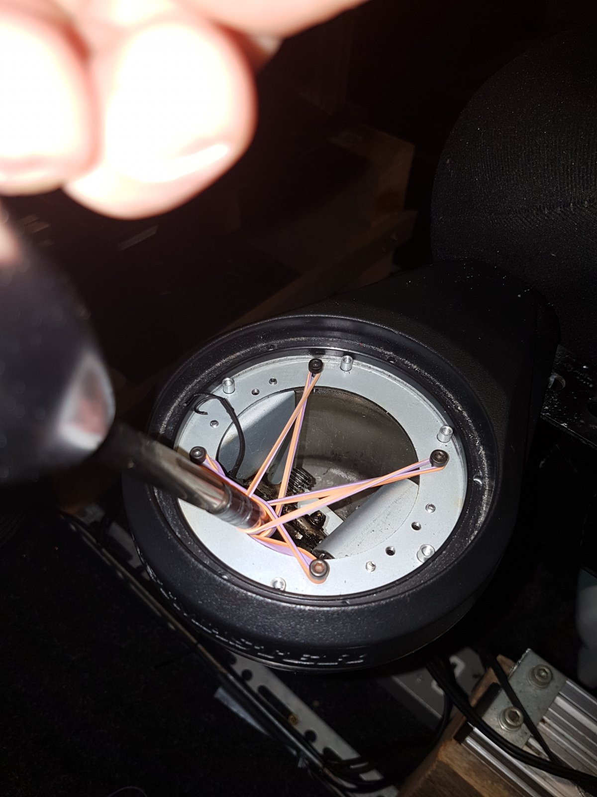

    Now all you do is put that bands over the lever shaft n its all good.
    Now this is where you could get serious and see its got more load one side to the other due to the placement of the screw and the stick having 8 gates.
    If like me you run 6 plus reverse you could just square the screws up to the centre resting gates to be abit more procise ect...
    But this is a very quick way to play n test.

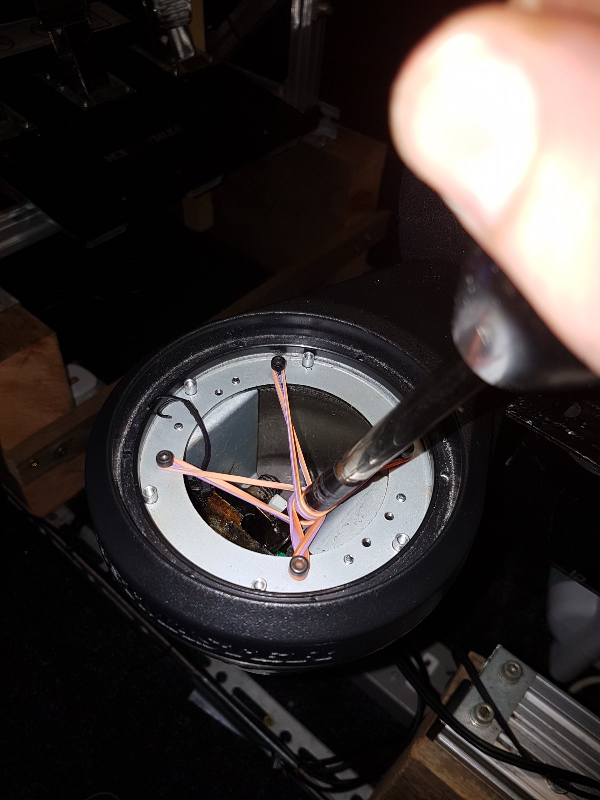

    The movement.
    To see how it works and what i mean about the screws and tension.
    See all fits back together as normal
    Hope this helps or give you more ideas or even find the perfect setup of what to actually use.
    This is just messing atm so not got it right as yet but soon as i do i will update with links to all the parts.
    Now what it does is pull the dust cover up abit higher so needs could do with a small washer below the plastic cover where the stick screws in then it will keep it abit lower if needed.
    Have fun everyone
    As another update you can possibly add some small very strong magnets to each gear via attatching to the gate plate.
    That way it should clunk in and out of gear aswell, it might be worth me trying this via 3d printing it with mount to put the magnets into it.
