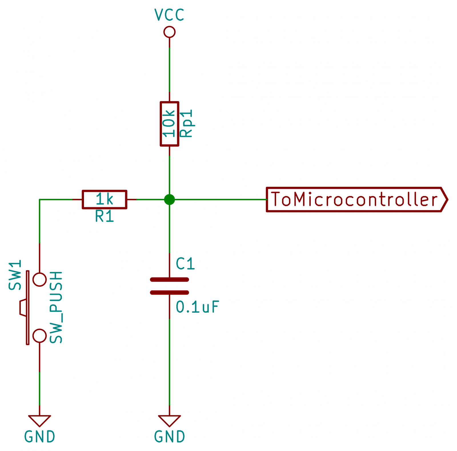

    Hi mate, i tried to write a piece of code for it. It catches button release, and randomly catches button presses on button A and B (but not for others), but i cannot put it into the function after release. I can change the state but i cannot direct it inside Switch/case. Do you think it can be issue of debouncing? would it help to add capacitors 100 nF? to make physical debouncing, if so where should i place them? just to replace resistors inside the scheme?
    the code is updated - https://github.com/darjusp/test/blob/master/Button.ino

    So the code should distinguish between long (more than 1 second) and short (less than 1 second) presses. This code is not written to detect when you release the button. Is rhat correct?
    I don't know how pins A and B catch random pulses? Does this mean it fires even if you don't touch the joystick?
    Hardware debouncing can be used but software should take care of this very nice.
    If you still want to debounce via hardware you can connect 100nF caps between inputs an ground (if you have pullup resistors).
    For this setup you shuldn't need extra resistors but they could be implemented.
    Here is a google image of an example schematic.
    You can try with the values given in the schematic but its best to recalculate them for your timing needs.

    Hey man, thanks it helped. especially to understand that i will need two additional components per button which is a bit too much :) So i will try to do debounce with software. I restructed my code https://github.com/darjusp/test/blob/master/Button.ino
