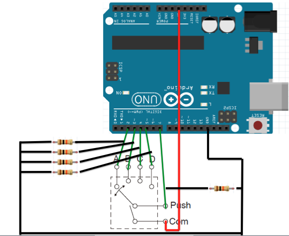

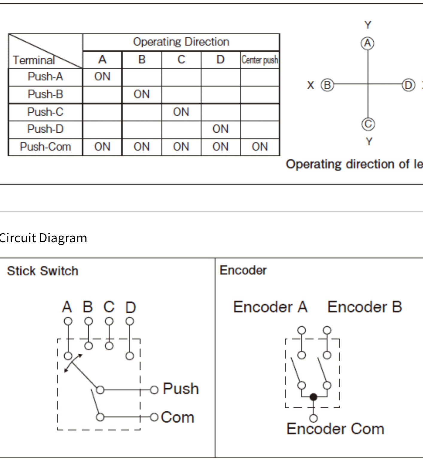

    Should be doable:) ok i will try to write you a sxript for testing... Do you have the encoders and a teensy? Wich teensy do you have? You said two encoders what is the other ones function?
    The first encoder you specified the keystrokes for direction turning, can you pecify keystrokes for up,down,left and right?
  2. narbi
    narbi New Member
    Feb 18, 2018
    7
    62Coins
    Encoders and teensy are on their way, should be here before the end of the week. I should be able to have some hardware ready next week end.
    Teensy LC.
    Only one encoder per teensy, as the purpose is the same, they only need to control 2 separate devices, it's easier that way.
    So one basic script is good, I will modify it for the second one changing the keystrokes, or keycodes, or whatever you will use.
    Push button : CTRL P
    Rotary clockwise : CTRL =
    Rotary counter clockwise : CTRL -
    Pad UP : CTRL N
    Pad DOWN : CTRL L
    Pad Left : CTRL SHIFT Left Arrow
    Pad Right : CTRL SHIFT Right Arrow
    Thank you for your help

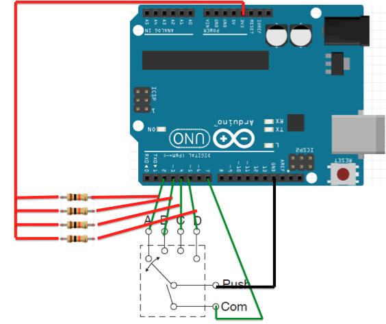

    I got it working the way I wanted, I just had to adapt your code to my needs, but with the help of the included examples and online help I figured it out.
    Working flawlessly in both different situations.
    Attached are both codes.
    I changed the wiring too, COM + Enc-COM + Ground go to pin 0, push button to pin 2.
