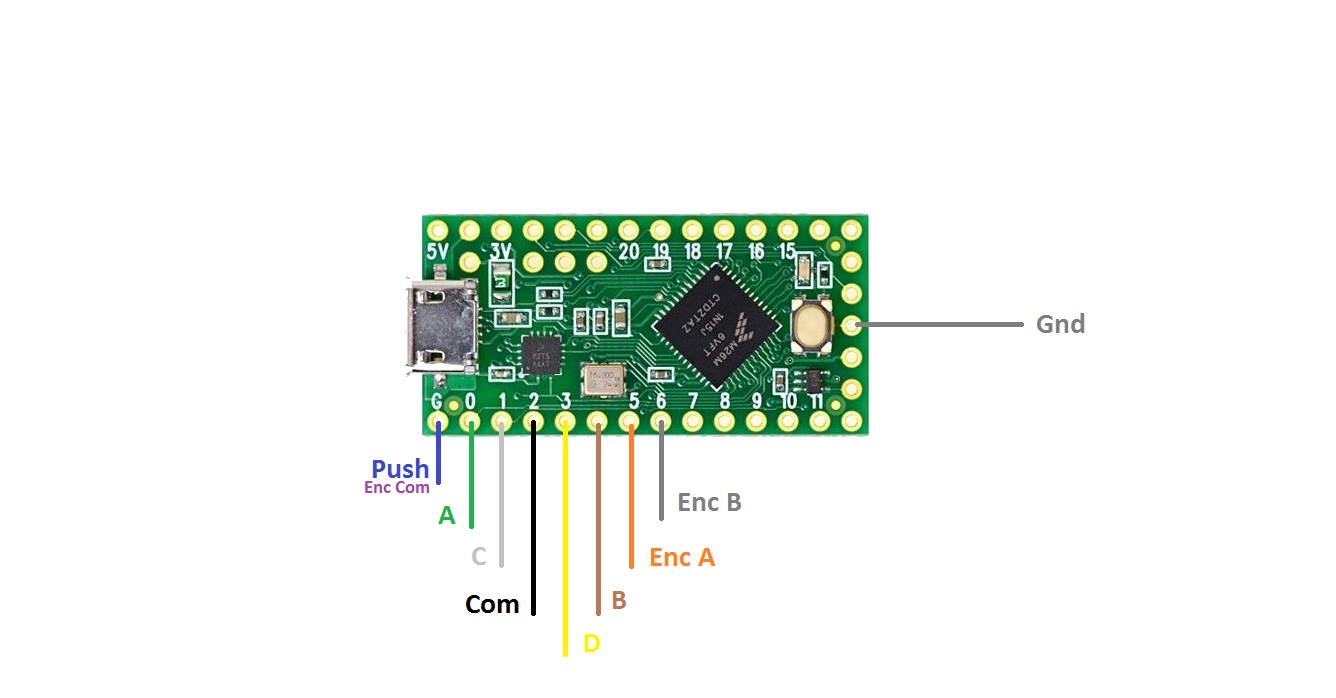

    You have to know something... I don't have a D pad (never did) so I don't know hot you have it wired... I only know you have an encoder and a Pad that has 5 buttons inside one for push in (like enter), left, right, Forward, brackward...
    So in order for me to help you ( I love to do that :) ) please show me some pictures and maybe how it is wired so I can better understand the situation ;)
    And did you download the modified version of the program?
  14. tadythefish

    OK I am looking at the pictures that you have provided on the PJRC forum and the datasheet off the encoder.. can you post a picture of the rear side of the encoder?
    I see how you connected everything...
    Teensy PIN--------- Wire color ---------- Enoder pin
    0 --------------------- Green ----------------- A
    1 --------------------- Grey ------------------ C
    2 --------------------- Blue -------------------- Push
    3 --------------------- Brown ----------------- D
    4 --------------------- Yellow ------------------ B
    5 --------------------- Orange ----------------- Encoder B
    6 --------------------- Red --------------------- Encoder A
    GND ---------------- Black ------------------- Ground terminal
    GND ---------------- Purple ------------------ Encoder COM
    Is this correct?
    If this is your wiring then I have assigned the wrong inputs to the code.. here is the corrected version please try it and report back
    NOTE: This shoul work as follows....
    When you PUSH IN button 1 should come on (windows test screen for joystick)
    When you push forward (button 2 or 3 or 4 or 5 should come on, one of them)
    When you push backward (button 2 or 3 or 4 or 5 should come on, one of them)
    When you push left (button 2 or 3 or 4 or 5 should come on, one of them)
    When you push right (button 2 or 3 or 4 or 5 should come on, one of them)
    I can't exactly tell you witch of the buttons come on since I don't know the orientation (how you have it mounted) of the encoder. But basicly this is how this code works. And we can make aditional changes

    No I have it as follows Not sure if you need to tweak it again,
    2--------------------- Brown -------------------- B
    3 --------------------- Yellow ----------------- D
    4 --------------------- Black ------------------ Com
    5 --------------------- Red ----------------- Encoder A
    6 --------------------- Orange --------------------- Encoder B
    GND ---------------- grey ------------------- Ground terminal
    GND ---------------- Blue/Purple ------------------ Encoder COM/Push
  16. Nick Moxley
    17,054Coins
    +2,504 / 30 / -2
    Pin 2 or Brown is the pin that im seeing that different activity on, If i press the D pad all the way, It lets go of the D pad number press, but sill unilized the "push" button number. which isn't what i want but that might be because of the code need changing....
    Again I Very much appreciate the help with this Tady, I owe ya one. ;)

    Try swapping wires Black and brown...
    PIN2 is the pin that COM needs to be connected...
    That pis is different from pin 0,1,3,4
    The code is written that if only pin 2 is LOW (push in) you get a signal.
    But if you push forward you said you get a signal forward AND push in... So i have edited the code to turn off the PUSH in signal if you press forward,reverse,left or right...
    So it is absolutley mandatory that the signal that is active (when low) when pushed in is connected to pin 2 of teensy and forward,backward,left and right are connected to 0,1,3,4
    So try swapping the Black and brown wires
  18. Nick Moxley
    17,054Coins
    +2,504 / 30 / -2
    teensy-lc.jpg YOU ROCK @tadythefish
    That works exactly like i want and just like you said swapping the brown and black did the trick. I cant thank you enough man, I seriously owe you a favor.
