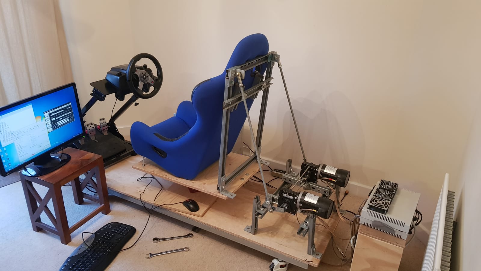

    Bit of an old thread revival here!!
    I have decided to renew my old simulator as it hasn't been used for so long! The plan is to simplify the design and to try and make the thing a bit more compact as I am quite short on space now.
    I've decided to remove the traction loss axis, upgrade the motors and re-do the mounting of the pedals and steering wheel.
    Here is a pic of progress so far!

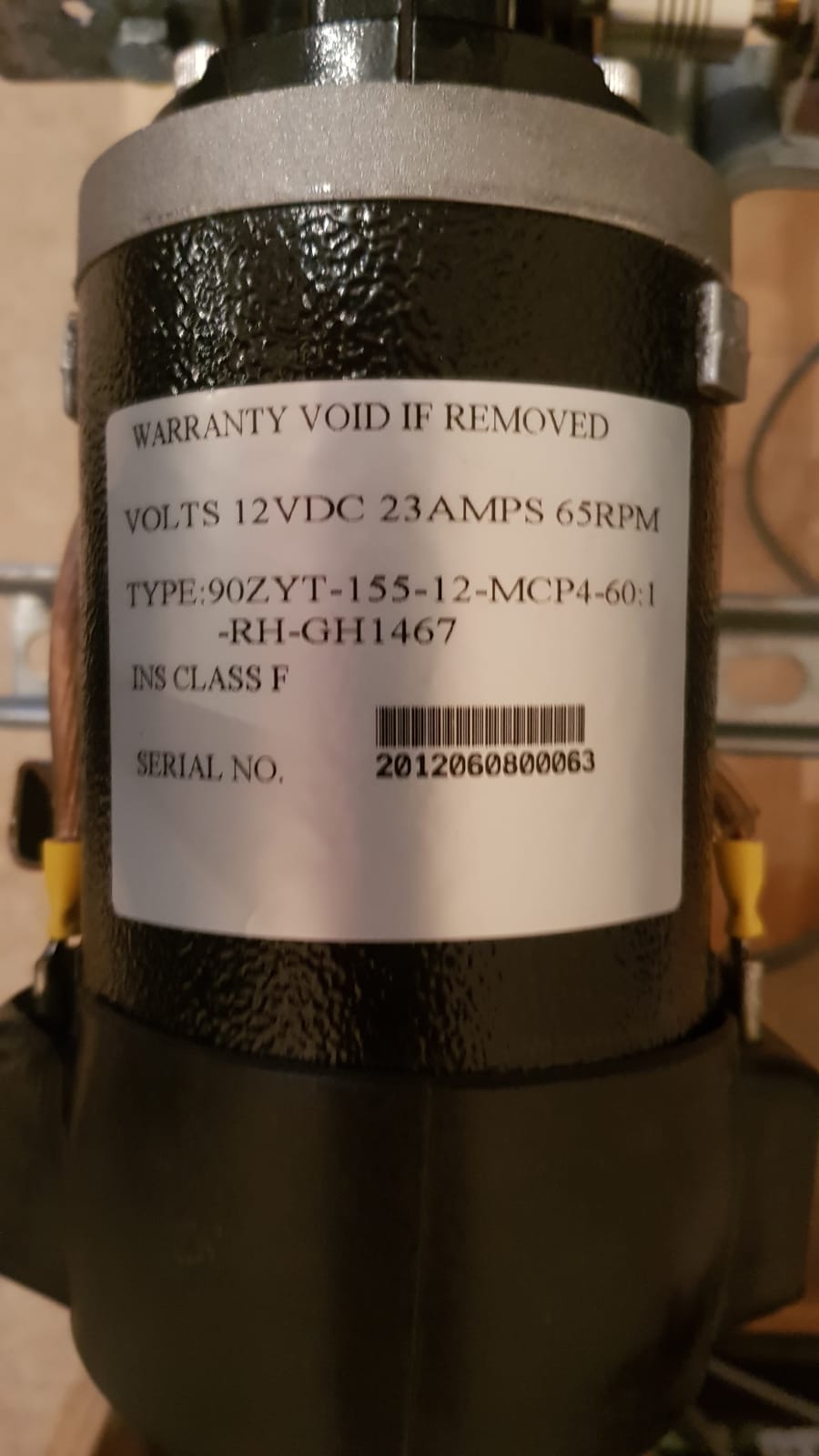

    And here are the new more powerful motors
    I think I may need to upgrade the JRK12V12 motor drivers to the Sabertooth 2x60 as am suffering from the dreaded motor driver error drop-outs.
    More updates to follow!

    Hi Lee,
    I purchased my motors from a company called motion control products. I got them from their Ebay store
    Specs are below:
    12VDC, 23Amps, 65 RPM
    90ZYT-155-
    MCP4 60:1 gearbox
    https://www.ebay.co.uk/itm/Brushed-...290092?hash=item59358974ac:g:CxQAAOSw6vBdoHzi
    Hope this helps!
    Simon

    Here's a quick initial video of progress so far. Profile is only running surge, swap and heave so far. The new motors feel much nicer!

    Here's another video with the projector

    Nice looking job there, and as long as it moves well, you are set.

    looking nice and simple.
    try do build mine also from wood...
    could you please post a detail picture of your drive shafts? are they build from 2 L rods?
    that will help me building...
    thank you!
