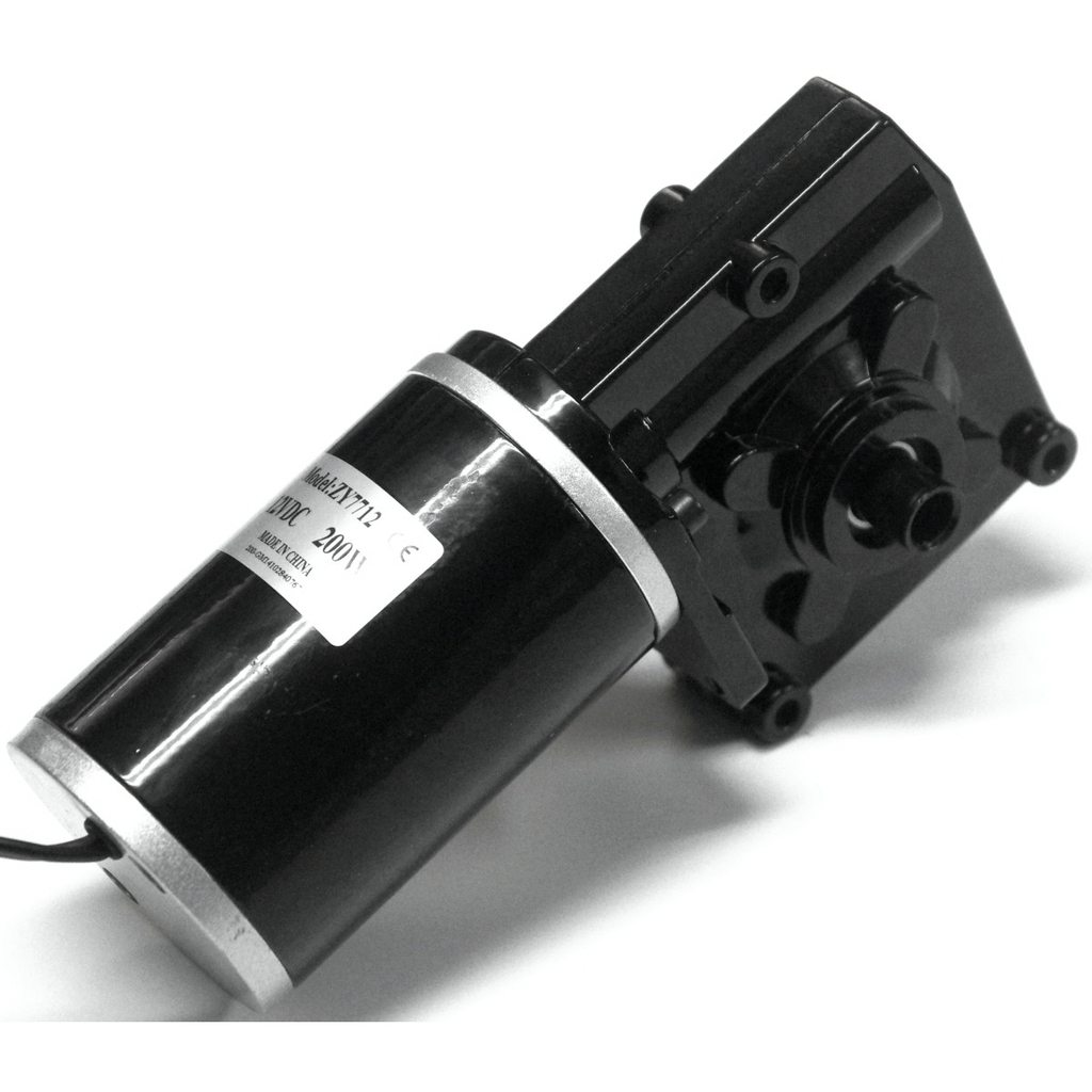

    Now for my build I had originally decided to go for wiper motors but after looking into them and what Id personally like out of my rig I decided against it. Instead I will be using a motor that Noorbeast showed me, its a 12v worm drive motor that he used in his DX Racer build.

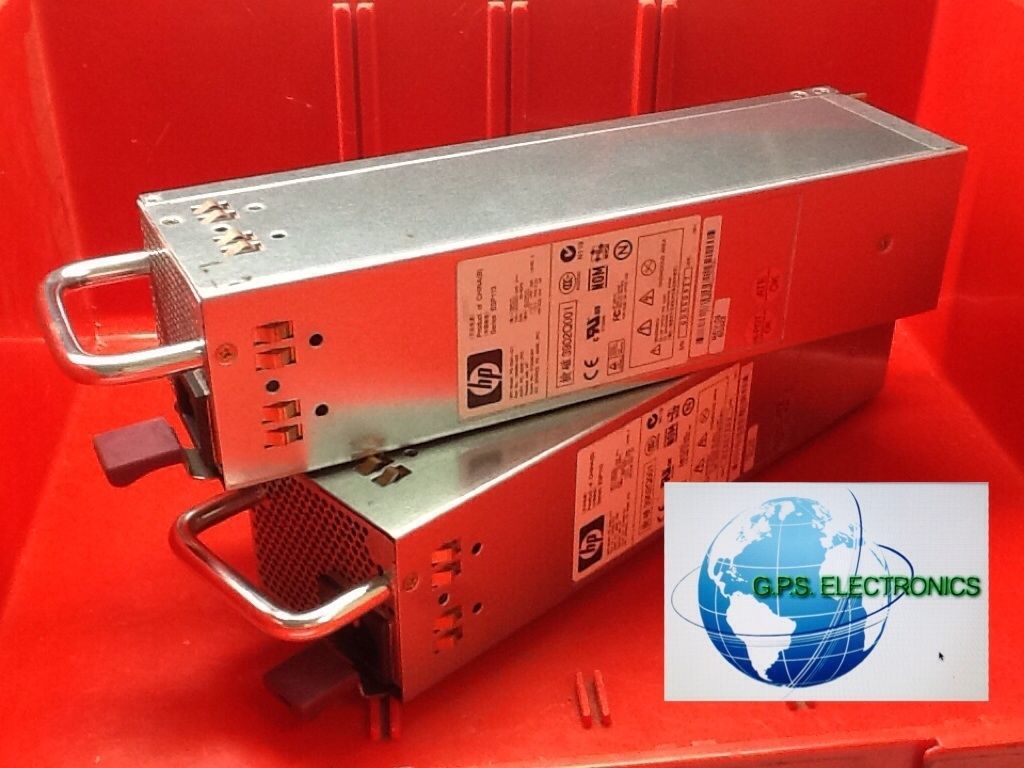

    Moving on from the motors I then needed to figure out what would power them, I cant remember who showed me the Server power supplies but know I am grateful and managed to find a good buy for a lot of 2 hp DL380s for under 40$ shipped!

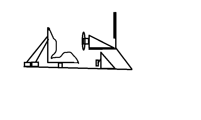

    first I will show a crappy picture I did in paint showing kinda how id like it to look, Id love to do it in some sort of 3d program unfortunately I do not have any skill at stuff like that but i'm awesome at building stuff haha.
    id like to make this rig easily able to be converted to a 3DOF cause eventually id like to add in traction loss cause I love drifting and do it myself in my spare time.
    if anyone can help make this more of a 3d render please do haha!
    next are the motors I will be using,

    The Worm Drive Motor 12V/24V 200W, 180 RPM, 20Nm Torque are perfect for this type of sim. There used to be a Canadian Ebay seller that had them, but is now selling the remainder at $900, which is just ridiculous :eek:
    But do have a good look around for similar specs from local suppliers, as these types of motors have been used for crab pot pullers, truck tarp pullers and other similar tasks.
    Many current members are scouring the globe for local reasonably priced DC motors.

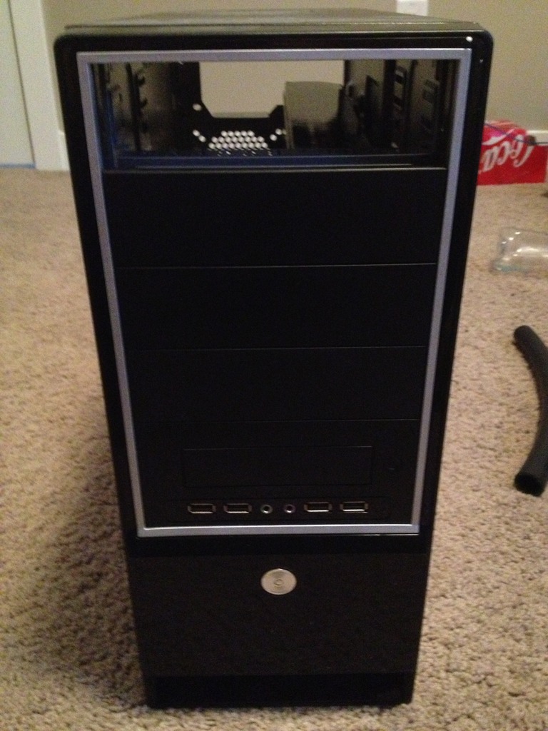

    well another update for the night, scored a second computer case to help run the rig :) total cost into my rig so far not counting the seat at all because that was bought for other intentions, is now only 43$!

    Try to avoid server PSUs, they are generally cheap because they sold 2nd hand because they are at the end of their service life.
    LED power supplies are new, cost more, and more reliable.

    even if that is the case @bsft at 37$ shipped for 2 I am not going to be too upset if one does die on me, I do not need super fancy gear I just want it to work and be able to say I succeeded in doing so. after version 1 is complete there will always be room for it to grow and improve and trust me it will definitely get upgrades. the wheel set I have right now is only a logitec G25, now thats not a bad wheel at all but its still not ideal but it was a great entry level.

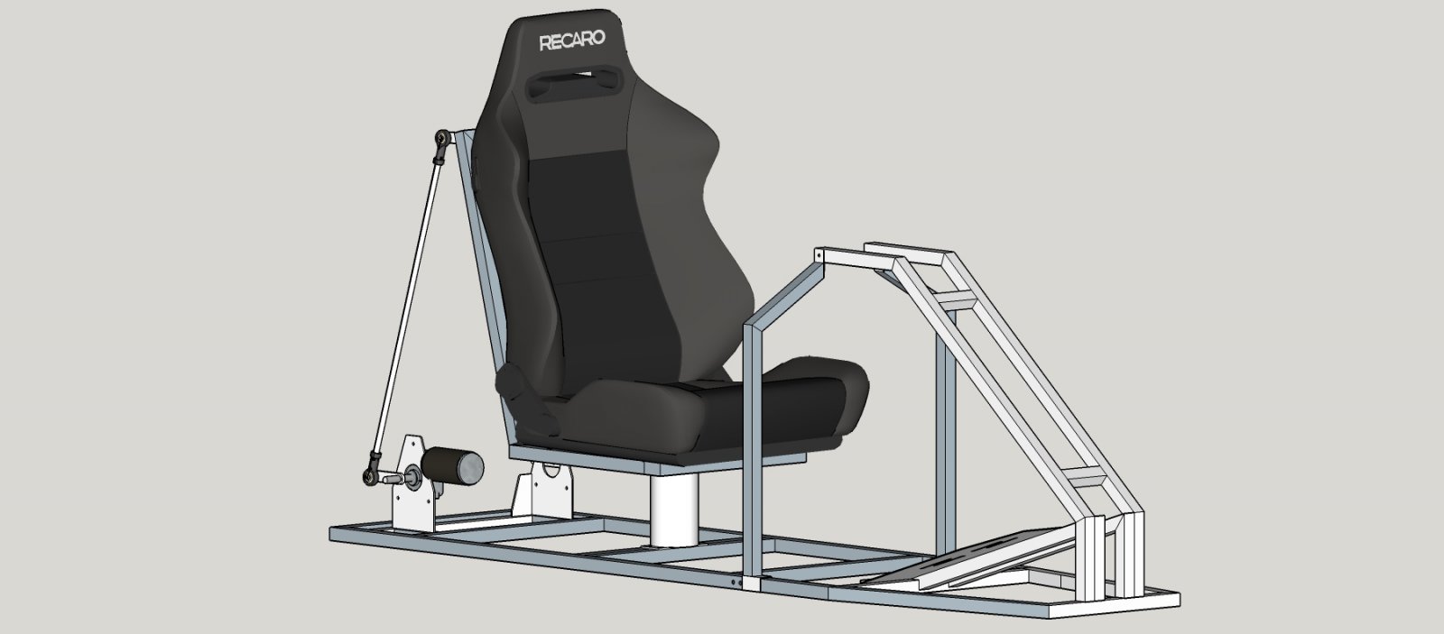

    Model , something like this -
    Built the rear recently for @madgino its still a work in progress, lol if I can get him off it or he gets away from work. We will dress it up soon mate.
    Built to adapt the front of a Next Level - GTPro and reuses the original seat back in its original position. A Static Sim Conversion.

    @eaorobbie that is basically exactly the sim I would like to build for myself :D

    Its a basic concept for a std seat mover built to replace the NextLevels joke of a motion base, with high speed motion from DC WormGears.
    Happy to discuss possible plans, but wont release them hear in fear of all the commercial spies we have at present.
