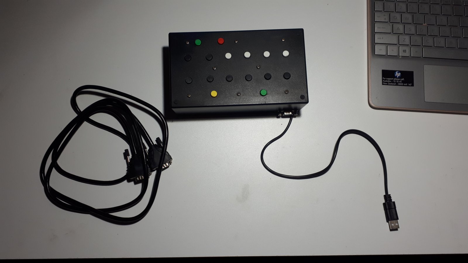

    I built the button box a few years ago and is rather simplistic it has 16 push buttons most are wired to a xbox 360 wired controller, I had intentions of going the arduino route with it at the time but wanted something quick and easy.

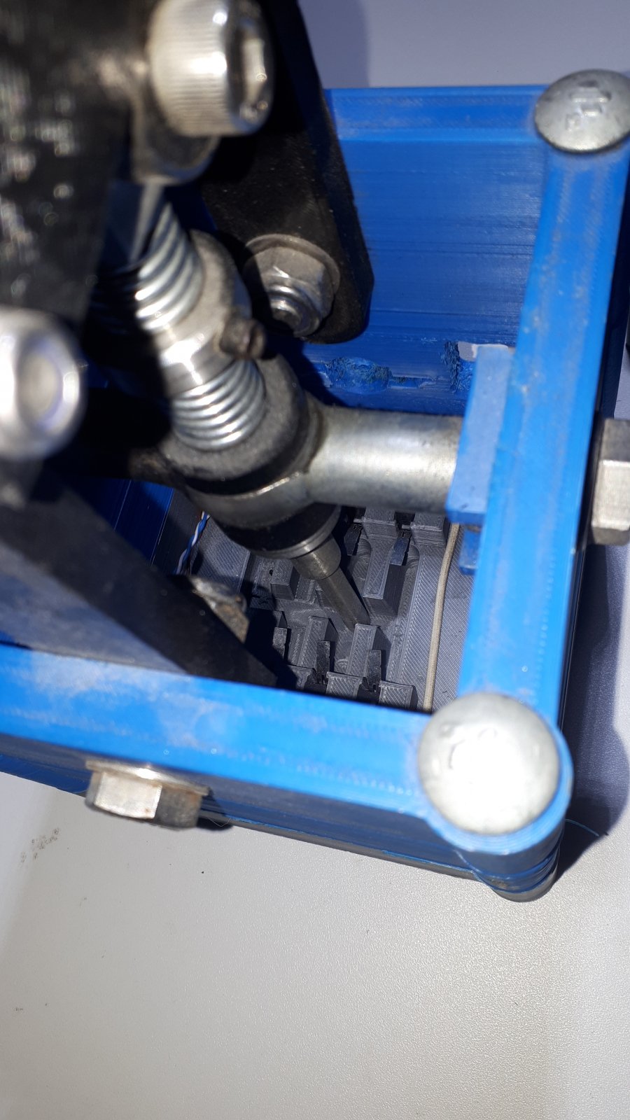

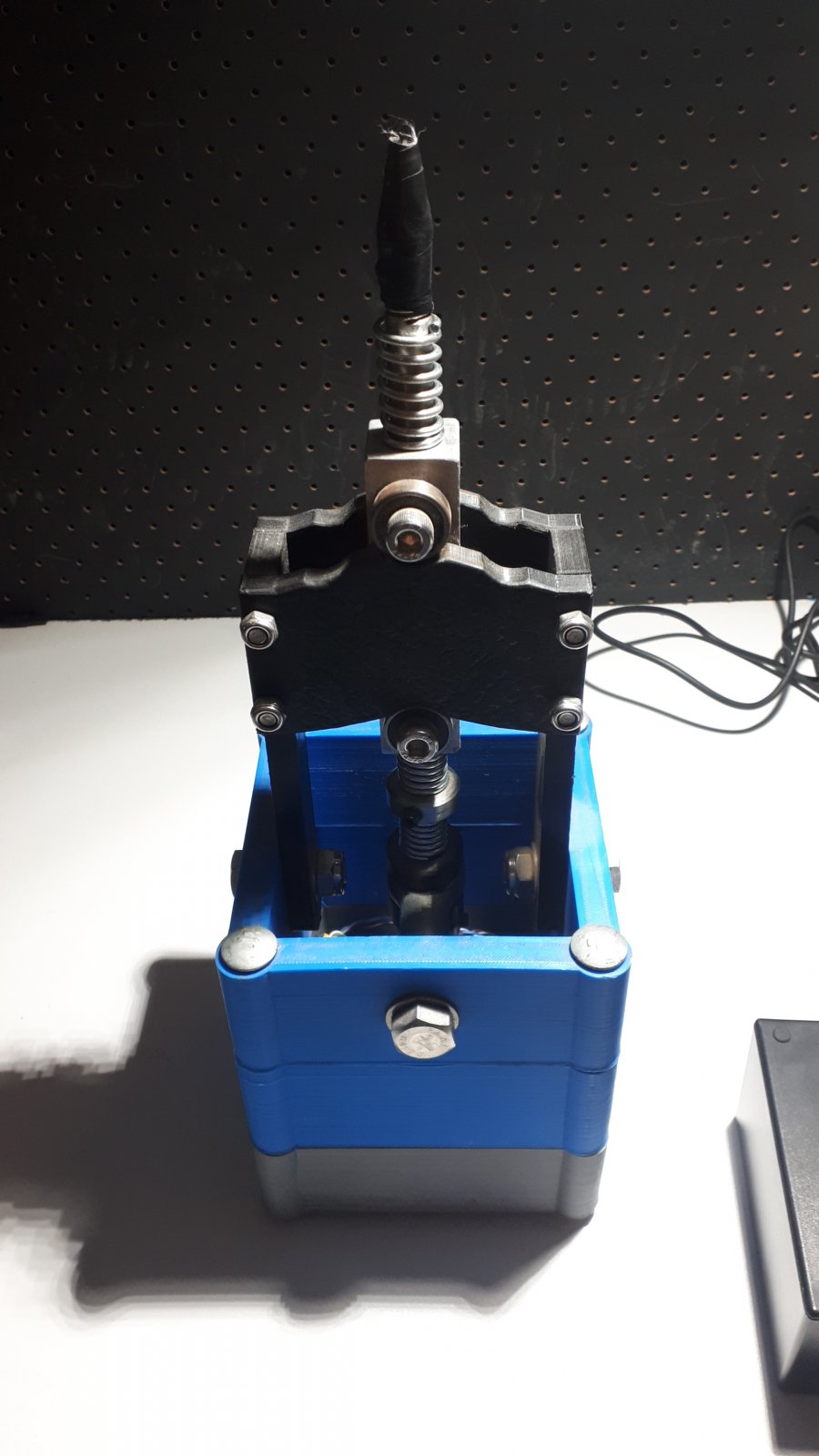

    The h pattern/sequential i have been working on it off an on for a few years i think the h pattern side of it was from a member on here, i will confirm before posting it up to make sure i give them credit for there part of the design, Its a little different in its workings, The H gateway is on the bottom and simply changing your ball type shifter knob to a sequential stick style knob changes the way the mechanism works to either retain a gear position or return to center, a Simple slip on bracket stops the side to side movement,
    I have designed it all on cad for 3d printing, i'm up to the wiring stage for testing and still need to get my shifter knobs sorted which isnt a biggy,
    Currently my button box, My diy handbrake and my Diy stainless sequential only shifter run off the xbox controller, Problem is some games dont let you keybind both the controller and wheel very well, So time for an arduino upgrade!

    Here's some photos mate, once the shifter is done i will probably do a little write up in my upcoming build thread
    Any questions feel free to ask!
