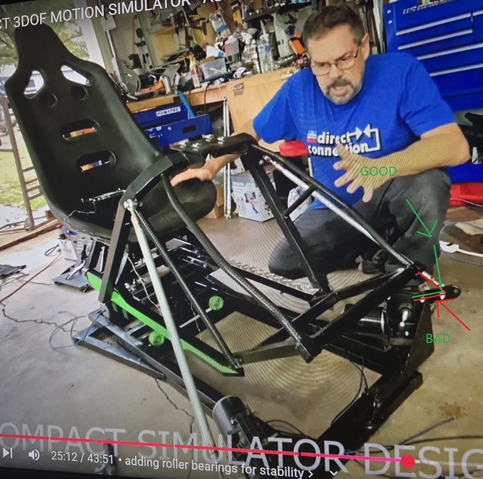

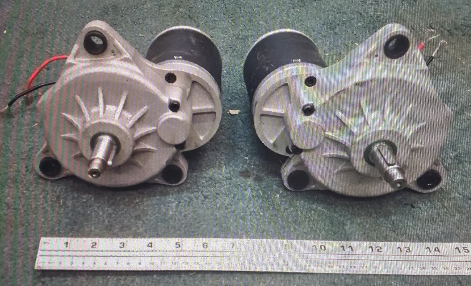

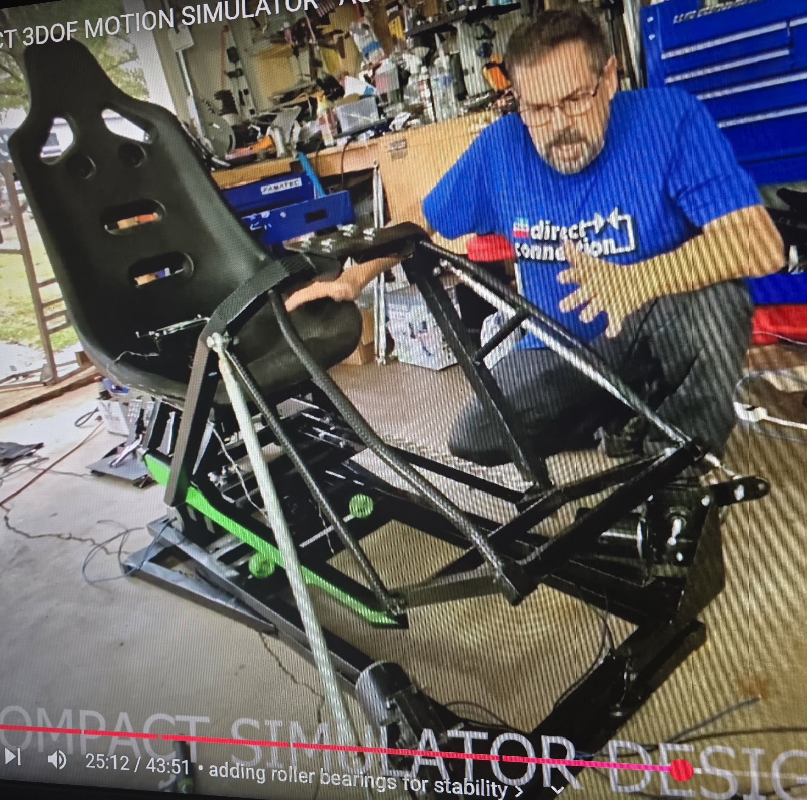

    I'm planning to build a 3DOF front motor design, similar to the picture but with my own touch. I will probably be upgrading the lower and middle frame to 2 inch by 8 inch lumber to make it stiffer due to the wheelchair motor mount, and everything else 1 inch 16 gauge steel square tubing. The wheelchair motors I have are 18:1 gear ratio, 24V, but I'm planning to run them at around 26V. The question is, how wide should I make the upper frame connected to the seat since my wheelchair motors have an 18:1 gear ratio? The original designer used a 16 inch width due to the limited steel tubes but I have plenty at the moment. Would you recommend going bigger, smaller, or keeping it the same? After using the calculator here, it kind of got me more confused unless I was doing something wrong. The plan is to use the sim rig 65% flight sim BMS, VtolVR and 35% racing. Would you suggest making similar angle rods or differently?

    Not a criticism of DMax, just a design related observation, independent of materials used or dimensions, a lever is most effective at 90 degrees and the greater the distance from the pivot under the seat to where the rods connect the greater the inherent design leverage, and the less strain on the motors.
    In other words, if the motors are mounted near your feet having the rods connect near your feet, rather than knees, has greater inherent design leverage.

    A bit this DMax design does not fit for flying in BMS
    see this design
    https://www.xsimulator.net/community/threads/diy-3-dof-inspired-by-dof-reality-h3-model.18273/
    much more compact
    I had two similar for flying (wooden and metal ) and this layout for flying with motors at the back was great.

    I have 3 identical motors, the same motors that DMax used in previous build wheelchair motors. I posted a picture of the motors in the first post. I didn't get a chance to measure rpm yet but from a quick glance they are 18:1 Why do you think motors in the back design is better for flying? The design looks great but I don't think my motors will have enough torque for the design.

    Please provide a link to the DMAX video showing your example.
    Generally, in the arrangement shown by Dmax,
    the motor-arm arrangement is inefficient (red lines in the diagram).
    The angle between the arms and the rod should be 90 degrees when the platform is at rest (green lines in the diagram).
    The platform I linked to is modeled after the DOF Reality H3, which uses motors with a power of about 200W.
    This is how you fly on a platform with two 250W motors at the rear.

    Here is the video to the motors that I'll be using. Please skip the video past 16 min

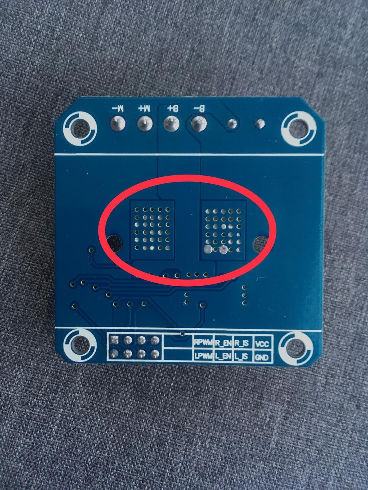

    After checking IBT - 2, I noticed the issue why some of them are breaking and some are working. The heatsink cooling design is a flaw. In order to make them work, you must resolder the chip, scratch the backside of PCB solder mask. Apply thermal pad and then a heatsink. You can even use 2 heatsinks on each side. See the picture, heatsink cooling the solder mask instead of cooling the chip. I placed the order from Aliexpress for IBT-2 and I'll let you know, how it works out.

    I have to worry you, everything you described about modifying the IBT2 cooling has already been tested, unfortunately it does not help :(. IBT2 with modified cooling and two heatsinks still break, it's really a waste of time to go to the trouble with them.
