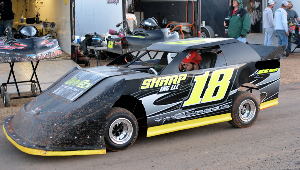

    We will be using one of these cars for the rig. (Made by Sharp Chassis.) A race ready car, with the driver, is approximately 930lbs. We will be able to shave significant weight from the car as it will not have a motor, suspension, fluids, etc. Our goal is to create a sim rig with a large range of motion with regards to traction loss to mimic dirt track racing.

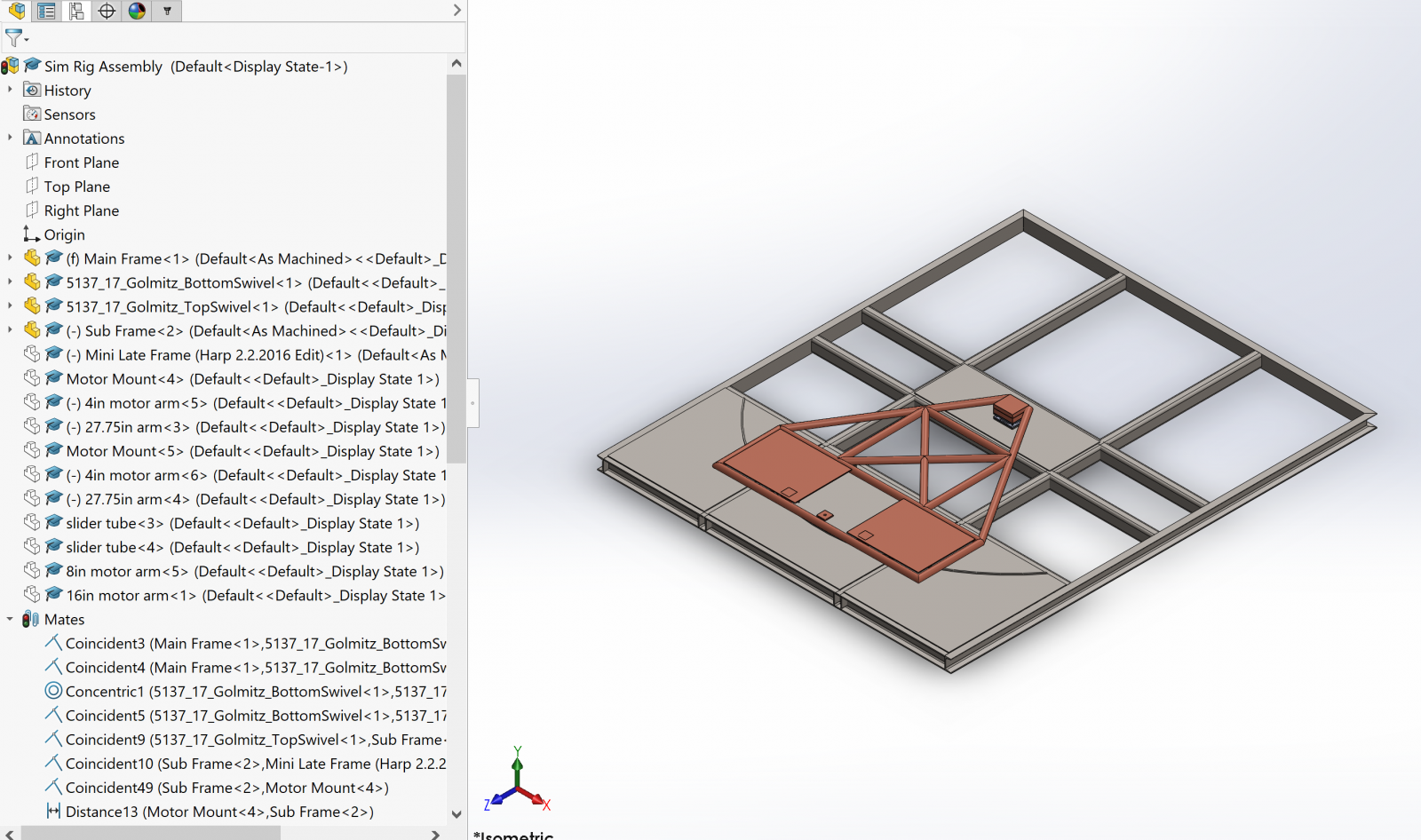

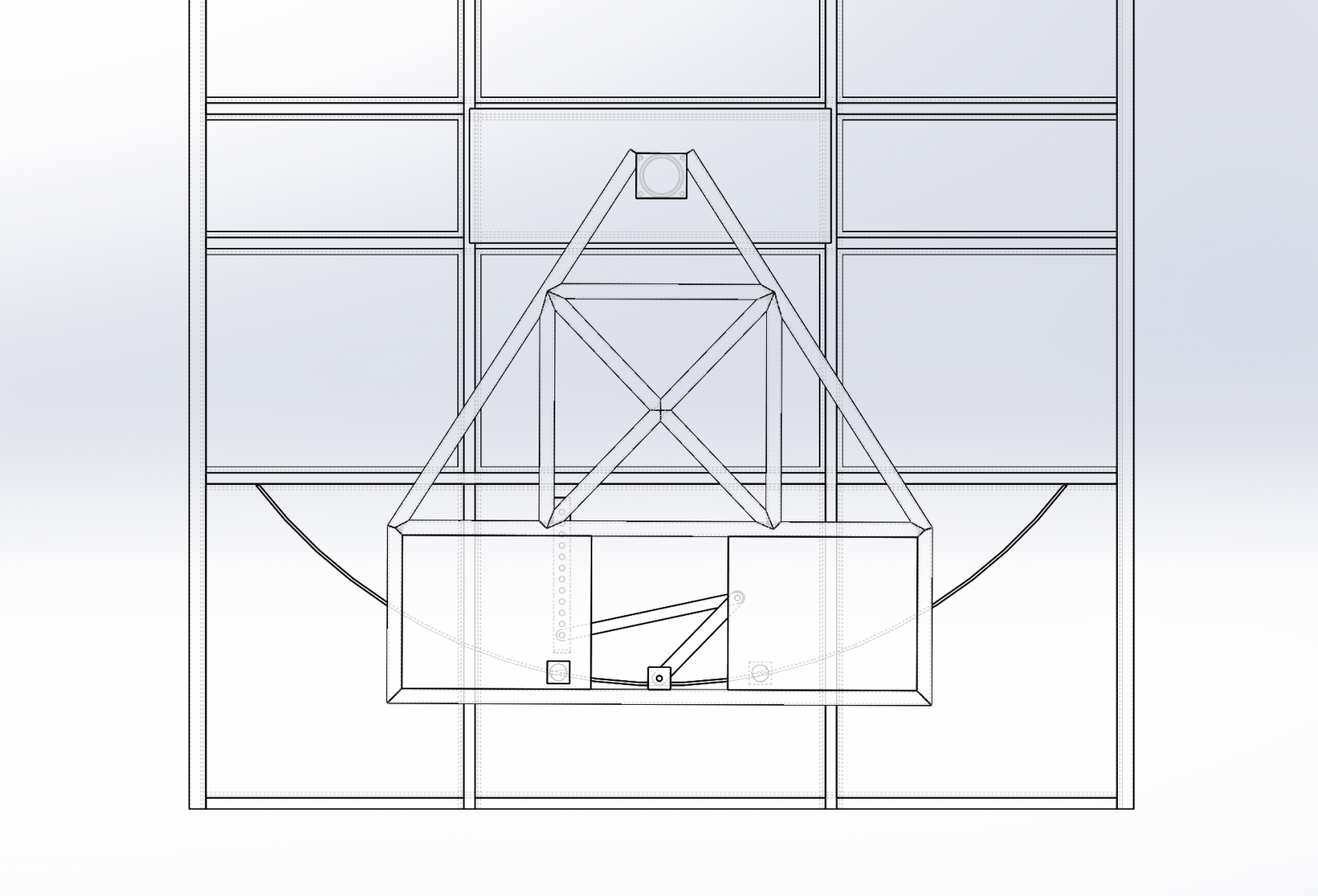

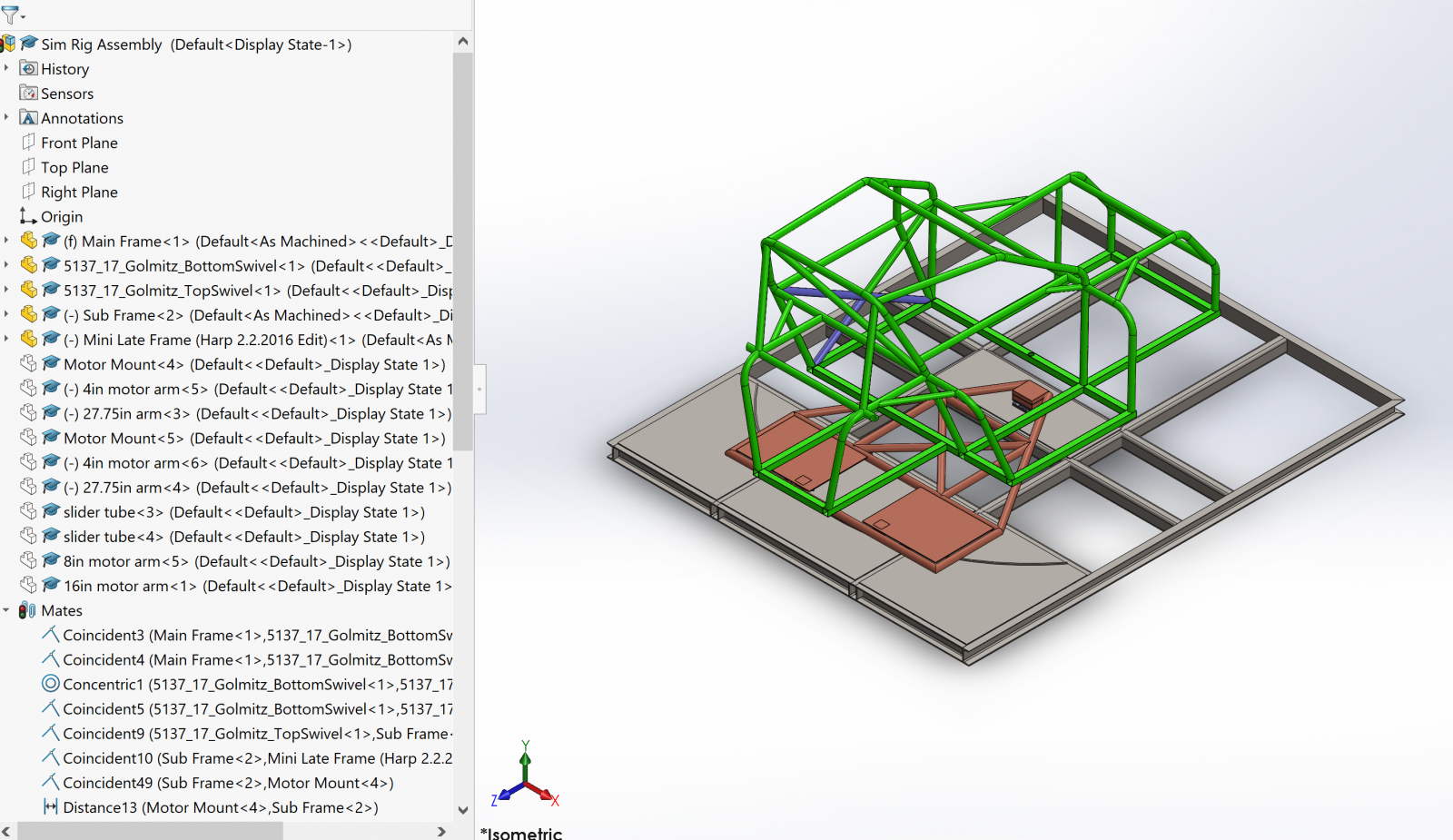

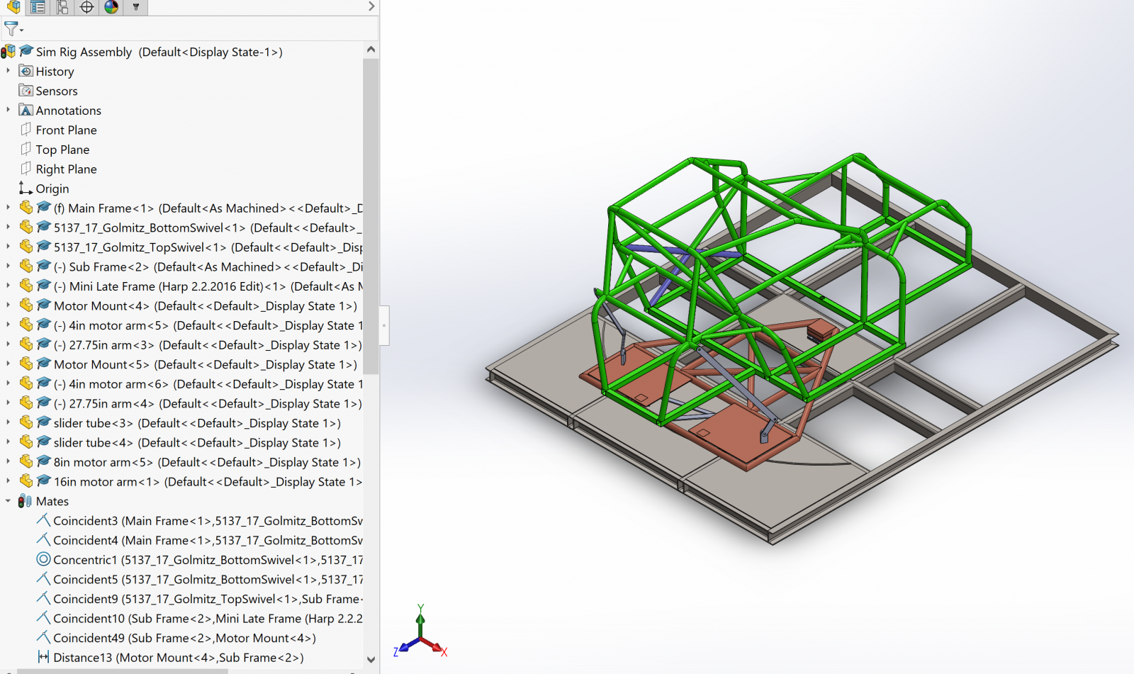

    With hurricane Irma hitting the eastern United States, school was cancelled for a good while. Here are some updates on our progress.

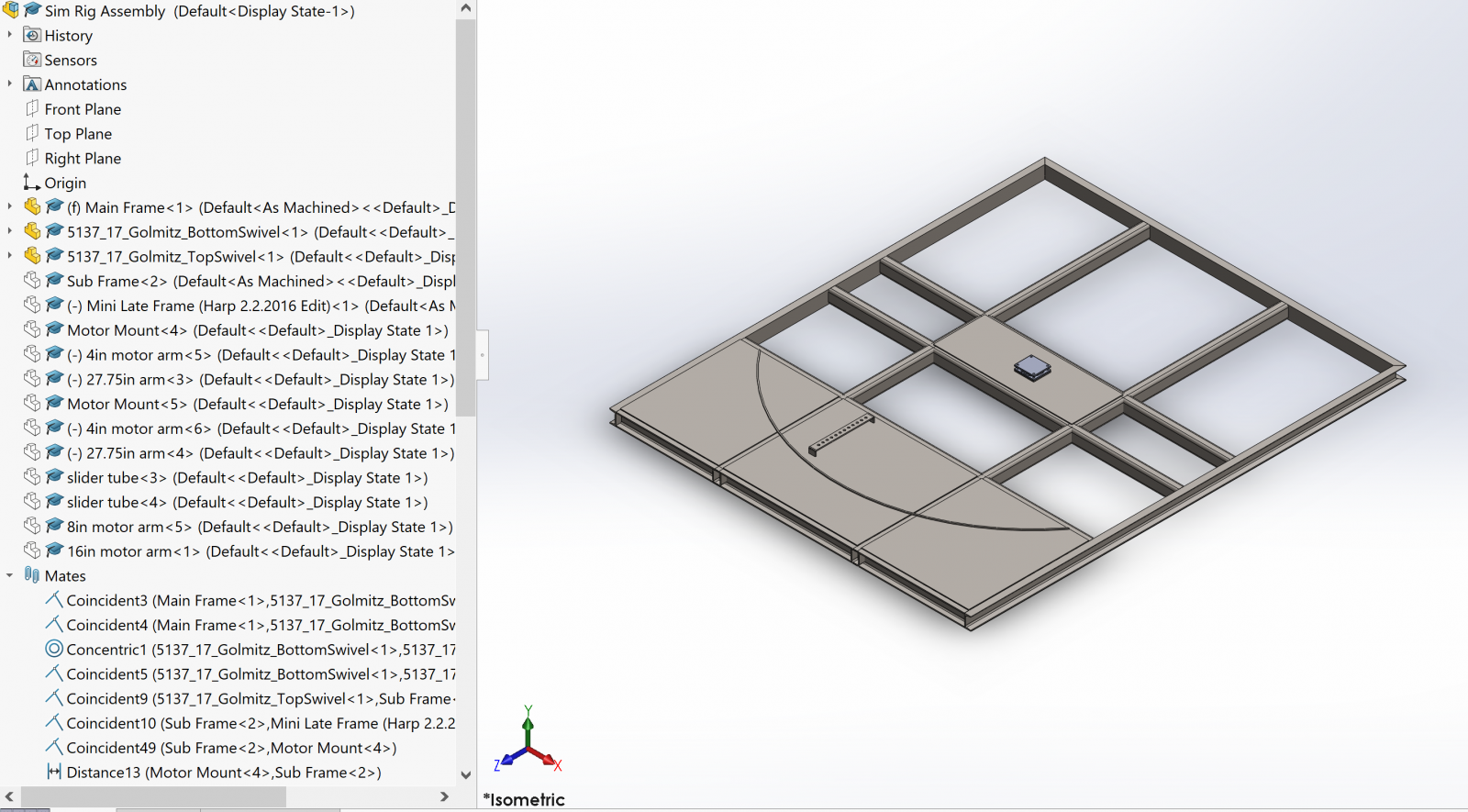

    Here is the frame we intend to use. Our manufacturing facility on campus took delivery of a new CNC machine, so the frame it came on was up for grabs. The swivel on the front is a 1000kg rated swivel. The arc is the path for traction loss.
    Sub-frame design. Will be using castor wheels for traction loss, but to save time on the drawing I didnt include them.

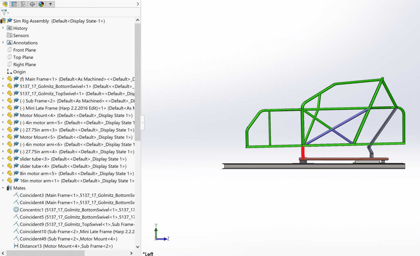

    Race car chassis on subframe
    Here it is with the motors and rods simulated. Most everything ive seen sim related has the motors mounted behind the actual sim rig, with the rods pushing towards the front. Has anyone tried this? bad idea? I did it this way to try and keep the final product looking clean and well put together. The body panels should hide the motors and rods nicely.
    Also, we will be using a universal joint (not pictured) to mount the front of the chassis to the sub-frame. The pivot point is the hole cut into the cross member above the swivel.

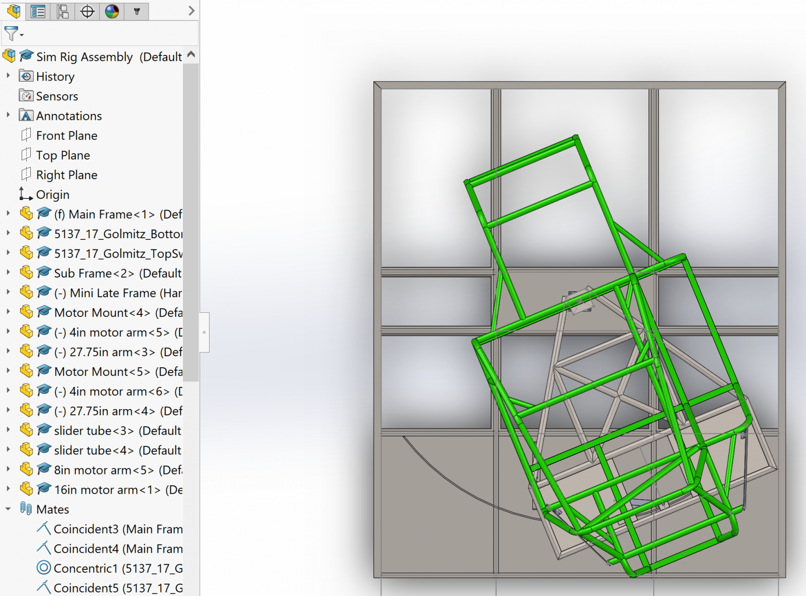

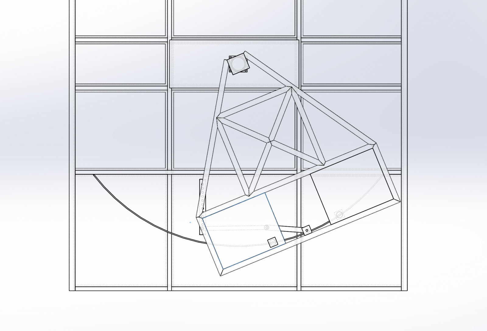

    Traction loss
    Home position
    Full swing

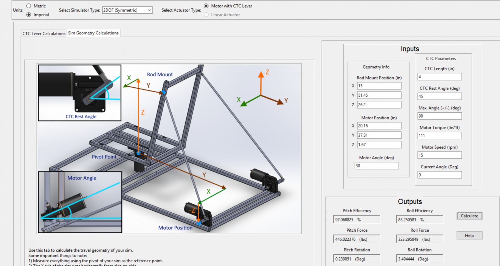

    Here are the SimCalc calculations for the model above.
    The hardware we are considering is below.
    We were looking at Motion Dynamics worm gear motors
    Specs:
    600W
    24V
    150Nm torque
    30rpm
    25amp
    power supply (AK-1000-24)
    1000W
    24V
    40amp
    Sabertooth motor driver
    dual 60amp
    120amp peak
    Kangaroo motion controller
    I would love to hear some opinions on the traction loss setup. What should be the max length of the motor arm to simulate the traction loss? We want a good bit of travel to simulate dirt track racing, but im afraid the motor arm will be too long at 8in-10in.
    Sorry it took so long to update! Looking forward to some feedback.
    -Joel
    20,555
    145,148Coins
    +10,780 / 52 / -2
    Something that pivots around a central point is yaw, not traction loss. TL pivots from the front.
    Keep in mind that simulation is about exploiting perceptual and processing weaknesses, in other words tricking the brain. Don't overdo axis movement travel at the expense of speed and precision, particularly if VR is ever going to be used.

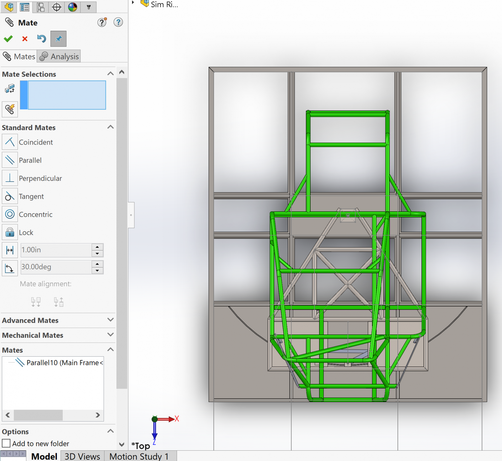

  12. Joel Magill
    Joel Magill New Member
    Aug 28, 2017
    7
    Student
    Statesboro
    222Coins
    Ideally I would have located the pivot point right under where the front axle would be, but because this rig will be on the heavy side, I moved it back to alleviate some of the weight on the rear motors. Additionally, a driver of these cars recommended this location for the pivot point, however he is a race car driver, not a simulation builder.
    The pivot is further forward than center, but just slightly. Im wondering if this needs to be redesigned now...the traction loss aspect is very important for this rig as dirt track cars stay sideways most of the time.
  13. PiaMan
    PiaMan Active Member
    Aug 2, 2015
    192
    Saskatchewan, CANADA
    607Coins
    +131 / 2 / -0
    3DOF, DC motor, SCN5, Arduino
    Your ujoint supports the weight. The traction pivot goes at ghe front axle. Since the frame willve supported with rollers or something traction loss doesnt add any weight to rear seat shaker motors
