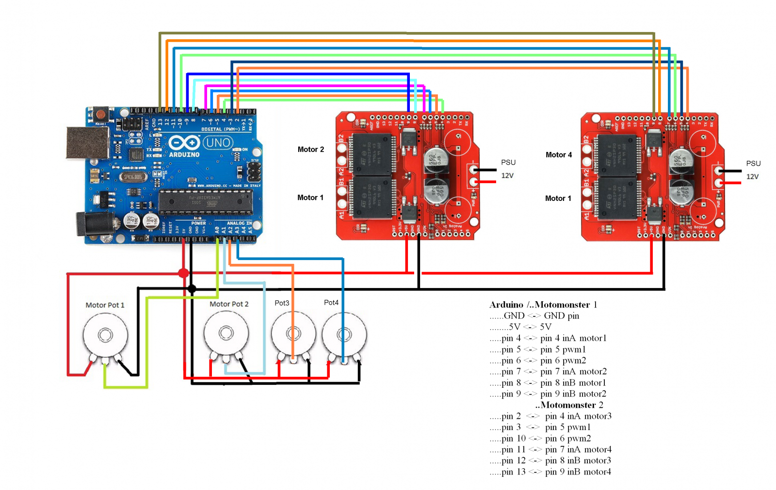

    +29 / 2 / -0

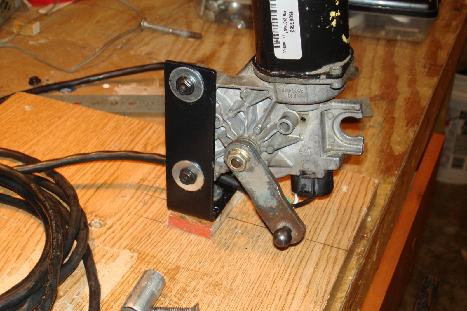

    yeah because i cant decipher which of the 3 wires inside the motors are the grounding wires. the photo that i was going by , the one you sent me....does not look any thing like the inside of my motors, ive scoured the web for wiring diagrams for my motors but nothing pops up. i have 3 wires inside leading to the top 2 are the same , 1 is not, there not color coded and i cant get into the casing where the wires lead to. the 2 that are the same are labeled c1 , c2 the 3rd lead off to a weired kind of plug and is off from the other 2. but they are all leading up into the plastic case.
    i really dont want to go cutting wires unless i know.

    there are only 3 wire pins that come up out of the motor to connect to.

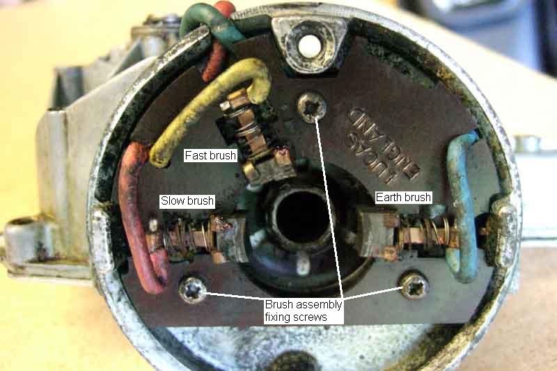

    So wipers have 3 brushes low high and earth you want very simply just 1 wire to red and 1 to blue and make sure they don't touch the motor casing as that will earth them

    thats the part i cant get into , no color coded wires are in my motor from the side i can see...........but i noticed that the earth ground was off from the other 2 if you were to look from the other side. so maybe the 3 that is off from the other 2 is the earth ground that i have on mine? i got to get off to work soon.. need coffee

    ive already been inside the motor .
    ive described in detail what i see when i get in there. theres not color coded that i see just 3 unshielded wires. 2 that look similar and one off on its on with a strange looking plug but all leading into a plastic casing the 2 that are similar are labeled c1 and c2 the 3rd off on its own , i cant see a label for it.

    Sorry I see now what you said can you take some photos of the things you mentioned?
