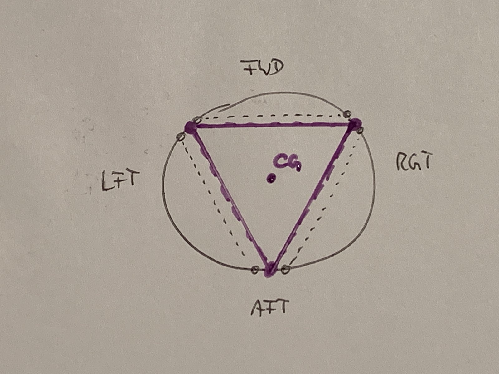

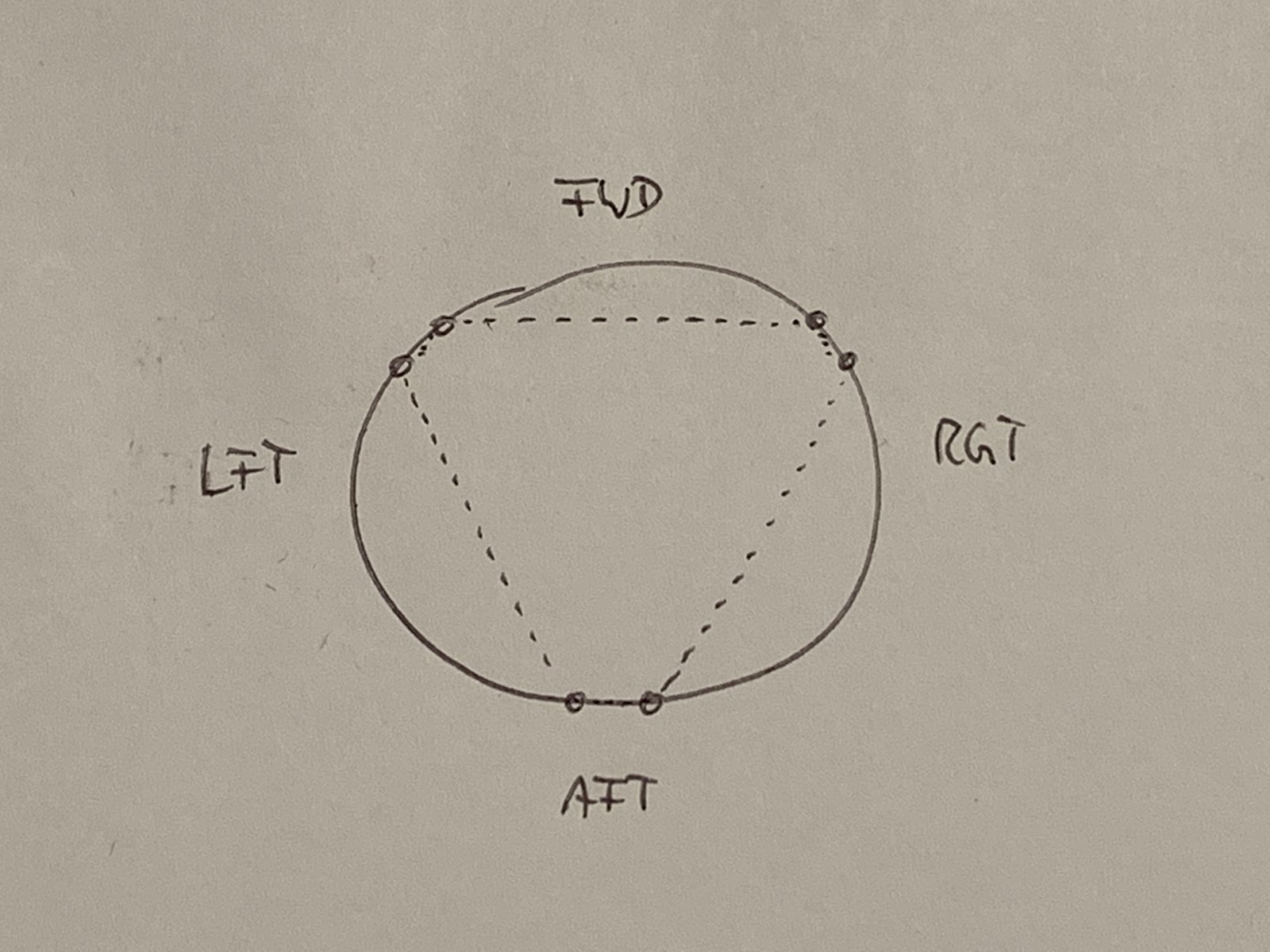

    First of all, I agree, you CAN consider the six upper connecting points to be three pairs (each pair sharing a point). It will make the calculations easier and change the result only marginally. If you use a computer, you might as well take the six points into account independently but that gets quite a bit more complicated.
    Instead of this:

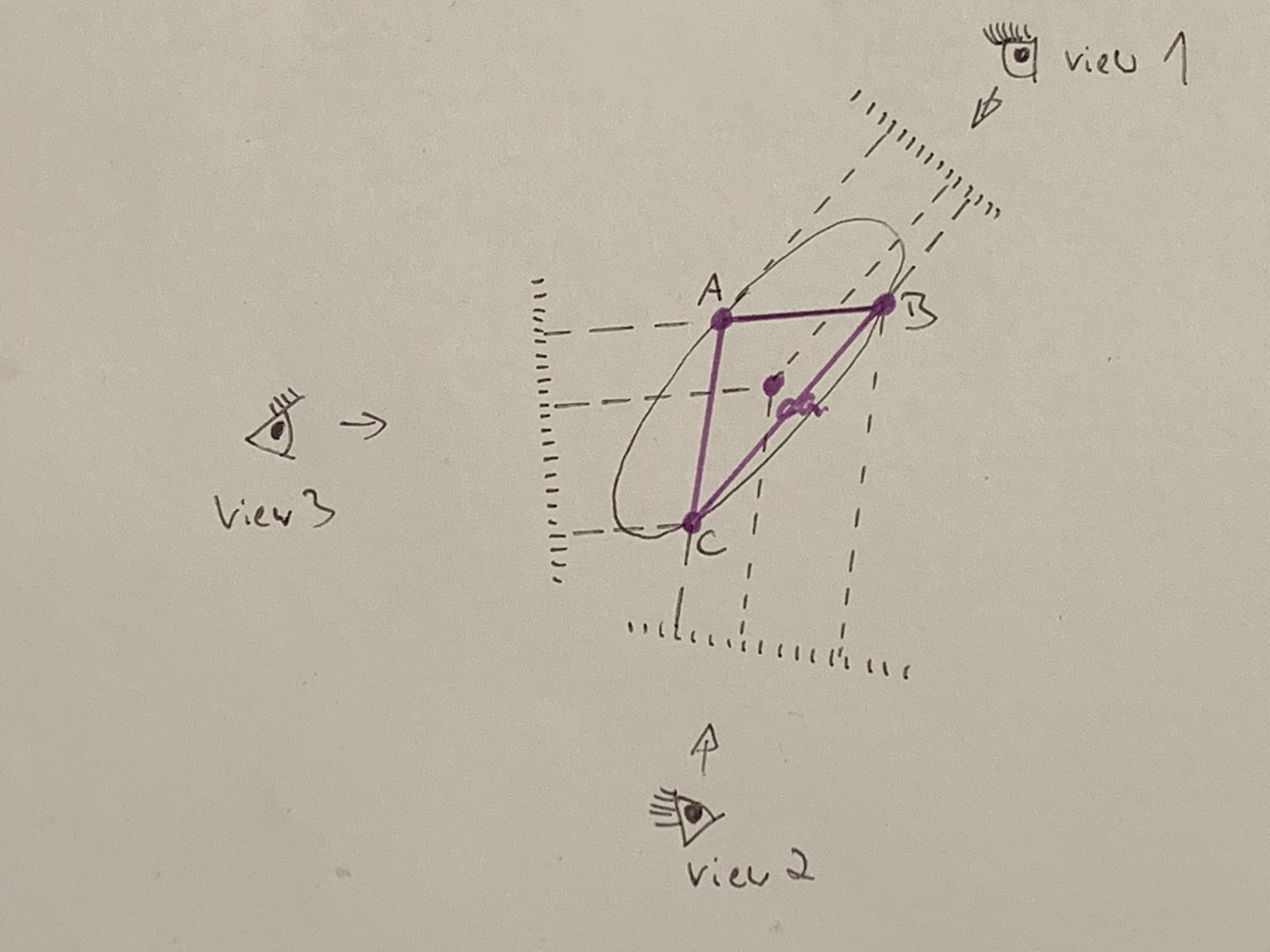

    Use this:
    I'm trying to lay down my thoughts here unfiltered, so let me know if I go wrong somewhere:
    • Since we only care for the distribution of the weight forces and these are by definition perpendicular to the horizontal plane, we can project the platform CG and all three (or six?) connecting points into the horizontal plane simply by ignoring the z-component. No matter the orientation of the platform in space. The resulting points will lay on an ellipse (because the platform was tilted) and the CG will not be in the middle (because it was offset vertically and the tilt moved it off center).
    • Instead of looking at the platform from the side/behind as you suggested, we will have to take three looks at these points (see above). Each such that two of them align. Then you can consider each of those cases as a simple supported beam. The two aligned points cannot be distinguished, but the load on the single point can be determined.
    • Do that for all three "view directions" and you have the load on each of the three points.
      View 1 determines the load on point A
      View 2 determines the load on point B
      View 3 determines the load on point C
    :thumbs I think that would be a way to do it. But I'm open for opinions anytime!
