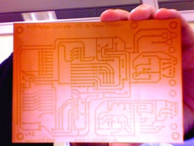

    The AMC layout must be converted to a PCB. To do this, you have to do it by your own, or pay a PBC service. In Europe, the cheaper one i knew some time ago is called Olimex. They are from Bulgaria, and ships wolrdwide. The two other ways by your own: With heat transfer, and with UV Exposure.
    This last UV Exposure is the method i will use becouse at work we have one... very old, but very fast! Tomorrow morning i will do it.

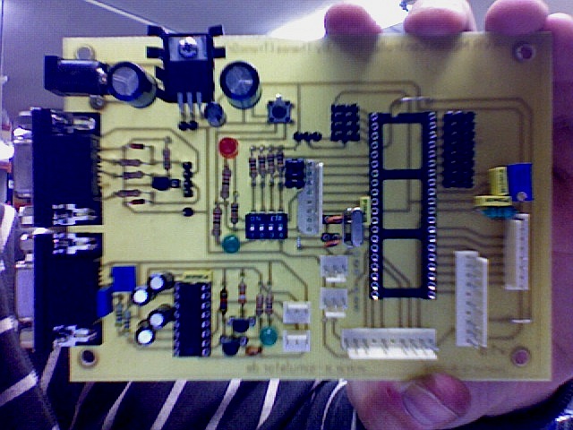

    Today i spent some time making my own PCB, but the H2O2 was very old and it was just almost water! I realized it too late, and the first PCB died.
    Tomorrow i will buy some decent H2O2 and try again... to gain some time, i have done a pre PCB like this:
    As things are really small now, there's no problem... let me see what happens when the PVC tubes are cutted and mounted together!!!

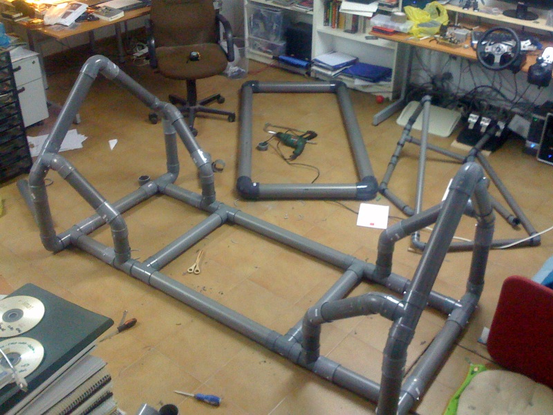

    After waiting for the PVCs tubes too much, i've just went to a industrial shop a little far away from my home and i brought all the thickest tubes.
    The tubes where cutted at 3 meters, so in order to put them inside my car a had to cut all the tubes at least to the minimun dimension Joyrider pdf's said.
    I have a fantastic :clap: 81,50€ PVC tubes at my garage, along with nearly 55 90º, 45º and T conectors. The price for the whole pack (different shops, but same prices), i think is quite cheap. The funny moment was how the man at the shop looked at me when he saw the joyrider schematics while i was cutting the tubes. :eek:
    Anyway: 81,50€ Total price of PVC.
    2 D90 3m PVC Category B. 6 meters total. (the thickest thay have)
    2 D40 3m PVC Category B. 6 meters total.
    2 D50 3m PVC Category B. 6 meters total.
    4 D75 3m PVC Category B. 12 meters total
    And all the connectors: About 54 of different sizes. Sizes and shapes on the Joyrider Plans. They cost 14€ by paypal and they sends you the PDF in minutes, it's worth of it, so please, support your local motion-simulator-diy-designer!!!

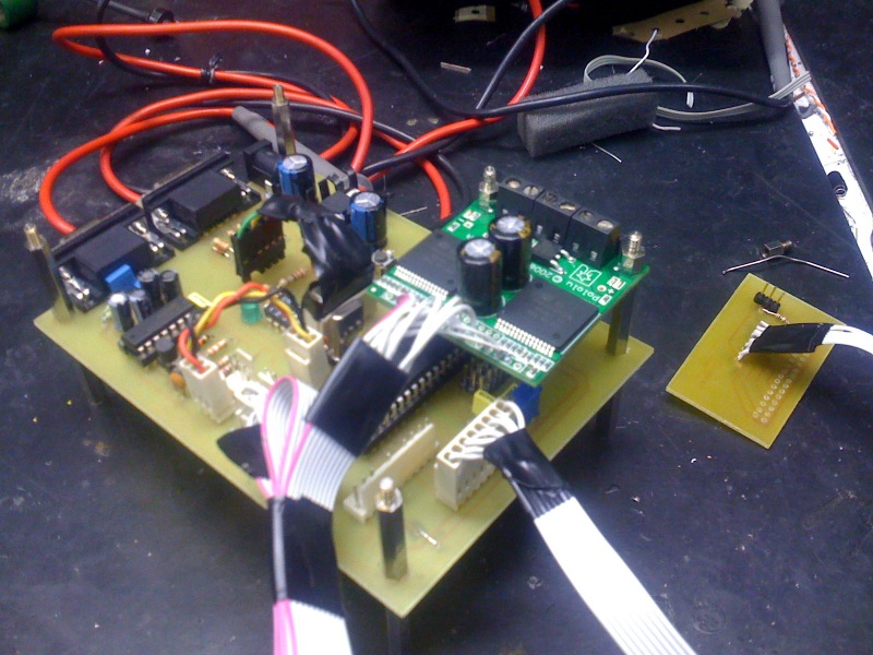

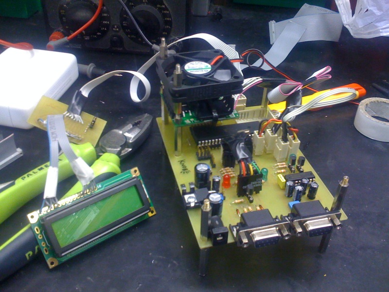

    On the electronic side:
    I've spend some hours drilling and soldering my fingers :hi: This is the result after a hard work on a sunday:
    You will see some different things about the Tronic's pictures as i didn't find the exactly componets. The ATMEGA-8535PI is out of catalog in Spain... and the 644 is nearly the same, at least in the mayor shops i now.
    I found it on a German store called DARISUS, and a i've ordered a couple of them for 20€ shipping and VAT included. It's not cheap, but who said it will be easy? They told me tomorrow or in a couple of days i will have it at my home. I ordered the 8535PU which is the same of the PI but with the regulation of ORHs and something GREEN (enviromental love) stuff. The rest of the models are for SMC, so be carefull when you order that.
    The blue capacitors near the DB9 are the 1n2f (in my case 1n5f)... i will see if they eat all the noise from my com cable.
    The pololu came, but... it was my fault, and i ordered the 3H instead de 2H... and i will send it back, becouse the 3H doesn't work with current sense, and doesn't allow high frequencies. That happens when you order something at 03:00AM... keep focus, man, otherwise you will pay double for everything! :blush:

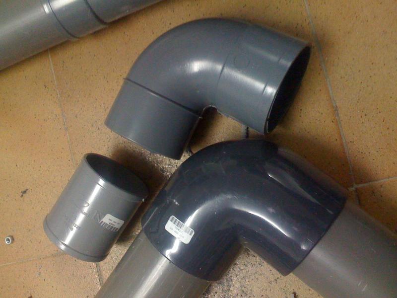

    If you are following the joyrider plans, sooner or later you will need to buy the pipes and connectors. I had a problem with the thick connectors T, 45º and 90º
    When you pass the limit of 50mm diamenter, it's very common in spain to use Female-Male connectors, instead of the Female-Female the joyrider plans use, as long as Thanos used too.
    This is in fact due to the preassure the pipes must resist (someone told me about) Then you have two different choices:
    1. The 75mm and 90mm connectors (T, 45º,90º) Female-Female are 3-4 times more expensive than the Female-Male normal ones, and 3-4 times thicker too. We are talking about 150€ in total, more or less.
    PRO: Exactly what Joyrider plans says.
    CONS: Expensive. Difficult to find in local dealers. You must join the connectors with 7mm tubes (a lot of them... be ready to cut and cut)
    2. Use the normal ones (not too light, remember they must hold your body and PC stuff) Female-Male, and buy some Female-Female straight connectors. Then remember to cut 4.5mm from your original pipes to match the lengh of the connector.
    PRO: No use of those 7mm little tubes. Only straight connector for one side. Cheaper but thiner.
    CONS: Cut 4.5mm anywhere you add a Straigh connector.
    In this crisis time i had to choose the 2nd option. I had already brought the Female-Male connectors so i would loose the money.

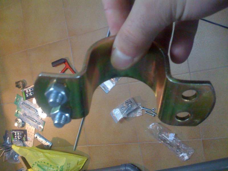

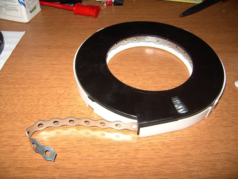

    Talking about the screws, remember that you can't add a Bolt and nut becouse the pipe is too narrow and long to let your hand reach the other part of the bolt.
    Maybe it's a stupid tip... anyway, since i've choosen the straight connectors, i'm using the screws for the long pipes, and everywhere i can, bolts and nuts.

    I've finally received the Pololu and the ATmega, the LCD is still missing... i'll try to buy this week. The good news for me is that my father doesn't need a discharged but new battery car. Raw 12v for me!!!

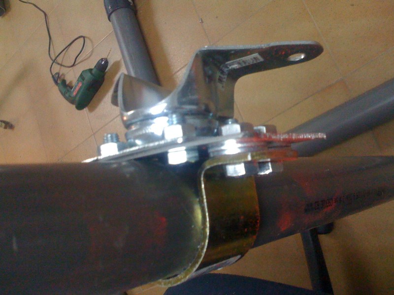

    I'm finnishing the joyrider... a lot of bolts!!! I haven't found the caster wheels on my local stores, so i'll search it on the mayor ones.
    This is what i was talking on the last post about the male-female conectors:
    If you choose the male-female then you will need a female-female connector. Just be carefull to note that when you are planning in the store the things to buy.
    This is the work so far...
    I have solded some wires here and there... i just need the LCD to finnish it:
    More news tomorrow...

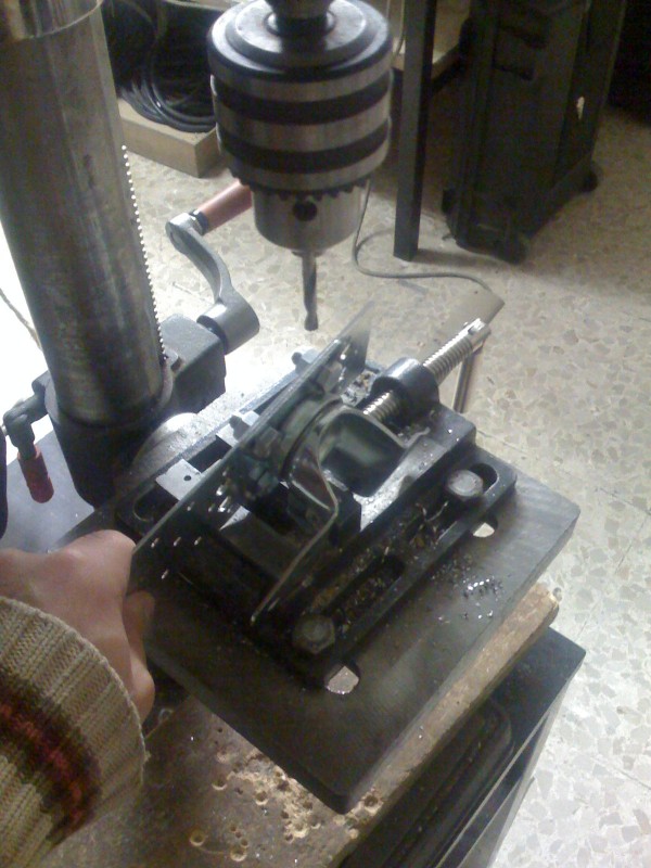

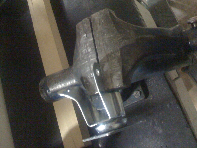

    I've been trying to fit the parts of the joyrider. Not an easy thing. I found that some pipes were not very well sized, so i had to re-cut some. I don't really know why, becouse on the paper everything was right, but on real life...
    I found the casters wheels, or at least, the casters i think match more or less the one joyrider plans says. Of course, they have a double bearing, and i hope don't break once i step into the joyrider :hi:
    Have you tried to bend metal with your hands? That's what i tried, and fail, of course. I should have called Bender (futurama best character, btw). It was nearly impossible to bend a sigle milimeter. Luckly at work i have some heavy weapons, and this is what i used to bend those casters:
    After doing that to all, this is the result so far:

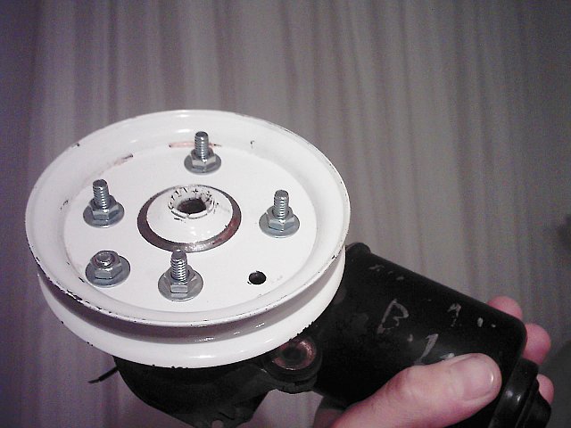

    What it's complety impossible to find is the white roller guide Thanos use on his tutorial. I just found a lot of roller guides, but a heavy ones, and everybody told me i'm crazy if i want to drill holes thru them.
    :sos: becouse i don't know any alternative.

    After the joyrider, i focused on the LCD, which is not the HD44780 exactly, but a compatible. The pins seems to have the same layout, and everything seems quite similar. I have attached to the Pololu two heat coolers,and a fan, just to be sure things stays on normal.
    And that's enough for the last days...

    The white pulleys are made from solid 5mm steel with white paint to save from rust... I almost burned my electric drill oppening those holes. I also tried to use a Ridgid hole saw arbor to remove its unused center hole bump, but I after a while I had to quit trying. As you can see on the photo, the mark of the saw is still there!!
    Regards, Thanos
  17. tronicgr
    tronicgr
    You can try using come metal ribbon holder, or whatever its named of... Here a photo of it:
    Just cut it in any size you want! And if you think its not strong enough, you can use two pieces together... :thbup:
    Regards, Thanos

    This is the way i solved the pipe holder problem: I found on the last store of my city a 39mm metal holder with 2 holes on each side. It was built for outside wood houses (at least is what the man of the store told me twice). It's a hell thicker than what we need, but i feel a little safer using them...
    As the holes of the caster wheel don't match with the ones on the holder, and that 39mm are not 40mm... i needed to:
    Fist, attach strongly the caster wheel onto a metal plate.
    Second, add some washers between the metal plate and the holder to let the pipe fits inside. (i just need 2 washers on each hole)
    And here is the result:

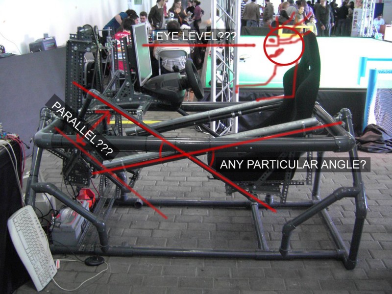

    I don't really know how to find the gravity center of the whole cockpick thing. This is the tronicGr at Athens Digital Week ... (what a headache just thinking to move that from your home to there...)
    Thank you one time more.
    Regards.
    Knob2001
  19. tronicgr
    tronicgr
    Hi Oscar,
    I guess, these is no easy way of finding the GC, since the cockpit is a little asymmetrical, and your material might be more heavy or light. I'd suggest securing the seat first, in a angle that will be comfortable to sit in while providing enough space for you legs. In the calculations take in mind that extra space that is needed for the pedals and their angle in relation to the seat.
    Then, you should add the LCD and the controls, prior installing any pulley drives and cables. If it balanced enough, the it should stay level with you inside it, on both pitch an bank axis. If not, you know what to adjust...
    Best Regards, Thanos
