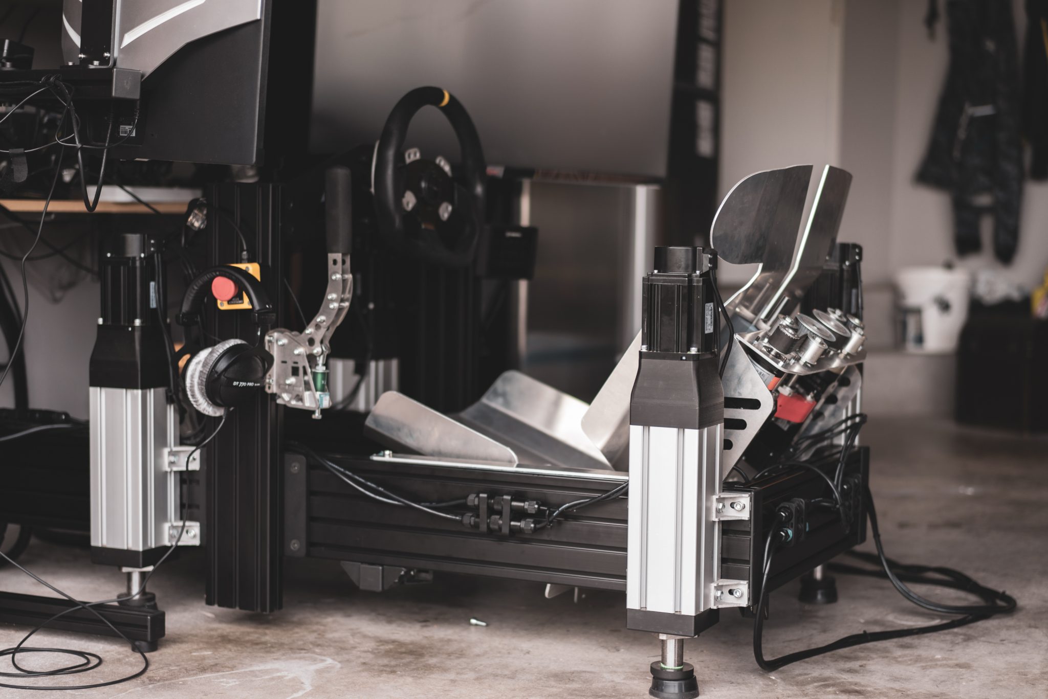

    Hi guys - I've been hacking away at a little G-Seat project and now in a state to share. It's *almost* done (well the back anyway). Just got to eliminate one area of belt slip and I can finalise it. Ultimately intending to have 4 panels, so 8 servos total (I think I might stop then....) on my rig.
    A bit of a walk through video
    Blog detailing progress along the way :
    https://www.rowanhick.com/2020/02/01/diy-g-seat-prototype-3-the-power-pack
    Cheers!

    Well I thought I better update this thread.
    It's almost done ! had a month or so of testing under the belt, solid and *amazing*. I've updated my blog above ^^^ with full details (just follow your nose from the homepage). I've also released the files for this all up on github for anyone who's mad enough to want to build one.
    Enjoy ! R

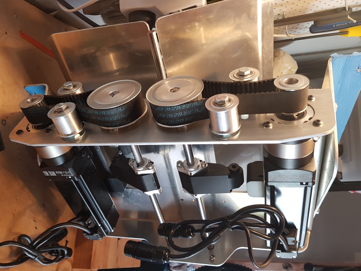

    Here's a view of the "powerpack" which is the drive system that makes it all work :

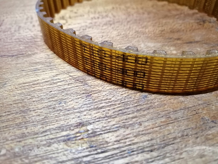

    Nice work :thumbs. I have been developing mine for many years and agree they are very complex to build and get right. Makes building a 6DOF look like a walk in the park, but they do deliver if done correctly. Unfortunately like VR, it is almost impossible to convey how they feel from images or even a video. They are although next level in regard to simulation. RE: your belt issue, have you tried re-enforced belts? Picture of one of the belts that I used for belt drive tests. You can see the fibre re-enforcement to stop them from stretching and they are not made from rubber.

    Thanks @SeatTime for the tip. Yeah that's on the upgrade list to go find some nicer belts vs the Ali specials :)

    Yes, those rubber belts were never designed to do what you want them to do. I purchased mine through Motion Dynamics and they were designed to handle the high torque of golf Kart drives motors etc. FI most of my G seat is made of steel plate.. so very solid.

    Cheers @SeatTime I see you're just across the ditch. Nice :) I'll see if I can get belts from them in the size I'm after. Running htd-5m 25mm wide on my g-seat.

    Can you tell me what you final gear ratio is on your motor? It looks like you're using 60ST-M01930 with either 4:1 or 7:1 planetary gearboxes plus a 2:1 belt system that brings the total to either 8:1 or 14:1.
    Any thoughts on that final gear ratio? Wish you had more force? Sounds like you still limit the speed of the motors so you arent wishing they were faster.
    Why did you not go with this gearbox ratio using one planetary gearbox from china? Why add the belt system?
    How is the backlash from the planetary gearbox you bought from china? It seems you are happy with the one you bought. They do have lower backlash models if you're willing to pay for them. But is sounds like thats not necessary in your opinion.

    - Final gear ratio is approx 14:1 - 7:1 gearboxes with 2:1 step down by the pulley system. This is on the bottom, on the top I'm 8:1 final ratio but that's because I bought 2x 4:1 boxes originally - that's too higher ratio, the servo's get warm after 10-15mins, hot in 20-30 mins.
    - Gearboxes were just the cheapest I could get that fit the bill, obviously you can spend a lot more - not sure you'd notice any difference with backlash
    - Belt system I chose so that I could translate the motion appropriately in a relatively small package. And I could play with gear ratios without throwing away gearboxes.
    All sorts of ways of acheiving the motion to lever translation, not sure mine is the best approach, but it works in the space available.
