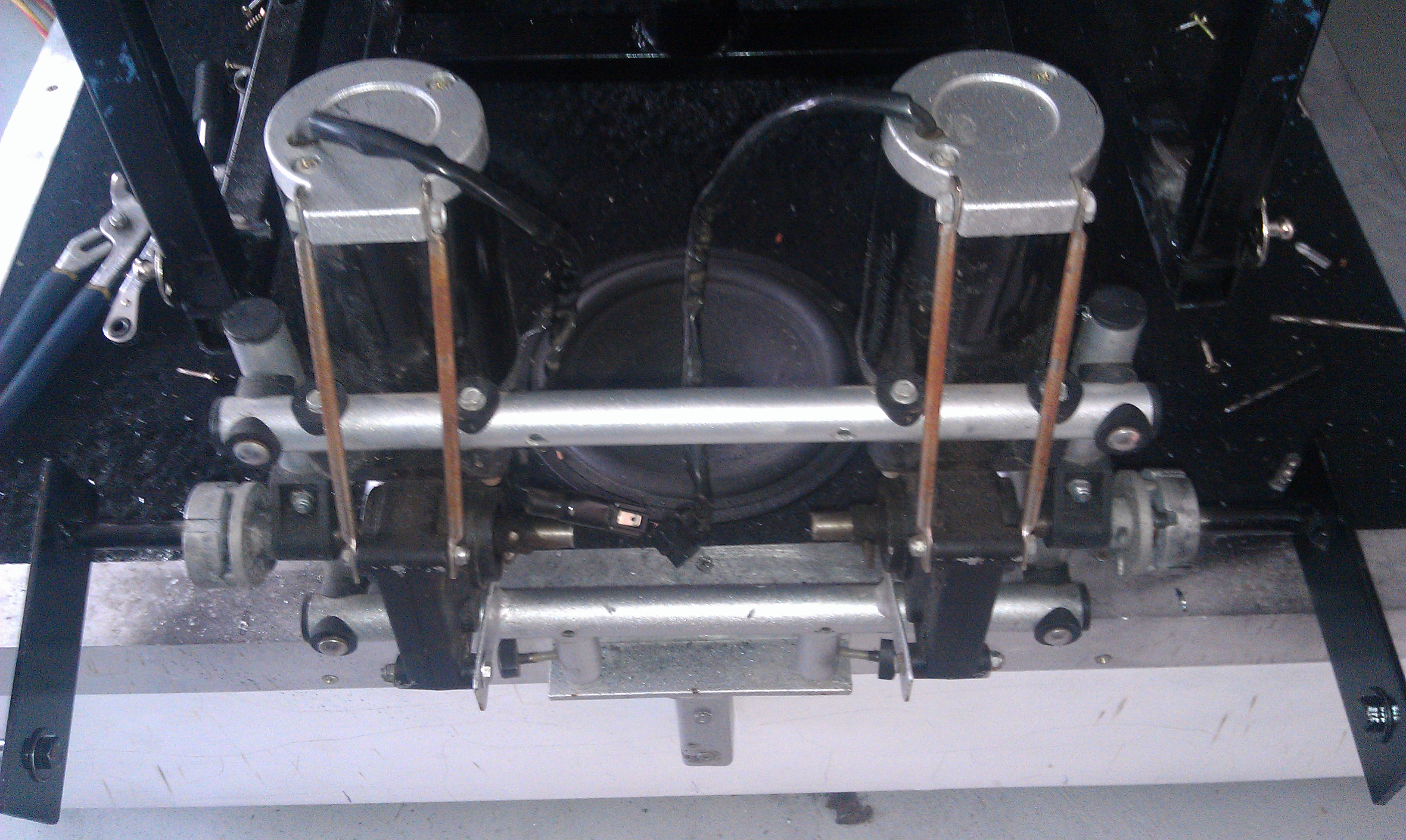

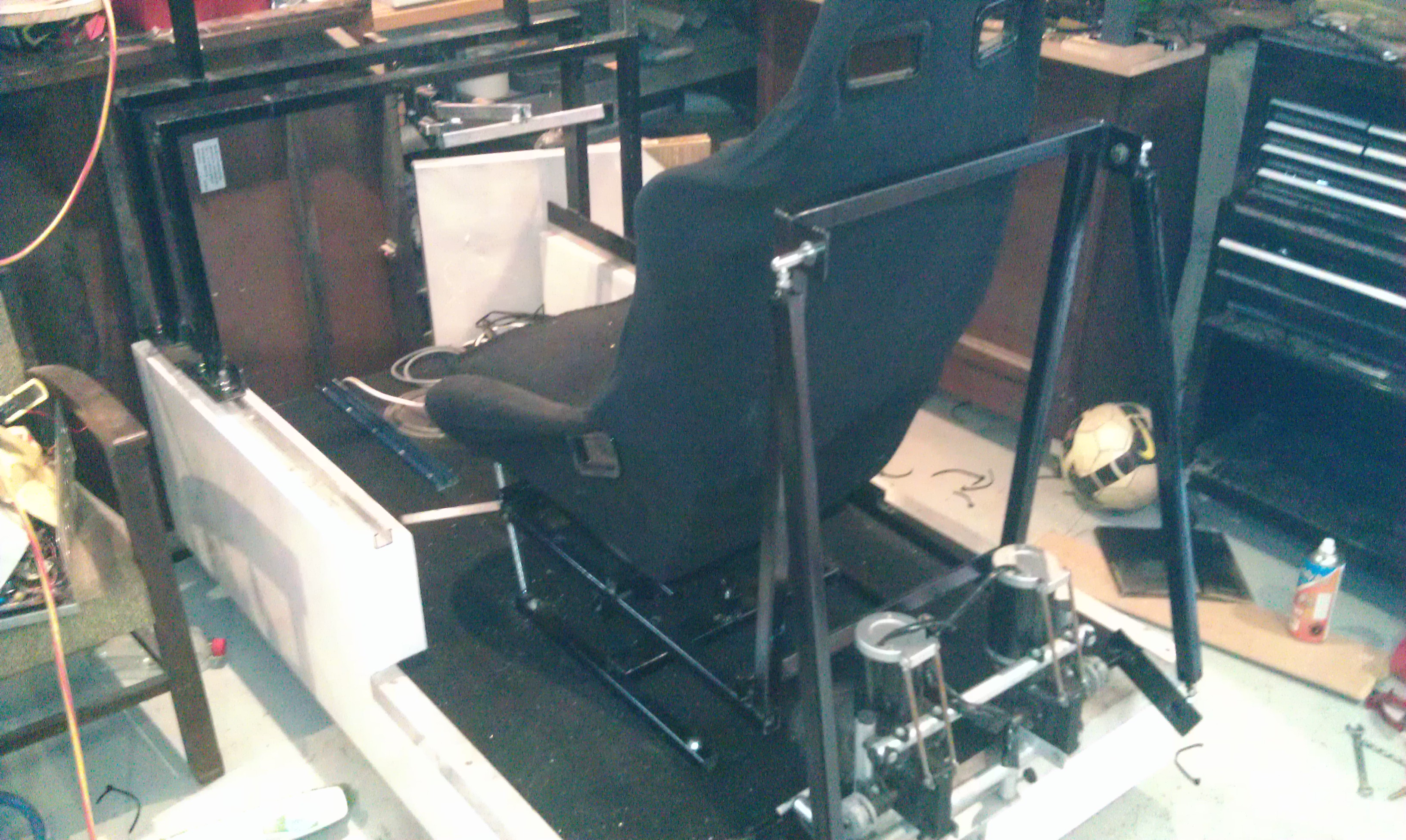

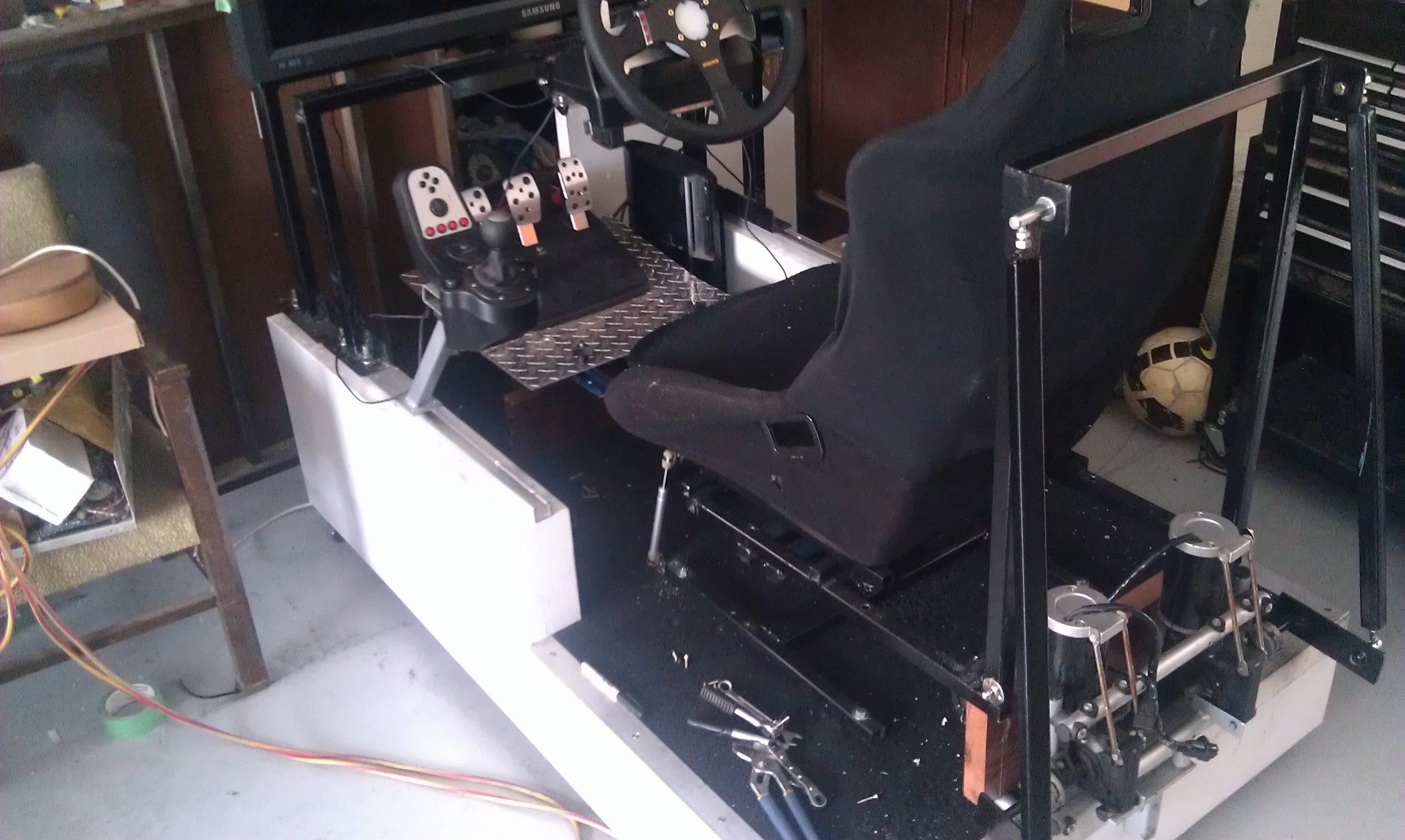

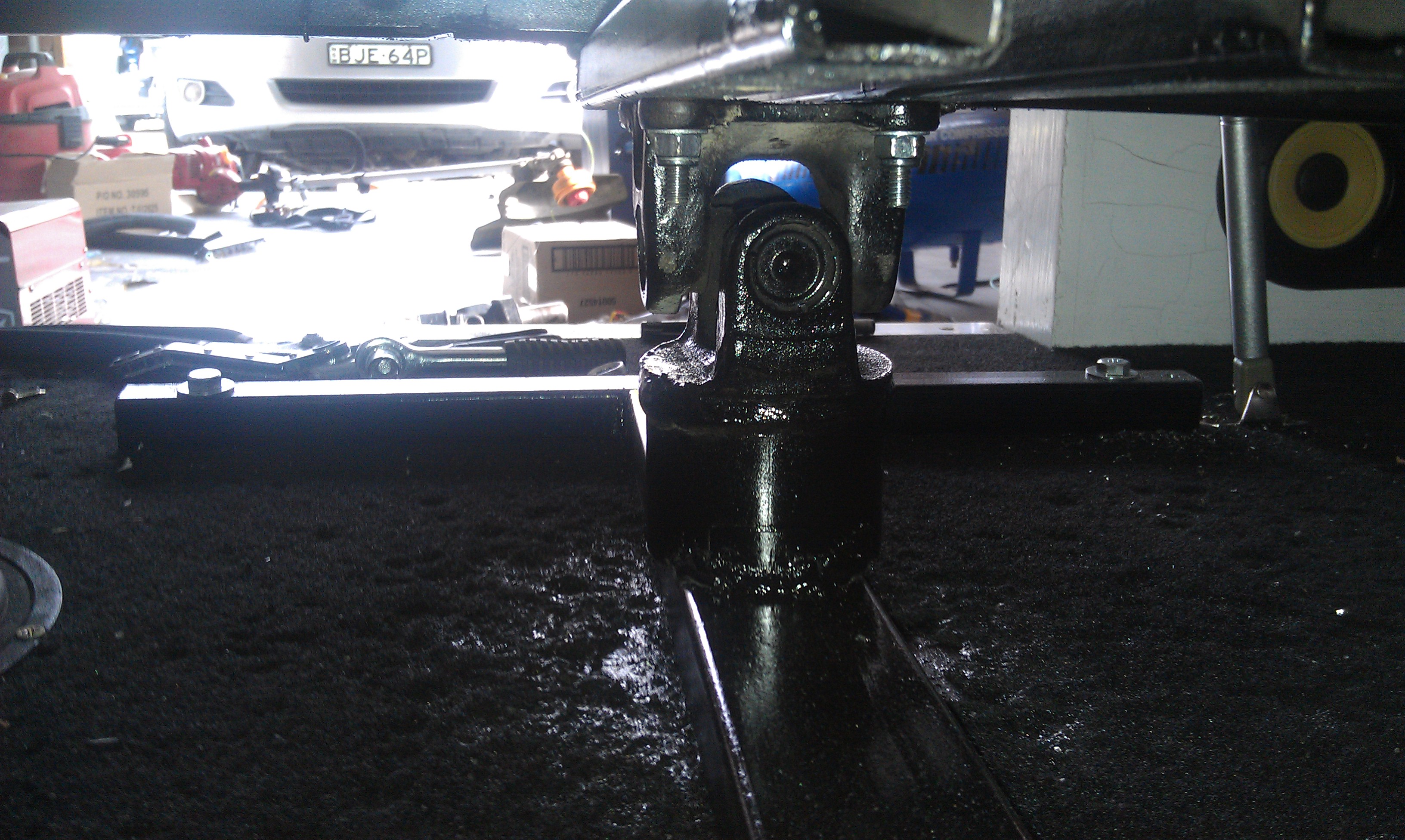

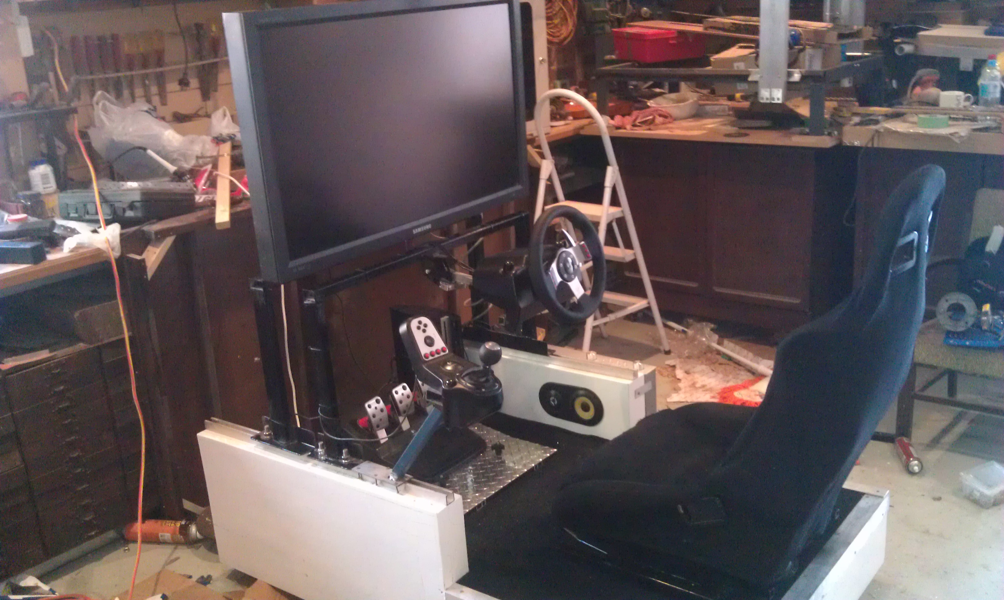

    I built myself a sled style sim a while ago and was very happy with it until I stumbled across this web site.
    Thanks to the generous sharing of knowledge by the members here I am on my way to converting it to a 2 DOF sim.
    My plan is to have the seat, pedals and wheel move but keep the screen static.
    Here is what I started with.
    After reading through many posts by you guys, this is how it is shaping up.
    Please disregard the blocks of wood holding it level at the moment, this is so I can still use it while the build progresses. GT6 came out last Friday and I was keen to give Bathurst a go.

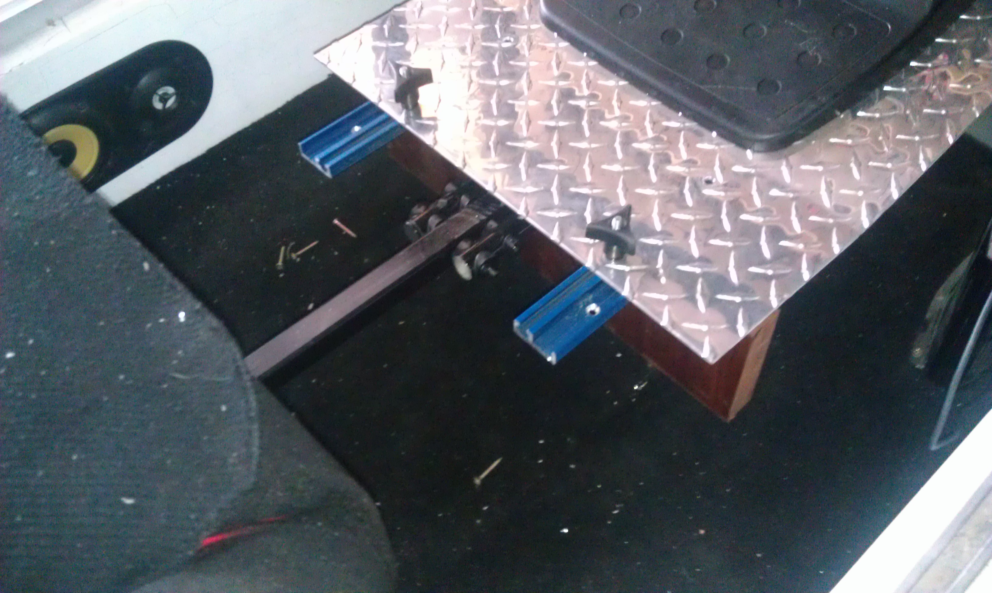

    The tricky part with my build is that I want to keep as much as possible adjustable. I have 2 young boys 5 and 7 and I want them to be comfortable playing it as well.
    I have the pedals sorted, but the steering length or closeness to the seat will be tricky. With the sled style I could move the seat forward and adjust the steering up or down, anyway I will nut that one out soon.

  2. bsft
    Hello Dave, nice setup. The motor placement is ok, as long as you are not too heavy a chap, like over 110kg. I have tested my big motors on about 6 different designs for best placement in regards to compactness. If it struggles, you may need to space motors out a bit, but give it a whirl first.
    As for main adjustable for younger kids, been there , done that. My older boy is now 10 but has been my test pilot on all my builds since he was 7. So adjustabilty was the key . Pedal placement was easy and when he was younger I would put the booster seat in, move pedals towards him, no probs.
    I have a mate whom has mounted his seat mover setup on seat rails to make it easy for him to get in and out. So motors, and control boards all in one on rails.
    As for steering adjustable, I made a slider setup on one sim, where as I cut out slider holes in base of steering mount, then made a plate with nuts on it for wingbolts to tighten against. So I can slide it back and forth and tighten to hold into place. So it moves back about 90mm towards the younger driver.

    I would have placed the motors a bit further apart but I was lazy and just used a section of the donor golf buggies frame, pretty solid but too close together.
    As you said I will try it out first and change it if it needs it. As i am just over 100kg it may be a problem.
    Dave.
