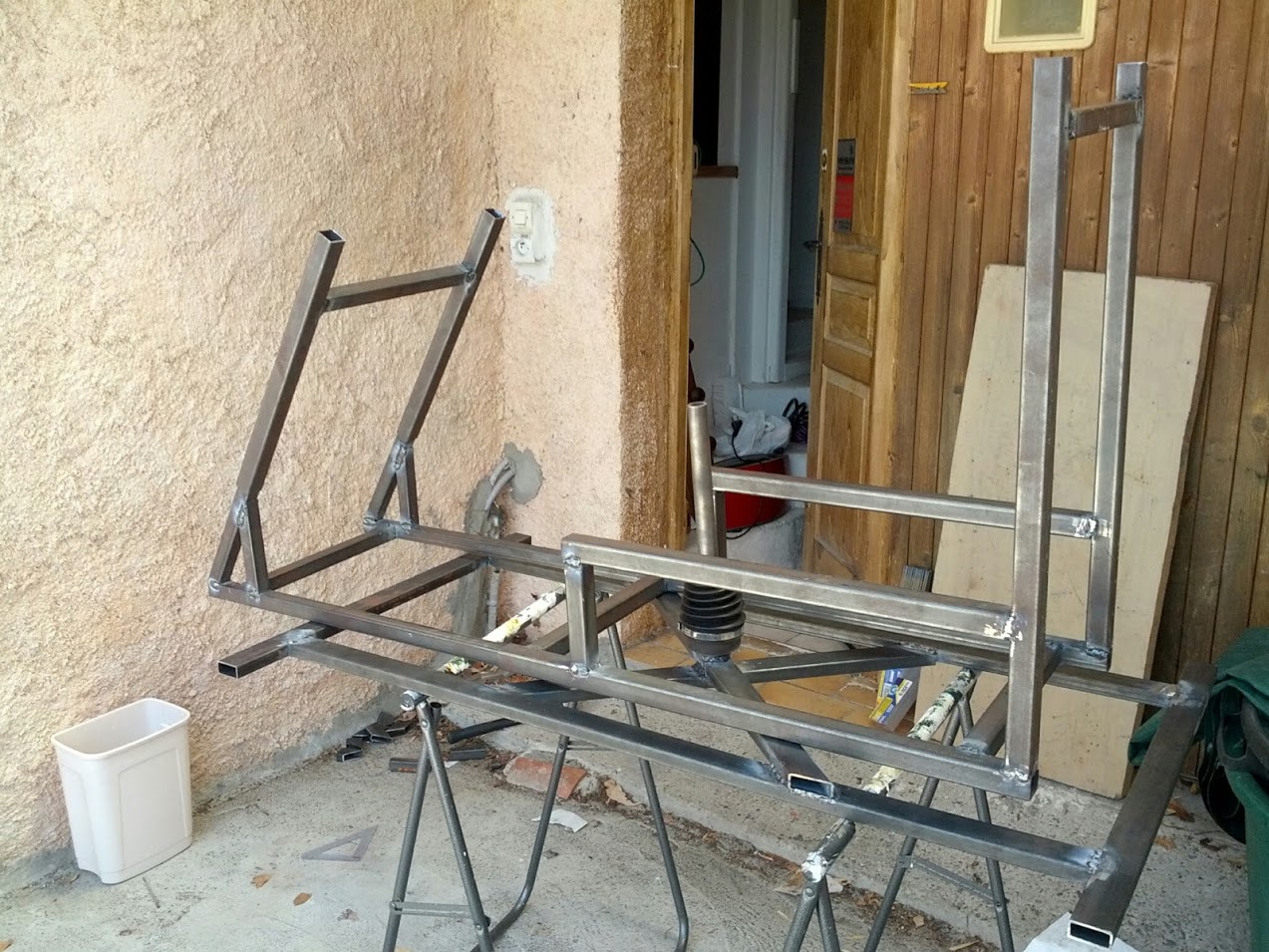

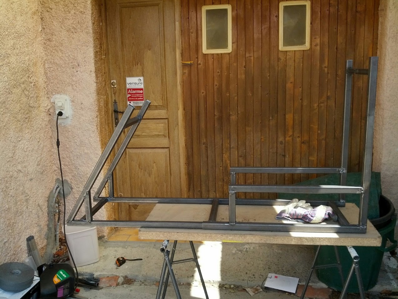

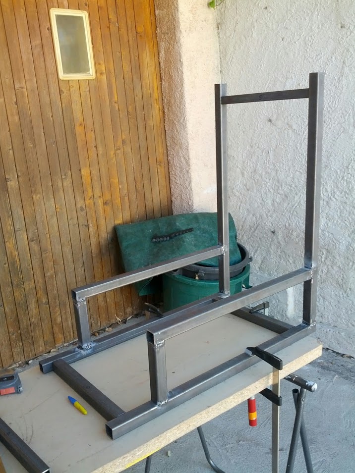

    Some welding occured this weekend, under 34°C sun :cool:
    The strucuture is sliding quite well (justt need to use a file to optimise, and put some grease for smoother sliding)
    Max length, minimal steering wheel height :
    Minimal length, max steering wheel height :
    Once I find the gravity center, I'll probably cut the structure tubes to have +15,-15 settings compared with my preferred driving position. This should fit most drivers (including my kids)
    I should receive my T3PA pedal somewhere this week :)

    Some progress:
    All the welding as been "hardened". It is rock-solid now.
    Next step is to brainstorm on how to make the fixed chassis and the moving chassis link strong enough, but removable as I want to be able to put all this in a real car.... any ideas ?
    If I have time this weekend i'll go for a quick painting also, to prevent rust. I'll probably ask the kids to help me for that !

    That is a big frame and the design does not lend itself to easy transportation, particularly in a car.
    Mine has 4 bolts holding the seat to the pivot post and 2 nuts for the connecting rods. The pedal and steering post detach with two quick release screws and a nut.

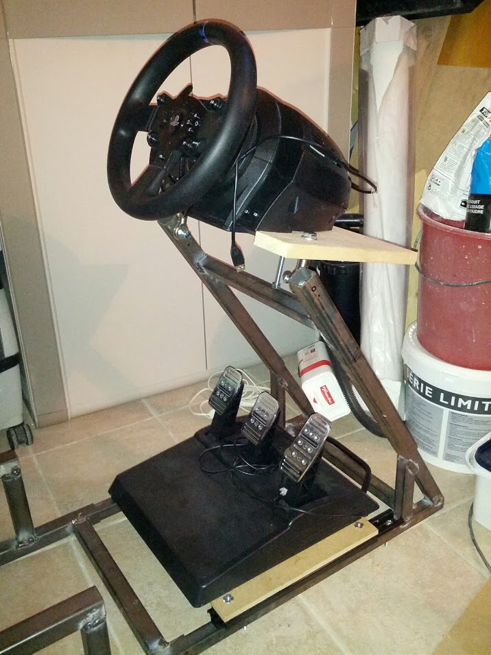

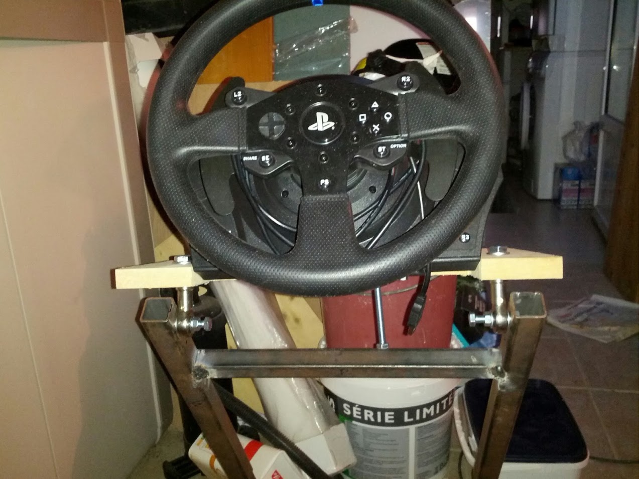

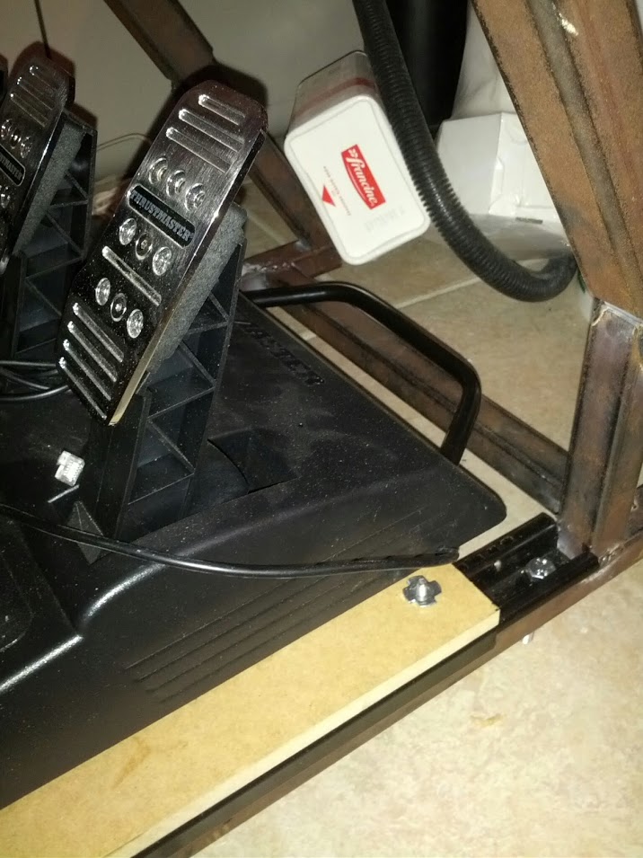

    As I'm on holidays, I took some time to start assembling pedals, wheel and other stuff. Here are some pics:
    Pedals and wheel slide together.
    In addition pedals are mounted on seat rails so pedals/wheel distance can be adjusted:
    And the wheel can be tilted:
    This should allow everyone to find decent settings. I'll adjust the screw length as well, and paint the wooden parts

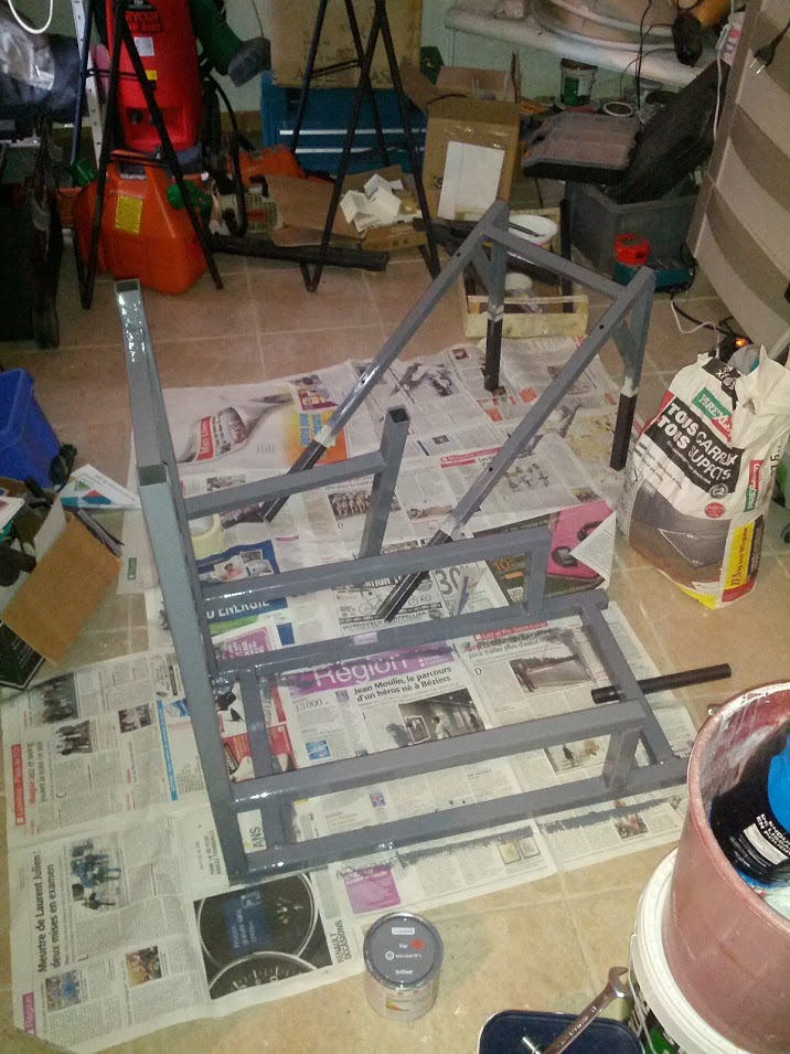

    Some painting as well started:
    I'll put some grease on the non-painted part to hve a smooth slide for the different parts.
    I just have to mount the seat, then find the gravity center and start the final assembly :p
    Chhers, and nice holidays to you if you are on vacation !

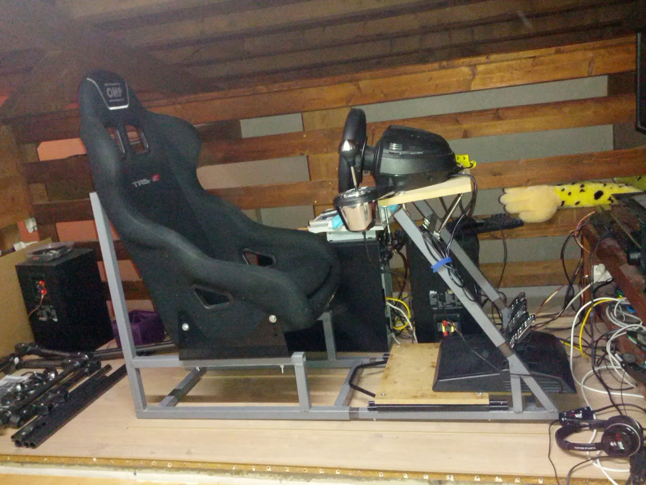

    After some tests, I reverted the pedal sliders in opposite direction.
    I also noticed the wheel is a bit too far. It is really usable for me, but for kids it will be too far. I'll rework this later on.
    While waiting to mount the base, I can enjoy the "to be shake soon" portion of the rig :D
    I'll also have to make a decent shifter holder, but I actually enjoyed this one. I was surprised and interested to see the speed gain to not to have to go lower, closer to the seat.
