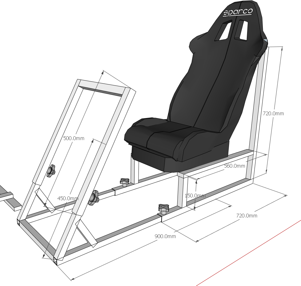

    Here is the final design for the moving part:
    As I has exhausted the 6m of 30x30, I will use some 40x20 for the seat mount. Should be enough ?
    The 500mm sliding into 450mm should provide enough range for steering wheel height. If needed I will shorten the 500mm after trying, in case I can't get low enough.
    I'll adjust the 560mm depending on my seat mountand the seat angle of the back, but I should be pretty close with 560mm.
    I attach the current sketchup file. If you have comments to make, make them now : it will be too late tomorrow :D
  11. RacingMat
    2,234
    21,094Coins
    Keep doing first what your wife wants!
    When I see your bathroom, I prefer not to fancy what she could do when she's upset! :mad:

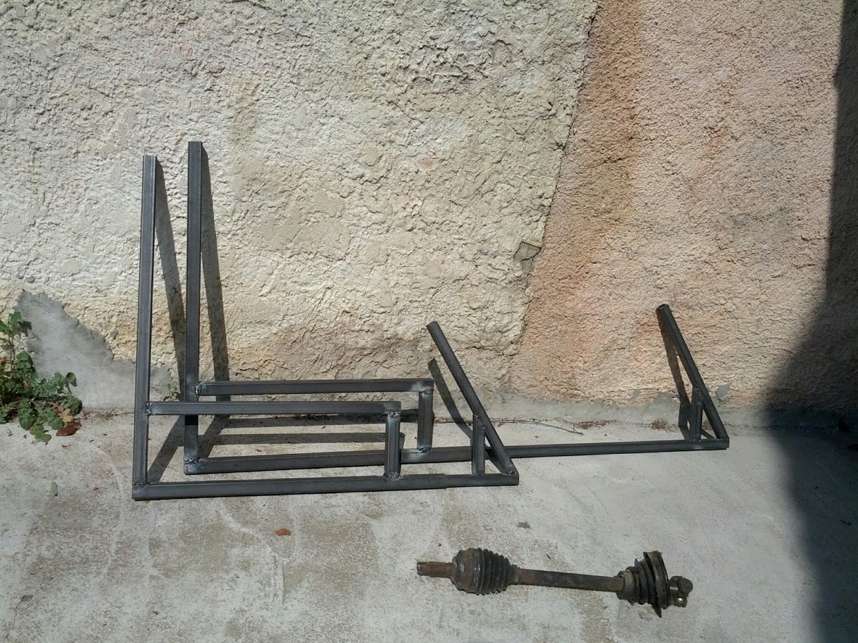

    Still alive, and bathroom has not moved an inch..... :rolleyes:
    But I started to weld the rig
    At least I see now something starting. I jumped on it and it looks solid but I'm not very happy with my soldering skills, so I'll try again with my "teacher" when he comes back from his holidays
    I'll put all pieces together, then he will review/correct the suspicious solders. Just to make sure and double-sure it doesn't break under rough tracks :grin

    Some welding today, under a heavy sun :p
    Max/min should accomodate adults & kids with no problems, even wih very long legs :D
    I also found a cheap gimbal nearby (the garge guy has dozens..... for future projects I guess)
    I hope I will have some time this week-end to weld the two mounts. Parallelism will be the key here.
  19. noorbeast
    22,185
    154,750Coins
    +11,196 / 57 / -2
    If you are using a CV joint you may need to want to consider a cross brace with heim joint ends between the top and bottom frame to prevent unwanted torsional twist.
