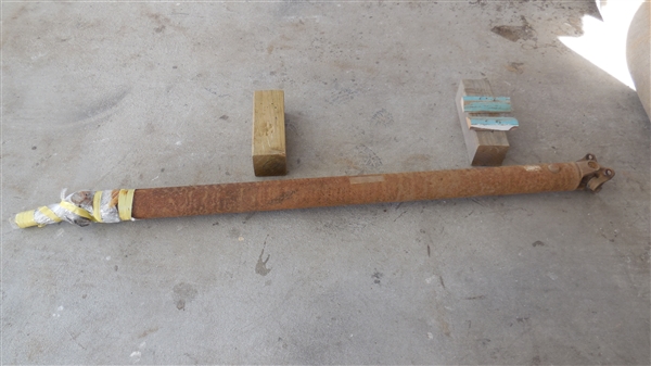

    Hey guys, just a quick "How to" question...
    I managed to get a tailshaft from a Ford Falcon with two UJ attached (Gearbox End to and DIF end)
    How are people cutting off their UJ's from such a large shaft? I tried to get it under my metal cut off saw but it's way too wide.
    Was going to go at with an Angle Grinder, but figured I'd check on here first :)
  4. bsft
    cheap 100mm angle grinder with cutting blade.
    I measure how high my pivot needs to be allowing for thickness of metal plate, then I cut the tailsahft best I can with the grinder, and weld plate on the ends. Mind you, I do take advantage of the yolk end (diff end) with bolt holes already in it. The other end, I just weld plates on.

    I used a grinder for cutting as well. It was easier to keep it square by using some rough timber V blocks nailed to a block.
    Do ensure the uni joint is square on the plate prior to welding, particularly if design tolerances are tight. It sort of sounds obvious but in many sim designs you actually have a bit of wriggle room top and bottom if you are slightly out of square, as you can twist the post slightly in relation to the base and seat boards. You have no tolerance room if the post has to slot into the frame on one end and where the top plate it is attaching to must remain square for other reasons, like on my sim for the quasi surge plate.
    Just a tip, be careful with Falcon tailshafts as alloy was used extensively in later models to reduce weight, which why the tailshafts were speed limited. On the other hand if you are looking for a light post and can weld aluminium then one of the later Falcon tailshafts is a really cheap way to do it.

    Thanks Guys... Good to know I wasn't off the mark taking an Angle grinder to it.

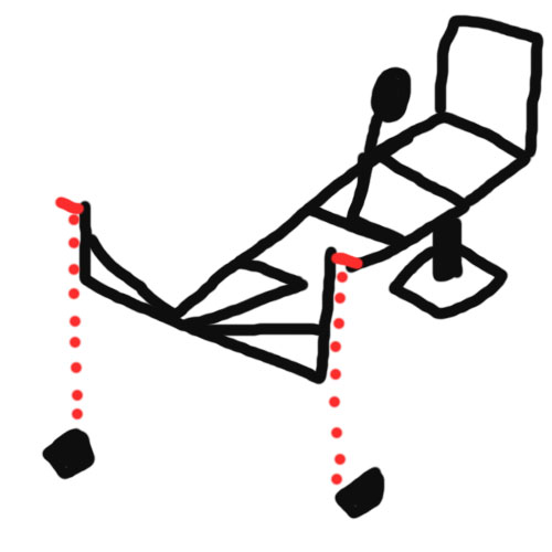

    Quick question on connecting rod lengths.
    Because I have opted for foot mount motors, I have taken @bsft advice and made the front connecting area quite wide at 650mm.
    This gives the frame an angular shape, so the connecting part is much wider than the seat (450mm)
    The recommend CTC for the motor arms is 40-65mm, I see posted about...
    I expect my pivot point to be about 250mm off the floor, giving the total height at the front for the connecting rods @ around 900mm.
    (I've drilled holes all the way up the connecting posts to adjust if needed)
    I lied didn't I... it's not a quick question at all...
    Anyway.. is 900mm connecting rod length a bit too much or inline with what you'd expect??
    Should I angle the motors or be ok with just straight up and down?
    (Pics would help but not in a position to take photo's at the mo...)
    Instead here is a crude drawing....
    Thanks :)
  15. noorbeast
    22,185
    154,732Coins
    +11,194 / 57 / -2
    How long the connecting rod is depends on the design. @bsft would be in a better position to comment on a foot mount but I know mine are about 355mm, so am guessing guessing you have a pretty high mount point. What is the height of that mount point?
    It is a good idea to angle the rods both in and back. Could you do a rough sketch of the planned relative position of the motors, mount points and rods.

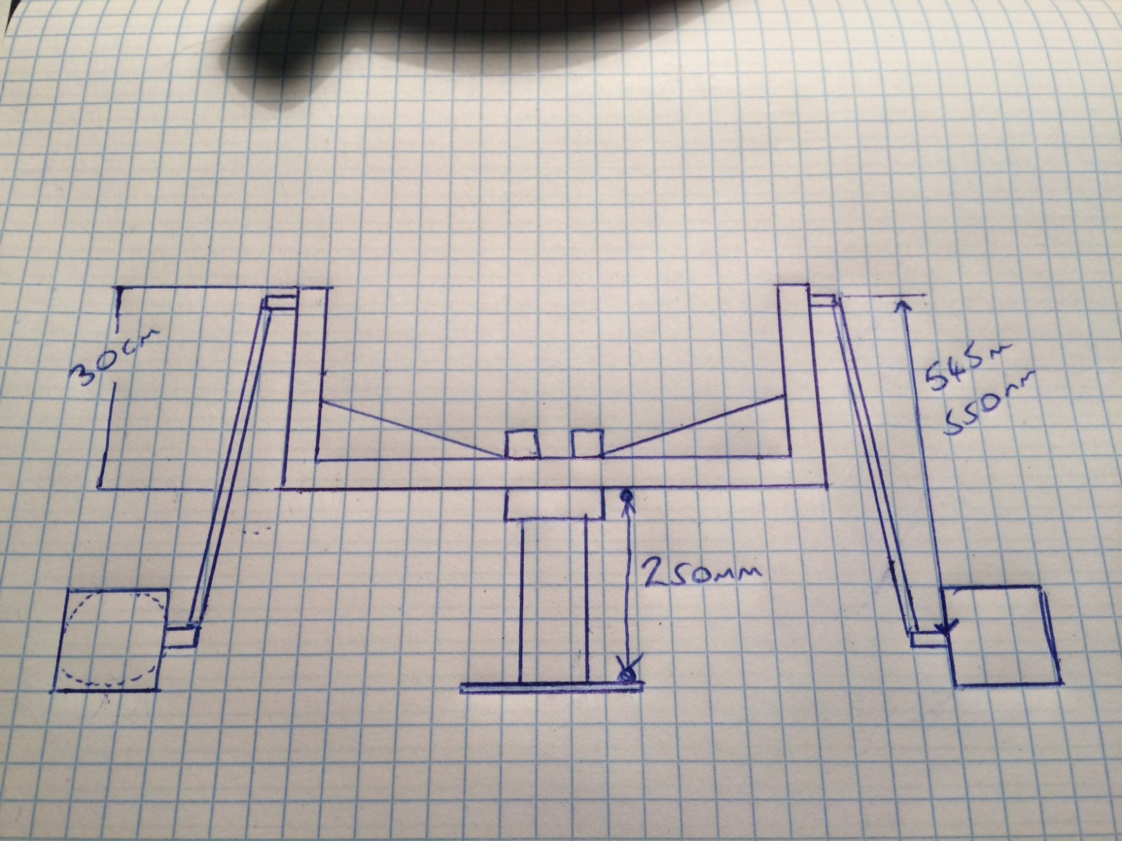

    Sorry @noorbeast. I gave wrong numbers.... I added the WIDTH to the mount point, not the height. DOH!.
    My mounts are 300mm high (when on the floor) with 8 holes around 3cm apart.
    Reading the forum posts, I'm guessing a 230-250mm height pivot will be enough.
    At it's highest point, my frame would have a MOUNT point of 550mm
    Lowest hole would be about 260mm.
    (All of this is not taking in the heights of motors etc... just rough numbers)
    Those numbers looks much better to me now. Stupid me :/

    That sounds like the right sort of territory to me, with plenty of adjustability if needed.

    Yeah, just drew it out and looks better. The rods are away from the frame so as not to catch.

    I imagined that you had the motors on the inside, any particular reason they are on the outside, as it would take extra space?
  20. Archie
    Archie Eternal tinkerer
    Dec 31, 2014
    1,081
    Wollongong, NSW, AU
    3,797Coins
    +1,382 / 4 / -0
    Seems more logical to have them on the outside, to me anyway.
    Plus looking at my frame they can only go on the outside.
    The base will only really stick out about another 5-10cm. I don't need a massive angle I guess.
    I was going to have the rods go straight up, but they might catch on the low corner of the base at the highest mount point.
