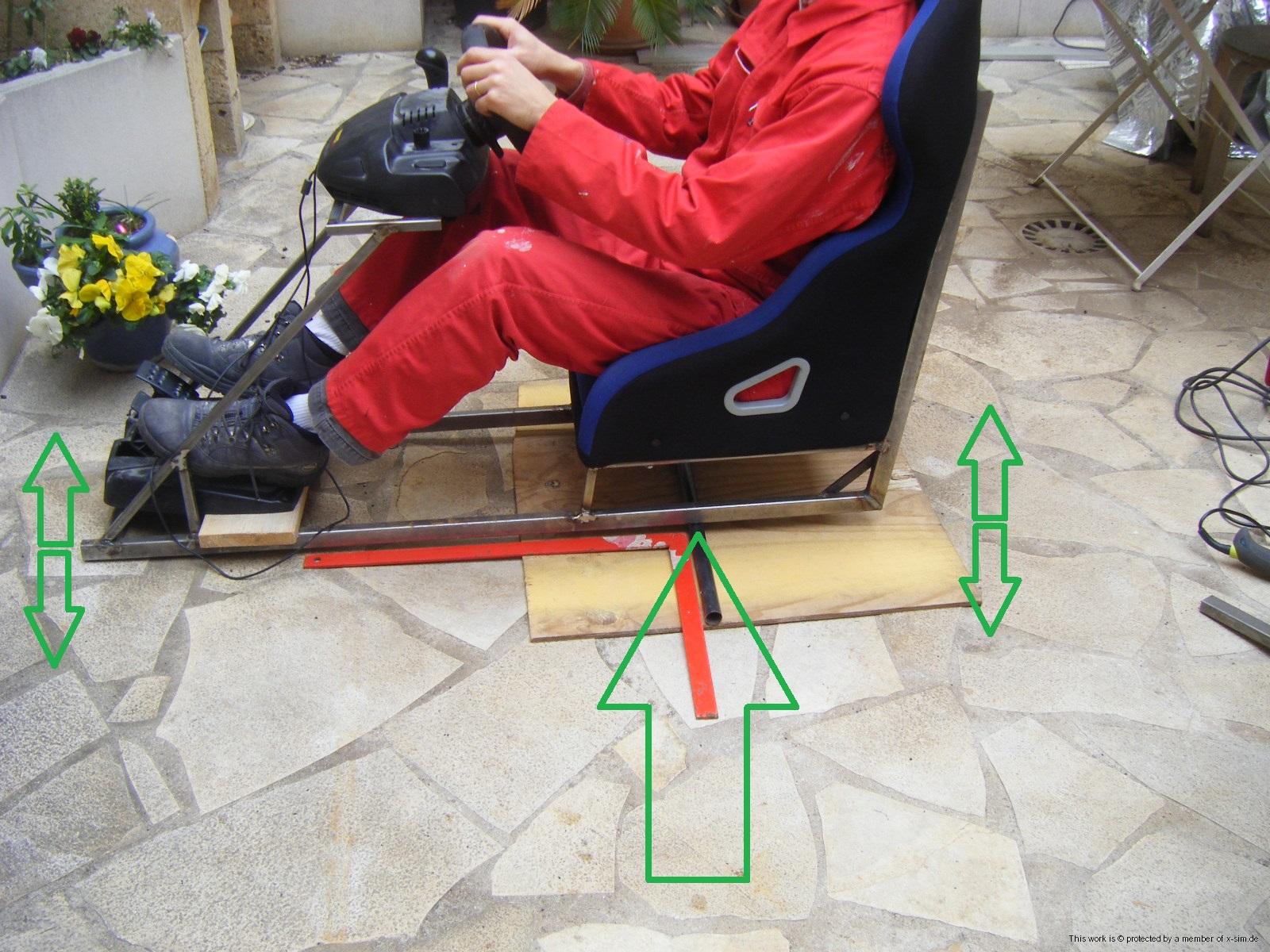

    @bsft posted an awesome video of a foot mounted motor platform which I really liked the movement of.
    Thanks @noorbeast - I an doing a rough design of the sim which I will post here soon.
    What I can't seem to figure out in my head is the weight/COG maths.
    I keep seeing the sim like a wheelbarrow where the foot mounted motors are the handles (so to speak.)
    You can move a wheelbarrow easy from that point (the handles) as the weight is over the wheel (pivot)
    However, try that from the loaded end and it would take way more effort.
    I only post that observation as an example as I'm trying to understand the dynamics of it all :)
  17. noorbeast
    21,592
    151,215Coins
    Yes a foot mount will work, just keep the mount point for the motor rods above frame height, as per @bsft's original.
    A round pipe is a far easier way to determine the COG than math, and a lot more fun too, just include yourself, controls and anything else that is part of the rig and have a mate roll you and the basic frame back and forth to find the COG.
  18. bsft
    Make the motor mounts a bit higher of the frame, so its above toe level and space the motor wider than the 450mm I had them at and 25:1 with 40mm CTC levers will move you no probs
  19. bsft
    as per instructions, set everything up on the frame and roll him on a piece of pipe to find the balance point, then make a mark, and put the pivot under there.
