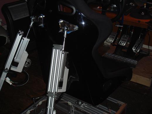

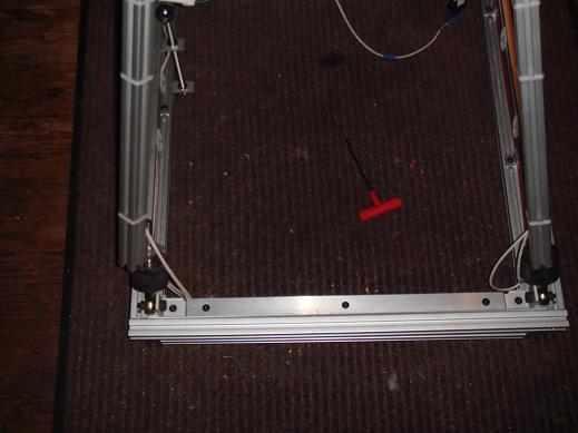

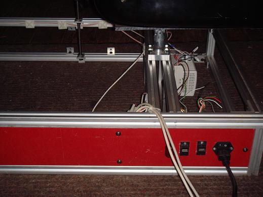

    well i FINALLY finished my simulator. :yippiee: its been a while but i can finally say its done. i've been at it all day. :lol: this thing is wicked. i love every minute of it. really takes sim racing to the next level. sweepers and fast chicanes are awesome in this thing. the cork screw @ leguna seca is taken to a new level with this seat, really crazy throwing you left and then right so fast, almost feels like the car is loose. its amazing. once again thanks to everyone for their help and continued support. special thanks to sirnoname, you are an awesome dude. and the community as a whole. i'm hoping once i learn how to make profiles, i'll share them with the community so we can all have something from each other. here are a few pics, its not completely finished, eventually i wanna put these through usb so i can hook them right up to the frame. i'm gonna put red plastic around the whole base with yellow inserts. then i'm gonna put a piece of clear plastic on the top section and put racing decals of the sims and gear i'm running. right now still testing all the fittings and making sure nothing gets loose. sim feels perfectly balanced and really throws me around good.
    heres a few pics. i'll post more updated pics when i complete the project, shouldn't be to much longer. i'll should be testing this thing like crazy from here on out :D

  10. RaceRay
    Nov 8, 2006
    4,657
    Hamburg, Germany
    23,876Coins
    +2,046 / 13 / -0
    Wow, looks really superb!
    From where where you got that pivot pivot?
    Nice idea to encapsulate the PSU within the hole frame with the PSU connector! :eek:

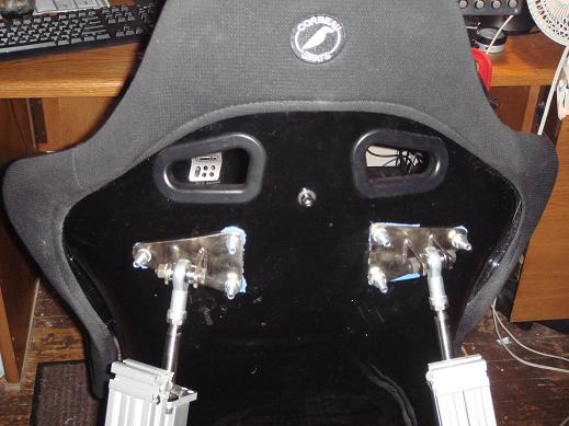

  13. Fahim
    Fahim Member
    Dec 11, 2008
    472
    523Coins
    Those two brackets on back of the seat where the actuators hang from. Did you make them yourself or can you buy these from a shop?
    I need 2.
  14. danknee
    danknee New Member
    Jul 2, 2009
    0Coins
    Great execution. I wanted to second the question about your source for the two brackets on the back of the seat. Also, would you mind indicating the exact u-joint and the specific brackets you utilized with the joint? Thanks in advance.
  15. njracer
    njracer Member
    Dec 31, 2007
    125
    2Coins
    hey guys, i got the back brackets made at a local machine shop. they're a little expensive though, 375 for both of them total. the guy did one helluva job imo, but they are designed around the corbeau fx1 seat. they match the curve of the seat. if you guys are interested let me know, he kept all the dimensions on file so if anyone wanted i could have them made up and send them. they are expensive though, so idk, it'd be cheaper to just do the t-slot way prob, idk if it makes a difference having the bracket directly on the seat. i'm sure it helps somewhat as there is no play in there. i'm in the process of getting a furnace to melt metal, once i have it up and running i'm gonna try and make my own brackets, if all goes well i'll be sure to post them. will be a helluva lot cheaper to as i'll be making them myself, and they won't be hand made every set.
    as for the universal joint, i'll post back tomorrow, i have to look it up all the dimensions of everything, you gonna need the u-joint, the rod to link them, and the mount to but it in on both sides. i'll post everything tomorrow. its a little late, i'm a little drunk from celebrating july 4th. be sure to post tomorrow.

  16. egoexpress
    egoexpress Active Member
    Dec 13, 2006
    3,839
    Germany - Frankfurt/M
    421Coins
    +10 / 1 / -0
    @Fahim
    You need a hardcase seat for such brackets. Afaics, your seat has a softcase...
