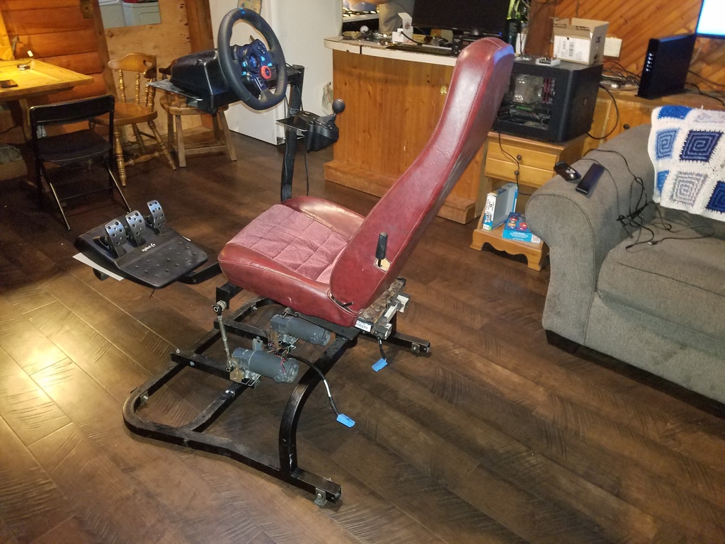

    Thanks to the help of this great community I have finished my Motion Simulator. I had a blast building modifying tuning and sharing this rig. Here is some video

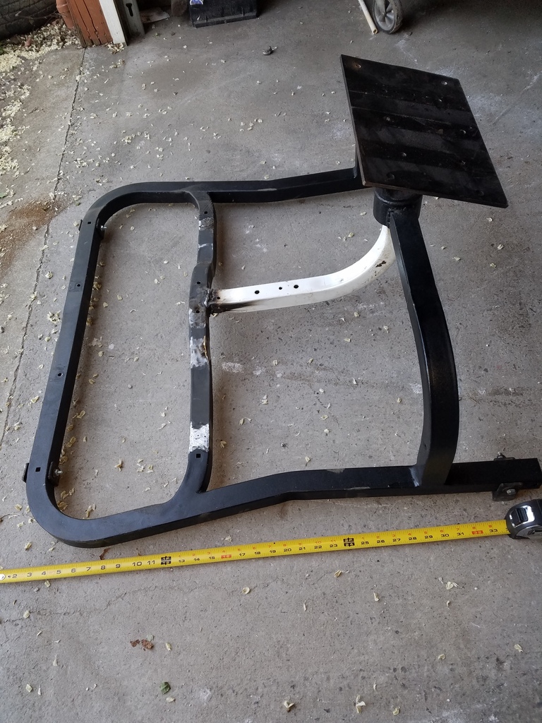

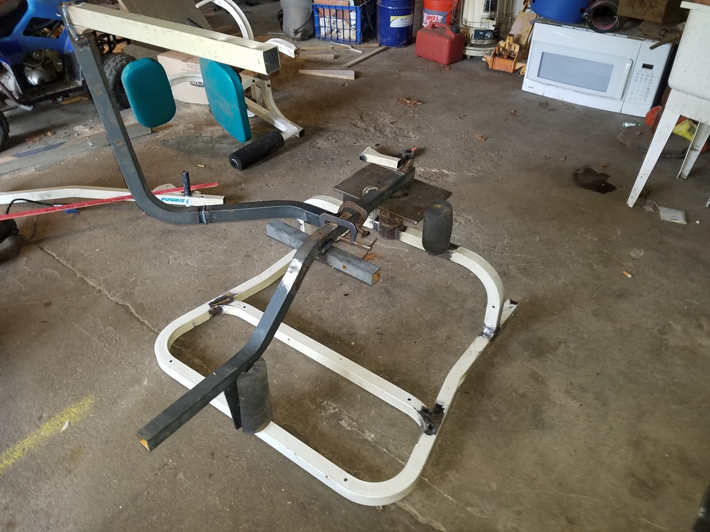

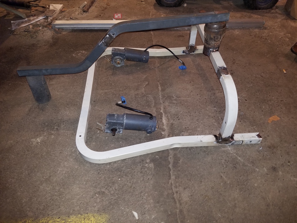

    Started my first motion sim chair today. Got the base welded up and added an old driveshaft uv joint. Scavenged up some 24 volt wheelchair motors. I dont know anything about electronics. With these motors looks like i need a sabertooth 2x32 and an adruino.
    I feel pretty good about the project so far. Especially the welding. First time with a mig. Thank God for blending wheels.

    I'm guessing that all or most of the steel frame has been salvaged from the exercise machine that can just be seen in the background?
    Very interested to see if the microwave also makes it into the build! ;)
    Excellent work, looks really good. I personally prefer seeing steel bent through 90 rather than welded as it gives a more commercial look. IMHO I think that your sim has the potential to be one very professional looking build.
    :popcorn

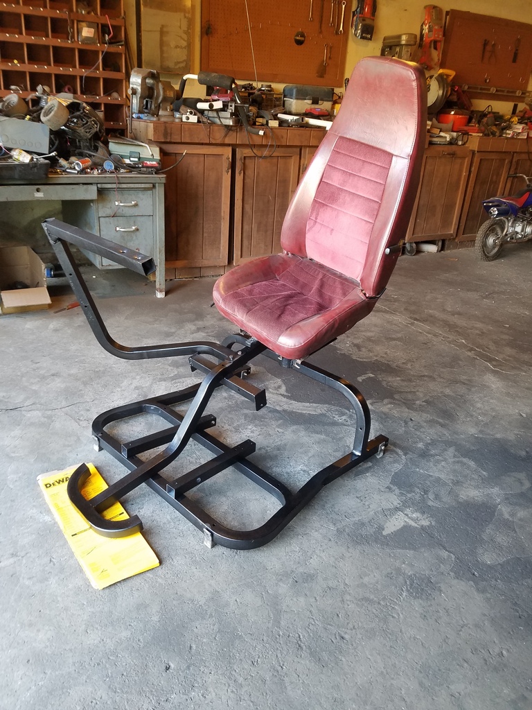

    Ok day 3. Chair is all fabbed up. Finally spent some money today. 2 cans of spay on Berliner.
    Now the hard part. I need to order the electronics. Can I use led switching power supplies? Any guess on wattage? No info on these wheelchair motors.
    Also, what do you guys use for motor arms?

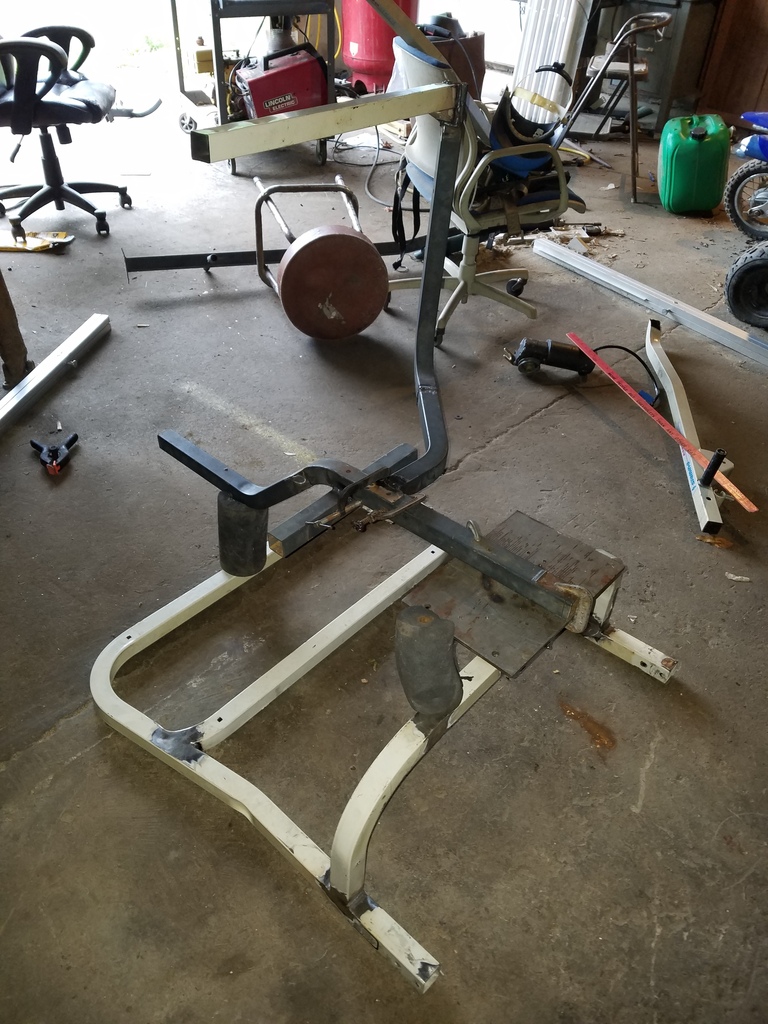

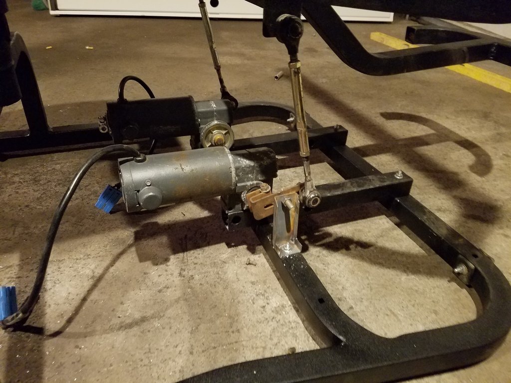

    Day 4. Found some actuator arms that were the right size. Found 2 tie rods that were a little too short. Made some temporary locks so I can use it static while I order parts.

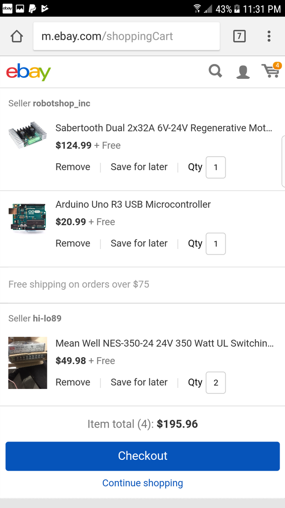

    So for parts this is what I think I need. Look right?
    And these I'm not sure of

    Your parts list looks good to me, you may need another PSU but you can just get an extra one if needed and put it in parallel if needed :)
    Edit: You have put x2 PSU's my bad :D

    Ordered parts today, changed the power supply for 1 600 watt meanwell.
    Got some numbers from the chair. 10 degree x2 pitch and 15 x2 roll. Pivot is 15" from mount, 14" wide. 3" ctc and 10" tie rods.
    Cg is good, chair will stay put just from motor resistance. It's also adjustable but right on for my position.
    Ran numbers through the sim calc thing I found here and looks like I'll probably need seatbelts. I don't have good numbers from these motors but every thing looks good so far

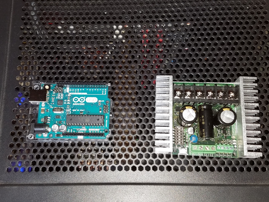

    Mailman left a present for me today.
    I'm kinda intimidated. First thing sabertooth was not recognized on a usb 3.0 port. Switched ports and got it working with describe. My ps will be a while so I might play with some rc stuff. I need to read some more posts on these things.

    Success. Wired up everything and tested with a 12v motor and power I had around. Made it all the way through the first setup. I can control a motor by a pot. Fast, slow, forwards, backwards. I'm super excited.

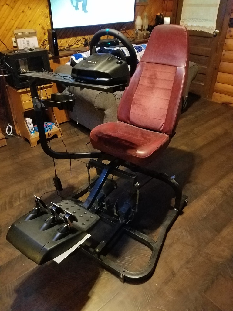

    Finished the fab work. Out of the shop into the house! Just waiting on the power supply.
    Took a couple nice pics

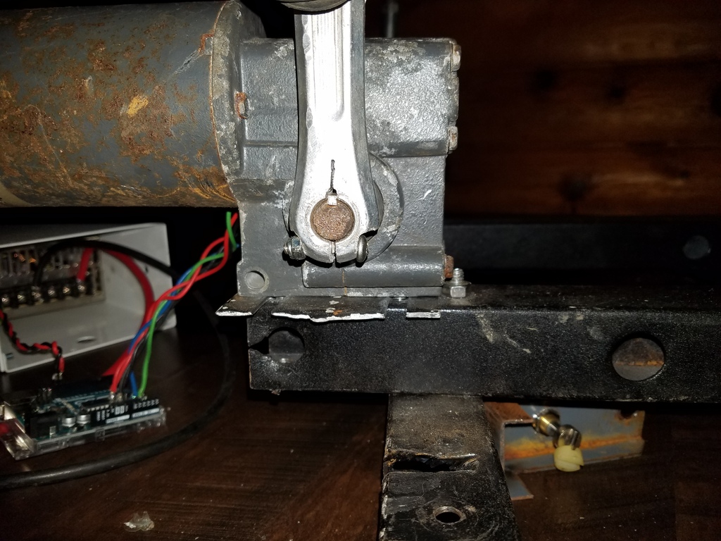

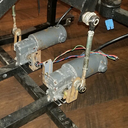

    Power supply came in today. This thing is a beast! Had some issues with a pot coming loose and had a few rotations. Had the whole thing hopping! It has to weigh 200lbs. I am just shy of 300 myself and it throws me around too.
    And I was worried
    That said, I need new motor arms. These are already bending. I think I need to bite the bullet and buy 2 1/2" keyed shaft hubs and weld up some steel arms.
    I don't have my sim tools licence yet. Going for the diy one and am about 10 days shy on time.

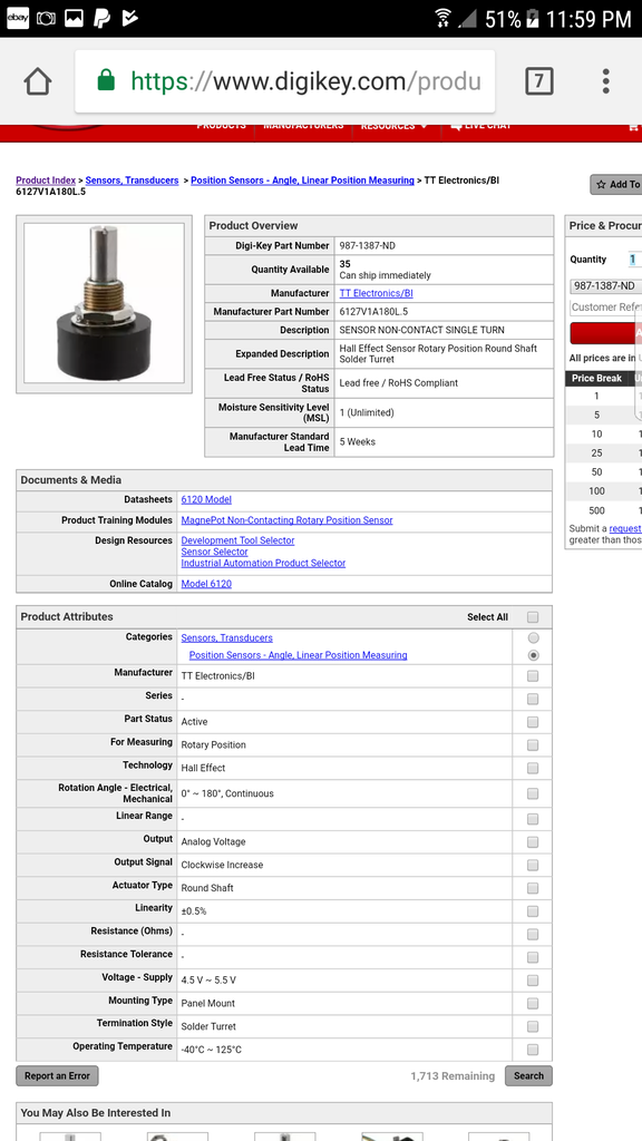

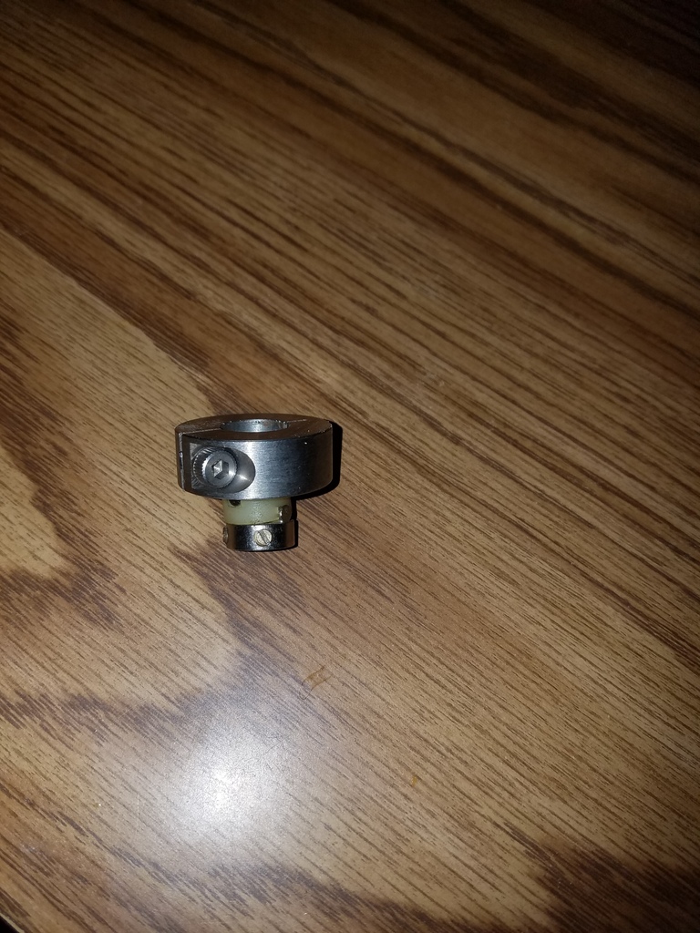

    Tightened up some of the issues. Made new arms out of bike pedals. Had to make the clamp setup and keyway.
    Then I found some wobbles for the pots and a collar that fits the motor shaft and wobble.
    Should be a lot easier to tune now

    Some more patch work today. Changed motor mounts, added some bracing.
    Now I'm trying to tune it. Have the pots all right but seem to pick up constant small variations, even with everything off. Can't seem to get it to tune at all. Oscillations everywhere. To be honest I'm just starting this but I had it way better before. It could hold position at least. And I could move it with the slide. Now I can't even get it to home.
