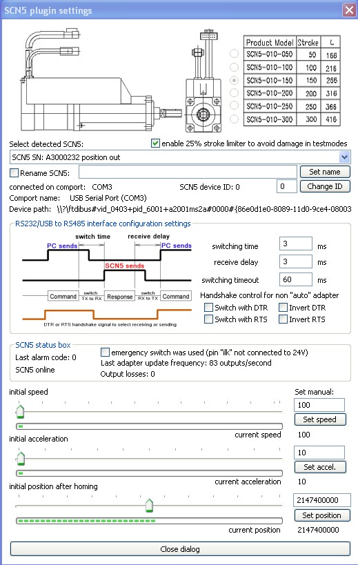

    Fahim I answered your previous mail on the software thread a copy of which is below. On your question about the dampers I have copied Bernard's idea and placed rubber dampers between the seat frame and the main frame at the back which seems to absorb quiet a bit. As you can see my main interest is FSX FlightSimming which does not require as fast a motion as the cars. I have almost got a profile ready which I will mail in in the next day or so with a few problems which I have encountered.

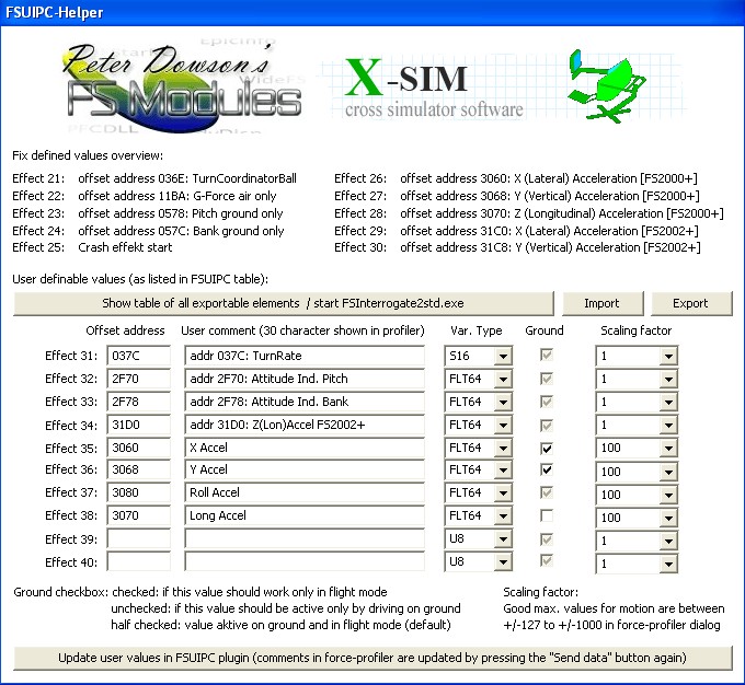

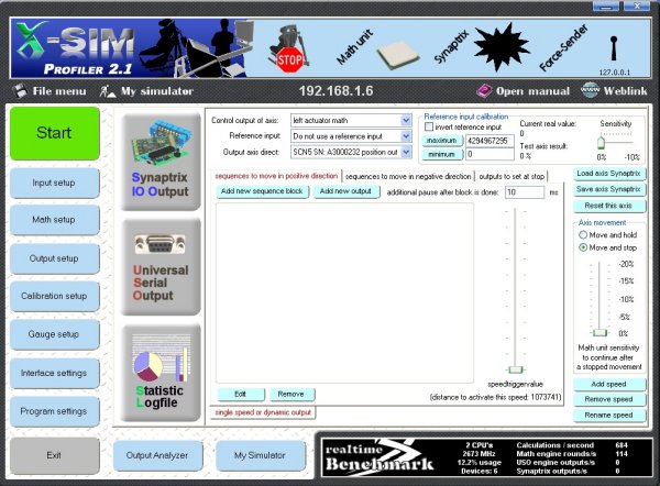

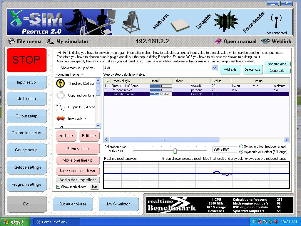

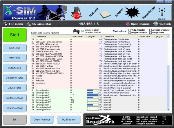

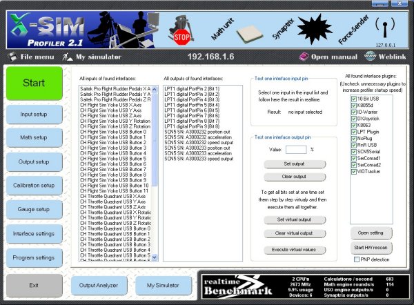

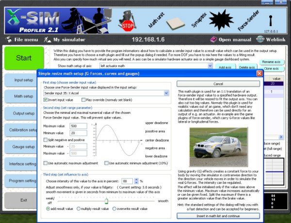

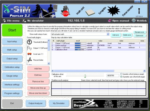

    Thanks to Chris and Egoexpress I have been able to create a profile for FSX FlightSim suitable for a Boeing 737 and I attach a copy of same below. I have also included a copy of settings which might help the Gurus on this subject to offer suggestions to improve same. As we know most of the members are involved far more with car motion than flightsim but from what I have learned so far the basics of creating a profile with X-SIM are very much the same regardless of type and I am hopeful that members like Bernard and lots of others who have created fantastic car profiles will put on there goggles and help!
    I should explain that there are three FSUIPC Effects that I feel are neccessary to make a FlightSim Profile worthwhile and they are as follows ;
    1. Effect No.35 ( This provides the motion to Bank the plane ether Left or Right )
    2. Effect No.36 ( This provides the motion to Pitch the Plane Up or Down )
    3. Effect No.38 ( This provides the motion for Acceleratin or Braking on the ground )
    Now a few mails back Egoexpress advised to only try one effect for starters and to progress from there, he was dead right. Chris advised to create each effects independent of each other and tweak them to an acceptable level before attempting to combine them, he was also dead right.
    I did what was recommended and created and tweaked effect 35,36 and 38 independently and had them all working as independent profiles at an acceptable level , I then tried to combine them and that was where everything turned upside down. The movements were all out of sync. and other movements came on the scene which bore no connection to the planes movements. I feel I tried every concievable combination and every option I could find to try and make them compatable but with no success.
    Finally I saw that there were three options one could use with the FSUIPC effects and they were as follows 1. Effect to be used on flight only. 2. Effect to be used on ground only. 3. Effect to be used for flight and ground (Default). I decided to cheat a little bit and confined Effect No.35 to Flight Only and Effect No.38 to Ground Only and then combined the two in the one profile. BINGO, it worked and both of these effects are working fine in the profile attached below . I am afraid I could not include Effect No.36 or it would have spoiled the whole profile as described above. Can anybody help with this ?
    The profile attached with just two effects, 35 and 38 works pretty well but if I can be a little critical of my own profile I would describe the folllowing. If I bank to the left the seat motion and the plane movement are in perfect sync. but if I then bank to the right the motion of the seat will continue to the left until it reaches a certain point and then change the motion to the right, when it arrives back in center position the sync. is perfect again. The same applies when I bank to the right. Any suggestions ? On the Acceleration and Braking on the ground with the other effect (38) the forward and backward movement apply but they are far slower than they should be. I can understand this as I have had to reduce the Main Interface Settings dramatically to provide the appropriate sync. for the Banking, however I wondered is there some way that you can speed up the acceleration and braking motion on this effect without changing the Main Interface Settings as this would put the Banking way out of sync ? I have tried a comprimise in the settings with values but I am afraid that they are miles apart and when one is acceptable the other is not. I have also tried Threshhold and Percent but with no luck. Any help or suggestions would be most appreciated.
    Kind regards
    Toni

    Intended Sim Hardware: 2 SCN5 Frex-Style design
    Actuators: 150mm
    25% Limiter: Yes

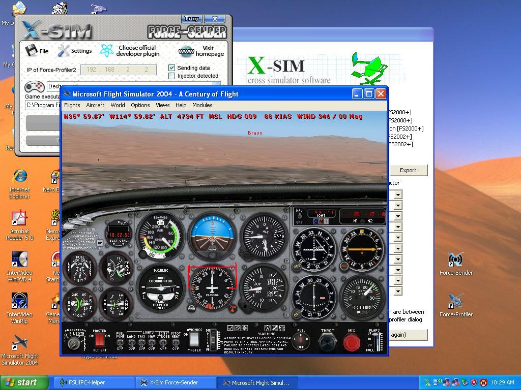

    Greetings, :)
    Good work, I'm working on a Joyrider configuration and enjoyed your presentation, even though the one I'm working on has motors and uses USO. I've got a question for you, when I do a 2 minute turn on my rig, half way thru the turn, I get a complete reversal of the direction of the sim (left to right), any comments on this phenom.
    jsmith2307

  13. jsmith2307
    jsmith2307 Member
    Oct 2, 2010
    105
    Respiratory Therapist
    Corpus Christi, Texas
    324Coins
    +7 / 0 / -0
    2DOF, DC motor, Arduino, Joyrider, Motion platform
    Greetings, :)
    Thank you very much for responding,

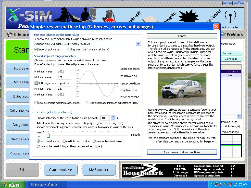

    I same get the output on both Profile2 and X-sim Converter with no difference. I tried to make some sense out of your profile Goshawk T-45 Banking and I think I've got a pretty good idea, but I used Extractor input 29: addr 31C0: X Accel. FS2002+ .
    Description of the problem: lets say I'm making a left hand turn, the sim starts out in a left hand turn for 90 degrees and gradually shifts to the right all while FS2004 continues in a left hand turn, if I continue with the left turn the sim gradually reverses back! The same thing occurs when it turns to the right.
    When I'm going 180 degrees in a different direction, the sim starts out going right when I put in LEFT INPUT on the controls, and it gradually reverses itself. Very confusing!
    jsmith2307 :?
