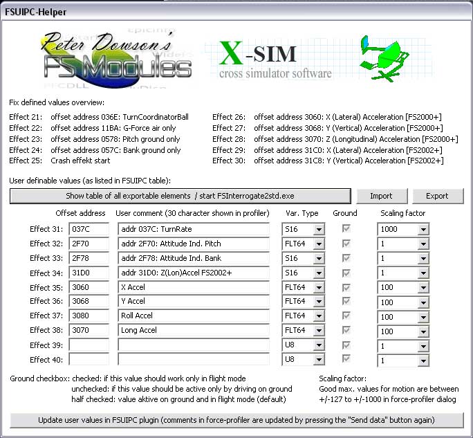

  5. CXCSimulations
    CXCSimulations Member
    Dec 19, 2008
    143
    - 9Coins
    Ok, Here are some basic instructions:
    *Launch Force Profiler
    *Load my attached profile
    *Click Interface Settings
    *Click on the SCN5 plugin and set the Speed to 18000 and Acceleration to 15 (these are extremely low numbers but they are a work-around I'm using to a problem mentioned in this thread: fsuipc-output-speed-t1831.html )
    *Launch Force Sender
    *Select the FlightSimV2 Plugin in Force Sender (A new window will open when you do so)
    *In the new window, add the values listed in the attached screen-shot (full disclosure: my profile doesn't even use all of these but I forget which ones it does, so just add them all for now. Later we can clean this up)
    *Click Update user values in FSUIPC plugin
    *Leave this window open, go back to Force Sender and click Try send data
    *Go back to Force Profiler and Click Start
    *Now launch FSX
    It should have motion now if everything worked well. My hope is that it does, and together we can work out an even better motion profile. The one I have is really just a quikie and only was really tested on the F-18.
    A bit convoluted, I know, but it is DIY software :) If your looking for something a bit more user freindly, you might look into this project here: simxperience-commander-for-x-sim-nearing-beta-stage-t1416.html
    It's still very much a work in progress (and I have yet to make FSX work with it) but it is great tool when you get it working. Makes things very simple.

  12. CXCSimulations
    Dec 19, 2008
    143
    - 9Coins
    I think I understand now; with such a big (cumbersome) plane, you don't think there is enough acceleration g-forces?
    Ok, then. I have some ideas for motion of this type. I think you want X,Y,Z Position (or whatever is is called in FSUIPC) rather than X,Y,Z Acceleration. This will give you the plane's orientational relationship to the ground rather than it's change in g-forces.
    I'm not at work this weekend (where our simulators are) but I can look up the values for you when I get back. I should be pretty easy to substitute the new values for the ones I have in my profile.
    To me this seems incorrect to me though. The reason is, when I am in a commercial airliner, if I'm not looking out the window, I have no idea of our orientation. The only thing I feel is the g-forces when the pilot makes a change to our orientation. After the change, the G's go away.

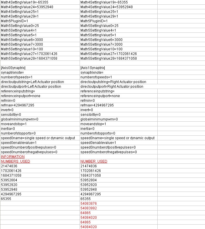

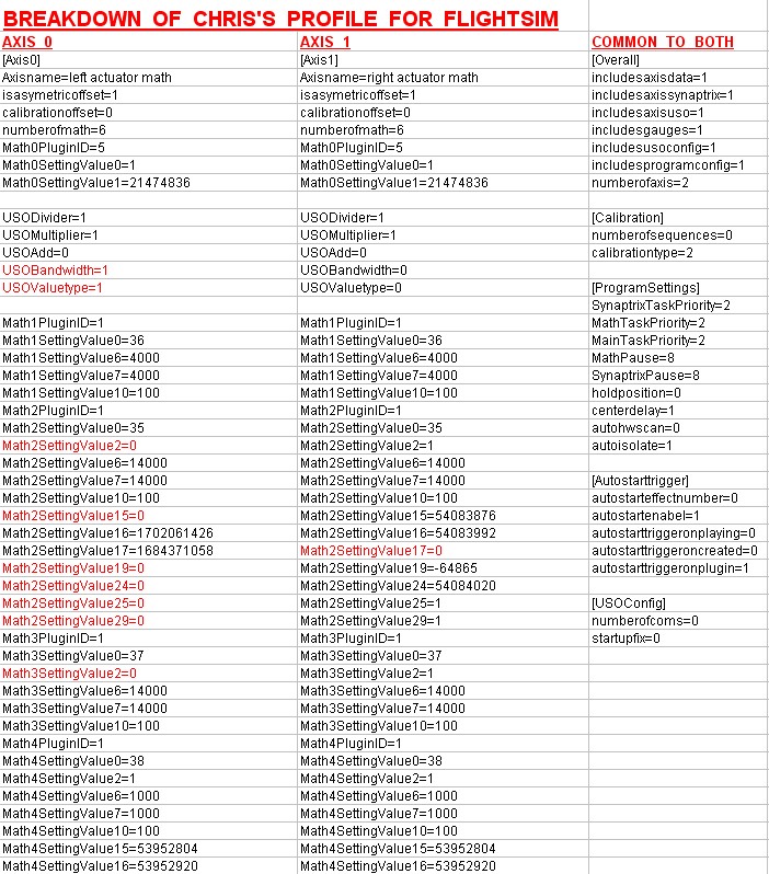

  15. toktiny
    toktiny Member
    Jun 21, 2009
    74
    - 20Coins
    I have done an edit of Chris's Flightsim Profile as you can see below. The main reason is that I am trying to understand how a profile is created so that I can attempt to create a new profile which would be more suitable for my needs as explained in previous mails. I have removed from the profile the sections which I dont think contribute anything to it and to reduce it to a more workable size. Now the efffects, numbers 3060,3068,3080 and 3070, which are acceleration effects, have been installed into this profile through FSUIPC but I can not see where there is any reference to these numbers anywhere in the profile which was created by Force Profiler .I can only assume that Force Profiler has renumbered these effects to its own set of numbers.
    In the photos below you can see that I have highlighted what I think are these new numbers at the very bottom and those in black are commom to both axis whereas the ones in red are only used by Axis No.1. Could someone please explain in as simple terms as possable what is the process that one goes through in creating a profile ?
    What all this boils down to is that : 1. I have completed the building of my motion platform. 2. I have tested it and mechanicaly it works perfectly 3. I am unable to create a flightsim profile that suits my setup simply because I cannot grasp how you go about it !! By the way I have read the manual and other threads on site several times.
    Much appreciation for help to overcome this final hurdle.
    Toni

  18. toktiny
    toktiny Member
    Jun 21, 2009
    74
    - 20Coins
    Chris you have put your finger on it and perhaps had more courage than I have to ask for more help in this area to be available. I have scoured all of the various threads in the different sections of the forum and I would say that there are more requests for guidance and explanations on the creation of profiles than most other topics. Several of the members who are most talented with this subject have ,with the best will in the world , have said they would provide an easy to understand explanation but I can understand that they have discovered new areas of motion platforms to explore and need the time to do this, however , I feel if us dummies could get past this part of the overall scene there would be a lot more we could contribute to the forum on the improvement of motion platforms but at the moment I for one (and I am sure a lot more like me ) am just snookered. The way I would describe it is that I have built the hardware, installed the fantastic software so kindly provided by our gurus but have not got the key to start the engine !!
    If you look in the profile section you will find that there are very few creating there own profiles , yes certainly there are plenty useing profiles provided by a small number of members and tweaking them to there own taste and requirment. I feel that if these members, like myself , could be tutored in a basic way to understand how to create a profile we would see a much larger and varied selection of profiles in the profile section for everyones use.
    Now you asked Chris how you could help and even though you admit that you are not in full understanding of all the aspecs in the creation of a profile, I can assure you that I am way behind you and you could help me with the following ; (when I catch up with you all we can do then is to keep appealing to the Gurus for help !! )
    1.Starting with no Profile loaded and you get Force Profiler started and transfer from FSUIPC any new effects that you require.
    2. I understand you use output1:1(GForce) to get your effects into Math Setup. Now when you select Sender Input No from this does it bear any relationhip to the effect no. in FSUIPC ?
    3. When you choose Max and Min in this I presume that this designates the range that you wish to give to this effect and depending on what the efect is it will vary ? Could you give me some idea as to what the difference in ranges might be e.g For braking on landing Max : 300 Min : 10. whereas for full left or right roll Max:1000 Min:1 ?
    4. In what order do you give these inputs and when you have one input completed how do you confirm it and move onto the next input ?
    5. If you remember you said you would look up the effect nos. from FSUIPC for to provide orientation. Coould you explain how to get these ?
    To put it in a nutshell if you could just put in the proper sequence how to arrange and input effects I would be most grateful. You could just take as an example one effect, does not make any differnce which one.
    On your question of how I made the tables in my last mail. It is ver simple , Just open the Profile M2 file with WordPad, edit any entries that you feel do not provide any usefulness e.g. Equals Zero,then select the appropriate section and transfer it to a titled column in Excel and then just dress up the spreadsheet the same as you would any other spreadsheet.
    Looking forward to hearing frm you.
    Kind regards
    Toni
  19. CXCSimulations
    Dec 19, 2008
    143
    - 9Coins
    Yes
    Yes. The Effect Number is the same in FSUIPC and Force Profiler. FSUIPC comes with some pre-assigned effects (21-30). It also allows you to add your own from the FSUIPC Table (Effect 31-40). - Remember to Send a Test Signal with Force Sender in order to update Force Profiler with any changes you make -
    This is the trial and error section for me. I had to play with these a lot. Based on my testing (and skipping those I don't know):
    Invert input is pretty simple. If the axis is reversed on your motion rig, simply check this.
    Range is the range that x-sim will use of output info that the game is sending out. Now, I've seen some reference of people actually measuring this somehow by running the game and pushing it to the limits, but I havn't figured out how to actually measure it myself yet. Until I do, I simply guess a number and test it. If the motion (extents that the actuator travels - not speed or acceleration) is too much, I increase the maximum values. The minimum values are good for removing any unwanted noise (great for some racing games)
    Split negative and positive means you want a different range for the negative and positive. A good example of this would be if you wanted more braking feel than acceleration in a driving game.
    Intensity seems to adjust the speed at which this axis is fed to the actuators...I'm not entirely sure about this one, so I'd love a guru to chime in here.
    Clicking the Cancel does just that.
    Clicking the Insert in math list and continue button does just that.
    The rest are a complete mystery to me.
    It seems to me that any modifiers are applied from the bottom-up. IE: if you add a Washout filter, it will only apply to the plugins above it in the list.
    See above for continuing.
    Well, the first place to loo is in the default Effects list (Effect 21-30). If you can't find the effect you want there, then you need to create a custom one.
    In the FSUIPC window, click Show table of all exportable elements this will give you a table of all the effects available through this plugin.
    Pick a blank Effect (31-40) and paste all the available information.
    The only blank I don't fully understand s Scaling Factor. I think this means how many steps this effect will have, but I'm not sure.
    I think I've armed you with enough knowledge to do this on your own now, so let me know how it goes.
    The only other thing I would suggest is working on one effect (isolated) at a time in order to get it feeling how you want before you move onto the next one. This prevents other effects from altering your perception. Only at the end do I combine them all and make group changes from there.
    I hope this helps. I'll be out of tow for a couple of weeks, but I'll check in from time to time to see how this is going :) Good luck!
