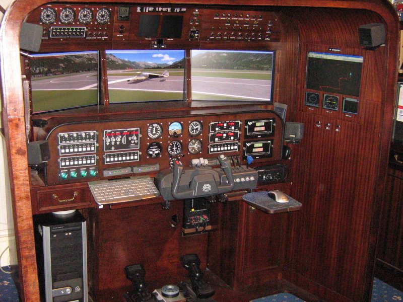

    Many thanks for your reply but I am afraid I have no intention of including my current cockpit in the motion platform. The platform would be really a replica of Mr Burns platform with no more to provide motion to than he has.In other words the platform is totally independent of my existing cockpit, you would need an elephant to even attempt to support it !
    I attach a copy of myexisting cockpit to give you an idea of what I am trying to do.

    Wow wow and then some thats some nice work and kit you have there, now i understand what you ment :) ok Platforms are out Lateral thinking now on my part required :) impresive work Congratulations on getting that far im still dreaming and making ( always making never finishing LOL:) )

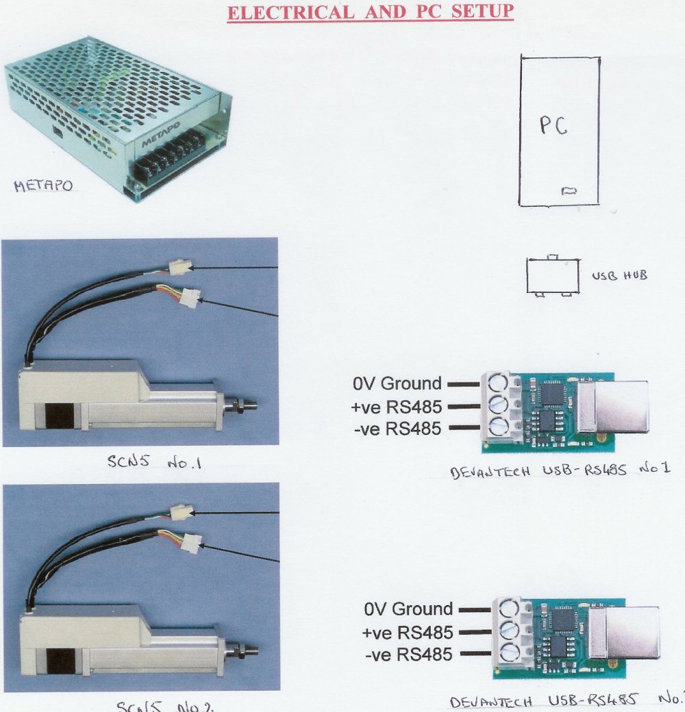

    I have Two SCN5's , Two Daventech USB, One 6.4A Metapo Enclosed Switching Power Unit and the Rod Ends and Brackets on the way, however , as I said in my first mail, this is the part that scares me. I have attached as much info as I can below and wpould be more than grateful if someone could help me with connecting up. I have read and seen nearly all of the invaluable help on this but can not find a wiring diagram for this combination of equipment . I should add that I have selected all of them from the recommendations taken from the site and am posative that from the members experiance it is the right one. I have not included in the items such things as cables between the SCN5's and the Daventech and the Daventech and the PC and power leads between the Metapo and the SCN5's but I assume that these can be aquired locally ?
    As regards the tweaking of the Profile and finer adjustments in the software this can follow later but for the moment while I am awaiting delivery I would like to know and get myself familiar with the wiring up of the components.
    My sincere thanks in anticipation.
    Toni

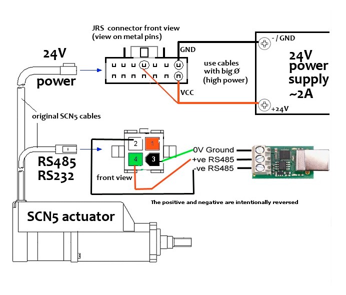

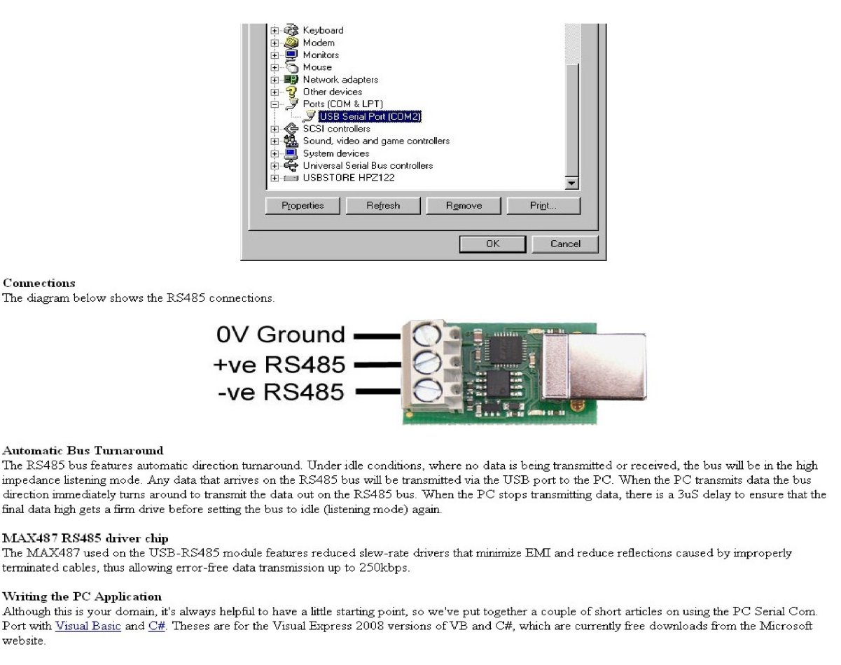

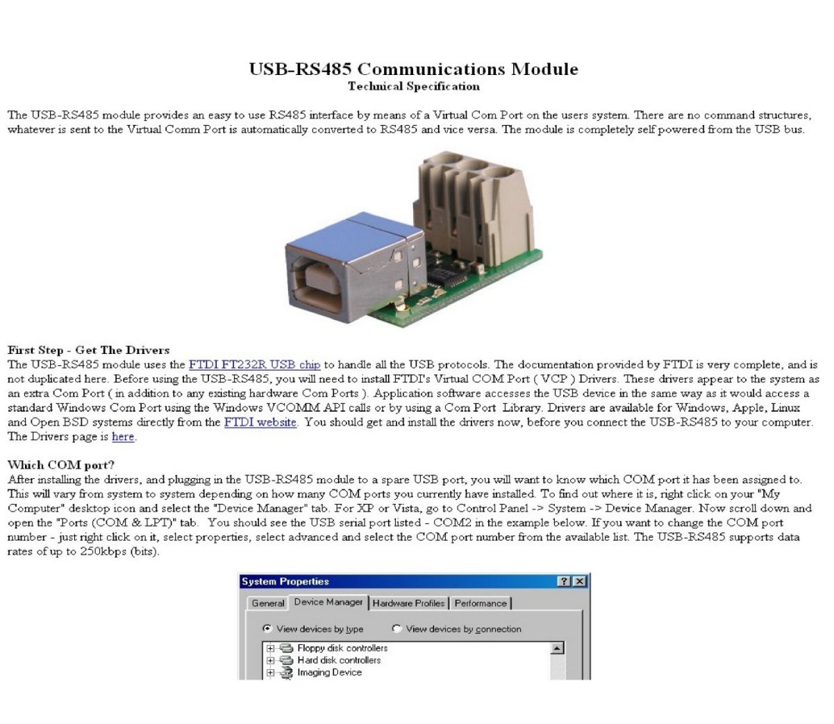

    In answer to your question about looking up diagrams , I have an individual file here for nearly everyone that has built a motion platform on the site ! I will explain to you , on looking over the platforms I felt that the nearest to what would suit my cockpit setup were those of Bernard and Mr Burns so I will take Bernard's one as he used a Daventeck USB to RS485. I have attached a copy of his wiring diagram below for reference.
    From what I have read I dont want to cut any wires on the SCN5's so I will use whatever alternatives are available to avoid this. I take it from the diagram that for power on the SCN5 the default connector is the JRS Connector and for data the default connector is the RS485/RS232. Is that correct ? Now in the diagram it is made perfectly clear what wires to use for these connections but what I am a little fuzzy about is what type of connectore can be used with both of these to provide a set of lleads that can be fed back to the 24V Power Supply and Davantech respectivly?
    Now Bernard includes in his parts list two DB9 Gender changers and I wonder if these are connected to what I am trying to say ? One other thing, he also includes in his parts list Actuator Power Cable can I assume that this refers to the connection between 24V POWER and 24V POWER SUPPLY in the diagram below and that Actuator Data Cable refers to the connection between RS485/RS232 and the DAVENTECH as shown below ?
    I am extremely sorry for what might be considered as stupid questions but being retired I have learned in my career that it is better to admit what you dont know rather than pretend that you do as it can make you look a bigger fool later !! Please be patient with me .
    Kind regards
    Toni

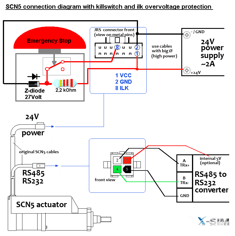

    33
    0Coins
    Re: Type of Platform for Flight Sim FSX ?
    It's recommended to add a killswitch and a zener diode for protection.
    More and detailed infos: scn5-hardware-thread-t1083.html

    in the hardware thread krümel mentioned you should find all answers.
    About the connector question: You can buy the connectors at components store (egoexpress knows where from). I only found the connectors to buy in high quantities which i didn´t need, so i decided to cut the wires (only the 4 needed wires , not the whole connector) If the actuator should be damaged in future i don´t belive that the manufacturer refuse my request of warranty only of the cutted wires. That would be not appropriate for a industrial product. In our case, there are other reasons why the warranty could be declined or not :)
