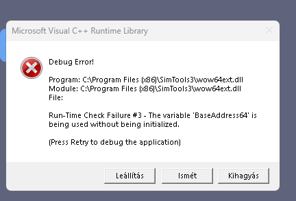

    It's not working for me, and I've reinstalled and tried everything below. If you have any ideas, I'm at a loss. Thanks

    Hello guys, I have this issue, no anticheat softwares, no anti virus active:

  4. Edusfilms
    Edusfilms New Member Gold Contributor
    Jul 13, 2023
    - 145Coins
    I have reinstalled the game several times on both the C and D drives and followed these steps as administrator:
    cd /d "D:\SteamLibrary\steamapps\common\STAR WARS Squadrons"
    rename starwarssquadrons_launcher.exe starwarssquadrons_oldlauncher.exe
    mklink starwarssquadrons_launcher.exe starwarssquadrons.exe
    attrib +r starwarssquadrons_launcher.exe
    But I still can’t get the motion platform to work with this game. I’m not sure what’s going on. I don’t know if it might be related to the fact that every time I launch it for the first time, Easy Anti-Cheat starts and blocks memory access.
