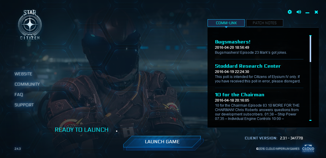

    Value1, I think the plugin is the wrong Version of plugin, could that be the issue I am having?
    see screenshot:

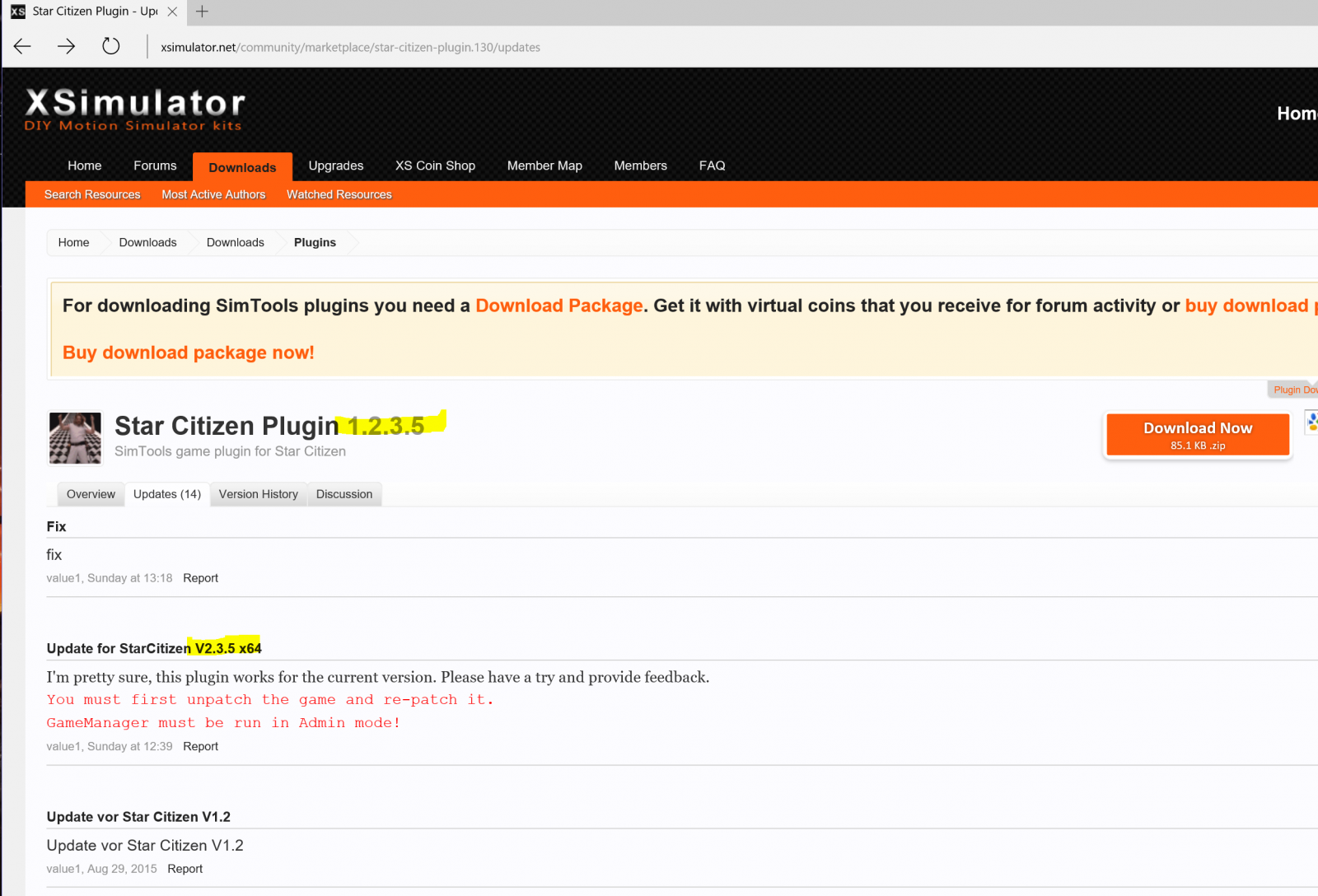

    If you are running the 64bit version of StarCitizen V2.3.5 the plugin should work.

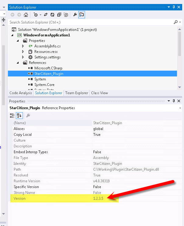

    Value1, I re-downloaded the Plugin and imported the "StarCitizen_plugin.dll" file in Visual Studio as a Reference and look at the Version number it shows Version 1.2.3.5
    You mention I should be using Version V2.3.5
    I was wondering if you can send me the direct link to the download for V2.3.5?
    in advance Thanks!
    Milton
    see picture for reference:

    @Milton I think you are confusing the plugin version number 1.2.3.5 with the 64bit version of StarCitizen @value1 mentioned, which is V2.3.5.

    you are correct! I am mistaken, I will check on the version I have and posted, I think it is Star Citizen Alpha 2.3.1 but not sure yet.

    The most likely cause for it not working is that you are not using the 64bit StarCitizen version 2.3.5 @value1 said the plugin works with.

    is the version of Star Citizen the Client Version on this screenshot?

    I've got the same. And it doesn't work for me... Maybe @value1 is on the PTU of star citizen?
