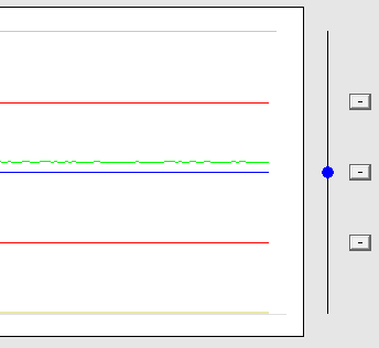

    I also have to scale the pots, but adding those lines (after the Feedback1 = analogRead(FeedbackPin1);) didn't help
    This is the max I get:
    EDIT: Nevermind, my fault: I just changed one feedback and I was testing the other one... :roll
    Thanks for the tip!

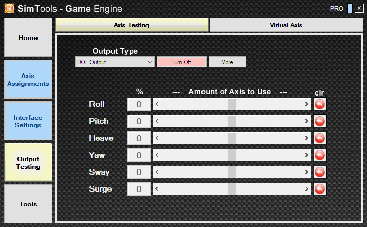

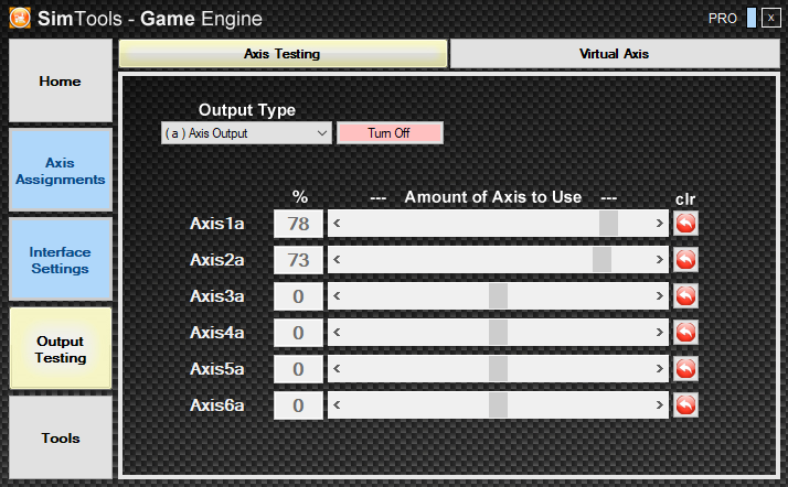

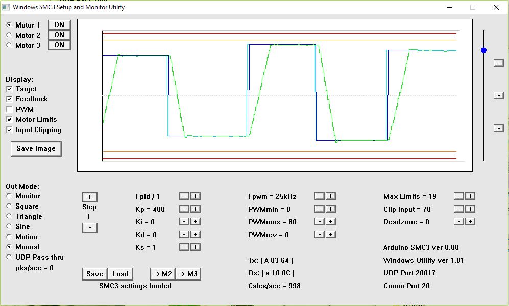

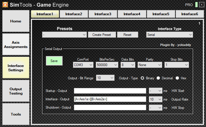

    I've hit another snag that I'm hoping someone can quickly diagnose. I'm able to get my motor to react as expected using the SMC3 Utility, but I'm getting nothing when trying to manually move it via SimTools 2. Below are screenshots of my setup. I have ensured that the SMC3 Utility is shut down. The SMC3 code at the top of this post is uploaded to the Arduino. The Arduino is connected to COM3. Any other thoughts on what I'm missing?
    My expectation is that I should be able to move the sliders in the Output Testing window (third screenshot below), and the motor should move accordingly.

    In the output testing panel choose DOF Output from the Output Type list.
    Everything else seems correct.

    Yeah, I've tried using "DOF Output" as Output Type as well with no luck. Thanks for the suggestion. Please let me know if you think of anything else. I'm wiring up an LCD and am going to dumb down the Arduino code a bit to see what kind of progress I can make.

    Everything else looks right so can you double check the ComPort is correct and shutdown and 3rd party applications like firewalls that may mess with running processes, restart SimTools and try again.

    Also, did you close the SMC3 app while testing Simtools? Run Simtools as admin?
