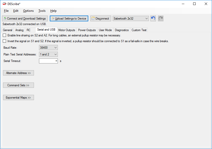

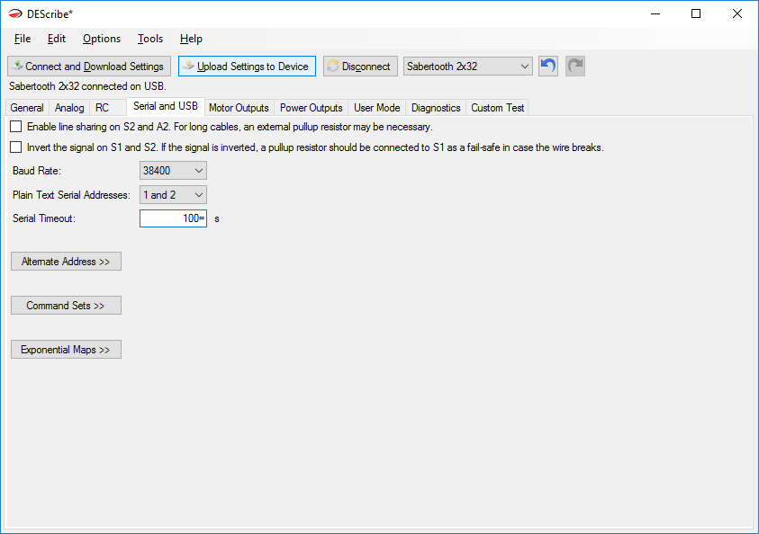

    +395 / 2 / -0
    2DOF, Arduino, 4DOF
    Sorry, I'd read all the thread and I can't find a fix for this. Any help? I can set up to 30, after that it goes to negative numbers.
  4. SilentChill
    2,645
    20,584Coins
    +3,566 / 34 / -0
    Just type I the number and when it saves it goes blank it's how it's suppose to be ; (
