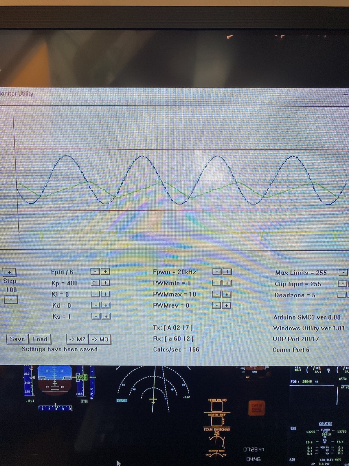

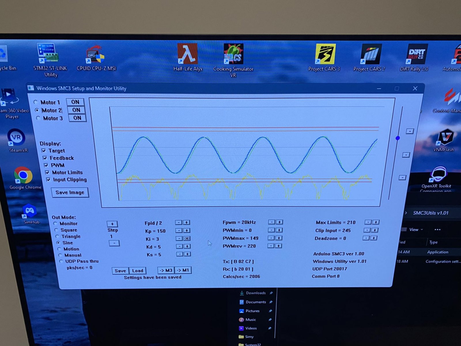

    I madę some upgrades in my rig so I have a little question. Im read everything here and I don't find answer. Change my drivers from cheap Chinese to sabertooth. I buy 2x32A I have two motors, 24V 350W each.
    My motors have a maximum operating current of 20A. I want to use an old power supply from telecoms for the power supply. Specifically, it is an ericsson 27.2V 1200W. The braking resistors calculated are 3.3Ohm this should dissipate about 200W of power for me. The output supports a maximum of 8A so there is no point in fitting larger ones. My question is will this power supply cope with these motors? Will it be necessary to use batteries? I wouldn't want to do this because the whole thing is supposed to be compact and such batteries take up a lot of space. After changing the gearboxes from cheap Chinese ones to SFU from DofReality the drivers and motors are cold after a few hours of operation it doesn't heat up at all. Now I have two cheap Chinese 24V 600W power supplies but I have the impression that they lack power when rapidly lowering or raising the platform because I can hear the fans inside the case slowing down to practically nothing. I don't know if it's the return current or the lack of power. On the graph in smc3 this manifests itself as a peak down past the clip and climbing to the set position. The motors are not braking fast enough. Is this a fault related to an incorrect pid loop setting or perhaps a power shortage?
    I now have the parameters as shown in the screenshot and generally everything is correct in the tests.

    Fan behavior is not a definitive measure, grab a multi-meter and a friend then check the PSU output under load.
    It is hard to say for sure but my guess is that kp could likely be higher and PWMmax and PWMrev refined.

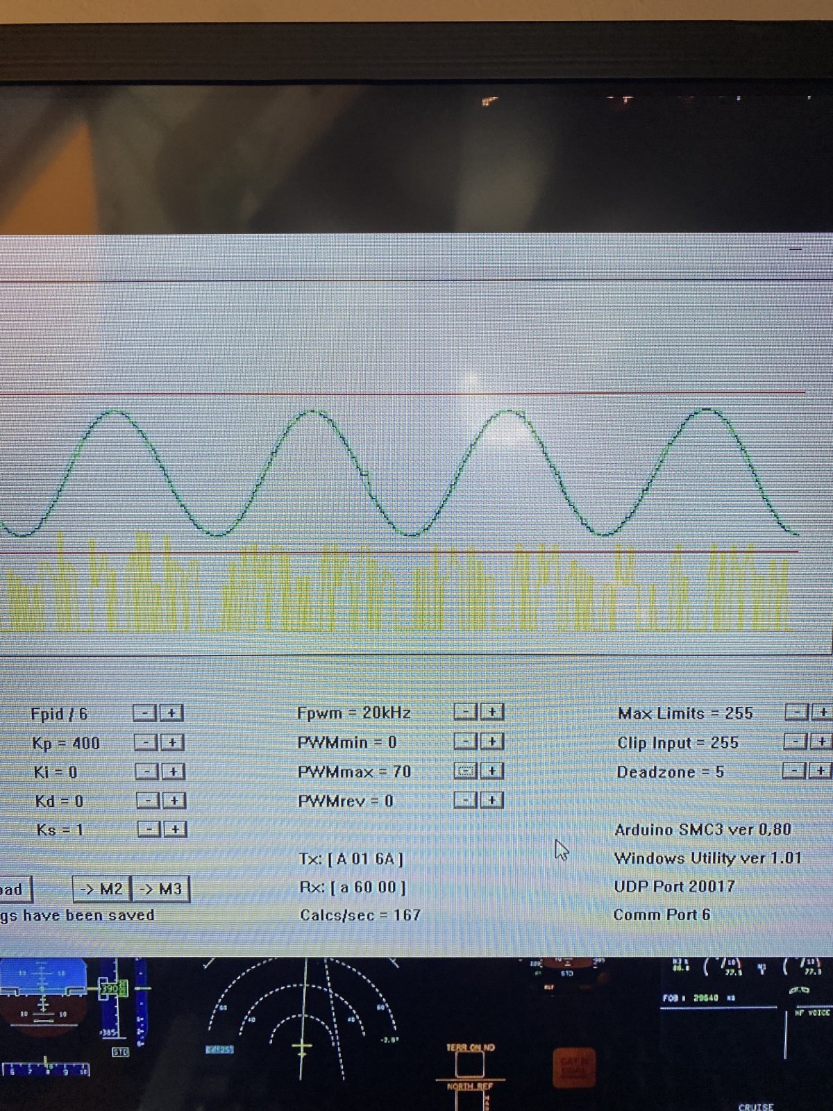

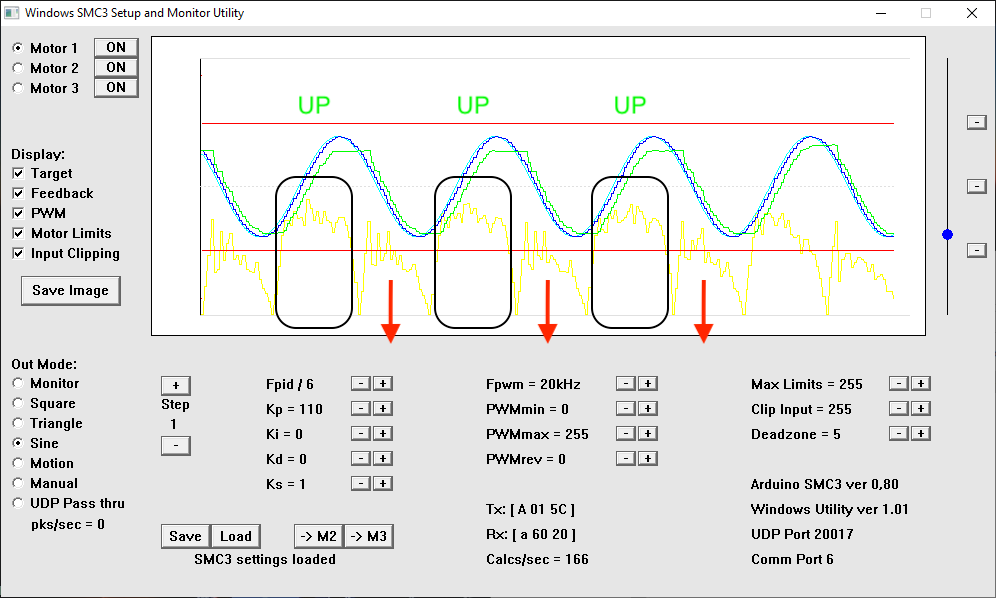

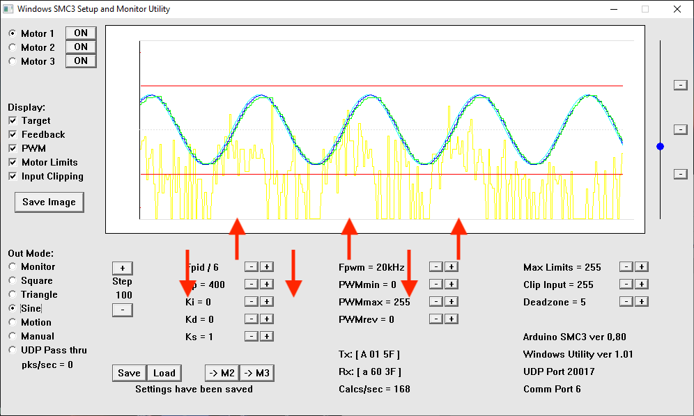

    Hello, I post a few weeks ago asking for help but seems nobody see my last post in my thread. Anyway, My build was done in January and since then I'm fighting first with cheap drivers that I solved buying and installing a couple of Sabertooth 2x60 and now with some strange noisy behavior that makes the rig unusable.
    Here is a link to a video showing what is happening with the motors. In this video I only show the behavior of one of the motors but all of them suffer the same problem.
    As you can see, when the motor lift me up run smooth, not perfect but good enough but the problem is when the motor drives me down it start to bounce. It happens as soon as the Kp start to be big enough to move the motor. I tried all the possible combinations with Kp, PWM max, Kd (nothing changes with this value), I even start with PWMax to 255 and then increase Kp and when it is around 80 the motor starts to move and start to do that bounces.
    And next I show you what is happening in SMC Utils
    There is the yellow line that (AFAK) shows how it is sending "force" to the motor to drive it forward or backwards and we can notice that when the arduino send the signal to move the motor up (squared in black) that signa is not perfect but as I said is tolerable. If we see the signal when the motor drives down (with a red arrow) that signa is very dirt.
    Don't care about the SMC values because it happens whatever the SMC values be, this is an example but it reproduces always.

    22,086
    154,124Coins
    +11,170 / 57 / -2
    What does the graph look like with the kp at 400?
  11. Josh_Possa
    Josh_Possa Active Member
    Jan 25, 2021
    135
    Catalunya
    614Coins
    +39 / 0 / -0
    Thanks for the reply. As far as the Kp increase the problem get worse:
    The red arrows indicate when the motor is driving up and when down. I also tried decreasing the PWMax but the problem stills. As soon as Kp is able to get the motor moving the problem appears.
  12. noorbeast
    22,086
    154,124Coins
    +11,170 / 57 / -2
    With kp at 400 at what vale of PWMax does the rig start to move?
  13. Josh_Possa
    Jan 25, 2021
    135
    Catalunya
    614Coins
    +39 / 0 / -0
    It starts to move at PWMax=17 without load
    To start moving if I sit on PWMax needs to be 70 (at this point the motor only moves a little not following the sine wave). If I live the rig without load it starts to bounce as crazy.

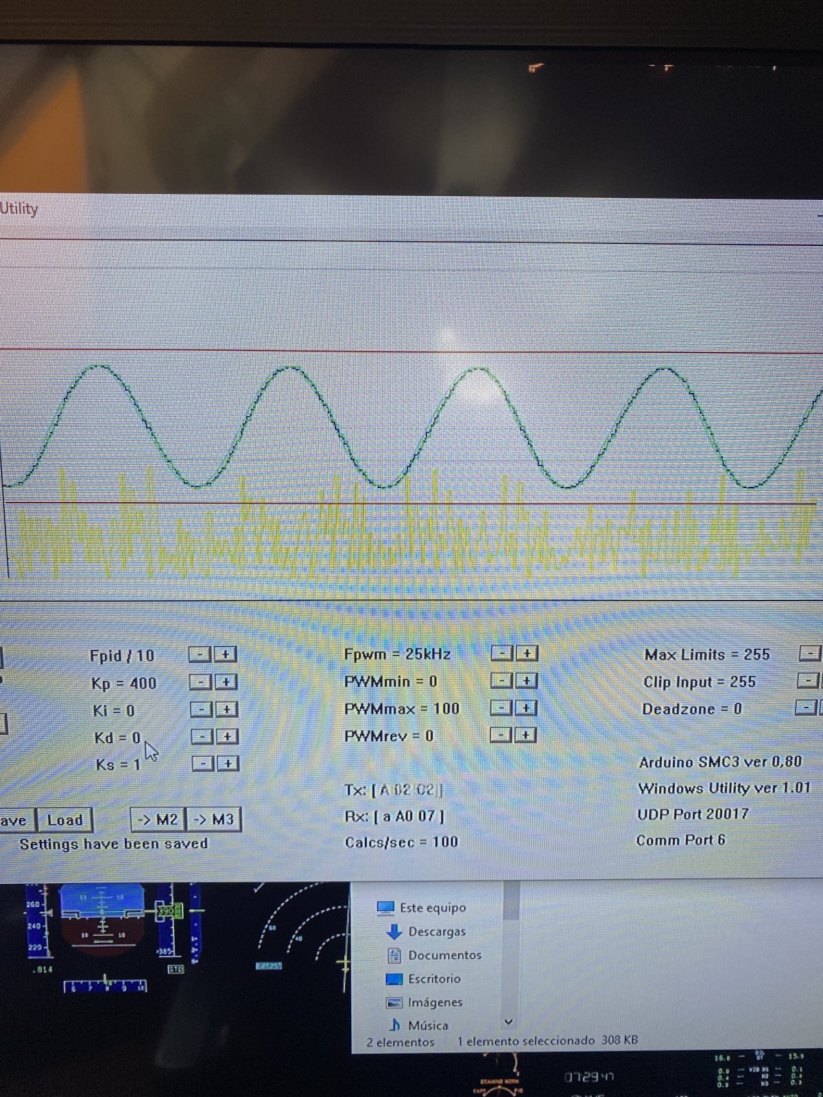

    And with PWMax at 100 and Fpwm at 25Khz?

    Bad :confused:

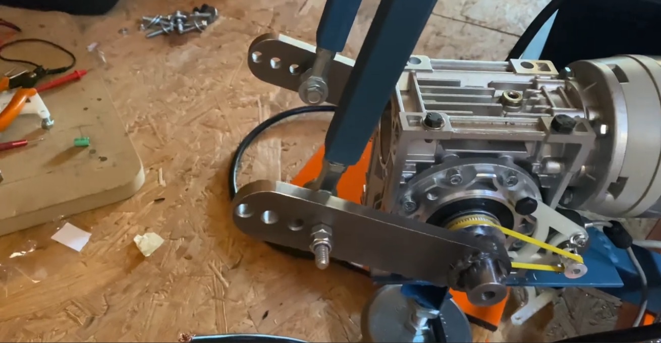

    What is the current CTC distance on the levers?
    Also is this the point at which the rig is level, at its rest position, as it should be but does not look like it in the video:

    The current lever distance is 125mm. When the rig is level the levers are parallel to the floor.
    Changing the Fpwm does not make any changes with the problem even how the rig moves, seems like it is not affected by Fpwm (same behavior from 5 KHz to 35 KHz)

    Design wise the levers should be at 90 degrees to the rods when the rig is at its level rest position. The reason being that a lever is at its maximum torque efficiency at that position.
    Not doing so means the effective lever torque utilisation when going down, with the aid of both gravity and rig mass, is significantly less than when going up.

    Yes, it is, but it stills makes no sense that behavior when the rig is empty. I can understand some weird behavior when the rig is full load and there is a error in the design but now the rig is running without load so...IDK. When this problem will be solved I'll modify the motor position to match the lever-rod angle to the max efficiency
    As you can notice the union between the motor axis and the hall sensor axis is an elastic rubber (I checked at first if it was the problem but it doesn't and the behavior is the same if a toothed belt is installed instead the elastic rubber). That makes me able to modify manually the sensor position and makes the motor correct the position. Well, in this case that is not SMC (or FlyPT) sending commands the motor movements completely clean, why? I don't know.

    I direct drive my Hall sensors from the motor shaft, so there is a 1:1 no slop connection. That you can move your Hall sensor so easily by hand may mean it is also affected by vibration and or inertia.
    Electrical interference is another possibility.
