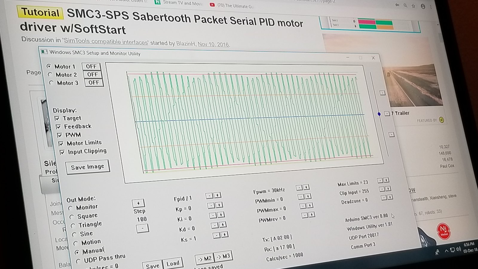

    Hi @SeatTime early days with this to be honest , I wont be able to provide better info until I finally get simtools running so that I can see real life operation under simulation running mode .
    had a bee in my bonnet about using optical encoders for a while and now that the means of doing this have crossed my path I thought I'd give it a whirl ..
    Warning did not have my hearing aid on so forgot about noisy PC fan :-(
    this is the very basic setup with no real fine tuning of PID / PWM values etc in smc just needed you guys to have an input in case I misunderstood what should be happing during the running of SMC utility and the interpretation of what should correct operation incase I have missing pulse counting due to not fitting Pull up resistors on the encoder channel a&b outputs ..
    Cheers Guys

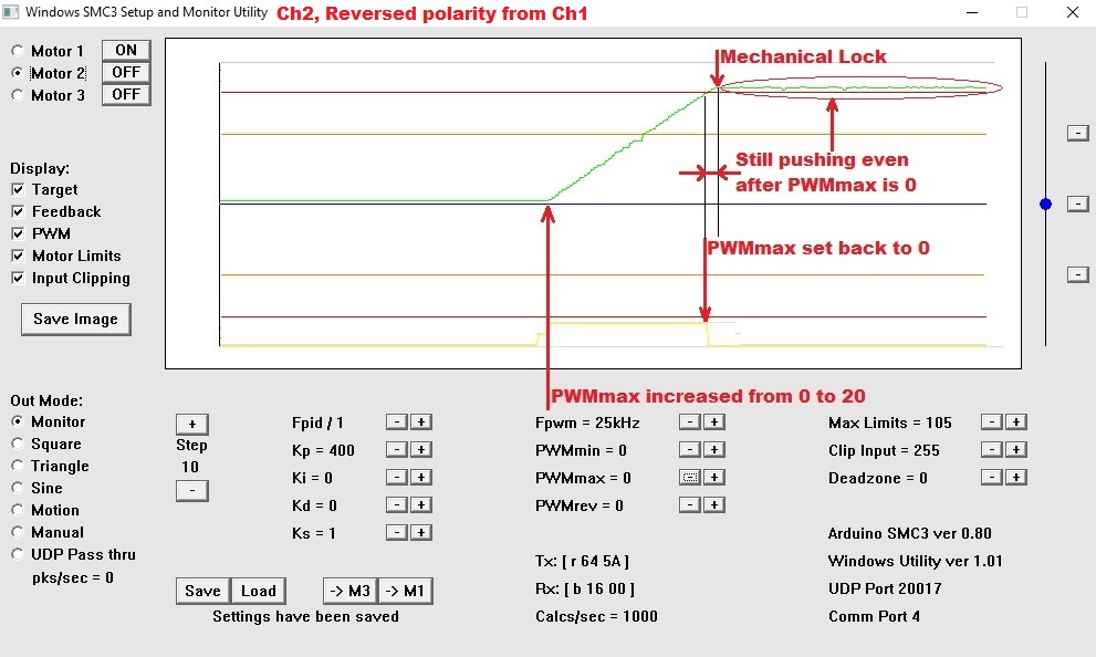

    I am having an issue with CH2 on my Sabertooth 2x60 on my initial setup with SMC3-SPS.
    Notes on the setup:
    The 6V Pololu motors that i use at this point are toys! The motors that i want to use for the motion sim are 24V and much too powerful for a desk test, this being the same reason why i want to make sure everything works to a certain degree before connecting those.
    The scope of this setup is to prepare Arduino, Sabertooh, SimTools, connections between components, etc.
    Setup:
    • Arduino Mega 2560 in this form factor (same schematic as normal one only smaller):
    • Sabertooth 2x60
    • Sony 8.4V, 1.5A power for the Sabertooth
    • Pololu 228:1 Plastic Gearmotor (search for POLOLU-1118)
    • ALPS RK09K113004U 10k Pots (junk i had laying around)

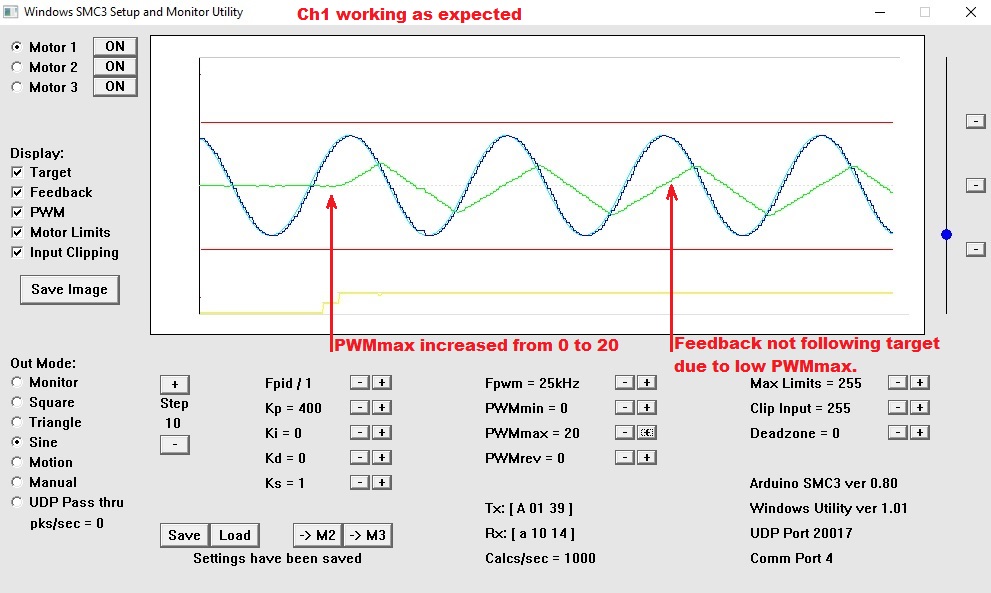

    First i want to talk about CH1. I have first tried CH1 and it seems to work exactly as i expected.
    I have configured and tested Ch1 all the way to LFS. Tested with heave and roll. Responds as expected.
    Feedback is not following target due to low PWMmax. I have tried with PWMmax 60 and it follows it perfectly, but it cooks the motor. I am guessing this is because of the crappy motors + over voltage from the power supply.
    Now onto Ch2.
    In picture 1 we have Ch2, with same motor as Ch1, same polarity on both the motor and the pot as for Ch1.
    Motor starts with proper speed (dependent on PWMmax) in what i concluded, after several test sessions, to be a random direction.
    You can see that it keeps that direction throughout the test. Also you can note that it seems to be trying to compensate for the target route but nowhere near enough.

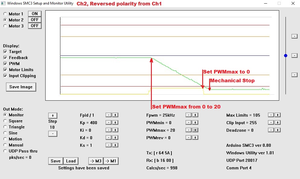

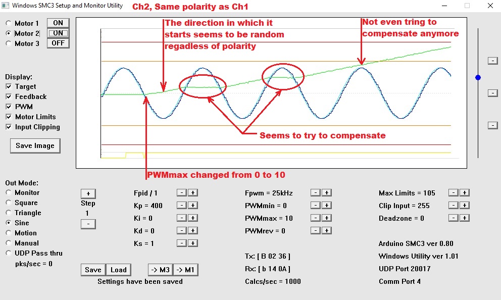

    Picture 2:
    In this picture you can see that motor pics one direction, still keeps speed according to (now higher) PWMmax. In this case it ignores the target completely. When PWMmax is above about 13 it seems to always completely ignore target. The bigger the PWMmax value, the faster it will go to the mechanical limits (no change in behavior).
    Picture 3:
    For this picture i have swapped polarity on the pot.
    What i would like to mention is that even after manually setting the PWMmax to 0 the motor does not stop. It then reaches a mechanical stop, and if i go and force it in the other direction it still powered on and wants to go in the initial direction. ON/OFF button in SMC Utility does nothing. Only way to stop this is powering off the Sabertooth. This is the same for all the cases, even the ones above with the sine target.
    Picture 4:
    Same as picture 3 (inverted polarity than Ch1) but a different case.

    I don't know whats going on but to start narrowing things down what happens if you pull out the wire to S1 instead of powering off the Sabertooth? Does the motor stop?
  12. dorulet
    dorulet New Member
    Aug 30, 2018
    6Coins
    First of all thank you for your response. Secondly, sorry for my late response, but i got carried away with Christmas holidays.
    Short version:
    I have fixed the problem. It was a beginner mistake that i tried so hard not to make. Inverted polarity on Ch2.
    Long version:
    Like i have said before, the actual problem was inverted polarity, but how could have that happen, when i have clearly stated that i changed polarity on this channel several times? It actually is a case of mixed channels than mixed polarity. What do i mean by this? Well you see i have made a prototype "motherboard" that takes care of all the necessary connections Sabertooth <->Arduino<->Pots. This motherboard also includes an additional controller that also provides some additional features: controls power supplies, provides an emergency button, ON/OFF button, monitors pot status (can cut power if something goes wrong regardless of Arduino status), display and more.
    Problem was that i have wired Ch1 on Ch2 connector and vice versa. So i just had luck that Ch1 worked right from the start, and when i was changing polarity for "Ch2" i was actually changing it for Ch1 instead. I knew that Ch1 worked so it did not cross my mind to re-check Ch1. I only realized the issue when disconnecting and reconnecting everything.
    After sorting out this issue i got both channels to work as expected all the way to LFS.
