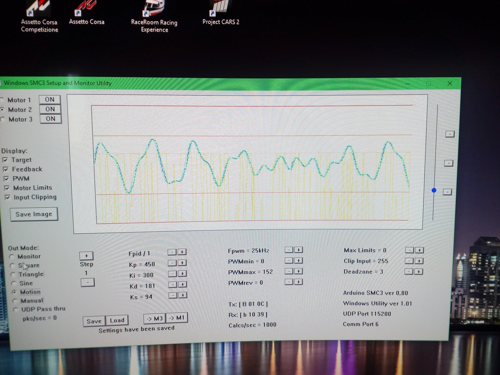

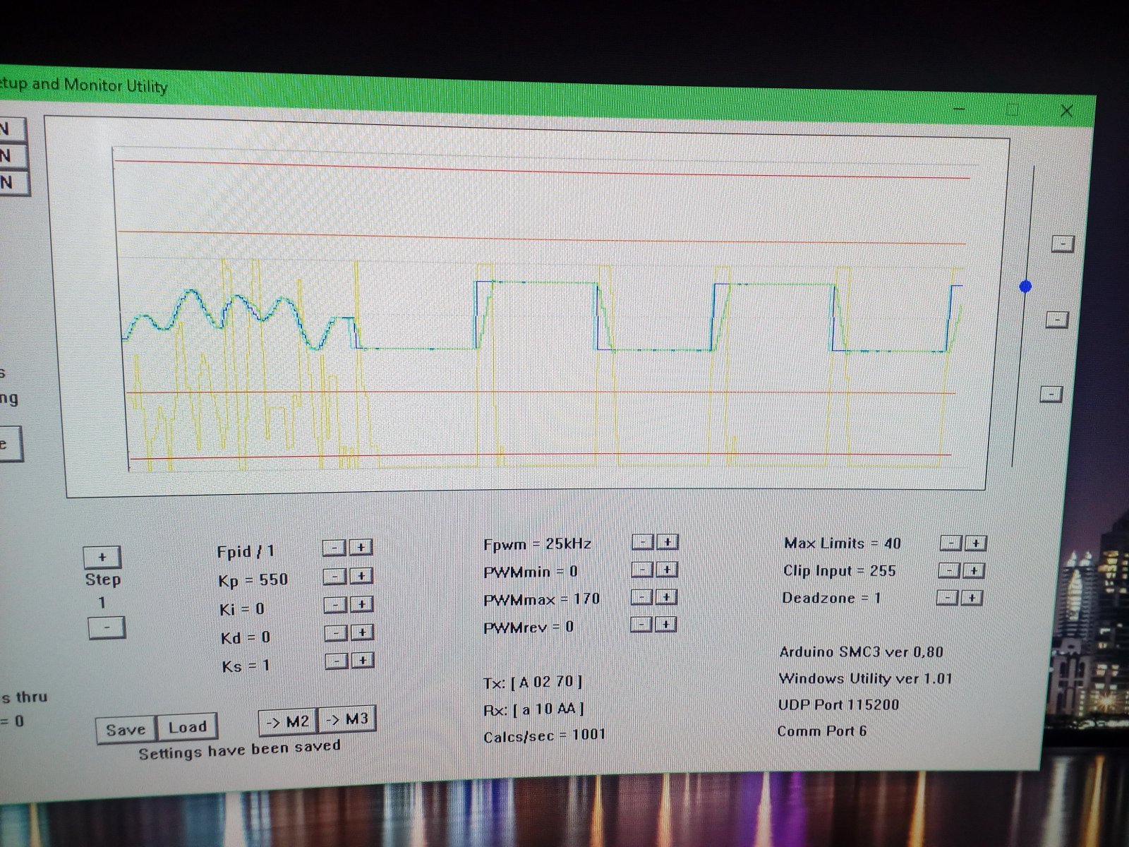

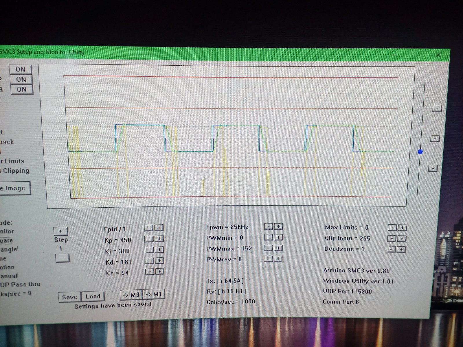

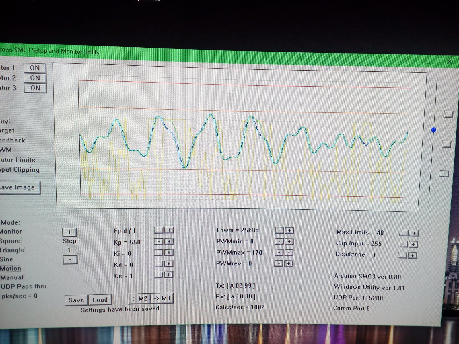

    Nun habe ich die ersten lauftests machen können.
    Meine Hardwarekonfiguration ist
    2 X 12v/30A Schaltnetzteil
    Saberthooth 2x60
    2x Traktionsmotor 90ZYT-199
    wenn ich diese Einstellung wie in Bild 1 ( kp 550 ) in SMC3 habe schaffen es die Netzteile nicht, schalten immer wieder kurz ab.
    wenn ich die Einstellung von Bild 2 ( kp 450 ) habe laufen diese problemlos, nur haben beide Motoren nach etwa 10 min eine geschätzte temperatur von 70-80 Grad und da ist noch kein Sitz oder gar ich als Last mit dabei!
    Gibt es da tips wie ich die Motortemperatur mit den SMC einstellungen runter bekomme?
    Now I have been able to do the first running tests.
    My hardware configuration is
    2 x 12v / 30A switching power supply
    Saberthooth 2x60
    2x traction engine 90ZYT-199
    if i have this setting as in pic 1 ( kp 550 ) in SMC3 dont manage it the power supplies will turn off again and again.
    if I have the setting of picture 2 ( kp 450 , thes run smoothly, but both engines have an estimated temperature of 70-80 degrees after about 10 minutes and there is no seat or even a load with me!
    Are there any tips as I get the engine temperature with the SMC settings down?

    Power supplies appear inadequate. Are you using a battery too as recommend? This will increase available current and also absorb regen current that can heat up your motors.

    I can't say how much heat is from load or from regen but in any case your power supply triping indicates you need a battery too or better supplies.

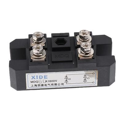

    It would bring 3+ times more power but probably overkill. And it wont handle regen current any better. But you need to determine why the supplies you have now are tripping to know what actually needs fixing. Unless you have a scope to check it though you will need to add a couple of 30amp min. diodes to the supply output wires to stop regen current from entering. If it stops tripping then thats the problem otherwise you need more available amps.

    was für Dioden muss ich da benutzen?
    bin da leider zu ahnungslos kann es jedoch dann machen wenn ich weiß wie es geht
    what diodes do I have to use there?
    I am unfortunately too clueless, but it can then do if I know how to do it

    I use a bridge rectifier like this myself instead which is 4 diodes in a single package. But you still need two if you're going to put one on each supply wire. I don't know if you really need one on each wire but thats what I did.
    https://www.ebay.com/itm/MDQ60A-Amp...ge-Rectifier/382239531614?hash=item58ff40625e
    But while they may keep your supply from tripping from regen currents they won't help dissipate heat generated from them.

    habe mir jetzt gleich mal 2 Brückengleichrichter kostet jeweils 100A

    @Neo_One When you wire the bridge rectifiers the two terminals that are between the diodes are not used. On the terminals you do use the current runs opposite the arrow. If your not sure which wire to put on which terminal though just try one way and connect a motor or something. If it doesn't work then reverse the wires and try again. If it still won't work then the wires on the other rectifier are backwards also.

    alles klar dann nutze ich nur den Plus und Minus Pol des Brückengleichrichters
    Soll ich dann die Plusleitung des Netzteils dafür nutzen?
    All right Then I use only the plus and minus pole of the bridge rectifier
    Should I then use the positive line of the power supply for it?

    I believe the negative wire is the most important because electrons normally flow - to +. But like I said before a I put one on both wires just in case. My thinking is regen polarity will depend on the direction the motor is turning so it may cause interferance on both wires where a second rectifier might help.

    I don't have and can't take a photo because I do something different now. But they're quite simple to connect. In case you're unaware a diode on a wire is like a check valve on a pipe. Flow can only happen in one direction.
    Therefore just disconnect the neg. wire from your supply and connect it to one of the rectifiers terminals. Connect another wire to the other terminal and connect it back to your supply. If it doesn't output power then reverse the wires on the rectifier.
    Repeat on the pos. wire if the supply is still shutting down at times.
