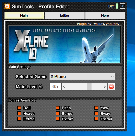

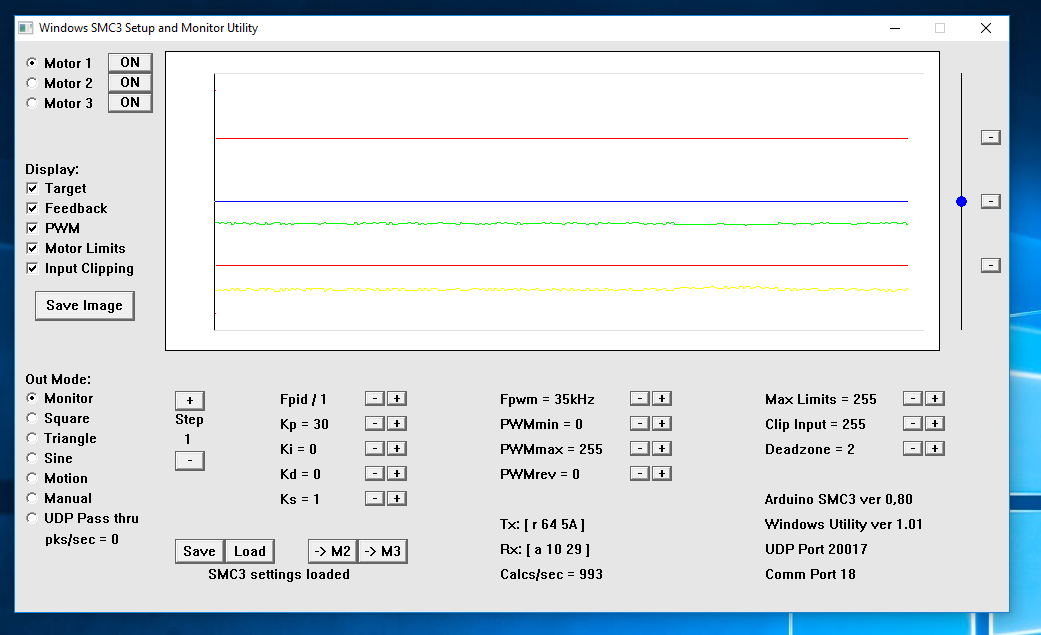

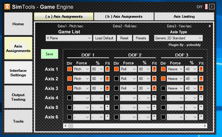

    Hello guys,
    I did some tests changing the settings and with the pid at 30 it moves a little better but I still am not happy with the result, it does not simulate the braking and still moves in steps
    I do not understand why the motor number 3 becomes very hot.
    I posted the screenshots of my settings so I hope you can give me some good advice.
    Thanks. Happy weekend

    I have done other tests and now it seems that with pid a 30 is a bit better but the engine number 3 is jerky and overheating.

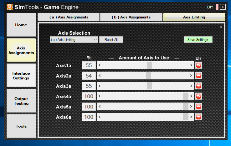

    One thing is your force settings in axis assignments are to high. Each axis totals 200 when they should be 100 or slightly over if you wish. 100 is equivelant to 100% of the range of the actuator. On motor 3 does it lift more weight than 1 and 2? That's all that come's to mind atm. Also stop using axis limiting.

    Just would like to share the experience of initial setup.
    I followed the step until step#6 "run SabertoothArduinoLibrary.exe" but after that I do step#8 " upload arduino sketch" before step#7 "Power sabertooths".
    Not sure that what cause the problem, after I powered sabertooths both of the motors was shaking severely, my understanding it should stayed still. What I did to fix this shaking at initial was i need to open the scm3 utility without power the sabertooths(arduino connected) and adjust all value (Kp,Fpwmmax,etc) to be zero then turned on the sabertooths.
    Not sure anybody has the same issue? or what did I do wrongly?

    set your pid. improper pid settings can cause erratic behavior.

    @Blame73 I use Hall effect pot from TT electrnic
    @Evan Rowlands Yes, I did use 115200
    @bruce stephen It's true that wrong PID or Fpwm will give this issue.
    But why would all those setting are in a brand new sabertooth? I'm not sure that these setting are store in sabertooth, arduino or PC? or I really doing something wrong.
    By the way, my 2dof sabertooth 2x32 motion is currently running and I'm very happy with it.
    Cheers

    @kwannania, Hall pots are long lasting when attached properly and noiseless so therefore are a good choice but they do have some hysteresis (drift). But this can be filtered by increasing the deadzone and adjusting pid settings.
    A sabertooth stores its baud rate on its own eeprom and pid settings are stored on the arduino. But since the sabertooths eeprom is powered by a built in 5v voltage regulator thats powered from the motor input voltage it must have power applied to it at least once before running the sketch because the sketches initiation sequence changes the sabertooth from its factory baud of 9600 to 115200. After this is completed power up sequence is irrelevant.
    Also Fpwm has no effect when using a sabertooth because it is not controlled via pwm.
