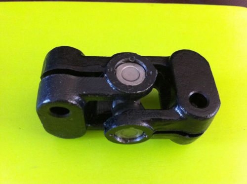

    I'm building a seat mover style simulator and I'm ready to design the joint that the seat will pivot on. It looks like most people use either a u-joint or some sort of swivel machine foot. Is one better than the other and does anyone know a good source for either. I've looked at used u-joints on ebay but it looks like most of them have splines and I'm not sure how I'd mount those. Also, does anyone know what the official name for the swivel machine foot I'm referring to is?

    You mean universal joint? Also constant velocity joints could be used, either of them does not cost much and are readily available in any autopart shops. You could even source some for free from repair shops.

    This is selling in Ebay for around ten UK pounds plus postage.
    I have used this for approx two years now I think and no squeaks or problem.

    Thanks for the information! I bought one from McMaster and I'm hoping to attach it to my seat this weekend. I figured the top of my seat would be about 8-10 above the base of the rig but now I'm not sure where to put the u-joint vertically. Is it better to keep it closer to the seat or the base. I was thinking closest to the seat but I've seen some setups where it's down towards the base with an extension that connects to the seat. Any advice?
    Thanks!
    Matt
  9. bsft
    Any where should do, the closer to the bottom of the seat will help overall balance. Also you need to mount the pivot point at the centre of gravity. For a seat mover, about center of the seat, for a frex, about 120mm forward center point of the seat.
