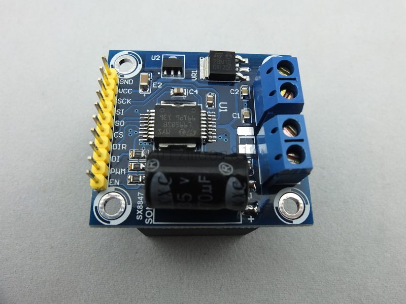

    Hi all, I have two 240w dc motor driver for my flight simulator. Does anyone know them?
    They are produced by SONXUN, SX8847 models.
    I'm trying to connect to my Arduino Mega 2560 with two optical encoders, two limit switches and a proxy for the central location of the engines.
    All for a cab game TAITO TOP LANDING converted to FSX!
    An old 2DOF.
    I will post pictures soon
    Regards
    ceretz

    @Ceresoli is there a data sheet available , a link with more information then we can inform you on how to use them.
    http://forum.arduino.cc/index.php?PHPSESSID=me43bkmpcav26repgknmej1ch4&topic=134411.15
    Looking here I found a code to drive them so to wire are run them he has :
    //Functions used on h bridge pcbs.
    int oneen = 8; // enable
    int onedir = 9; // direction
    int onepwm = 10; // pulse width modulation
    int onedi = 2; // disable
    //also connect GND and VCC obviously
    Looks like we need to drive the enable pin high in order to enable the driver and then set a direction high will go one way and low will turn it the other way, then we drive the pwm pin inorder to set a speed to travel in the direction we want, lastly you can then disable the driver via another pin ( like if a safety switch).
    Looks feasible and I believe @RufusDufus code could run these drivers.
    Hope that gets you started

    This in my Arduino's code for test only two SX8847 Without other I/O
    I use it witw an Arduino Mega 2560 R3.
    Two SONXUN SX8847 Test with Arduino Mega 2560 R3

    I have update arduino with an LCD. This is the first test.
    I'm work to study the SPI register of SX8847, becouse there are some helpful function and communication sended to arduino from this driver!
    The information are very helpful if the are some problem during motor control.
    My idea is to have an LCD monitor 20x4 for parameter visualization like motor position, sx8847 problem (temp. warning, no load, undervoltage, ecc.) and state of various switch for security.

    With a little help of arduino's community i have compiled this.
    Example with explication for SX8847 SPI Access, program and serial monitoring
    The second step is adding a LCD for diagnostic (visualize SX8847 Poblem and motor position) and complete the sketch with some security switch, 2pot and the infrared photocells that block the simulator in case of unauthorized acces in mition simulator area .
