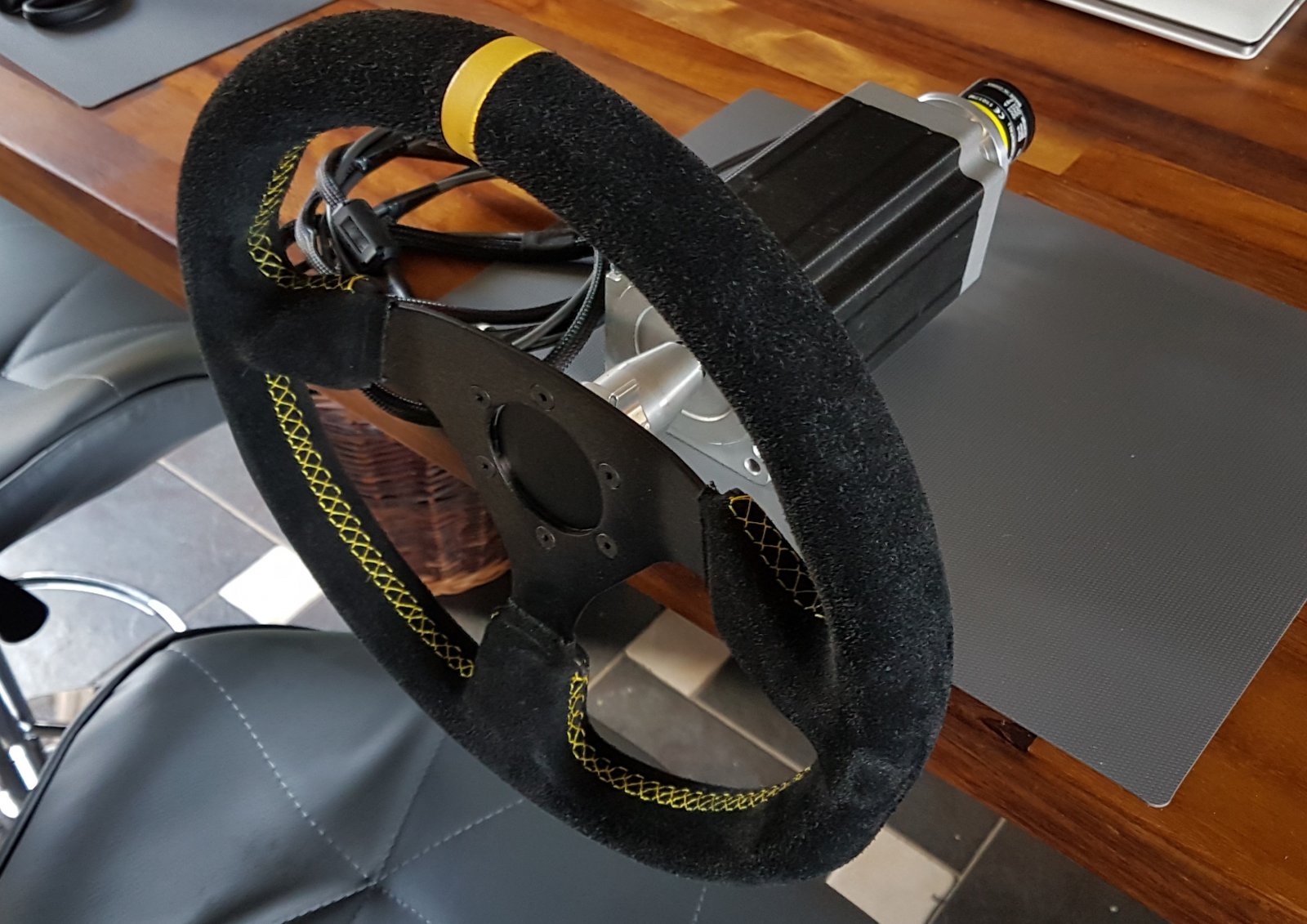

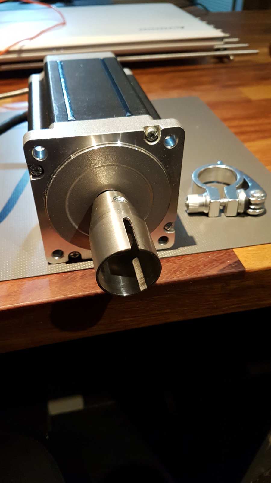

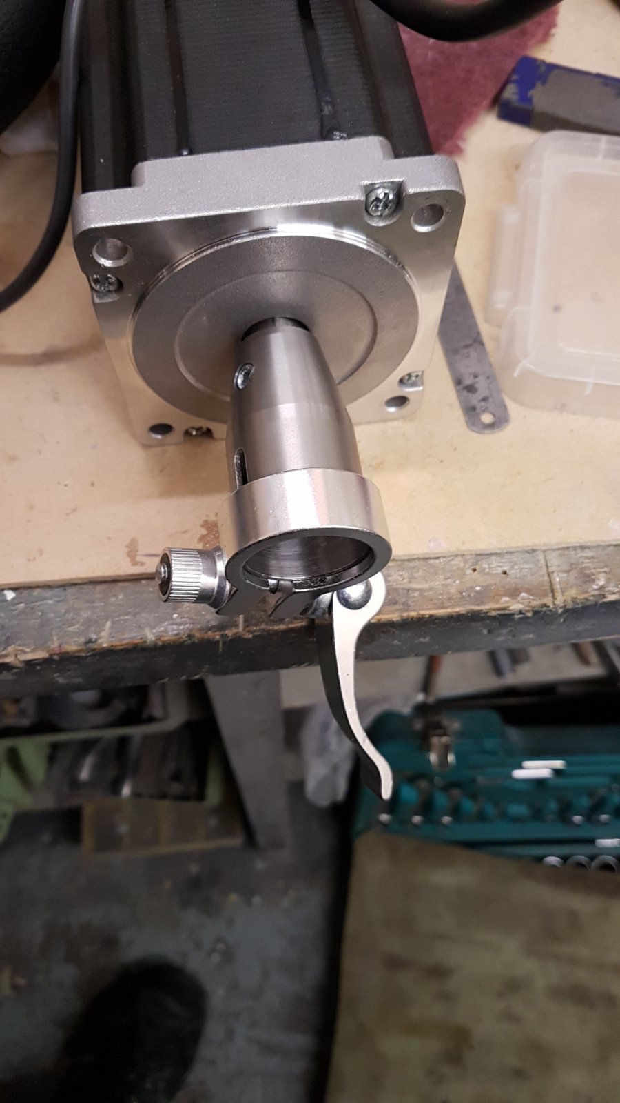

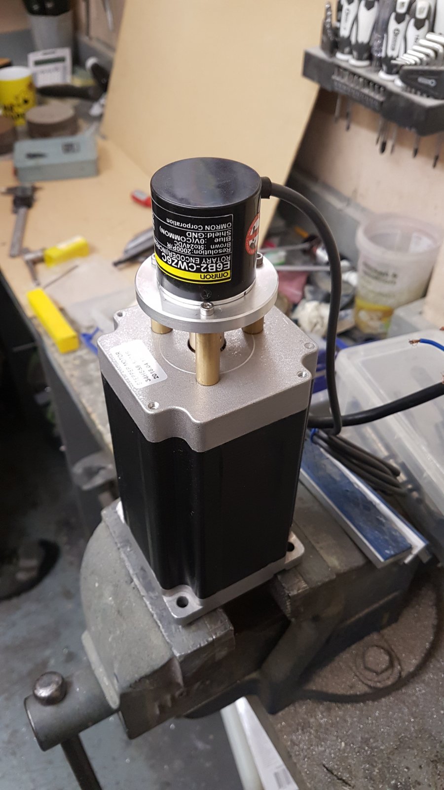

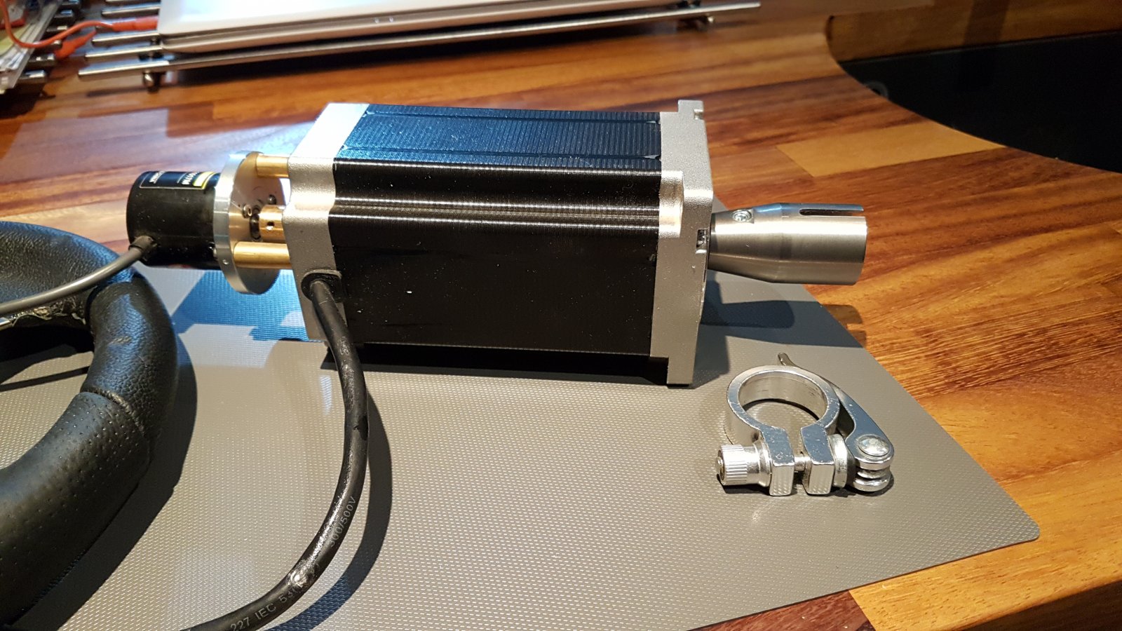

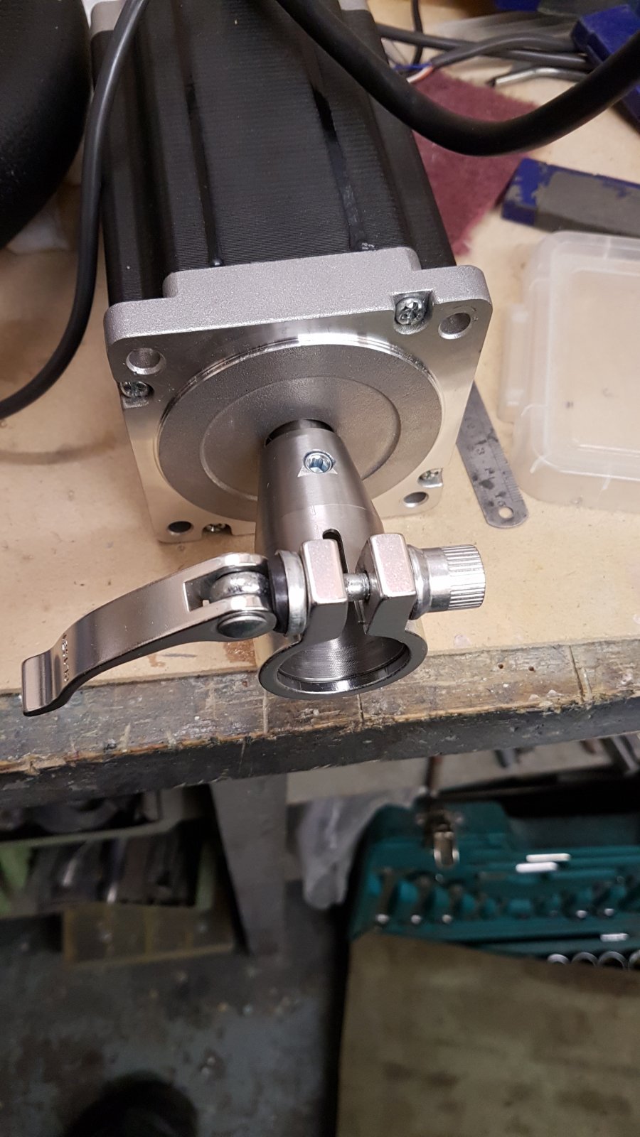

    Couple of pictures of how i mounted my diy wheel QR hub and encoder
    20170214_224611.jpg 20170215_010207.jpg 20170215_011036.jpg 20170315_210059.jpg
    hopefully Drift video coming soon

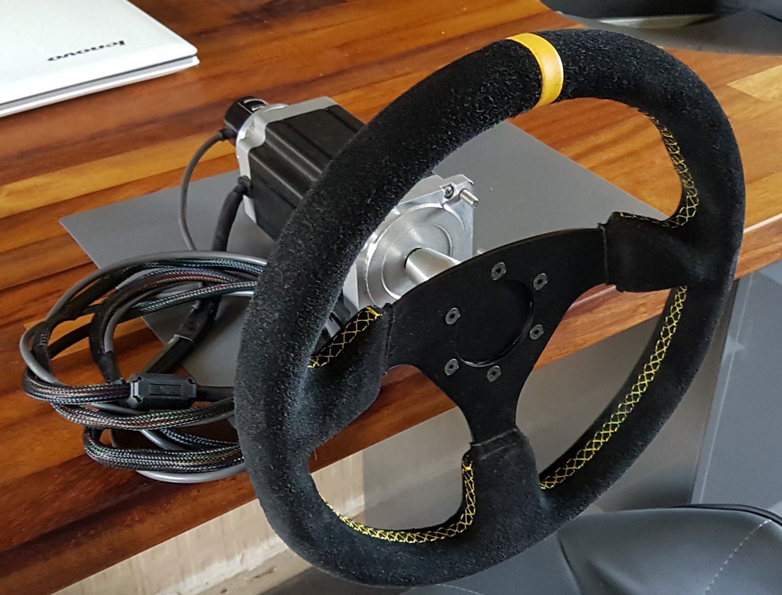

    Hi All
    Just wanted to pass on some final thoughts on the Son of OSW wheel
    @RufusDufus has been working hard with a steady flow of updates coming my way each one making a noticeable improvement and the wheel is now feeling even smoother and quieter.
    I'm really happy with it from how easy it was to build right through to how well it performs, I must point out the best wheel I've used to date has been the g27 so I can only compare it to that and it's way better in every way !!!!!
    I feel my driving has improved I'm more consistent with lap times and crash less as the FFB gives me a better feeling of what the car is doing.
    So if you are using a wheel on or around the g27 spec I can highly recommend getting one of these, I'm hoping to test a T500 soon so I can compare that as well.
    For me it ticks all the boxes and with the bonus of it using the stm disco board with the mmos FFB software it has good options for shifters, pedals and a button box all from one windows device.
    To sum up I can't really find anything negative to say about this wheel I love using it ( it calls me when I'm working lol)

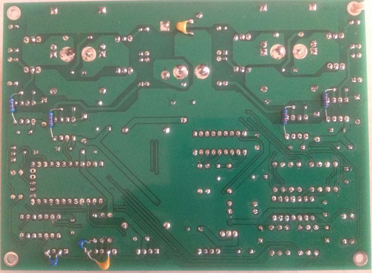

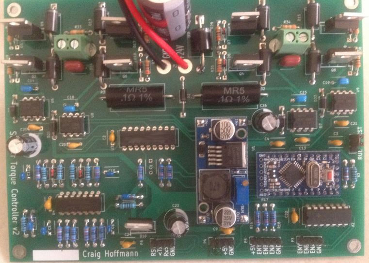

    I have a few extra "field trial" boards for sale if there are any Aussies that would like one. They are $150 + $10 standard parcel postage with signature. For comparison the expected price of the final boards will be $220 + shipping. Payment by paypal.
    These boards are hand built and have components on the back of them to bring them to the final build spec as shown in the pics.
    If you are interested send me a PM but have a read of my website first so you understand what is required to build a complete wheel... https://sites.google.com/site/steppersimwheel/home

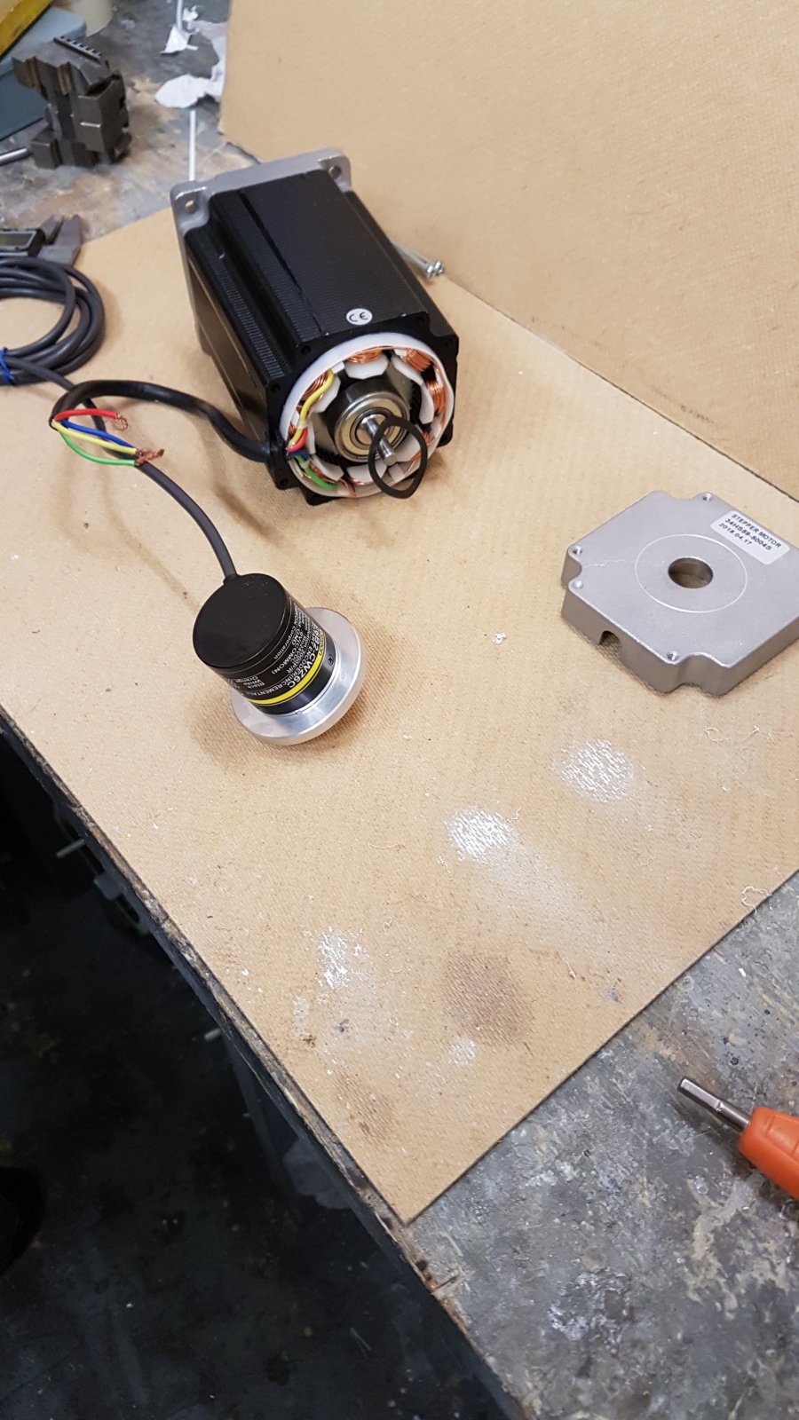

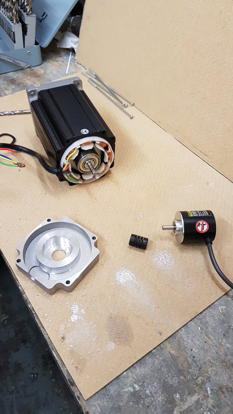

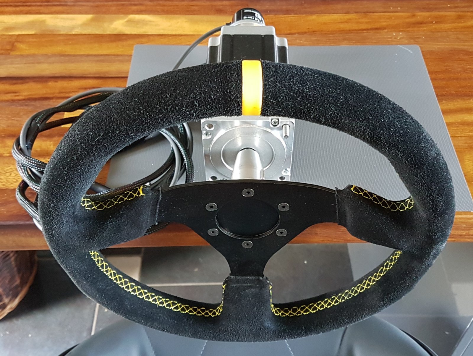

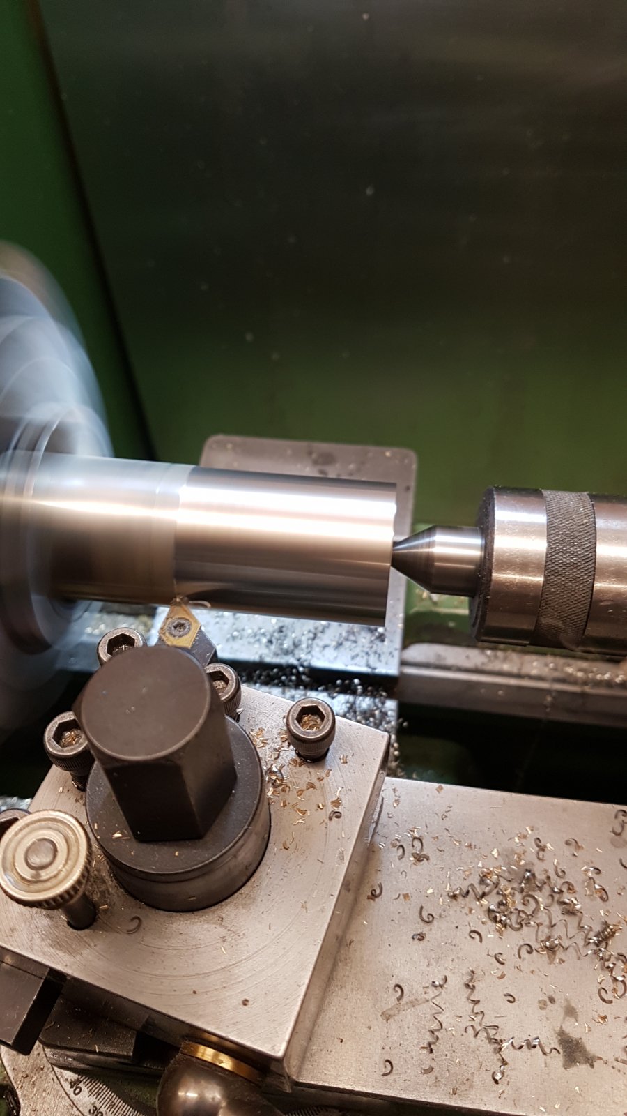

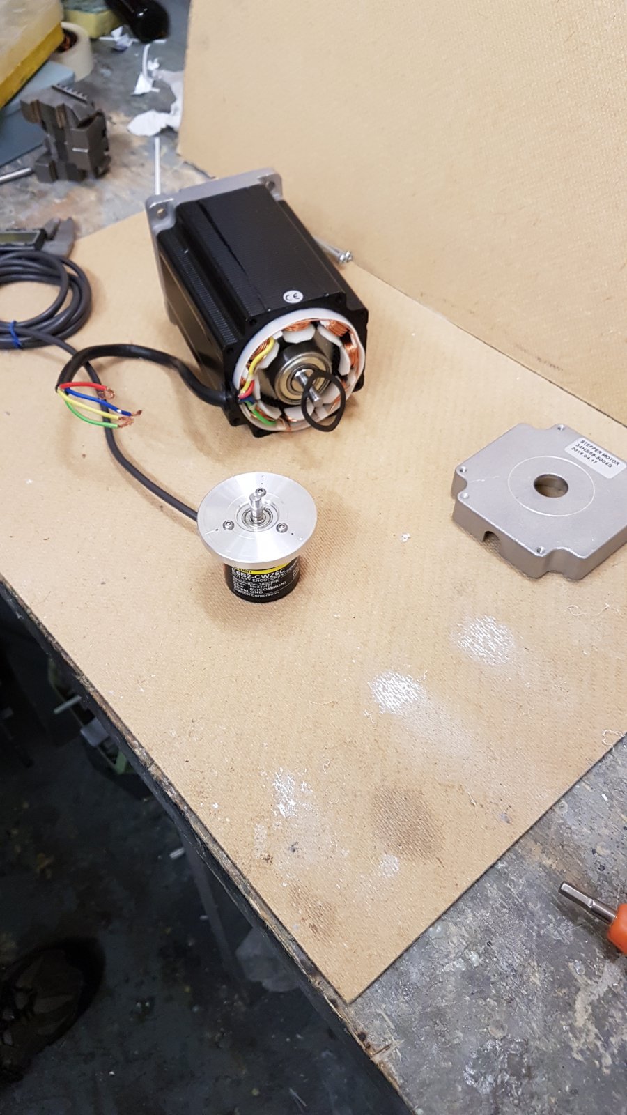

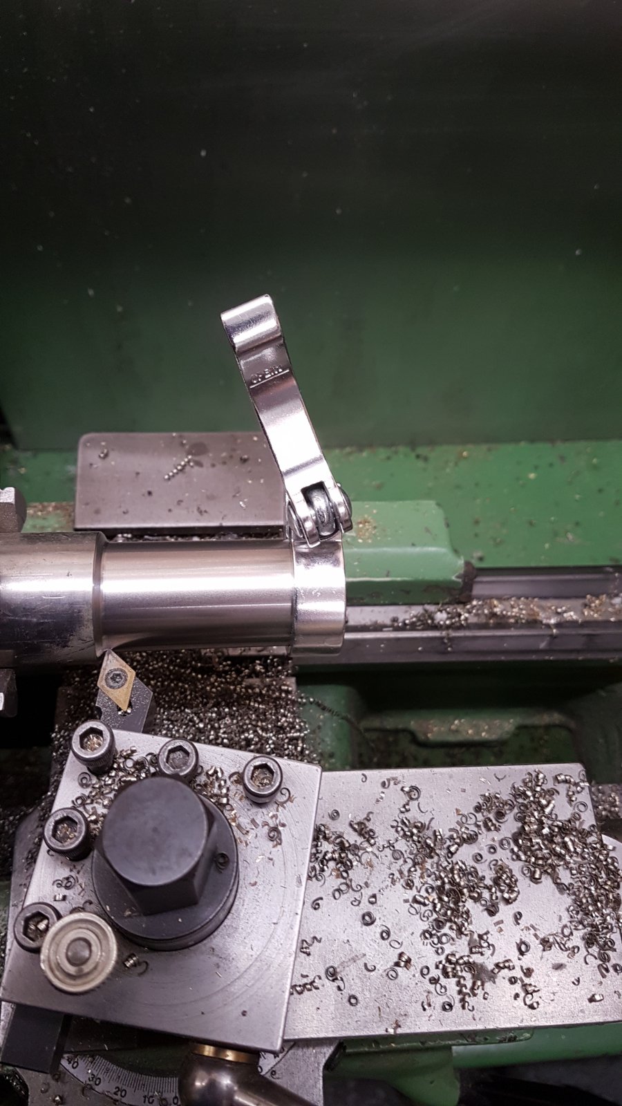

    Hi All,

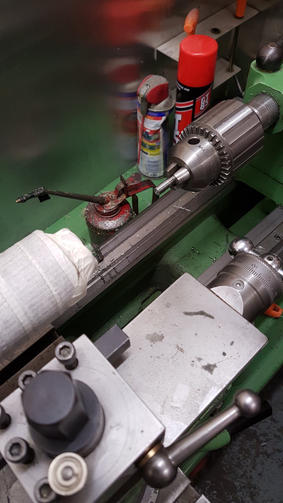

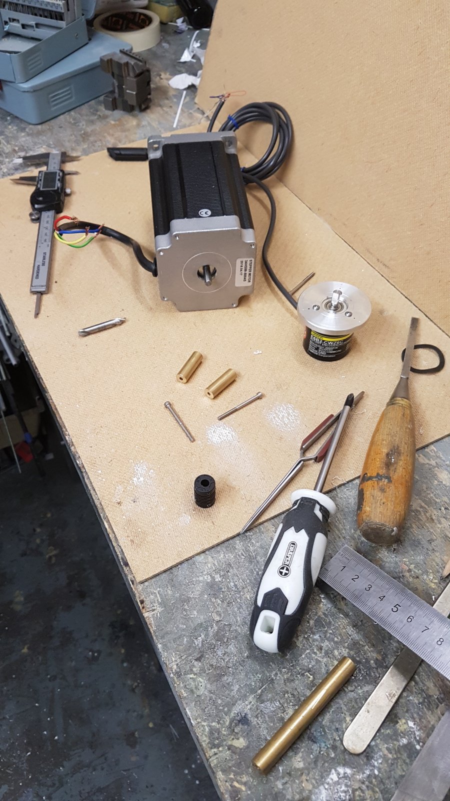

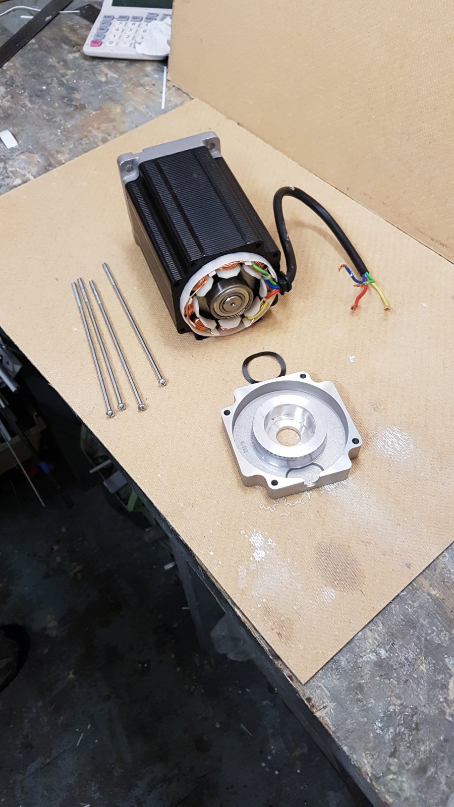

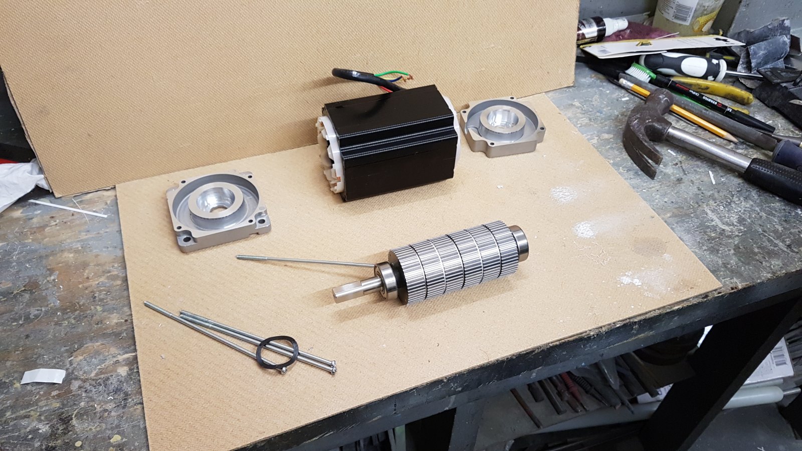

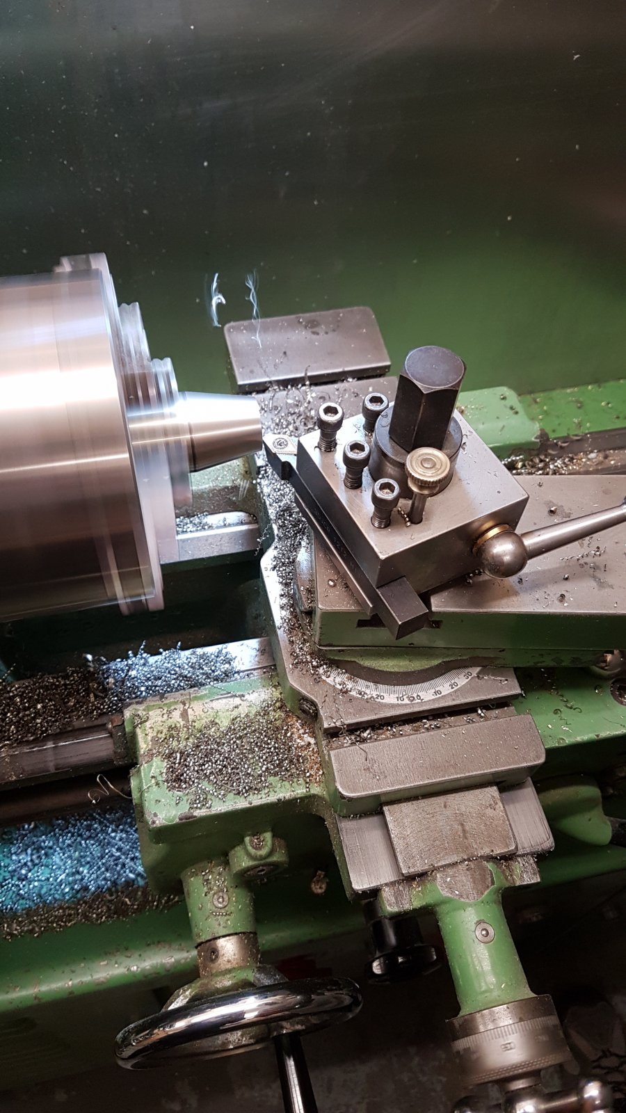

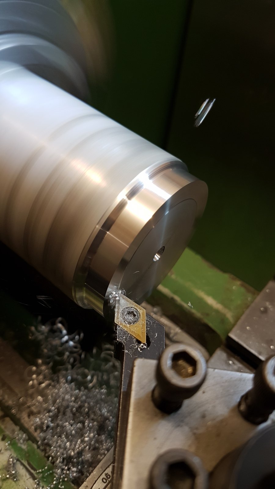

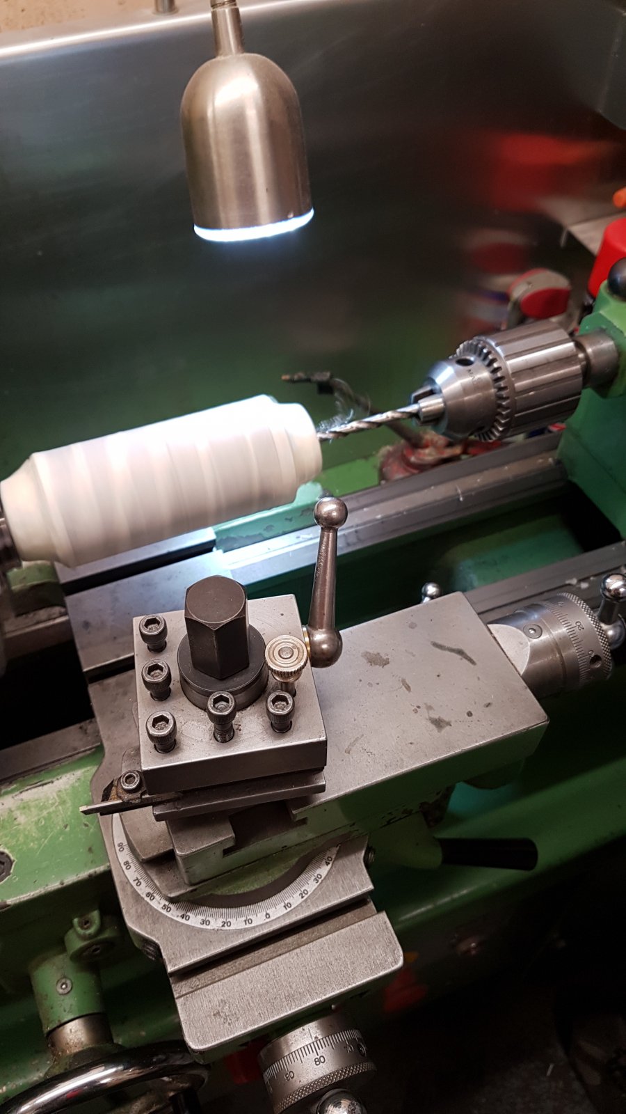

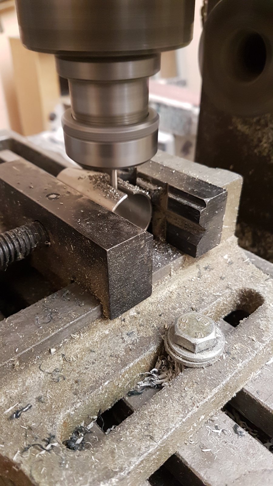

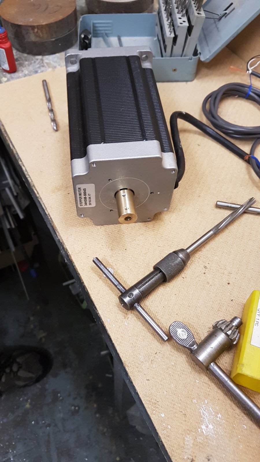

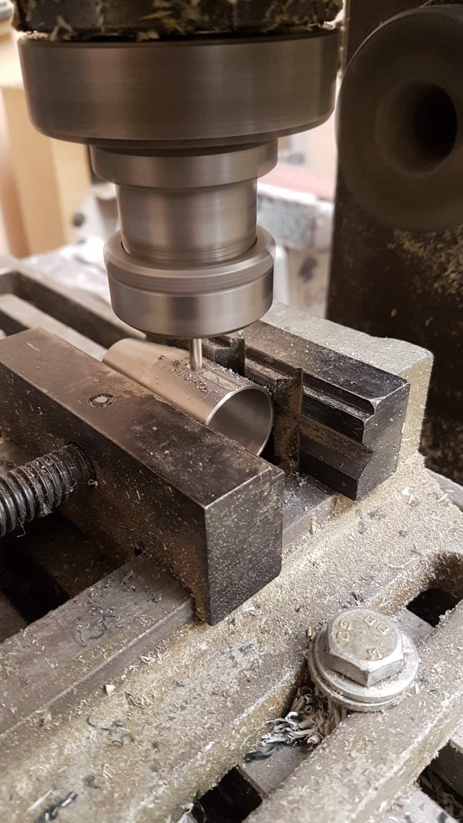

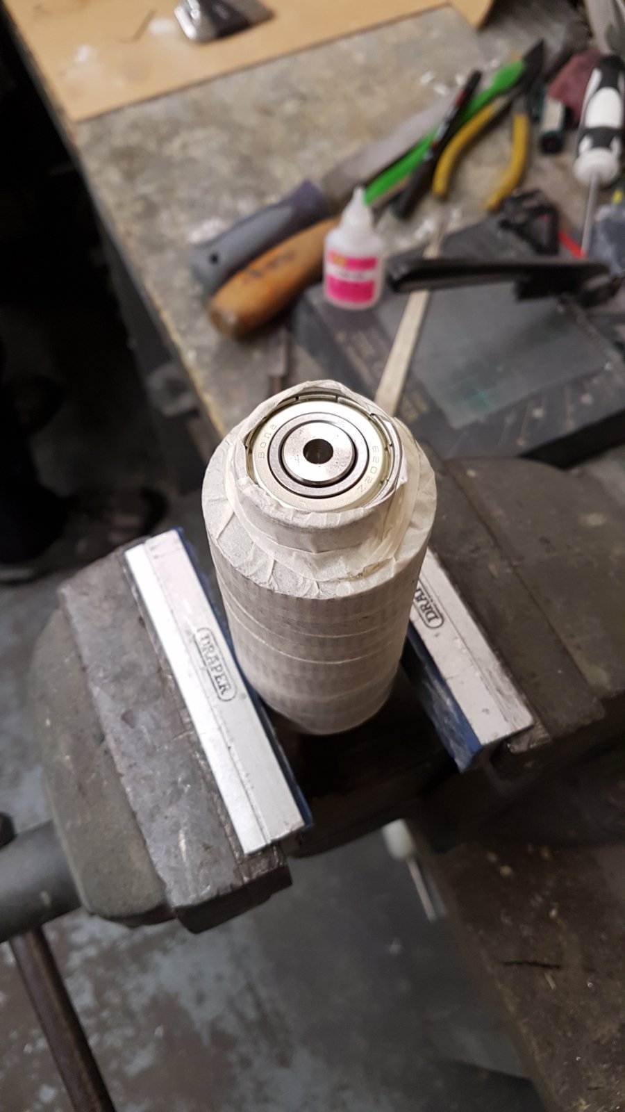

    Been asked if i can show some pictures of how i mounted the encoder so i thought i would put all the pictures i got so far.
    I stripped the motor to use a lathe but you could easily use a pillar drill, the strip down took minutes and was very easy, one tip would be to take it apart on a clean board with no metal swarf etc then tape it up because it has strong magnet pull
    20170214_205912.jpg 20170214_210009.jpg 20170214_210335.jpg 20170214_211529.jpg 20170214_212339.jpg 20170214_214356.jpg 20170214_214825.jpg 20170214_220454.jpg 20170214_224606.jpg 20170214_224611.jpg 20170214_231550.jpg 20170215_010207.jpg 20170215_011036.jpg
    • Informative Informative x 3

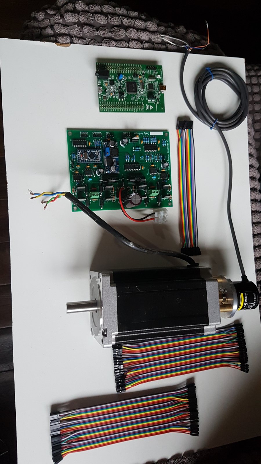

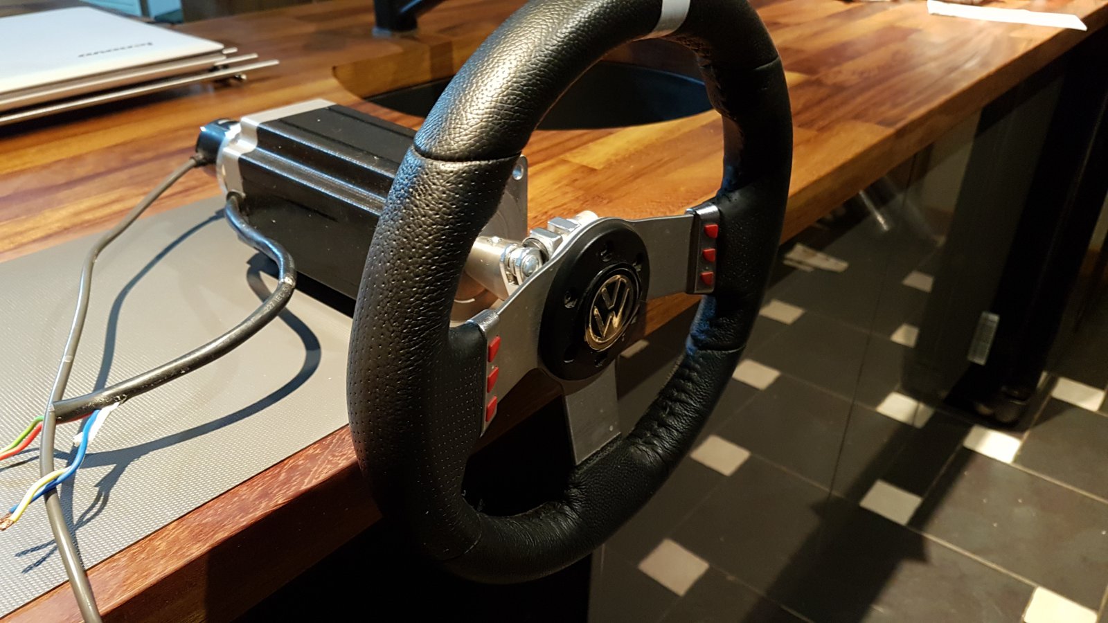

    Hi everyone!

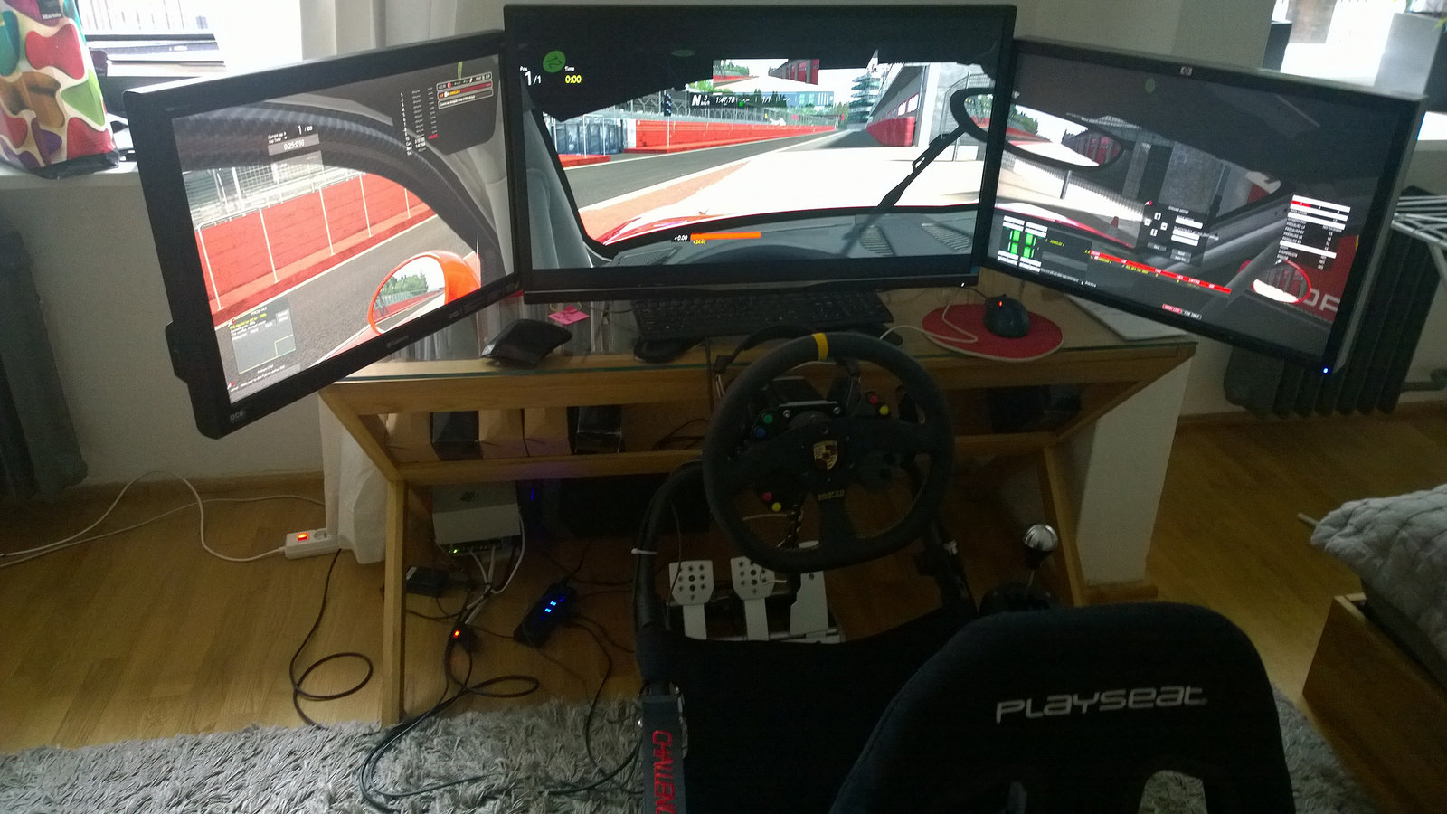

    I have received the board from RufusDufus some time ago. Unfortunately had some encoder problems, waiting for a new one from China, but my SSW wheel is working anyway (without centering after power ON, but everything else is ok).
    Previously had TM t300rs with 32cm Sparco rim.
    In a few words:
    SSW is ~3 times stronger, ~2 times faster, has better initial acceleration, is more brutal and more responsive:) I like it strong, I am using it at arounf 70%, so I am able to feel some coggling, but nothing serious and I know Daguru is working on making it better and better! Cannot really feal it during driving, more when standing still. Will post some test when everything will be finished, but It is already on par or better than AF in acceleration and rotation speed!
    Some pictures:
    [​IMG] [​IMG]
    [​IMG] [​IMG] [​IMG] [​IMG]
