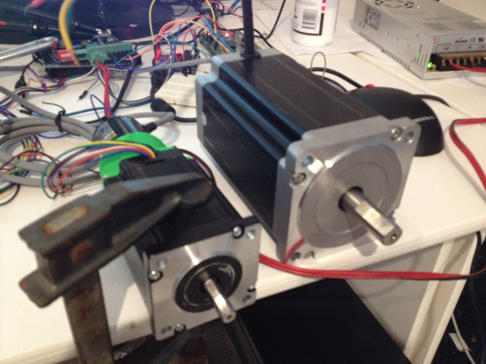

    The motor I hope to move on to once the baby motor/driver works properly...

    @RufusDufus That looks great. Thans for explaning the PWM signals. Trying to implement that
