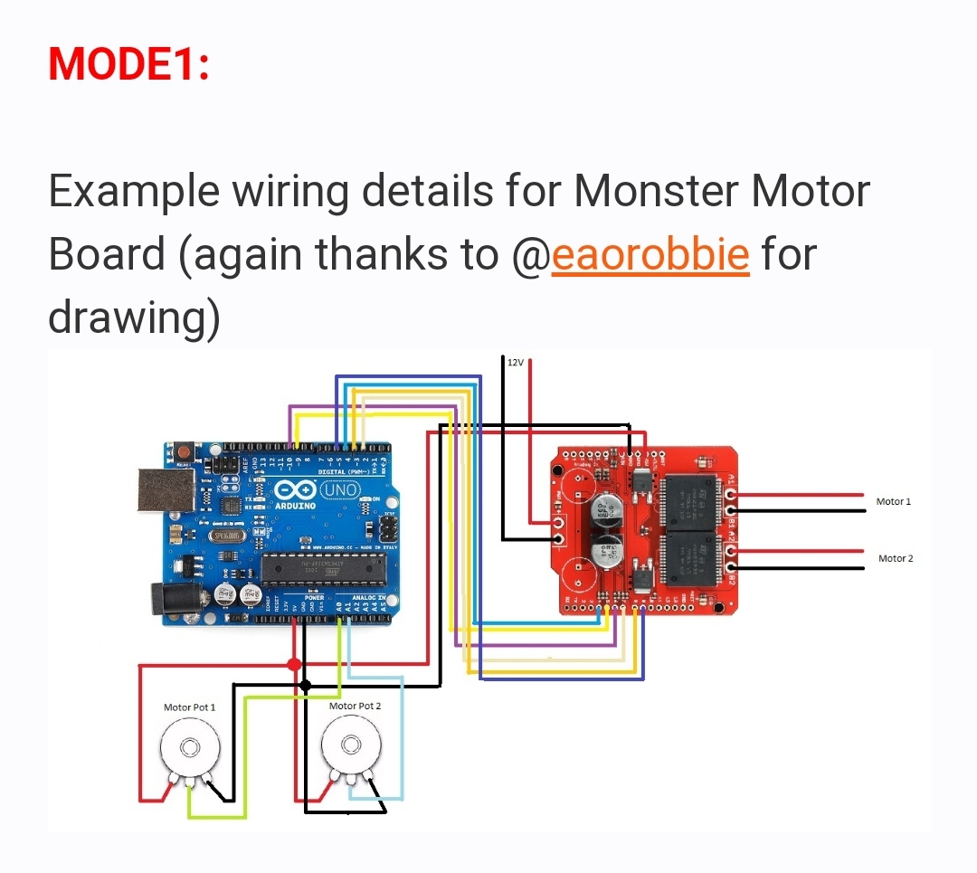

    Is it possible to have the arduino-motomonster connection scheme?

    Do you have a picture of arduino- motormonster?
  9. pfm21
    pfm21 pfm21 build 2dof dinamic
    May 13, 2020
    72
    181Coins
    +11 / 0 / -0
    Connection diagram
  10. pfm21
    May 13, 2020
    72
    181Coins
    +11 / 0 / -0
    I use this
  11. lindo123
    lindo123 Gamingfeeling
    May 30, 2018
    37
    none
    United Kingdom
    327Coins
    +12 / 0 / -0
    2DOF, 3DOF

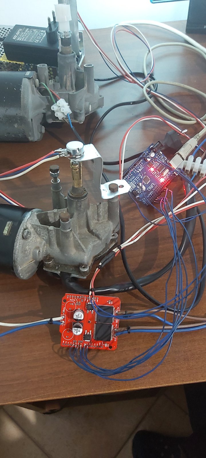

  15. pfm21
    May 13, 2020
    72
    181Coins
    +11 / 0 / -0
    This a picture
  16. lindo123
    May 30, 2018
    37
    none
    United Kingdom
    327Coins
    +12 / 0 / -0
    2DOF, 3DOF
    Did you configure the position of the potentiometer when you put it on there E.G show the middle point of the motor on smc3.

  18. lindo123
    May 30, 2018
    37
    none
    United Kingdom
    327Coins
    +12 / 0 / -0
    2DOF, 3DOF
    I will post more tommorow about it. Basically, you stop the motor from spinning then put the potentiometer to the middle position then glue/ attach the pot (in the middle position) then re apply power go into smc3 along the side are controls E.G motion/manual/square wave ext click on manual and use the mouse to move the motor around along the right side. To turn the motor off take away the power from the Power supply.
