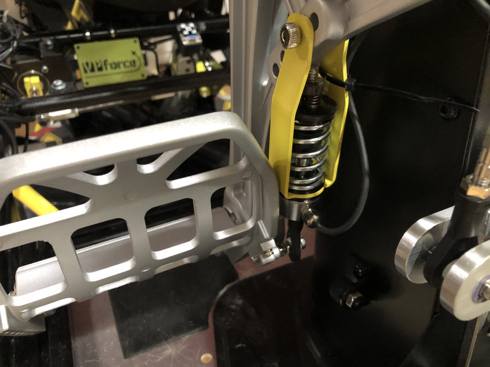

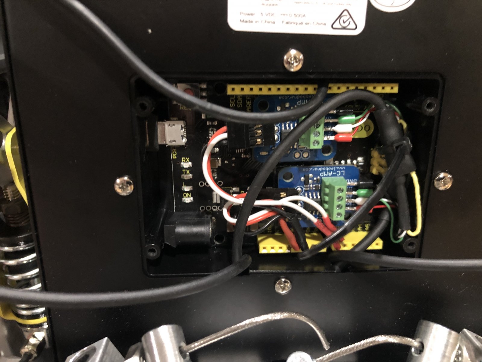

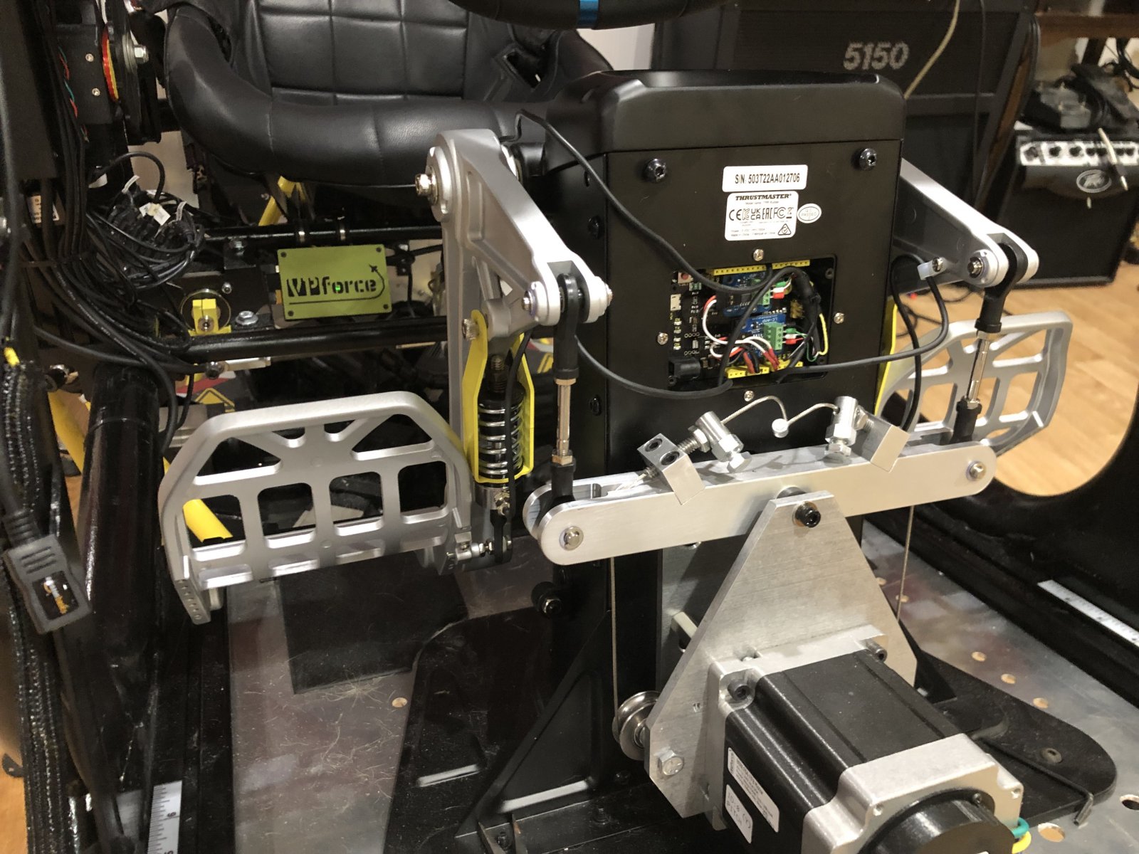

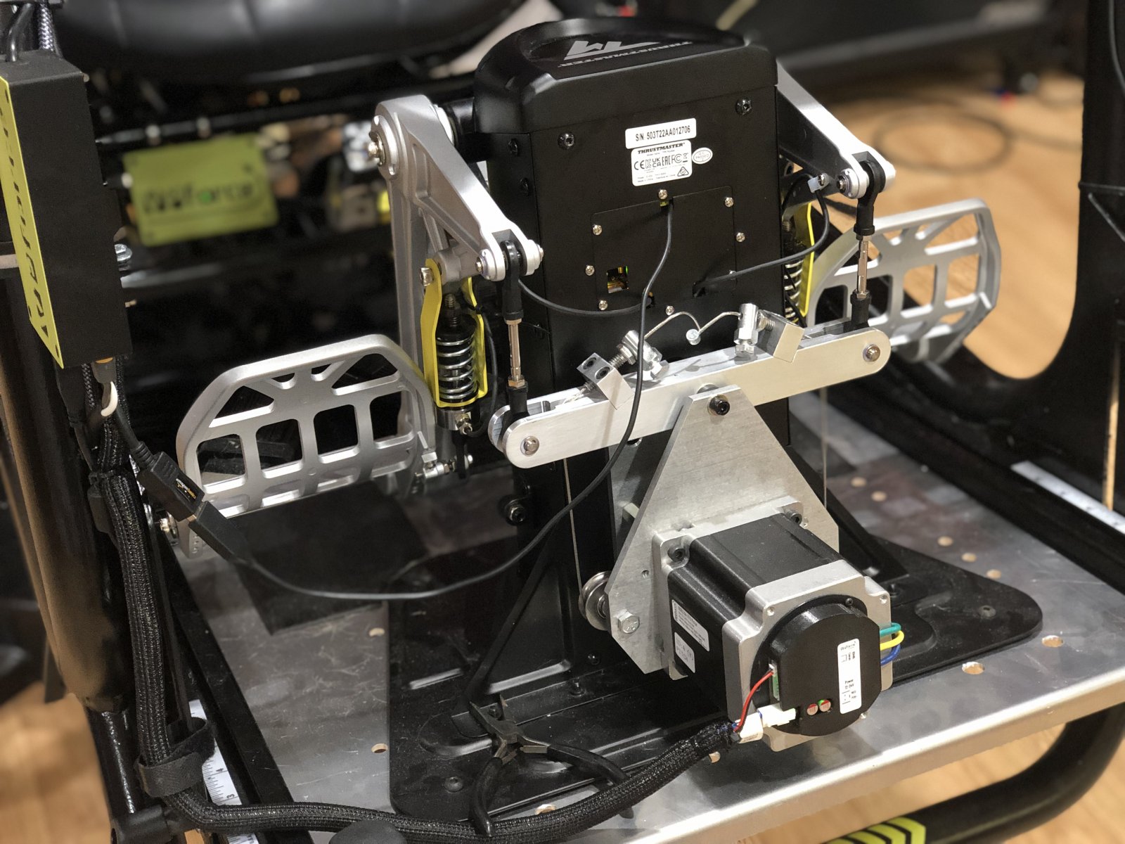

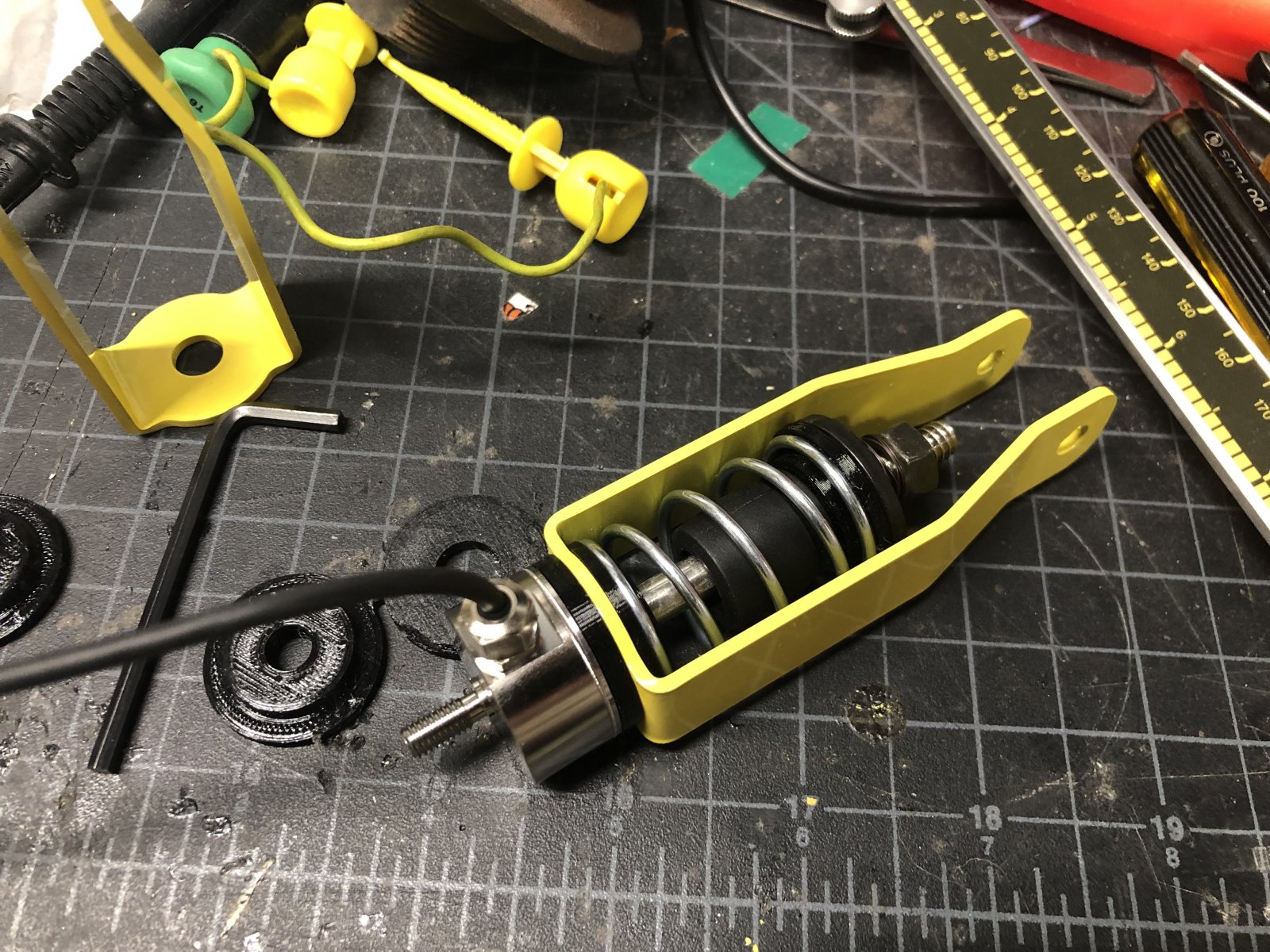

    Projects are never really done, right?

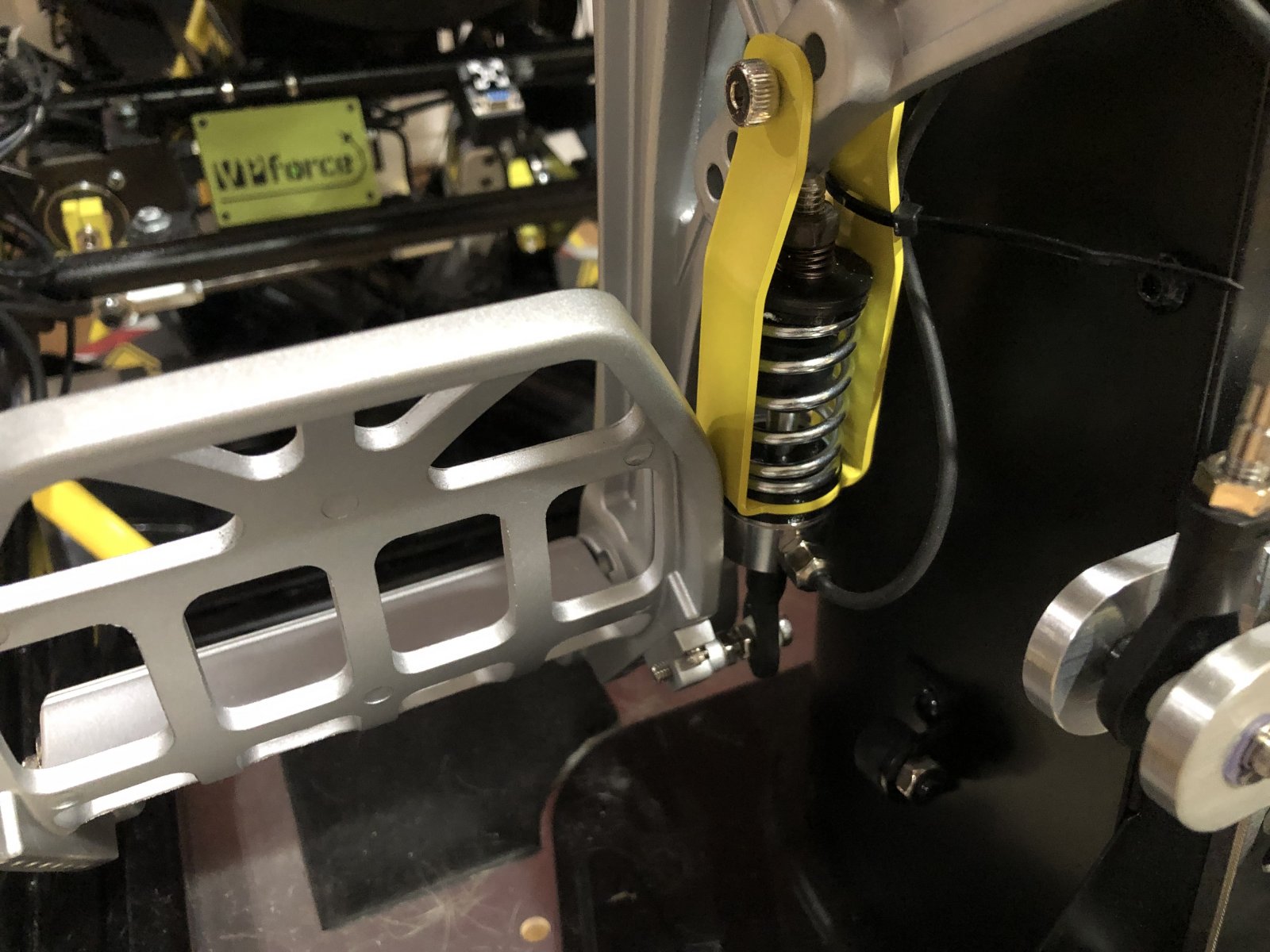

    I never liked the brakes on the TPR's, so I converted them to load cells like many high-end sim racing pedals. I found some 30kg load cells on amazon and drew up some bracketry to make a unit the same size as the original TPR brake units. They have a little bit on free compression and then hard rubber insides so that they get very firm and braking is controlled by pressure, not position.
    I needed some loadcell amplifiers (got from Leo Bodnar) and i used a arduino Leonardo that i had from my old DIY joystick and discovered that it all fit right into the stock TPR electronics enclosure in the back. Wonderful upgrade!

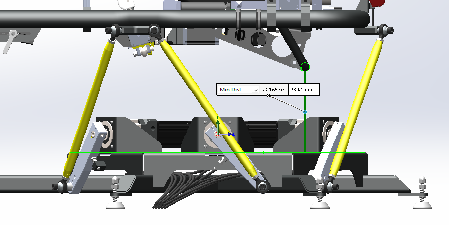

    Hi Smitty, I want to build a rig like yours. Do you might have a photo or drawing of your rig in the position when it's switched off? I want to understand how/where the platform rests (and see if there is enough room for adding the controller onto the base plate). Thank you for your help.
  16. smitty
    smitty Active Member
    Aug 24, 2021
    150
    936Coins
    +209 / 2 / -0
    here's the clearance at full down position
    yes, you could fit the servo drives between the servos, and many have done just that. I chose to put them in a cabinet so my hands arent near moving machinery when adjusting the servo drive parameters! also this keeps the AC voltage away from the rig. Also, unless you special order short servo cables, you will have lots of cabling to hide under the base. I wonder if having the drives and the thanos controller in a separate metal box helps with electrical shielding, as i havent had any weird issues from that like others have.

    The ceiling height in my room is quite limited. I’m considering not mounting the servo drives directly onto the base plate and wondering if, by doing so, I could reduce the length of the yellow bars by approximately 100mm to lower the fully down position without sacrificing any range of motion. Would this adjustment be feasible?

    possibly, youd have to model that and check for interference. another option is to sink down the seat, footplate and monitor mount 100mm lower.
