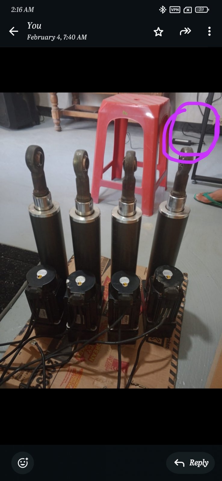

    Damn good man, i was have 4 actuactor only but without driver servo, that way still loking for the other servo, i have panasonic minas A5 its suport step dir also but dont have torque reach ( vnm need it for limit stop) also the encoder resolution is 20bit ABZ its mean 1milion++ ppr, they say over kill for motion
