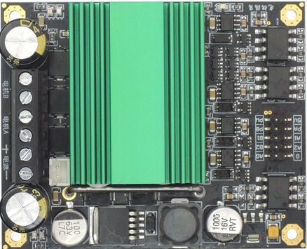

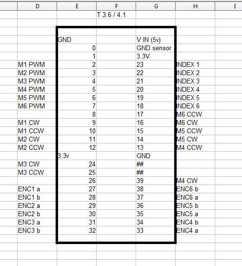

  4. Fifi
    Fifi Oi Oi Oi
    Jul 7, 2022
    8
    65Coins
    I am researching my first build, and came across your earlier build, and now this one. I like your earlier build.
    After looking at your video, can I ask:
    1. Is the battery powering only the motors, and the electronics are powered by power supply on LH side of cabinet?
    2. What type of motor controllers are they please? Top of cabinet, 3x units - does each one control 2x motors?
    3. Do you have a diagram for how you connected the Teensy 4.1 please?
    Thank you.

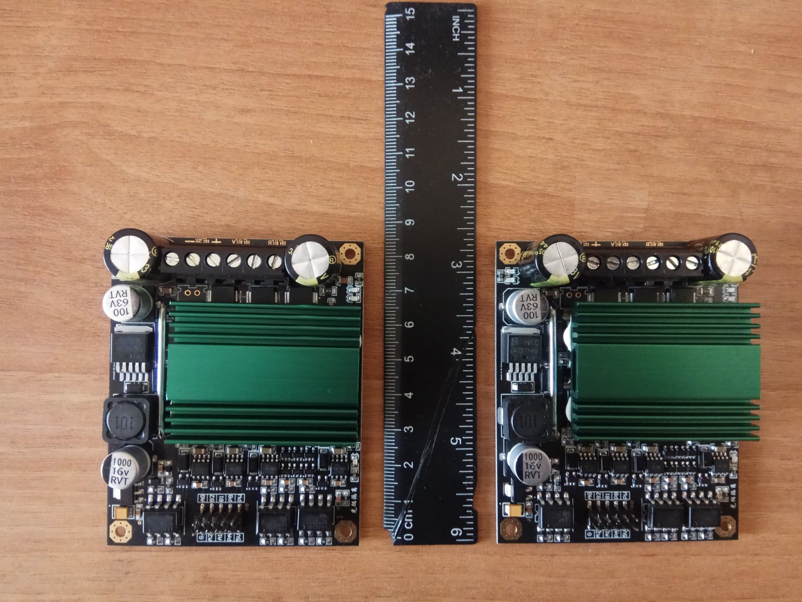

  5. kalbasator
    kalbasator Active Member
    Dec 28, 2021
    105
    Kazahstan, Almaty
    400Coins
    +37 / 0 / -0
    3DOF, DC motor, Arduino, Motion platform, 4DOF
    Second question - This is a 100A driver for two motors, like this:
  6. Gadget999
    1,959
    11,983Coins
    +484 / 10 / -0
    Yes these are the motor drivers
    They can handle 200 A for short periods of time
    I suggest you use a cooling fan on them
  7. Gadget999
    1,959
    11,983Coins
    +484 / 10 / -0
    Hi Fifi
    attached is a wiring diagram for the Teensy 3.6 / 4.1
    the software and firmware is not open source
    There are several power supplies
    24V - keeping the batteries charged
    12V - powering the encoders and the main isolation relay
    5v - powering the electronics and motor drivers
    3.3v - used to supply 3.3v at the board level
    the batteries power the DC motors and also work as buffers for the regenerative power from the motors

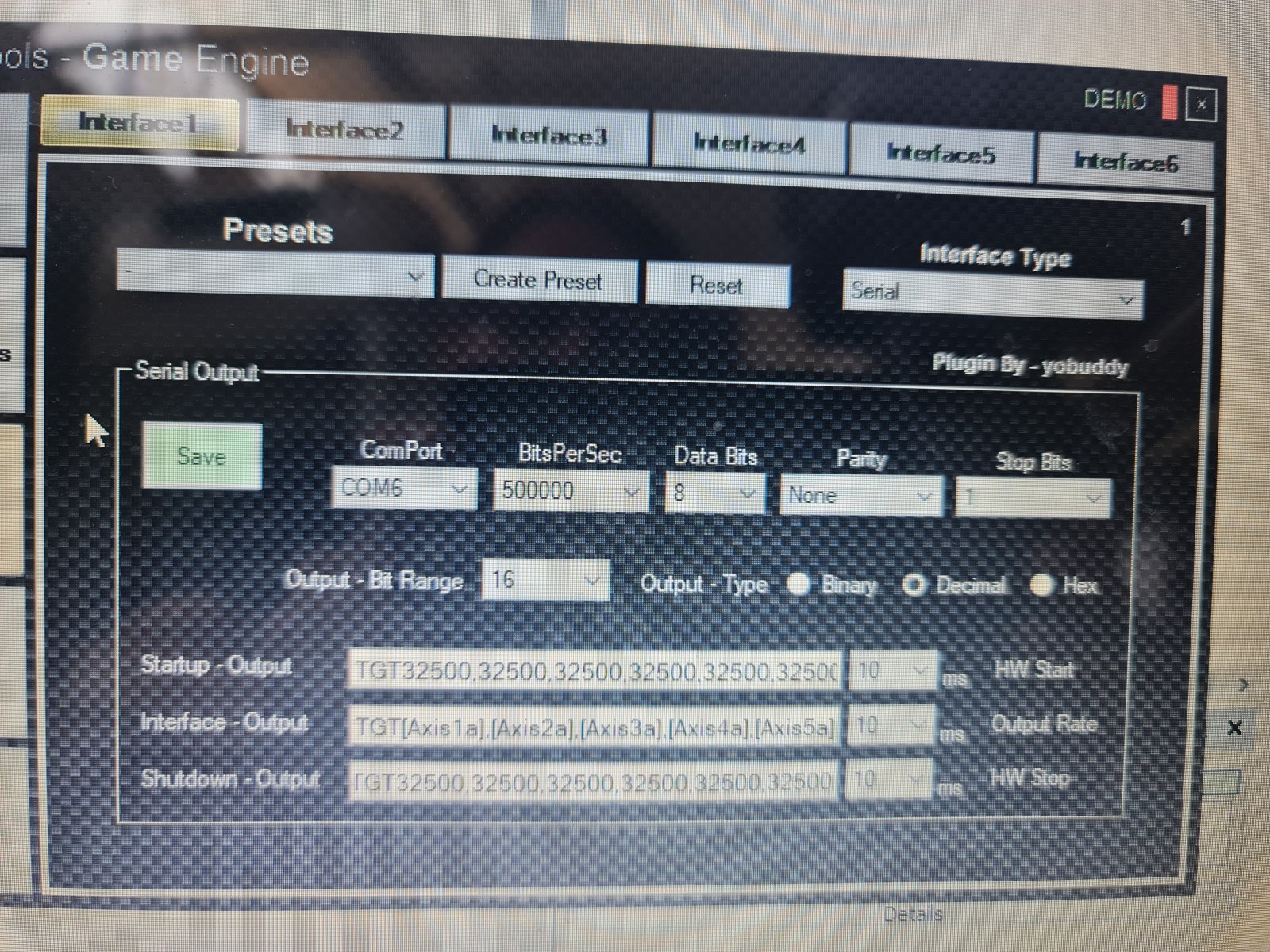

  10. Gadget999
    1,959
    11,983Coins
    +484 / 10 / -0
    @noorbeast can you confirm I have the correct settings for simtools
    My Sim uses the protocol
    TGT65536,65536,65536,65536,65563,65536
    Basically TGTAxis1,Axis2,Axis3,Axis4,Axis5,Axis6
    The start and stop positions are TGT32768,32768,32768,33768,32768,33768
    Pic attached of current config
    21,580
    151,094Coins
    +11,028 / 56 / -2
    I have no idea of what hardware you are using, or if it is compatible with and supported by SimTools, hence please explain the designation of TGT?
  12. Gadget999
    1,959
    11,983Coins
    +484 / 10 / -0
    the board can respond to many different commands
    TGT is designated Target- each actuator is sent a position between 0 and 65536
    a string like this is sent "TGT10000,20000,30000,40000,50000,60000"
    i have simtools v2.5.x installed and it beeps when i try and enable output testing
    however - using a serial port sniffer I can not see simtools is sending any data

  19. yobuddy
    5,399
    50,604Coins
    +5,159 / 19 / -0
    Hi @Gadget999,
    To get this: TGT10000,20000,30000,40000,50000,60000 you will use this: TGT<Axis1a>,<Axis2a>,<Axis3a>,<Axis4a>,<Axis5a>,<Axis6a>
    Nope, the S is just a end of string identifier is all.
    For output testing I suggest you use (a) Axis Output type
    Keep in mind that while 16 bit does have 65536 possible entries, that the the zero counts as an entry, so the range is 0 to 65535 with 32,767 being the center value.
    Also, It looks like your sending data as decimal values, where if you send data as binary values, it will already be in the format your micro-controller will understand. And all 16bit inputs will be a formatted 3 chars.
    So the output would always be 3 chars for each input: TGT111,222,333,444,555,666
    And you can directly read each value in the micro-controller, as the input format is what a micro-controller understands. So if you read the 111 (axis1a) from the input (TGT111,222,333,444,555,666) it will already be the needed value in the controller with no translation needed.
    Hope that makes sense buddy?
    Chat soon,
