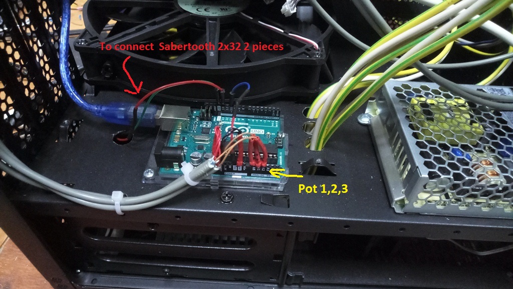

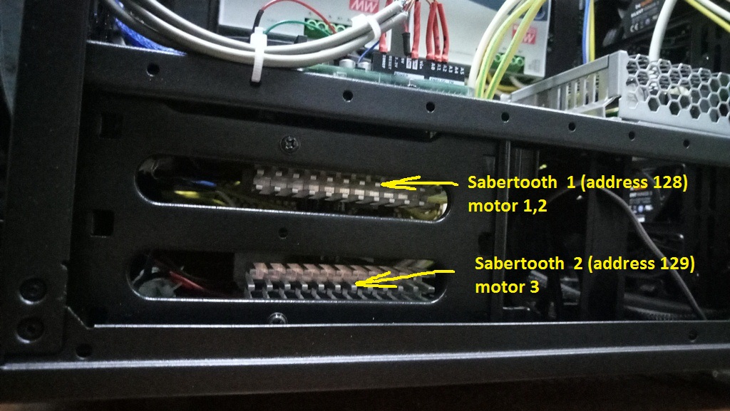

    Everything works fine. To connect 2 Sabertooth 2x32 need, In packet serial mode, DIP switch 5 sets the packet serial address. The ON position sets address 128, and the OFF position sets the address to a user-definable alternate 129.
    In SMC3 sketch uncomment the line 1549-1585 for 3 motor work.

    Hi.
    connected yesterday 3 of the motor. everything works fine.
    1 Arduino uno and 2 Sabertooth 2x32. 13 pin for Sabertooth 1 (address 128) for motor (1,2) and 13 pin for Sabertooth 2 (address 129) for motor (3). DEscribe 115200.
    in the sketch Sabertooth ST[2] = { Sabertooth(128, mySerial), Sabertooth(129, mySerial), };
    simtools work fine [A<Axis1>][B<Axis2>][C<Axis3>] Baud rate 500000
